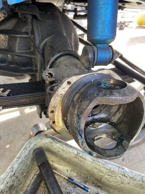

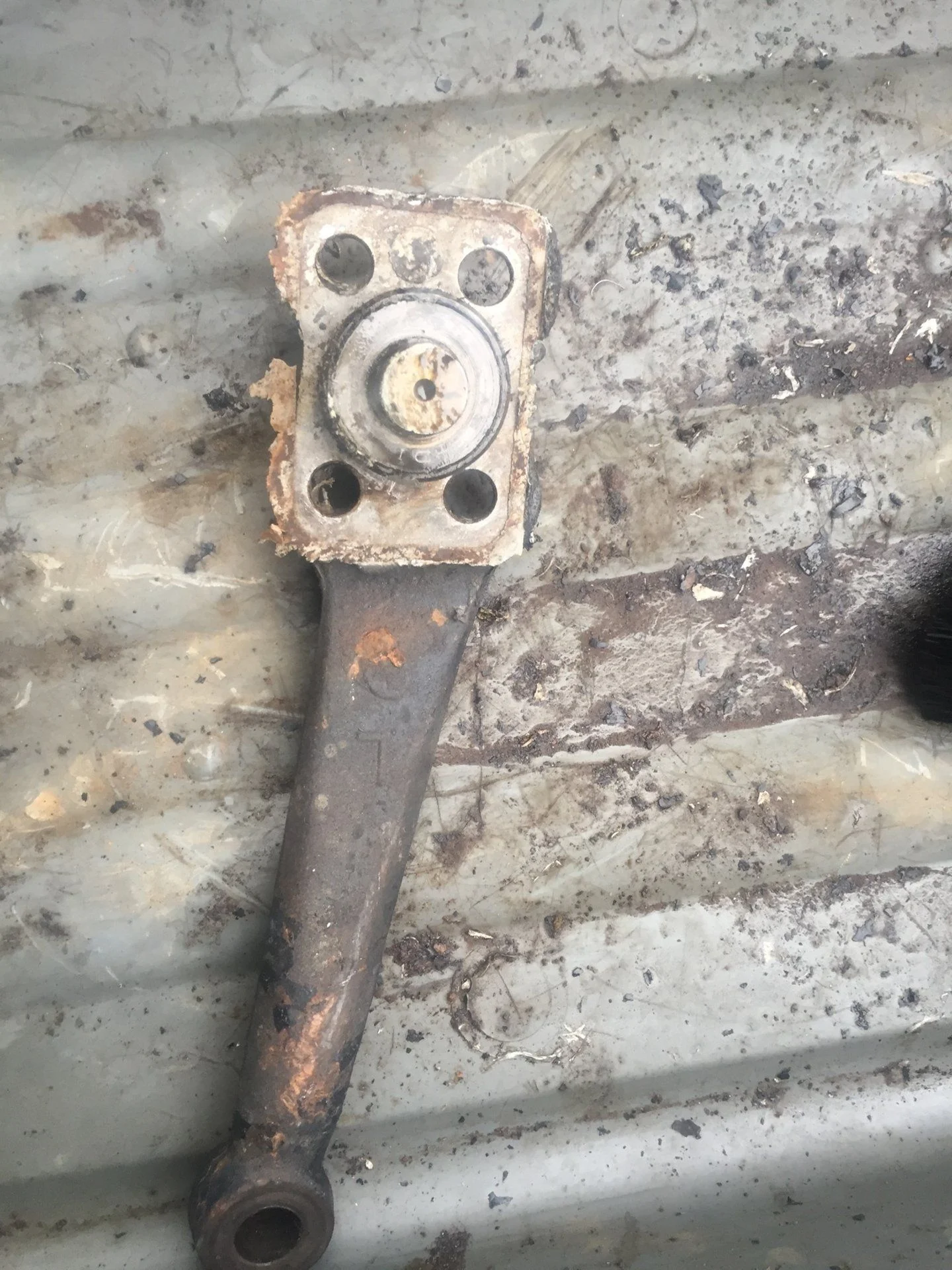

NEVER, ever, in four decades have I seen someone put silicone on...a knuckle arm! :bang: They literally tried to bottle up the genie rather than fix the problem

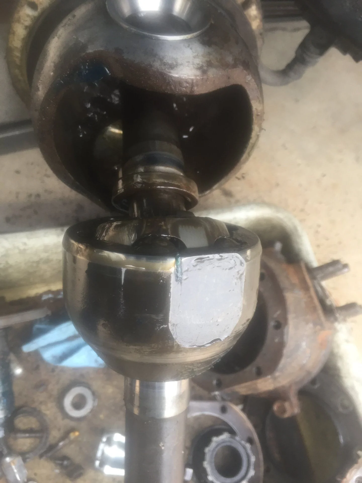

If they’d bothered to pull the spindle and birfield they would have found the real reason:
the birfield seal is attached to the axleshaft instead of the axle housing!
Notice how grease-free the knuckle is. :rolleyes:

never seen that before with the silicone. atleast the knuckle was easy to clean out as there was no grease left in there.
both sides had silicone or just 1 side?

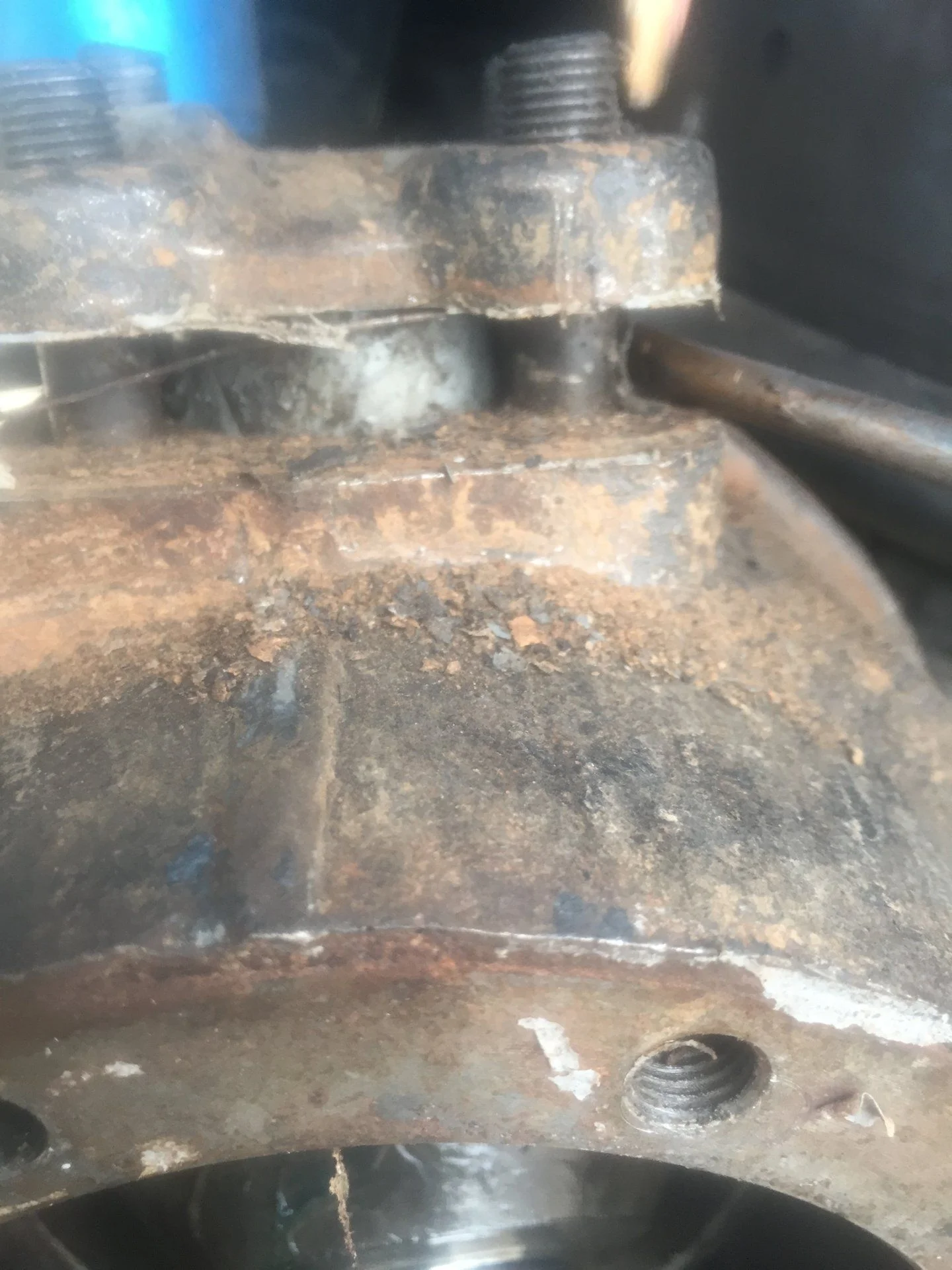

As I worked my way through the front end of the SA nightmare, I hade my reservations about the hub housing. It had some pretty deep grooves in the backside where the seal goes.
Probably because the dust seal had long since failed

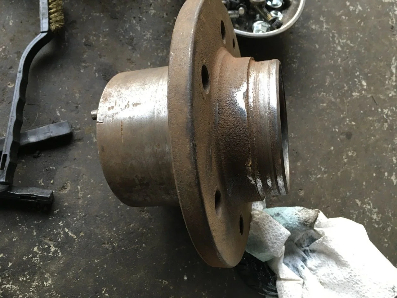

I knew the wheel studs were going to have to be replaced to run factory rims. The ones in there were extra long and shouldered to accommodate alloy rims.
I figured the dust seal was a secondary, not like the wheel bearing seal, so I went ahead and cleaned the hub up with the intention of putting stock studs in. Nope. Holes were drilled for the longer studs. :bang:
So I cleaned up a new, non US drum hub, put in new wheel bearings and reassembled. Nope. That’s not going to work either! Hadn’t occurred to me while I was overhauling the demolished rear end that all the replacement parts came right off my shelves no issue...including the backing plates! D’oh, the SA truck has a domestic rear end...that takes 15” rims. The SA front axle won’t take his shiny new factory 15” rims he special ordered.:crybaby:

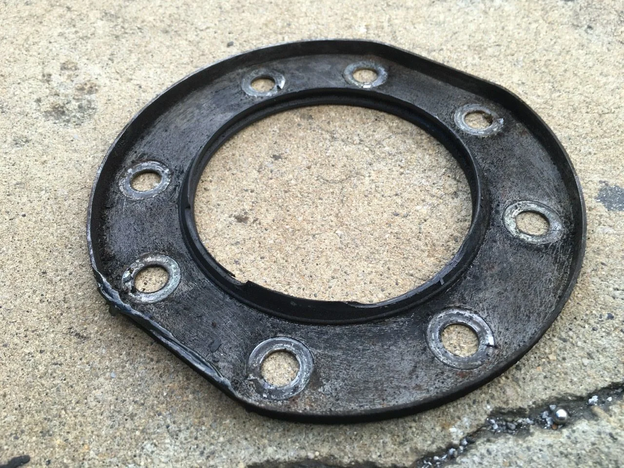

Disc conversion is almost done. Ironically, the hub housing on the passenger side was not grooved.
NO RUBBER LEFT IN THE SEAL AT ALL! :bang:
No grease to leak out of the knuckle. Good thing too, as the backside of the knuckle had not been assembled in the correct order:

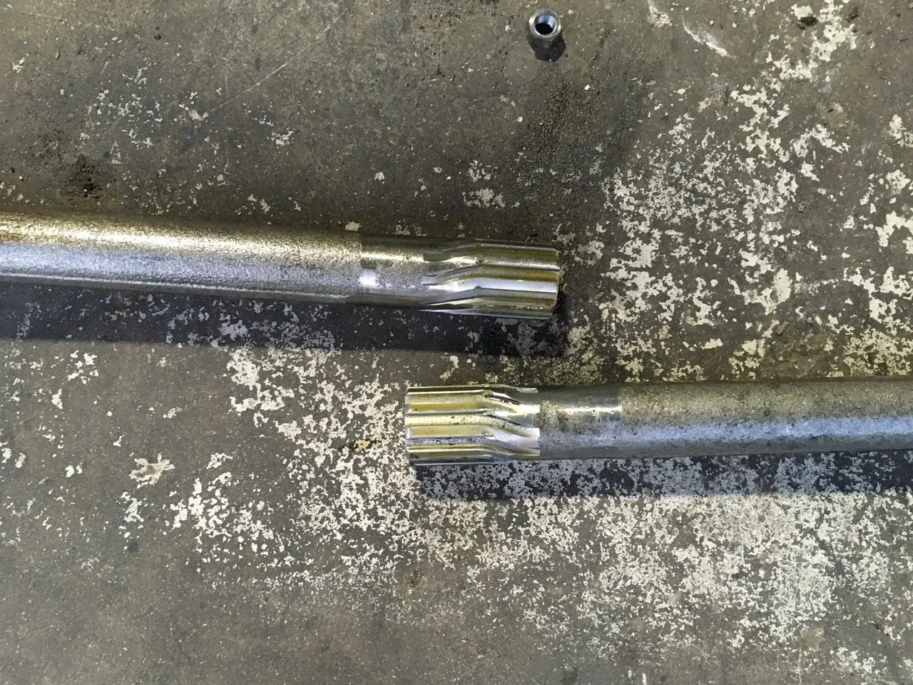

Today’s entrants are domestic, out of a ‘66 front end I just picked up from @Dynosoar. @wngrog informed me many years ago these are to be referred to as ‘work-hardened.’ :rolleyes:

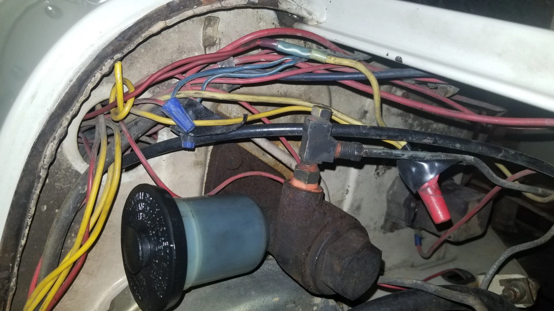

@Coolerman said my truck wiring qualifies to be on the wall of shame thread. I'll add more later. Some hack did a number on the wiring. It is really bad!
