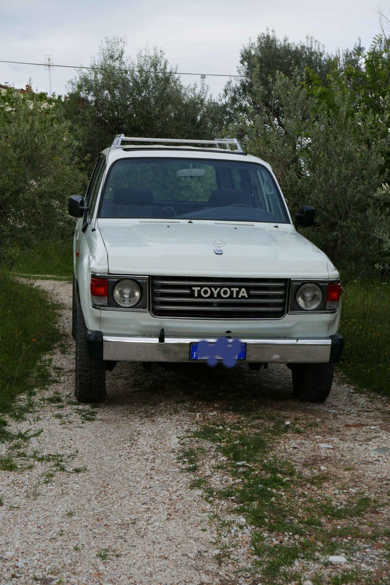

Dear Hojo61 I wanted to congratulate you on the beautiful work you are doing on your project, really fantastic and very good! I also have an HJ60 and I have worked hard to bring it back to life. Please don't give up right now that you've done that awesome loom work. Unfortunately, while I was working on the Toy I fell and broke my ankle, but I didn't give up! I await an update next spring for the update I recommend.
In the meantime, I wish you a Merry Christmas.
Alex

GREAT looking HJ60! You have all the chrome bling bling and a sunroof, wish i had those.

Man that hood ornament is great. Did you add that yourself? sorry to hear about your ankle. Good luck with the healing process.
I am 75 years old and my recovery was certainly much slower than that of the young Hojo61 I'm sure, but I was a bit lame, but it's the same at my age, I won't be able to go skiing anymore but patience I'm too old now ...
Sure I certainly put the emblem that i love on it by myself!
