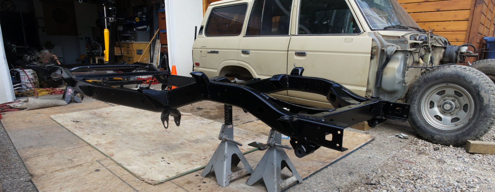

I hate to admit that I threw a frame like that away. That is a time devouring load of work! All I did was sand blast a perfect California frame and coat it and it just about did me in. Nice dedication to the preservation of the good stuff.
Way to plow through it. My frame wasn't that bad. I have re-built one rear frame section and re-conditioned another. Im not sure which one was easier. Good work!!!
I want your axles.
View attachment 1590687 I hate to admit that I threw a frame like that away. That is a time devouring load of work! All I did was sand blast a perfect California frame and coat it and it just about did me in. Nice dedication to the preservation of the good stuff.
If i had access to that good frame i wouldn't think twice to go that way. Sandblasting and painting would have been much faster than rebuilding, but what fun would that be after all. :flipoff2: :cheers:
I want your axles.

First of all, don't expect to see a half finished rig in this post, this is just a small update to show you guys i'm still around, and the project is still in works, not abandoned in a backyard. :)
Progress has been super slow due to the BMW, it gave me hard time figuring out why it wouldn't pass emissions test so i let the professional take care of it lastly. Turns out it had bad cat, bad o2 sensor, and 3 or 4 bad ignition coils. Jeez what a nightmare, and it wasn't cheap. That's how your quick and easy projects end up like usually, right? :rolleyes: I have been daily driving it for about 3 weeks now and i have to admit, pretty fun little car to drive.
And then there is work, uh, doing 8-15 hours per day really takes its toll, i don't really have any lust on welding or anything like that at the end of a day. What i mean, that really limits project building days to weekends.
But, let's get on the topic. I brought the frame back to the shop about 3 weeks ago and started working on it the next day, nothing major, mainly doing some welding, grinding and measuring the body hangers back on place. That is really slow alone with tape measure.
Had to source some main components for the frame i thought i could use but they were too far gone.
Luckily i found them quick and in really good condition. Huge thanks goes @Samppahj who cut them from his spare frame and send my way quickly. Samppahj has been huge help with sourcing parts too. Not to forget he has 3D modelled some NLA parts, don't forget to check out his build thread!
But, the sad reality is that the goal has to be lowered due to very limited time. My goal for this year was to get the frame, axles and power line ready and bolt the cab back on frame at least. I hope to get the frame and axles ready, maybe engine and gearboxes too, time will tell.
I got some pics too:
Here we have the frame back indoors, ready to be worked on.
ve8QopsPZ4HnQM81ObQhpCCa1rZZFQS1B9OHCUveq8tjsmZAdRX36_yM402RQaFC5M__3oR7hnvIO2Bzqd2Qpuanp9SZqWlEbib37oUxZmLYWV411eJhaxOqVOsMAevoF_9E50Iw6V8EjkuDwsehFPqQwiPLUnti2KAw0sHsrFnDIEkgFrtAK-rD2G2dXkS_Nxf_A9BodudafMSjqEnITNVWu0Wy1qSUFBexIHdieHc7pcGRYYsKyhD75VAXl0SBe4w8zIhTawArXvzNCqCiqGAKl2t42WxPJQCsP9QfTPtDGVhKIP6wwls9ROvrtmZ2oAwvrh1186pMwPmnt3vUIp9DpML01J0jxlnigjn0LYjz9sTlXRyt535Jru49Ll6D3Tv0TxkZ1B947ste-op9yOtB8DeDli1XMWS8iNBcYNmR4xyxYvdcQDO-QkbplID0xOUWtzEov4wgL231aX-sp4SMWilcP7LYWyTR-D5hg3xkIuSa1WJYnke1YWpL5-bWHePULCCgtX2_66ax79BiFAQJYkxp0fzviKVmzHHn_rUCaQ8Jkwg9EZPJRBmmosWcFcbyz9HcIaifgThT_wm58QLbQkMUVUrpVaW1wGW4am1CC0B5DEFAgvJp-QDVvbXwXv3gz4BC8nlOe96rCvBivZmObR5B-cb4=w602-h1070-no
Welds grinded flat and transmission crossmember brackets back in place.
FRqNKANP8PFK1GAwFpZ77JM1TWSXjk1lycYqcUcAuLAqXoPP6pgKAfimv6Vt7q182adPDuXf7mf6LBTQtPi6e4V7wMxIosqH2oo3Qj3BgKQgQaUujNqSIMiS0z6d_8_cASPUfGl8jmvb1YVGGmtmX55Uv-k6tLx-f99v7Y8iNs5UZaY-XpuDf30Ck-Aq3UXkkm9rhsdtBOcI1dz6NG3xGaAz3vsTOQikNjO1cJ9o71QhE6qMbz8OGSGivD-0BT12pxCpMTM3LfaUyJ0Lmkee1gOD0ises3V9MBF-a6gduIF8r19SquAeQ_2XYAXIwmIg5SWOOZKiqJGqOXhOdeOogWYKT-B2dpBV0lOzRsHUvZFsR-tVgaLK9PfUHmIQYAKQRIJIhgnieS9Oewt1x-o6VY5wVa0_wIAUTA3lV2Lth8l4vCZrlh0a8wgjDK6FHX7N0onzznxagiyyb9ZfQ0CfOUFCE2IH0tjRUEInSZHMBLlQ3C6yB6pECHQ0809AAV3xG3ZRSV6VUb--IoNvYCXpphMQPrRQm1w3d4H6VSKzZ8ioAiOb0dfSrOJGHJ6_5-vuQIQ_QfOPtFqtTqGaRLM1kOAvRpK3rgc9xgYQq2m6G4Le36Nop-4lgsK3DUWCsETOQWQWwKIMIwbOtFCC8exPRGZ3UVQ3W4hF=w1516-h853-no
Reinforcing the frame with plates.
z64PLkvKR6thDoVUkHVSElFQ1Z0PnHokia4xXxcie2ReuLqRfSDhAAnjSc0YAOjBSRZTMfYJCaI8AVwBInAtSLEw6Ns_VJVKWKTvBhX3h7jXPlVvDADA5Qwy0rMxIHkw2-jRYoO1DVaoB02pZgN0Ij3zDJ4nFBH4Tup8zCrvyBkU-QiCNwgFK9gkKxfaXcPgLmNz0_3VrxkdE3NXjPGrvWr98a5UE64KXFmbirBi060AgHdtzhPH4cew3sARQ0IRiplPXyduhhmKgA6NNaDyXP7jXAoLyufyuwbnx0wAinDS46jLfwIy_Br25Xe9o4_U5WdLuujDswWpsdVXBpCeu844TfdKYnOovL-4PRsUhzdEavVaNbubrY3w4XdRep2NcEF1MnnABKZhhzeZV0HZMuLrkIGOnKTj2M81WeWxk2dwe15ImwkvkskSlbqFylsn7BsKGwKvNjw70MXkEpnbRqnPygXTCibrGpAnChchqe3GhYxRkq894_HBHx3T_tgsBt0A3Rg0549D5xFVxF1L979tYp5KcSPb9MHo9lVHeGl3sr0QACapNmzGod6FxMePJkiJHQUsZCuatl49KgH_277TBqUk_GLCLdFjJlCUIYaKQcG9AhEIPm_tkmqixP5L9ff515qnLbvMVrdHiyZrxBVC1BW-4oUl=w1516-h853-no
