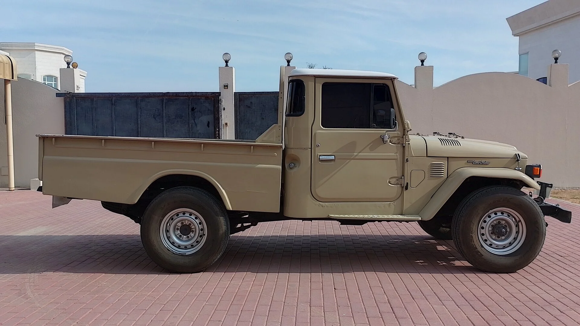

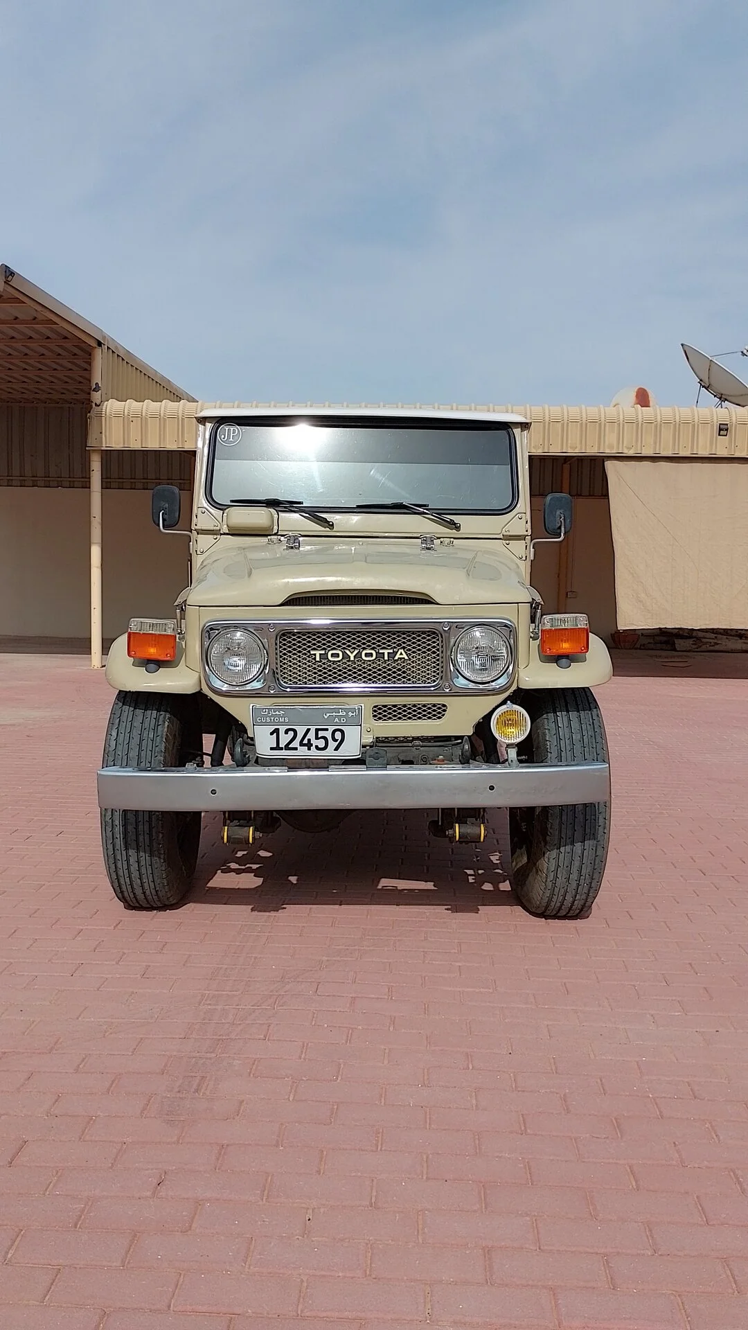

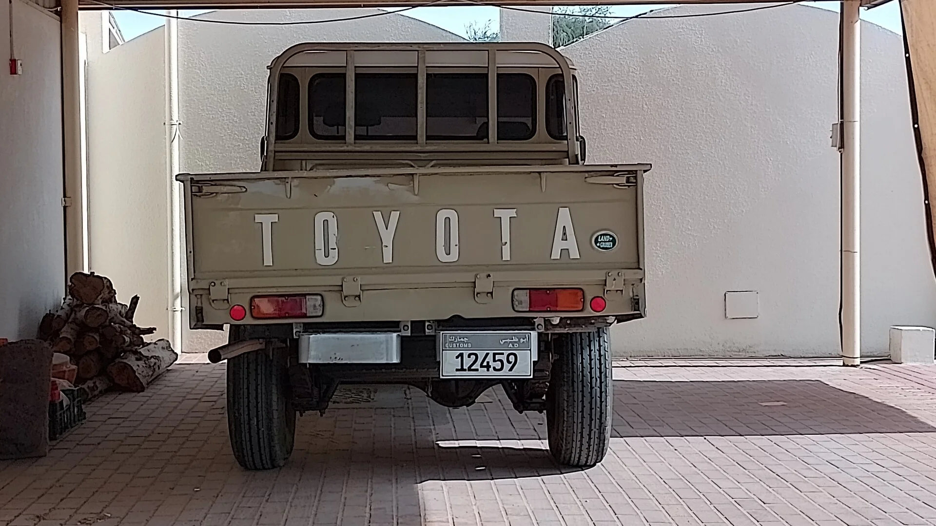

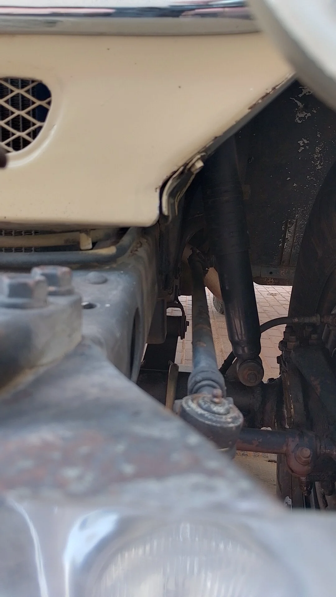

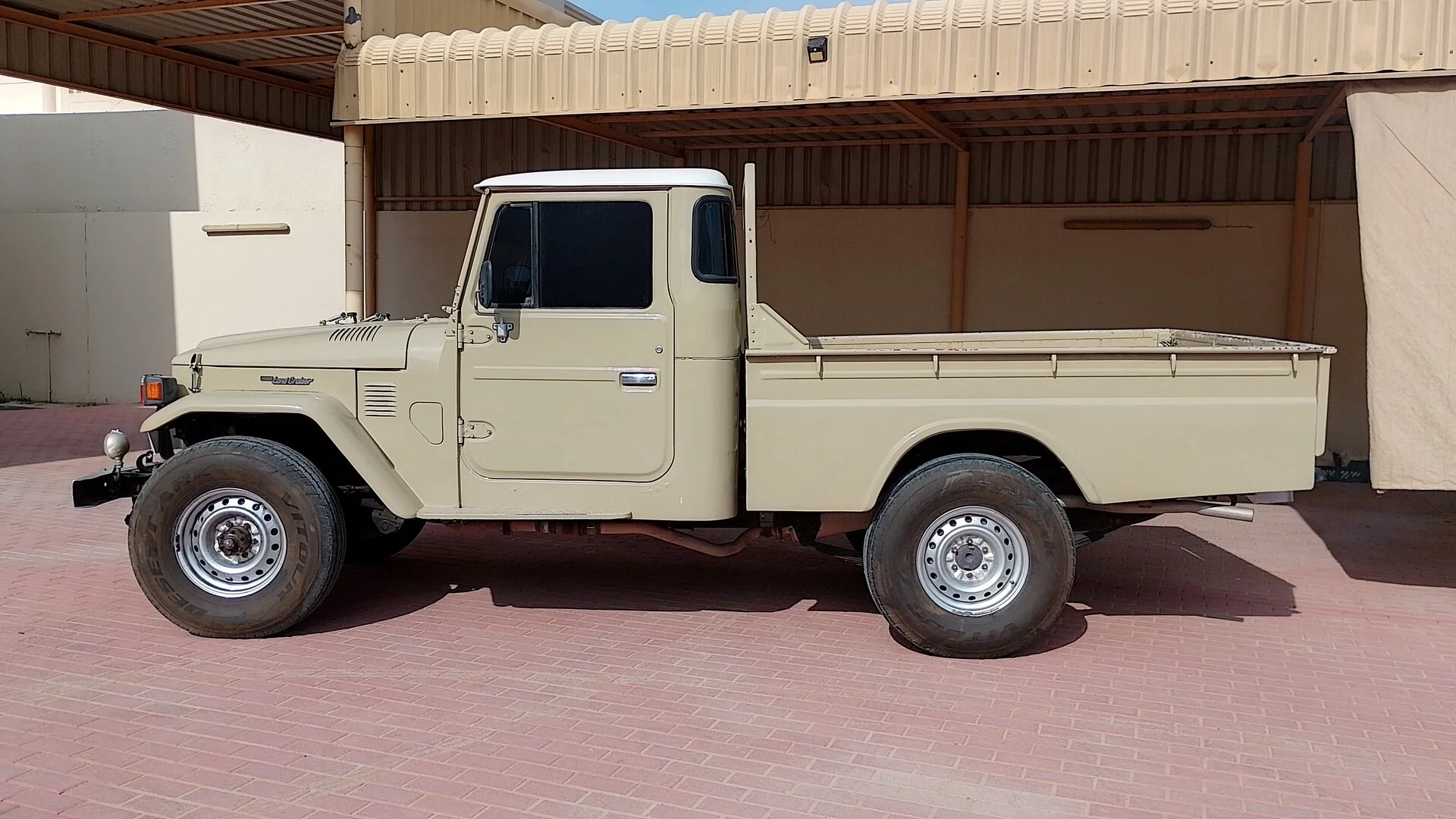

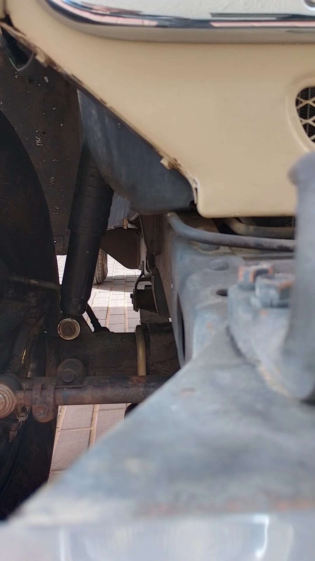

I HAVE ONE QUESTION FOR THOSE THAT KNOW THINGS... As you can see from the photos, there is a poor lateral alignment. The front left sits higher than the front right and the rear right sits higher than the rear left. This could be a bent chassis I know, but the suspension is also uneven (detailed below), so I will supply you with photos and all the relevant factors I am aware of (just ask if there is anything else) for you to figure out which it is.
Factors suggesting chassis misalignment:
- Visual misalignment is significant
- Passenger door has minor issues opening and closing
Factors suggesting chassis fine:
- Doesn't pull to the side when driving
- Doesn't crab walk
- There is one suspension spring less on the rear left than rear right, and the front right suspension seems flatter than the front left, which could both be congruent with the higher rear right and front left. [Having said that, I do know suspension can be affected by chassis damage.] I do not know why there is a spring missing from the rear right.
- No visible chassis damage or bending (but I'm a novice so maybe there are tricks to figuring that out that I haven't learnt)
Just to provide as much info as I can, the front left sits 2.5cm or 1 inch higher than the front right, and the rear right sits 3.5cm or 1.4 inches higher than the rear left.
I will attach some as many relevant photos for you to have a look at too. Thanks for any advice given.

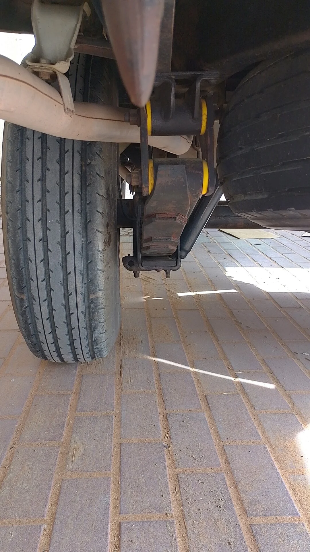

I am not an expert on suspension issues, but if you are confident the frame is straight and true, then start with a new suspension kit from Manafre, JT Outfitters, or someone like that. It looks like a case of worn out springs to me. Up front you can loosen some of the bolts in the front clip and the bottom of the front bib and wiggle stuff around and retighten. I have zero experience with pickup beds, though.
Looks to me like somebody was jumping too many dunes and had a hard landing
The springs were taken apart poly bushings put in … new unbolts used on a few
Messed up the number of leaves in the pack … maybe even had a few broken leaves
Bolted it all back together tight before lining it up well … then over tightened the shackles even it looks like on at least one
If you notice the spring pack
On Dr side has more leaves … the rears are different spring packs even
My quick observation

Congratulations on acquiring your first FJ45. I say this for a reason. You will likely own more now that the "sickness" has started.
As JohnnyC states, your leaf springs have been assembled using a jumble of parts and this is most likely the reason why it is leaning on the various sides. Here in Africa that is par for course.

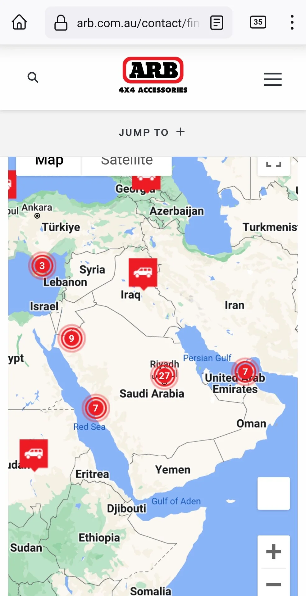

I'm assuming you are Middle East/Gulf based given the architecture, as such I would approach your nearest ARB/Old Man Emu stockist and authorised fitment centre and have them replace the hodgepodge of springs and suspension components under your Cruiser. That should get it much closer to level, riding better and safer than now.
There are a good few in that part of the world -

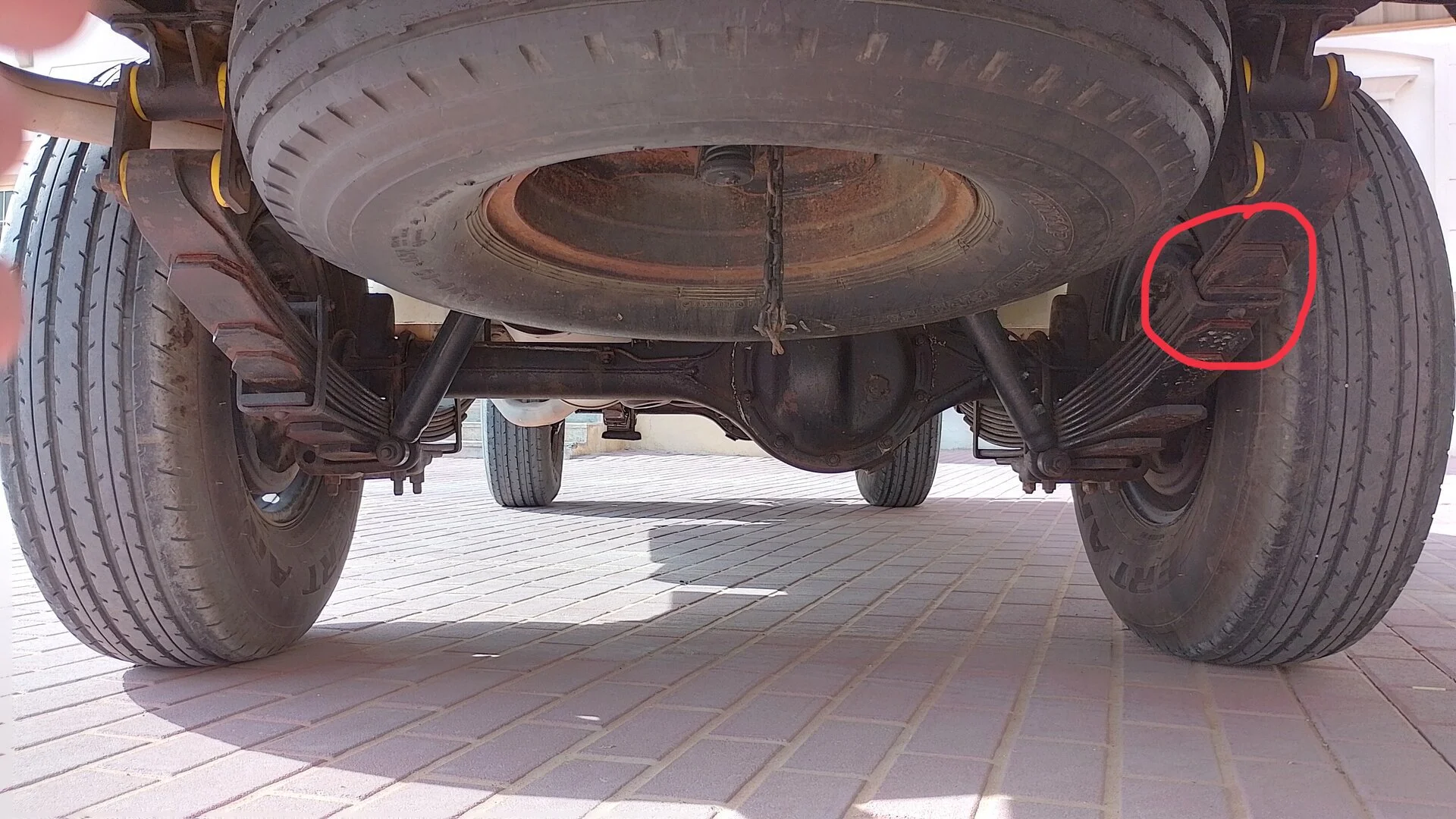

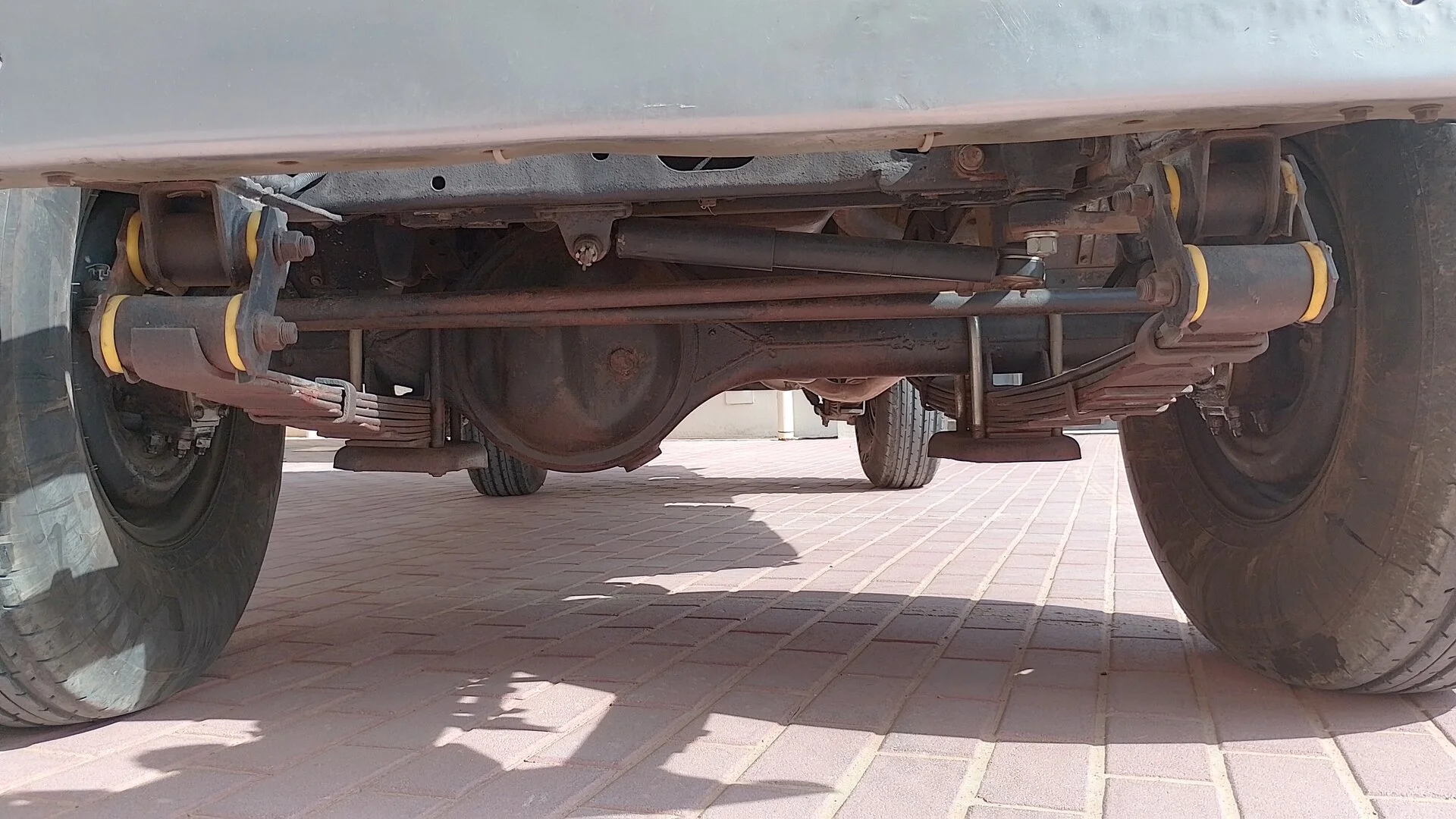

Both the left side spring packs look tampered with or damaged. The rear one has a non-factor clamp in the wrong place which might be compressing the leaf spring and causing that left rear droop. The front looks like it has a broken spring clamp.
The image of the front springs shows the Left and right are different, and have different curves.

Poly is fine or oem rubber … doesn’t matter … the point being is it was changed out for a reason … they needed to get removed in order to repair the suspension
U bolts are supposed to be there … some were replaced… a sign that they needed to do spring repair or replacement
U need to get a suspension for an fj45

Just a couple things from your pics, not suggesting addressing these will cure all your ills but just looking at the obvious discrepancies (along with others already pointed out):
this indicates body components out of alignment a bit, which could point to body mounts askew
this is different than the other three on the rear spring packs, maybe causing pinching and non-settling of that spring pack - but that one and the ones on the front packs look like what’s on my ‘63 so maybe the others are replacements?
Nice looking rig, should get lots of mileage from it!
Photo directly above in post #14 shows right rear spring alignment clamp is in "pinch bound" condition, and left rear spring alignment clamp is loose bound for good spring movement, lets leafs glide on each other as they should for a smoother ride. Yellow spring bushings are a pure indication the bushings are not graphite impregnated, no internal lubrication installed. Graphite is black, so bushing would be black. The yellow bushings will not tolerate lubricants, will absorb lubricanrts, then turn soft and begin erosion. Installing the yellow bushing dry will create very squeaky springs.

All 4 spring packs, none are the same, take em all off, separate, clean and rebuild spring packs that match from what you got there. The right front fender has a bit of a janky bend/tilt to it and the right rear corner of bed indicates the jump or hard landing theory. IMO correct spring packs and go from there. Nice truck overall.
The fender to hood off-set in Middlecalf's image looks like the frame is slightly torqued by that rear left spring. To me it looks compressed by that clamp. Take it off and see what happens.
