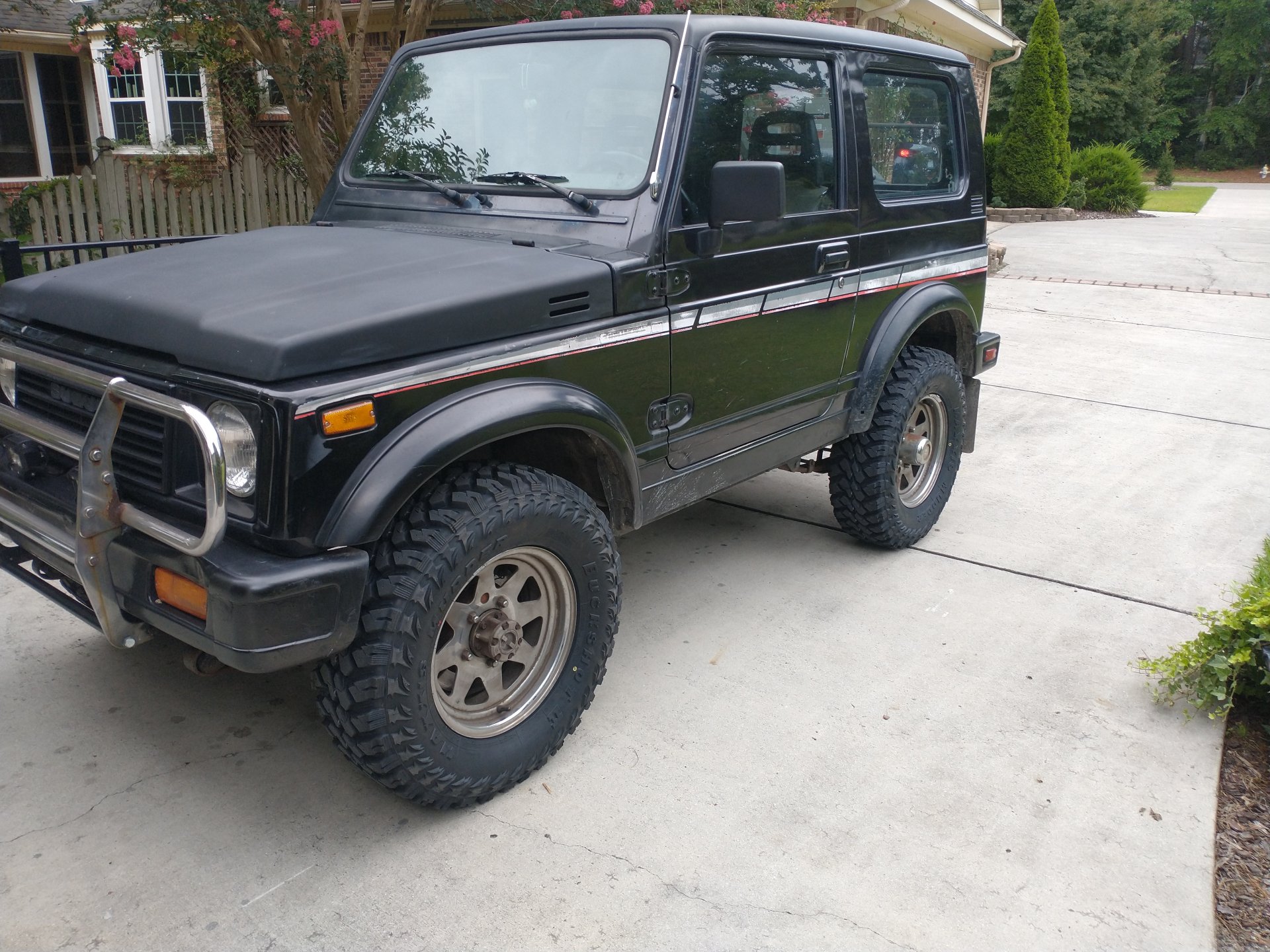

I offered my 87 Suzuki samurai for the clown car effect!
Love these samurais!!! I have been trying to convince my fiancé we need a samurai for years haha. Also I know this is out of the ball park @theglobb and I am so sorry to hear about your 3b again! but somthing like a converted camper school bus or somthing like that would be really cool for a trip out west. But long live the troopy! Safe travels on your trip if you do end up going!

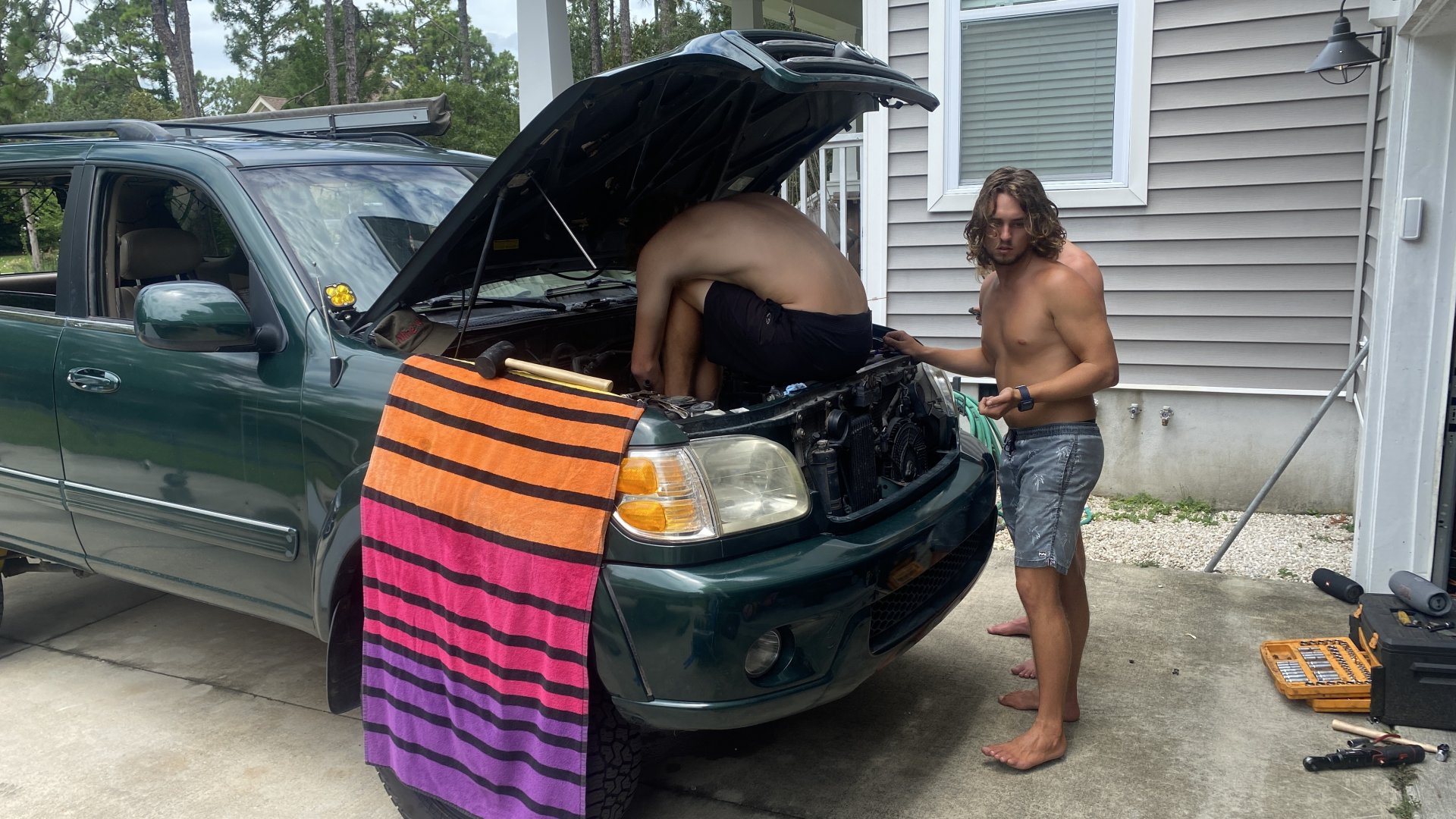

Sorry for no response… lots I had to do in the past 2 days. Nonstop work on the sequoia: new rotors/pads, coolant flush, double down on all the bolts in the new suspension, and that HORRIBLE starter. Man that starter is in such an inconvenient spot being under the intake manifold, got it done tho. Greased everything I could grease, seafoamed it, heavy dose of injector cleaner. Running like a champ.

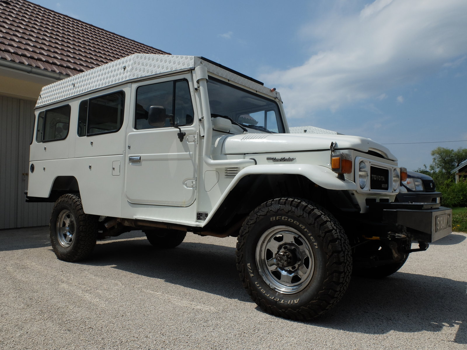

Note that the 3B in the LWB BJ45 and BJ75 is a very European spec (probably for tax reasons on big engines in some European countries), rest of the world mostly had the 2H with the HJ47 and HJ75 for LWB.
(Everyone had the 3B in SWB and MWB)
I'll give 1 example to give some hope in the capability of the 3B with a turbo to survive.
This BJ45 with a popup roof and outfitted for travel is not on the light side and has 460kkm on the clock. The owner travelled dozen of times to Africa, Eastern Europe, Siberia, Mongolia... All these destinations start by a lot of freeway to go there.
Seen it in person multiple times, still running perfectly fine.
This cruiser is awesome… like @gilmorneau said about the 3B’s, it’s probably been fully redone at some point or very greatly maintained before the turbo was eventually added. Still, I think all of this is a sign to not put a 3B back in. Doesn’t belong in a troop carrier in America.
