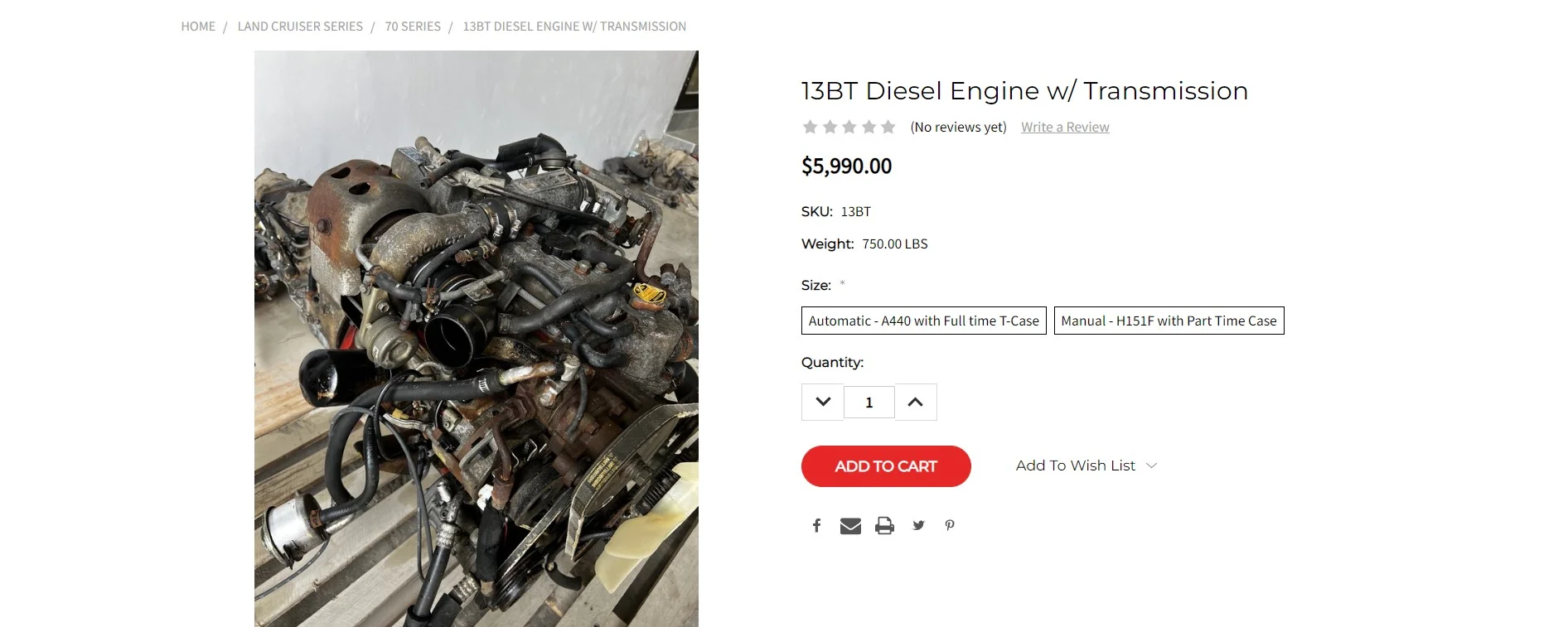

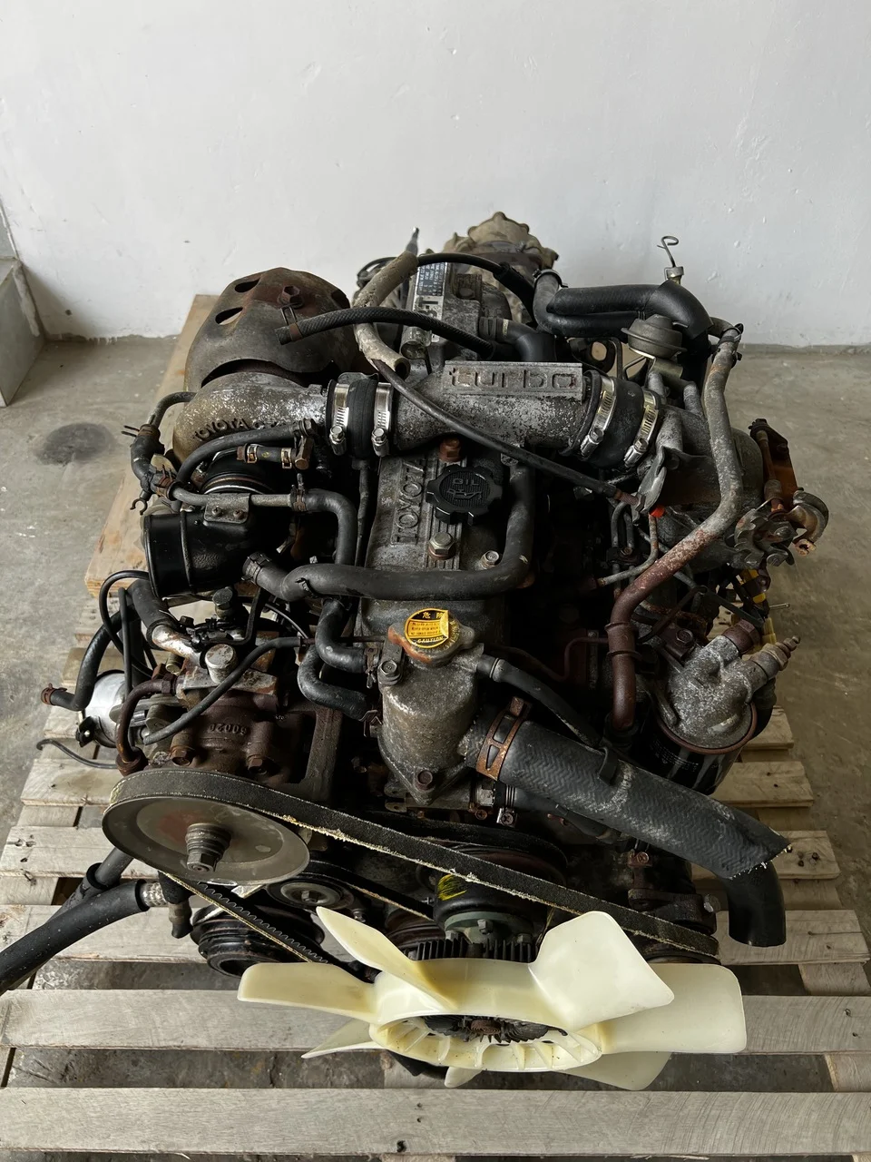

Land Cruiser Heaven Thoughts??? I really dont know what a fair price for a 13BT would be, contacted them asking if I could get it without the transmission for cheaper and if they had any idea how many Kms it has on it. Their website only says this about the engine...
"13BT from a JDM Spec 70 series. All our engines come from running and driving 70 series. We guarantee the engines to have good compression per OEM Specs.
Donor vehicles come with lower than 275k KM.
13BT with Automatic Transmission
Engines are used, and we recommend that when you receive them you replace all gaskets and seals."
Do these guys have a good or bad reputation, never really heard about them before but they are on the east coast so much much closer. Also the only 13BT i can find for sale in the states. I'll update the thread when I get a response on milage etc
Lots of salt exposure. :hmm:
This company has had issues in the past.
Search here:
Bad Sellers - Buyer Beware - https://forum.ih8mud.com/forums/bad-sellers-buyer-beware.352/
Just google them , plenty of bad reviews out there . I have bought some stuff from them before that was advertised "in stock" and once they had my money I had to wait 2 months to get it . Only deal I would make on that is pickup in person and hear it run before you load it up.
exactly what I was thinking. then again doesn't really affect the internals... just spray everything with kroil for a couple days before tackeling anything
