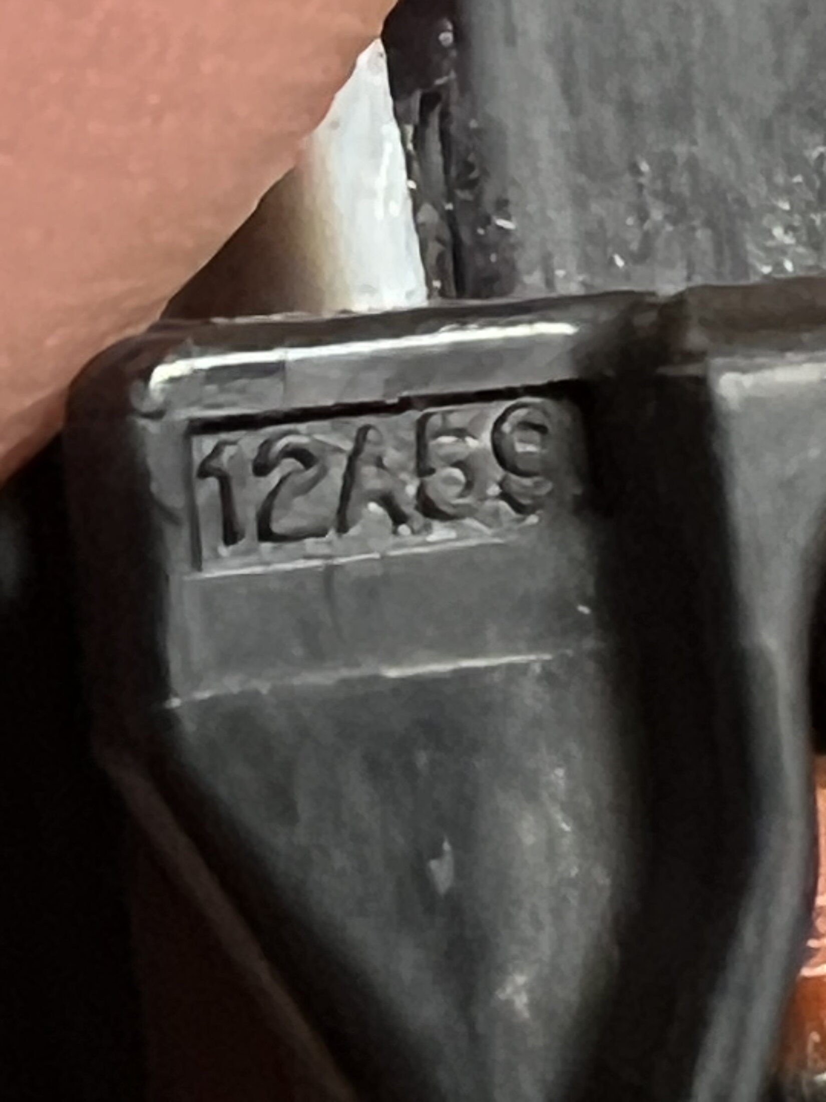

Can anyone weigh in on whether these two connectors are the same or possibly a supercession?
90980-12A49
90980-12A59
(last two digits are 49 vs 59)
The use of 90980-12A49 is a female 6 pin connector for the front camera on a 2016+ Land Crusier. Toyota calls it a F connector.
From web searches, the 49 and the 59 look like the same part.
90980-12A49
90980-12A59
Did you get the 12A49 directly off the connector? That number isn't coming up in the systems I have access to, and not much coming up in an image search online either. In the diagrams 12A59 is used in dozens of vehicles however, including your 2016 cruiser, on the front and rear camera.
Nope. I'm a dope and messed up the part number. The 12A59 is what is stamped on the connector. Sorry.
Thank you!
In the EWD, it is marked A49, so that may be where I got turned around.
That makes sense. The EWD is like learning another language..
