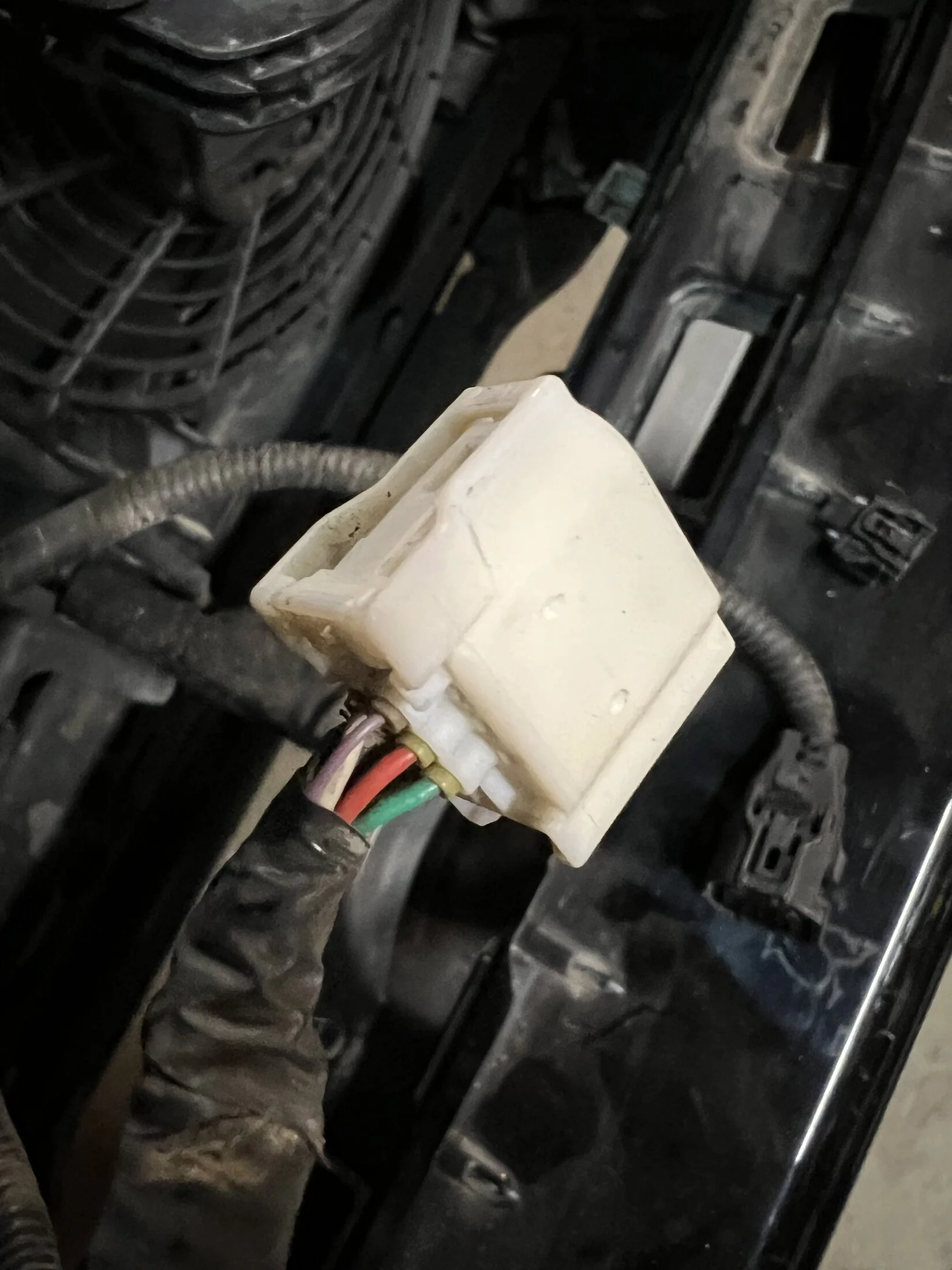

I had an aftermarket front camera that I used an ARB wiring kit to adapt to my factory harness. To do this, I repinned it into an ARB connector.
I need to repin it back to factory.

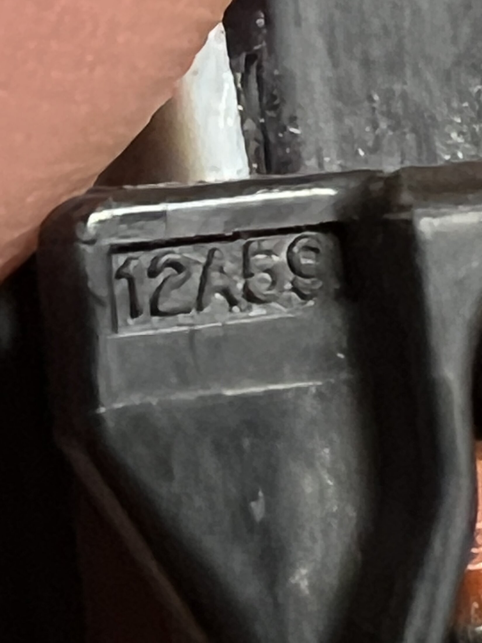

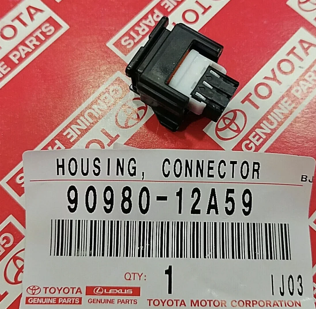

It is a 6 pin connector. 12A59 is the only marking on the factory connector. It is keyed to fit only one way.
Wires are lavender, red, green white, blue, and maybe black.
It is a 2016 Land Cruiser.
Thanks in advance for any help.
Pictures would be helpful too.

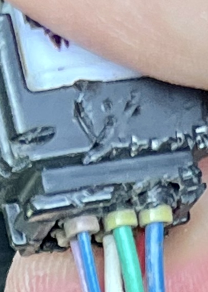

I found a picture on my camera roll from when I did the project initially. I zoomed in and think this gives me what I need to get the wires in the correct positions.

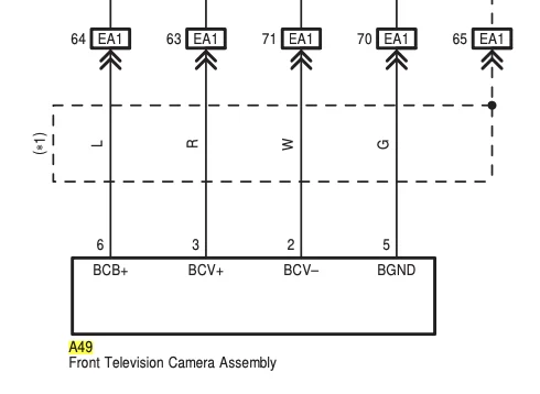

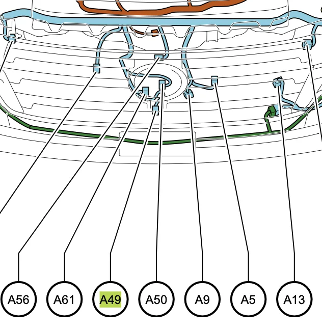

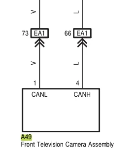

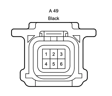

Adding EWD information.
So from the back side, I think we are looking at pins arranged like this:
1 (violet) 4 (blue - smaller wire)
2 (white) 5 (green) connector locking tab to this side -->
3 (red) 6 (blue - larger wire)
Connector A49, Toyota part number 90980-12A59
