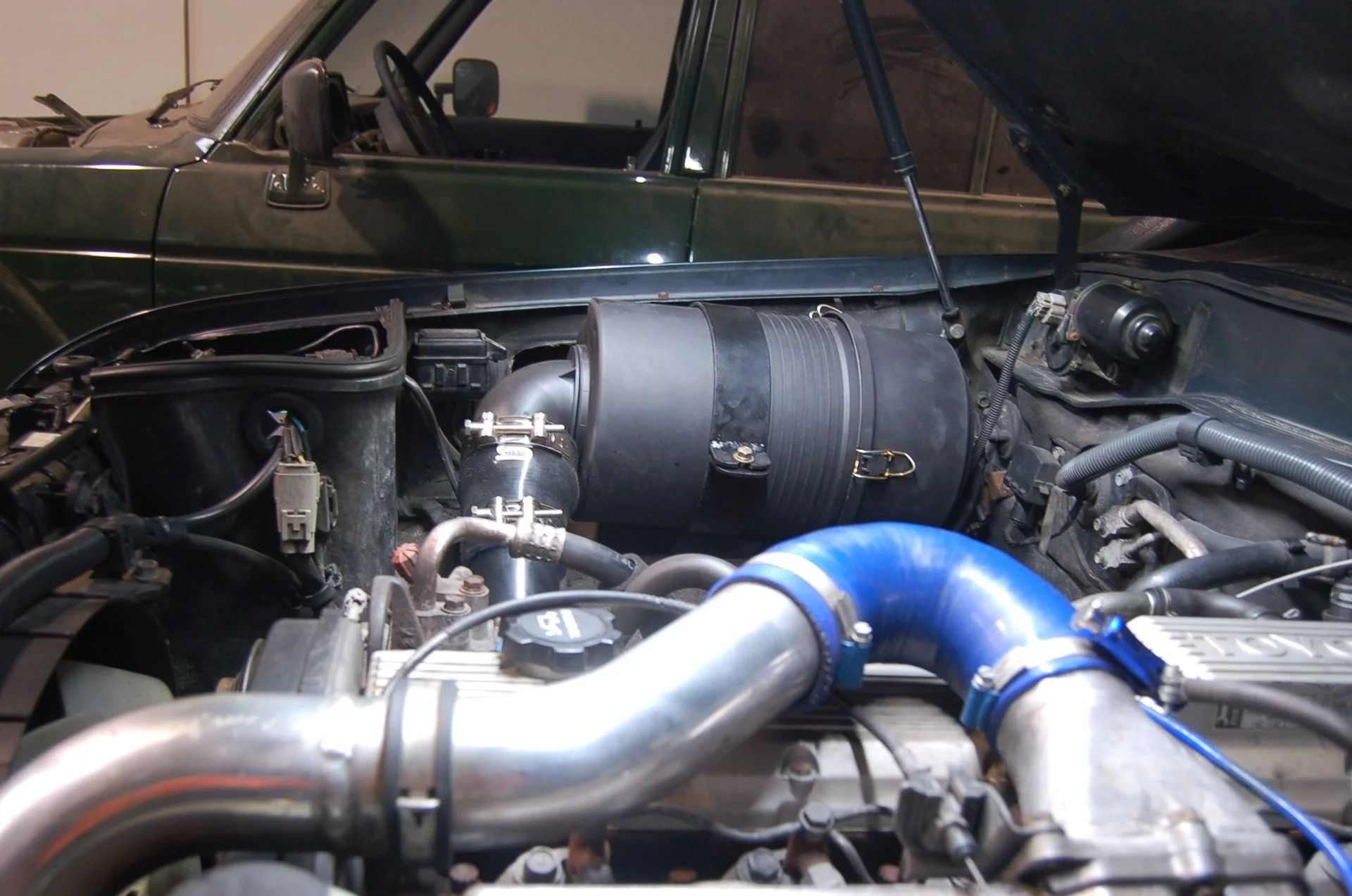

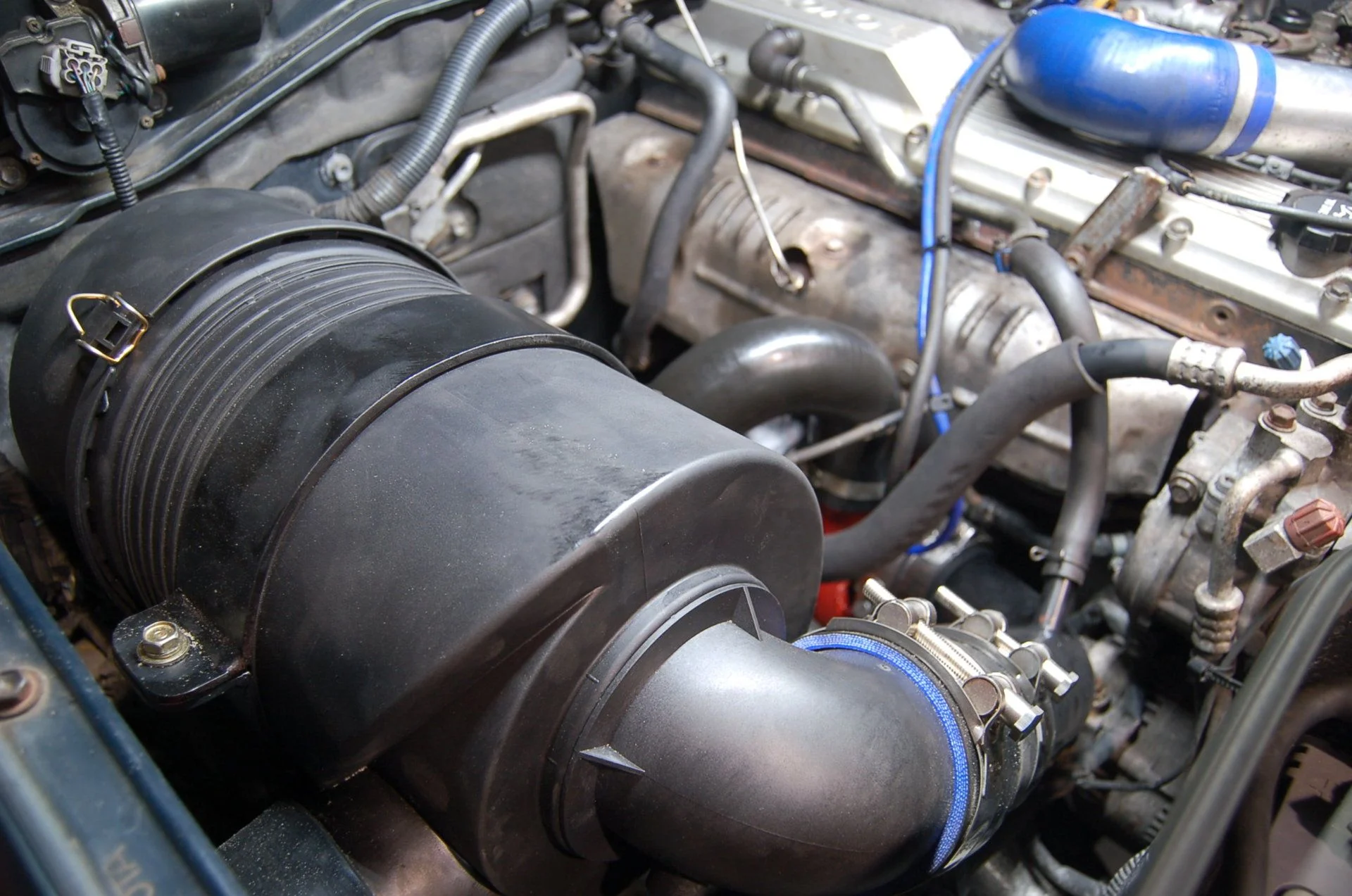

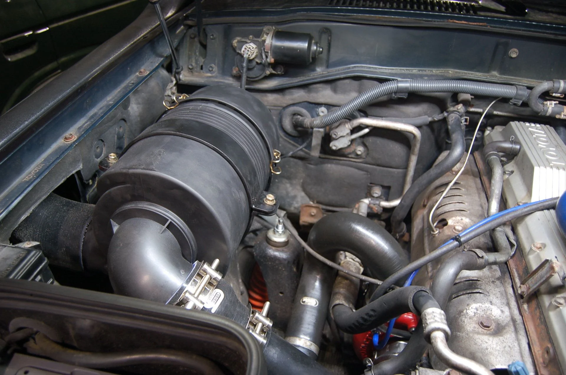

@remy when you disconnect the snorkel where does it draw the air from? Just from inside the engine compartment?

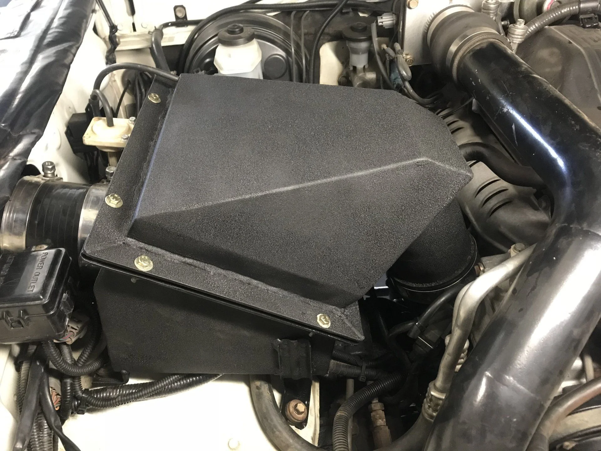

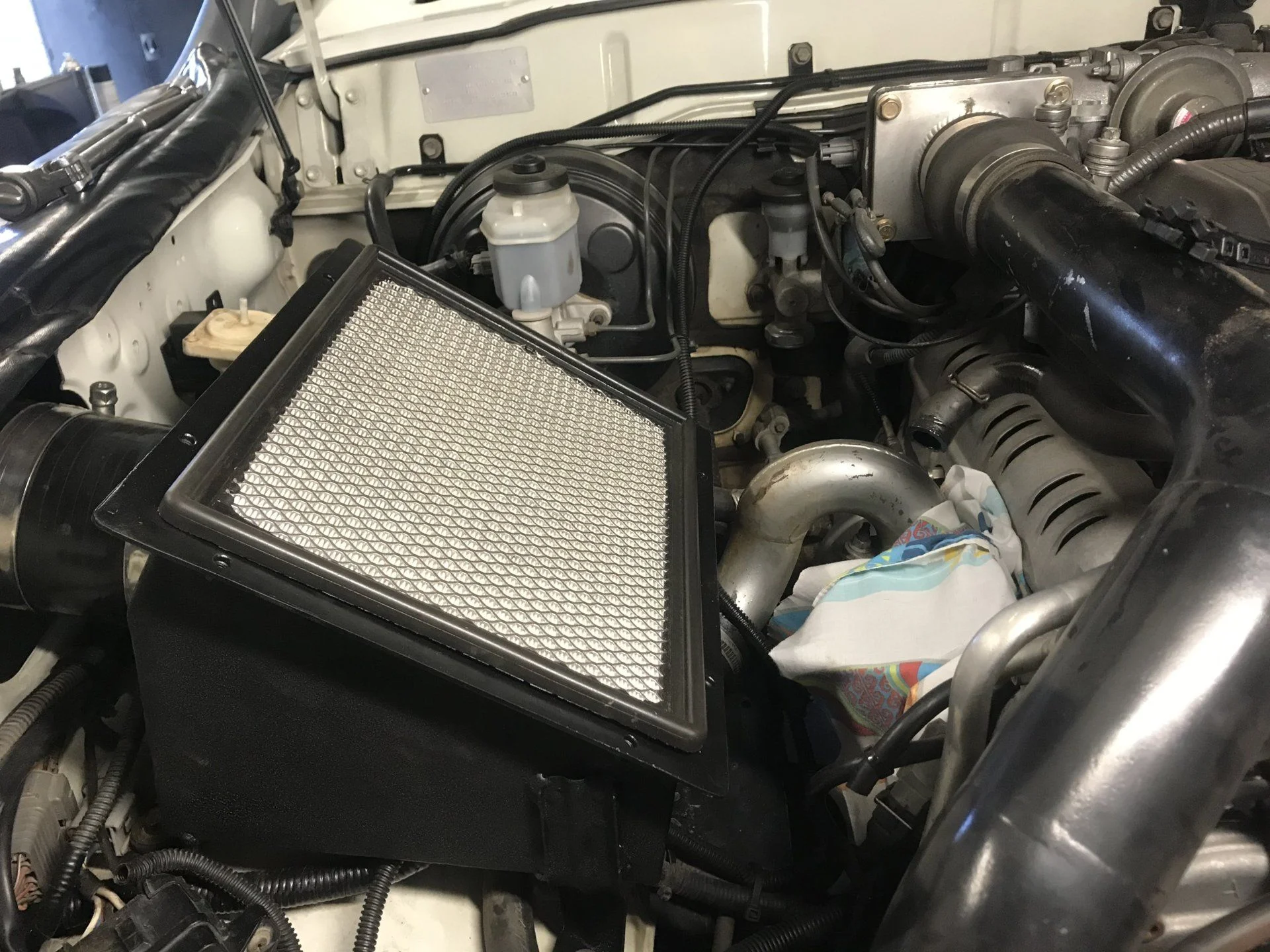

Fitted up new custom panel filter airbox using a duramax a/c delco filter.
Large bell mouth entry approximately 6” across face into 4” pipe and a silicone 90 bend 3'' into the turbo
Custom 4” bend out of safari snorkel into bottom feed of airbox.
Yes, that lid will fit but it's only 3". With the 4" inlet mod to the box and a 3" 95-97 fzj80 airbox lid, you will be just over the vacuum threshold. With our testing it only went under the threshold after we welded a 4" inlet pipe into the top of that lid.
tor with your air box having a 4 inch intake are you running a different than stock pipe to the turbo and are you using a different turbo than stock with your testing. i’m asking because the stock pipe coming out of the air box is only 3 inches at the box and 2.75 at the stock turbo. i would have thought this was maybe a source of restriction in the system unless your turbo had a larger intake. or is the vacuum created by the stock turbo (boosted of course) enough to need a 4 inch pipe into and the air box? maybe i’m overthinking it. just curious because i do have a safari snorkel and am trying to think of a design that’ll accommodate it when not in use but cap off for when necessary (and obviously needing less air at slow water crossing speeds). i still want to get as much air flow as i can. my turbo is a stock housing machined with a high flow wheel and i’m boosted up to 16 psi. i don’t think it’s breathing well through a temporary cone filter i have in place. thanks for your thoughts
With our testing, increasing the tube from intake to turbo decreased vacuum. We used two adapter hoses to go from 2.5" at the G-Turbo to 4" at the airbox. Then we can either use two separate 3" inlets at the box if you want to run a snorkel or a single 4" inlet
Well yes inside the fender where it should connect to the snokel. Did a dyno today and just remove the snorkel shifts almost the whole line by 200 rpm. Still got the same top hp with both runs though.(272) Didnt check with the standard airbox as it was to much work to change.
