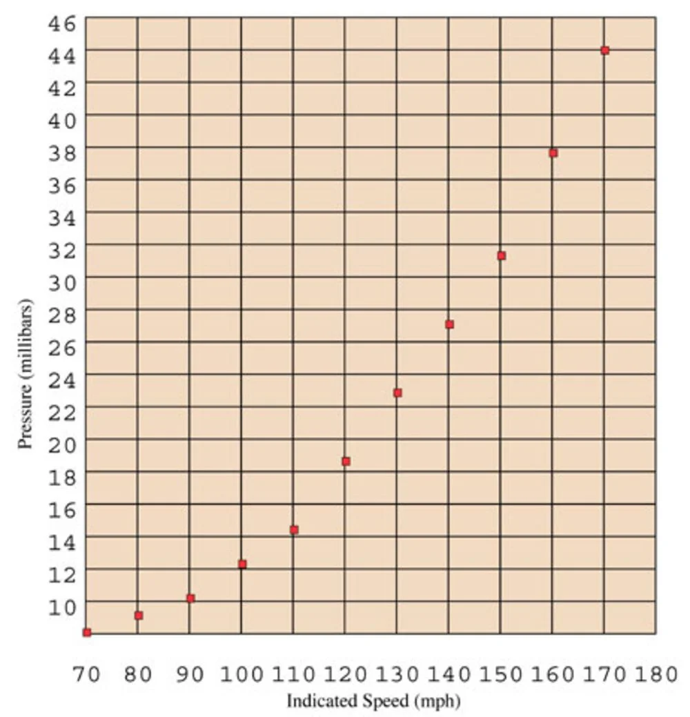

The motorcycle magazine Sport Rider had tested the ram air effect of a popular 900cc sport bike on a dyno that could simulate wind speeds to 150mph. The effect on pressure inside the airfilter housing was barely measurable until 60 mph but there was enough of a pressure increase to add 9hp at 150mph. Being that many of us travel around 60 mph there may be a small effect at the airbox from ram air induction or is it lost to the extra restriction caused by the 1.5 meters of pipe and 3 bends a snorkel adds to the intake piping as dougal mentioned. They did note the benefit of breathing cooler air which for us driving cruisers may be the only advantage for a snorkel. Crossing rivers aside.

Did they raise the post filter pressure above ambient? I could see lessening negative pressure but stacking pressure waves doesn't happen until you reach the speed of sound.
edit. Very sorry, apparently I dont know as much as I think I do. I shouldn't say ram effect is a myth, but for the average vehicle it is not a useful tool. After reading on a formula one site doing the tests you described it can have a beneficial effect but the design of the intake has to be a very specific shape and placed strategically on the vehicle and, as you stated, doesn't have a statistically significant effect until much higher speeds than I drive.

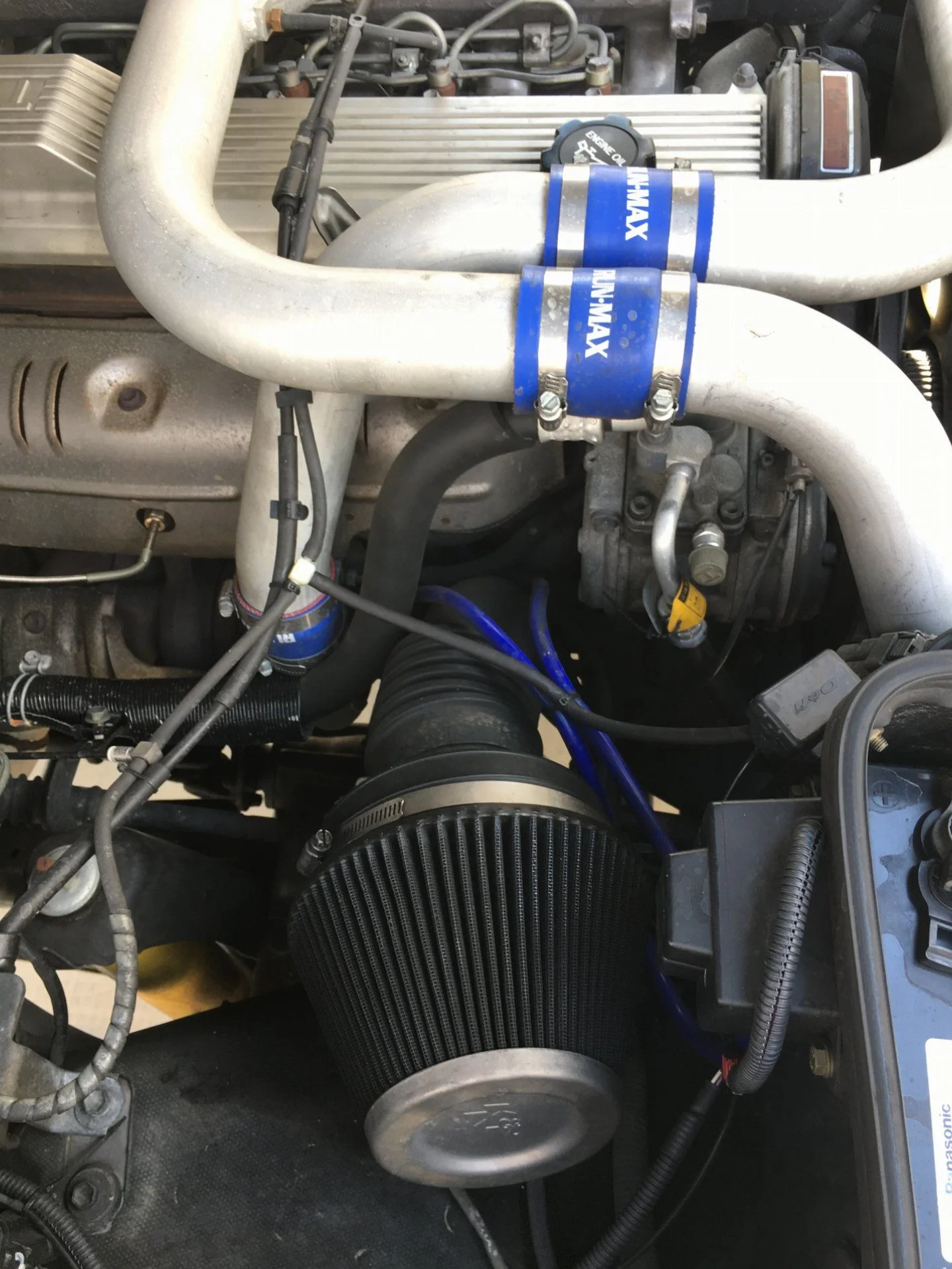

Got any pics of the intake that's on it?

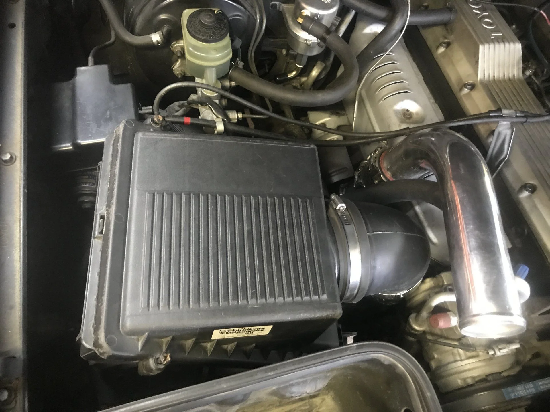

Finally got around to taking some pictures. I feel like this is just sucking up hot engine air. Just noticed too that the PO drilled a nickel sized hole into the backside of the filter....
I'm thinking custom air box and snorkel...any inputs?
