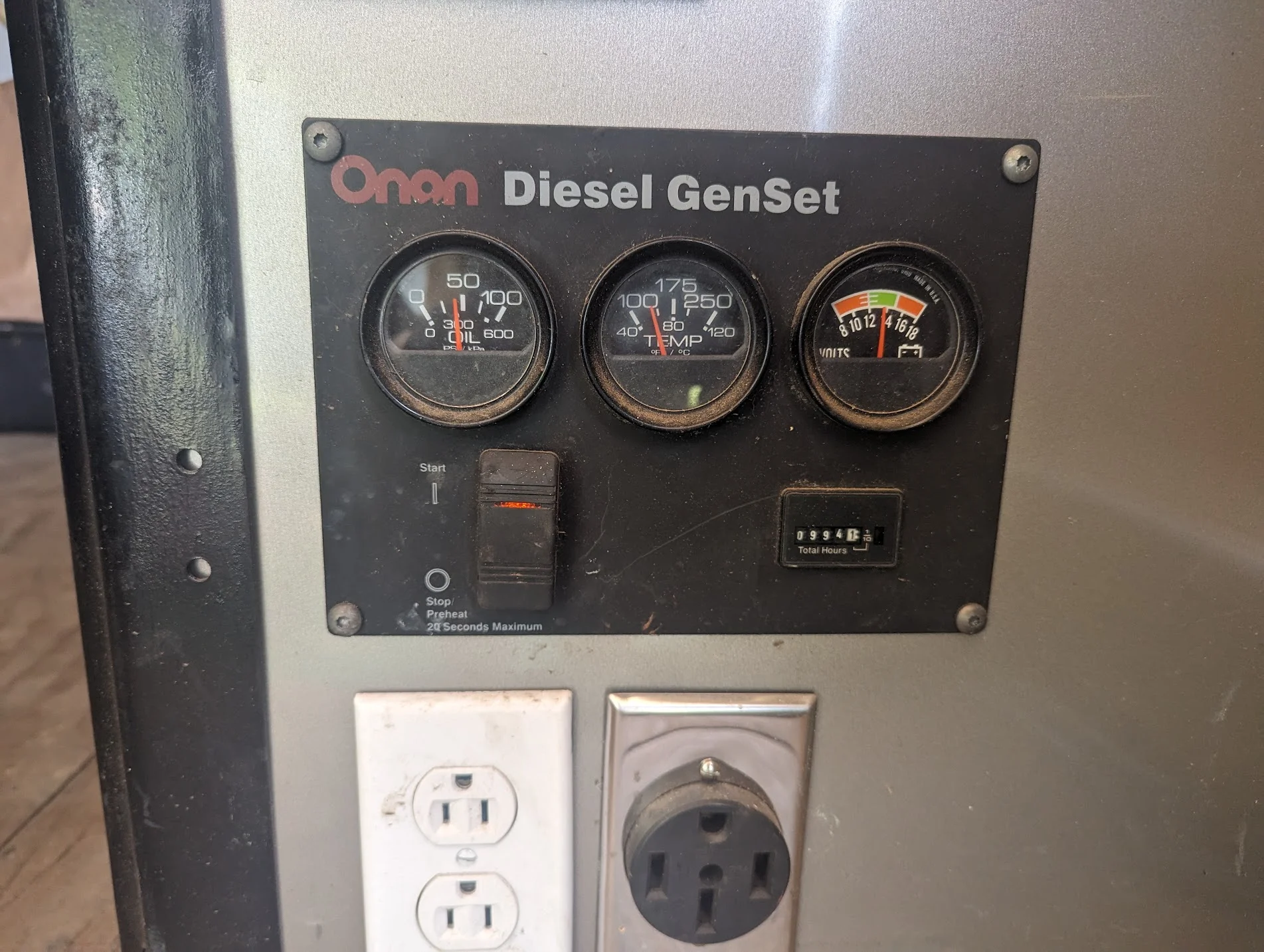

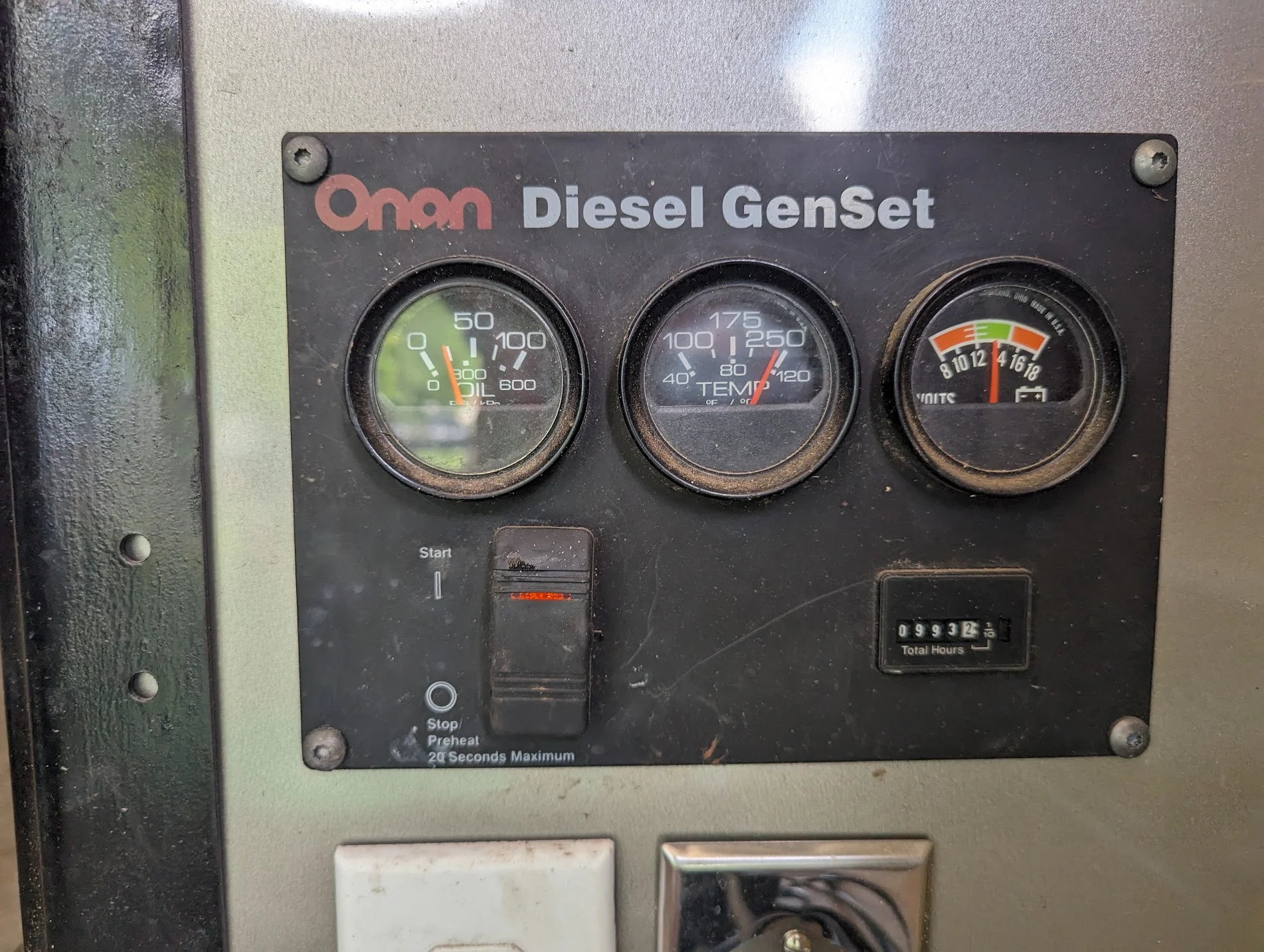

GSMTR!! Got there fired up the genny and she was overheating, losing oil pressure:
Changed the oil with T6 and added coolant (50/50 zxed-1 and water) and she was fixed. To clarify, oil change because I had never changed the oil, but that didn't fix the overheating issue (duh). There was no detectable coolant in the radiator cap tube somehow. This pic is after running for a few hours, it is running much cooler now somehow.

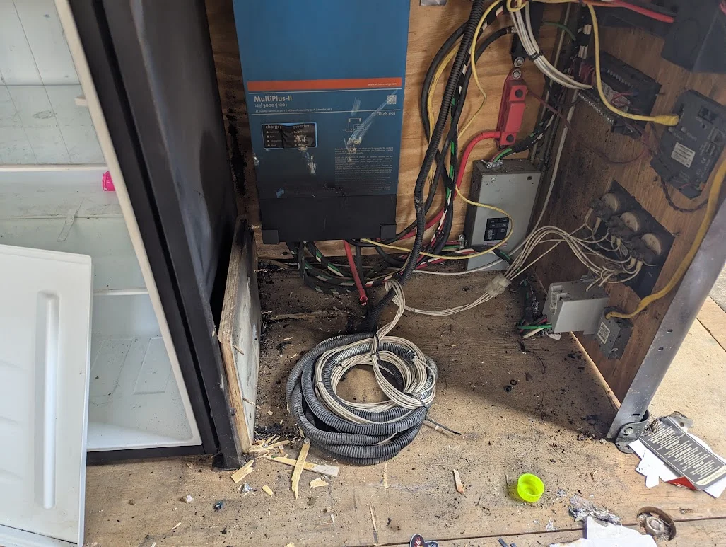

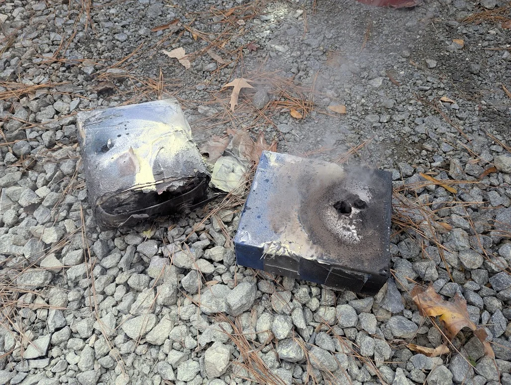

Yesterday was exciting for all the wrong reasons. This post will document what happened and what I did. Next post will document what I think caused it, the mistakes I made, and what needs to happen next, to prevent this from happening again.
Inverter has been off for the past few weeks, just because I haven't been using it. Didn't think a ton of it (mistake #1)
I clicked on the inverter to get things going (plugged into shore power) so that I could winterize it. Inverter said low battery, and generally it won't kick on when that happens, so I walked in the house to grab my phone. Came back out, heard a bang, thought my neighbor dropped something next door, but nope, turns out one or two of the cells in my LiFePO4 (LFP in modern speak) blew up. A fire then grew. Didn't have a fire extinguisher immediately next to the electronics (mistake #2) so I grabbed a pickaxe that was closeby and tore the batteries out. Had to pry against the *very expensive* inverter case to get it out (mistake #3).

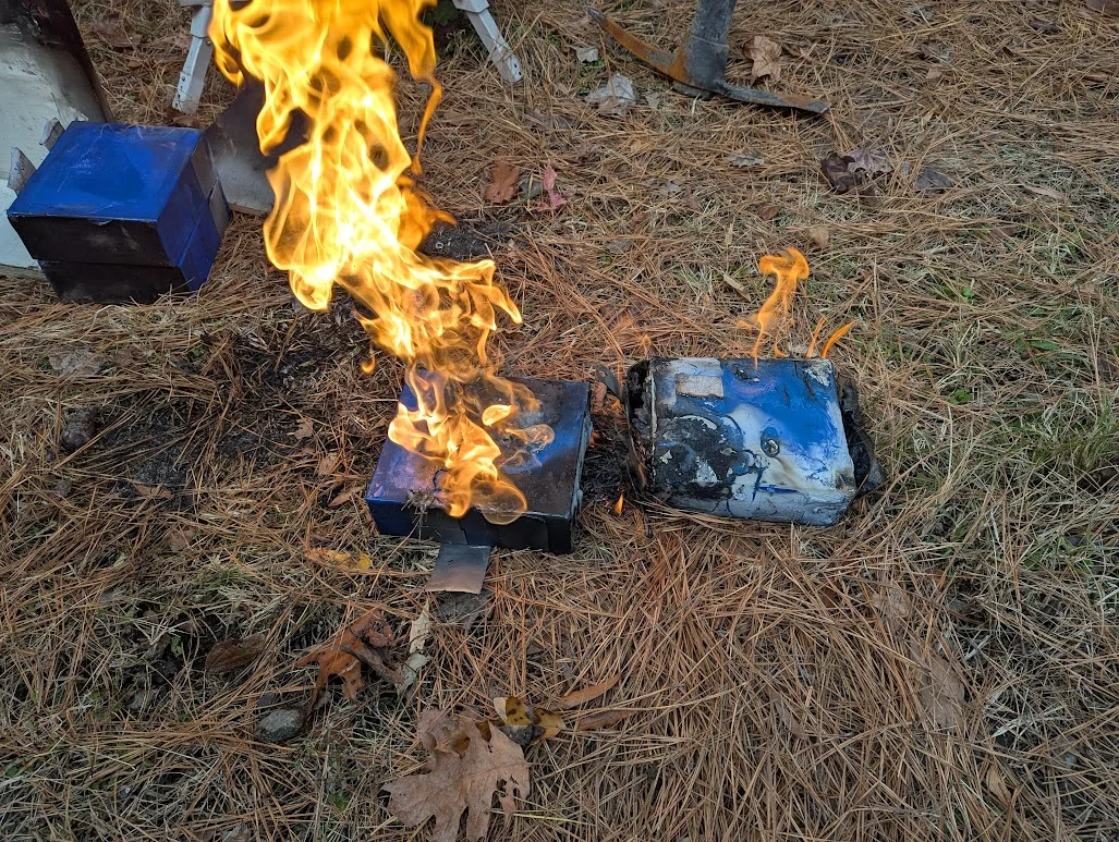

Cell #1 blew up completely and spread it's black bull**** everywhere inside the electronics cabinet (very stinky). Cell #2 swelled up like a mfer. Cells 3 and 4 got a little scorched but didn't puke.
Since they were ****ed anyway, I took the pickaxe to them to burn off whatever is coming out. Was freaking out a little bit, and figured if I got htem to burn when I was paying attention to them, that was best. Made for a good pic, but not sure i'd make that same decision again.

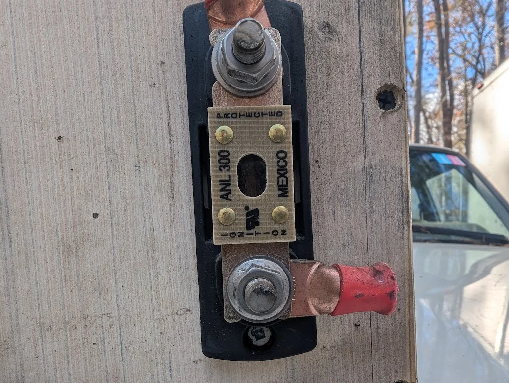

Of note, the ANL fuse protecting the batteries did *not* blow, so this was not a dead short situation. Kinda hard to see, but trust me, it's not blown.
Charred remains:
Plywood battery box lid (mistake #4)
Now, what the actual **** happened here.
LiFePO4 (LFP) batteries aren't as flammable as other Lithium battery chemistries, primarily because they're not self-igniting, and secondarily because they aren't self-oxygenating. These things I knew. Biggest issue you can have is that if a battery blows up, the LFP battery will vent. I also knew this. What I didn't know, is that *when* a LFP battery vents, that vented gas from the LFP battery *is itself flammable*. This is a pretty ****in important detail that I did not previously know. Reference below. Do your own research:
So, let's get into what went wrong.
Ever since I had this battery array in the trailer I had one cell that was marginal. Meaning, it didn't have the measured capacity of the others, and in general brought down the whole pack, via BMS protection, because it would get close to overvoltage, or hit undervoltage, before the rest. Not a big deal, that's why the bms is there right. Well, if a LFP battery is left in the undercharged state for too long, it can fail and offgas. Also, if it gets too cold and is attempted to be charged or discharged, it can also offgas. This is important.
Mistake #1. I left the inverter off for a few days / week, and it's been below freezing for the first time this year. Can't do that. I know the pack was in a protection state when I clicked on the inverter, because the inverter told me *low battery*. So, don't leave them to discharge all the way in the winter, that was dumb.
Mistake #2. I didn't have a fire extinguisher *immediately* next to the batteries. I didn't think that fire was a concern, but that was, in hindsight, ****in dumb. Always have a fire extinguisher right next to your electronics, one rated for electronics fires.
Mistake #3. The battery box was right next to the inverter. This was the biggest mistake I think.
Remember when I said that the LFP produces flammable gas when they fail and offgas? Right, well having the battery next to an inverter that has large contactors within it is ****in stupid. What I think happened is that at some point over the past few days/weeks, the battery failed and started to offgas. There's not a ton of ventilation in that area, so I assume this flammable gas was building up. When I clicked on the inverter, it didn't blow up immediately, but what I would bet happened is that one of the contactors switched on to try to charge the battery, and the tiny arc from that (inside the inverter case) was enough to ignite the flammable gas from the LFP. This flame front traveled up into the battery that had failed and caused it to blow up, blowing apart the plywood battery box.
Mistake #4. The flame at first was so small that it took me 10 seconds or so to realize it was on fire, but between that time and the time it took me to find a ****ing extinguisher / tool, the plywood lit on fire. The plywood fire is what caused most of the soot and scorching.
So, ****. What are we going to do about it, and what should I take away from this?
First of all, don't put your LFP batteries in wooden boxes.
Second, keep your LFP batteries away from ignition sources.
Third, keep electronics rated extinguishers next to your batteries, no matter the chemistry. Lithium rated extinguishers for lithium.
Wanted to share my experience. I'm going to have a rethink of my layout to deal with these new problems. I'm a bit rattled, but thankfully I was there when this happened, instead of my camper burning to the ground for me.
Be safe out there.
Lucky you were there and caught it very quickly, It could have been extremely bad. Even though the new battery is sealed I would build a sealed metal battery box with a external vent.
I am getting a little defensive here, because people don't seem to understand what happened. I'll boil it down more.
All wire protections that I had in place still work, none of them failed.
No wires were burnt. Not one, other than the bms balance leads that were on top of the batteries, because one cell was on fire (duh). The bms itself, which was outside the battery box, didn't heat up at all (no insulation melted off anywhere), and appears functional.
Inverters have things called contractors and switches in them. They're not always sealed (waterproof) like the contractors for your winch are because who would subject your $2000 inverter to water. The breakers in your house also arc when you switch them on or off, FYI, you just can't usually see it.
A tiny switching arc from an inverter in normal operation is enough to ignite a flammable gas at the right stoich ratio.
To summarize my lengthy posts:
1. When I bought the cheap grade B cells, one was way crappier than the others. It has fought me for years. I probably should have replaced that cell two years ago.
2. It must have been venting/offgassing when I switched on the inverter, meaning it finally kicked the bucket, maybe due to cold weather, maybe not. It has been cold, but I haven't been in there in a few weeks (it was warm a few weeks ago).
3. An arc from the inverter must have ignited the gas from that one cell which blew it and some other things apart.
4. The small battery fire caught my plywood battery box on fire, which is when it became much worse.
Summarizing even more:
One of my lfp battery cells failed, because it was cheap, the gas from which was ignited by an electrical arc from (I assume) inside the inverter enclosure, which then caught my plywood battery box on fire.
None of my 3.5 year old wiring failed, just a single lfp cell.
Steps to fix:
Higher quality battery from the start.
Sealed box for it to live in.
Store it away from ignition sources such as inverters.
Possibly stick it in a fireproof box.

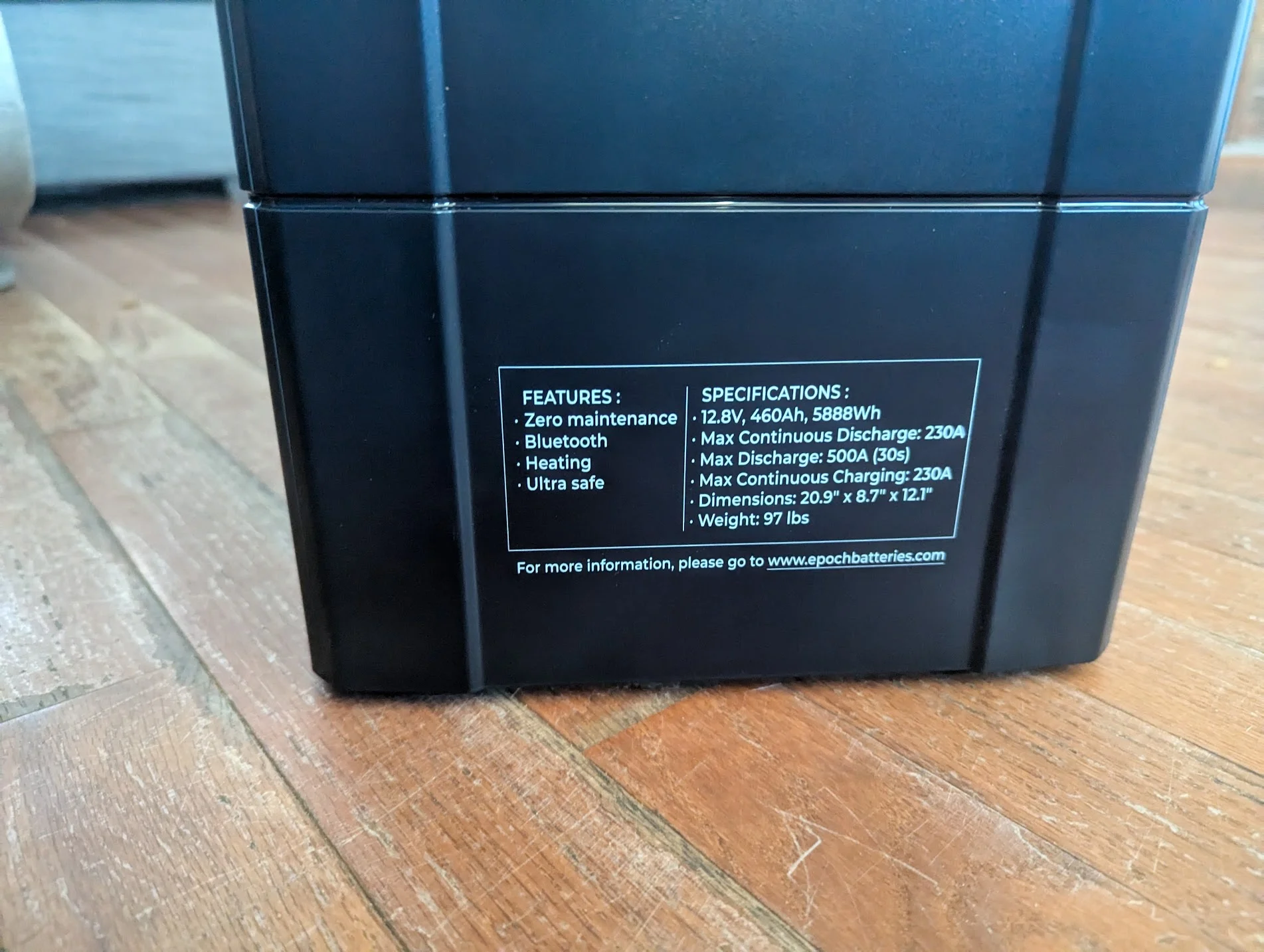

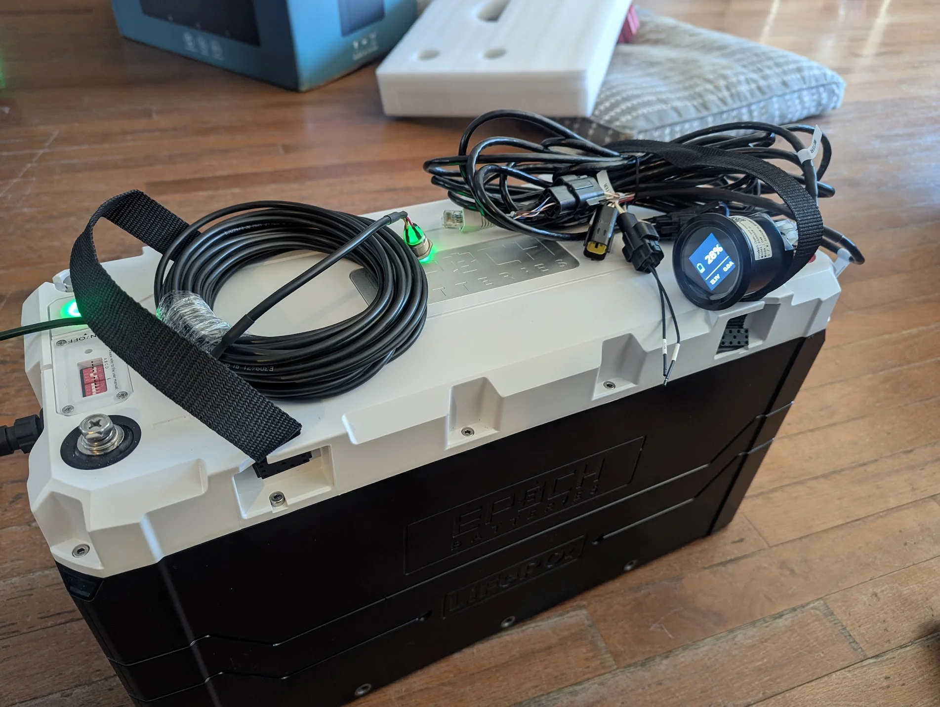

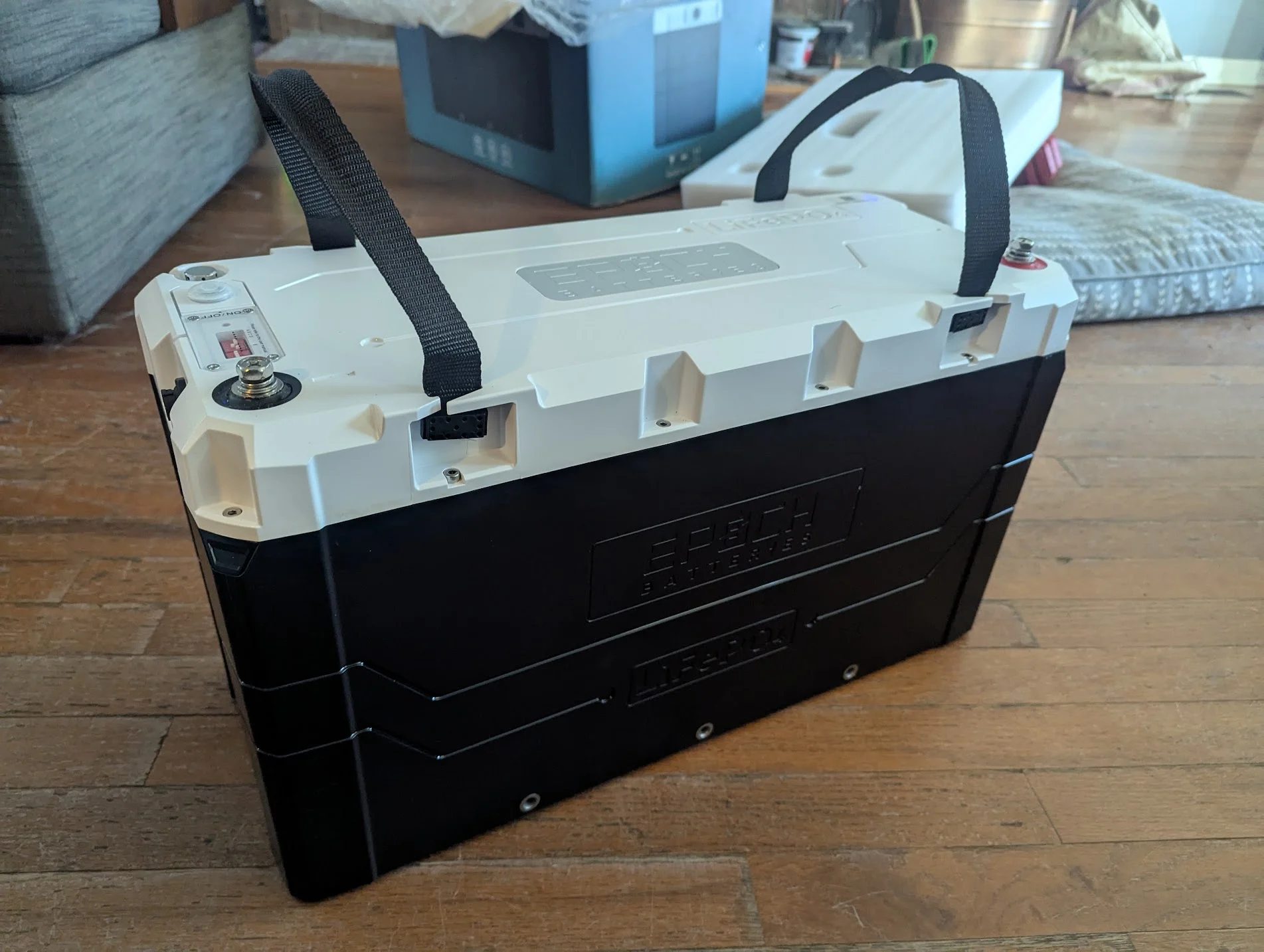

New battery arrived today! Will get to play with it soon.
97lbs and 460ah of capacity, which equals almost 6kwh of storage at nominal voltage. Hell yeah.
Came with remote power button and SOC meter as well. SOC meter enables bluetooth directly to the battery, which is super duper neat. It will integrate with the rest of my victron system as well.
Now to figure out where to mount it...
