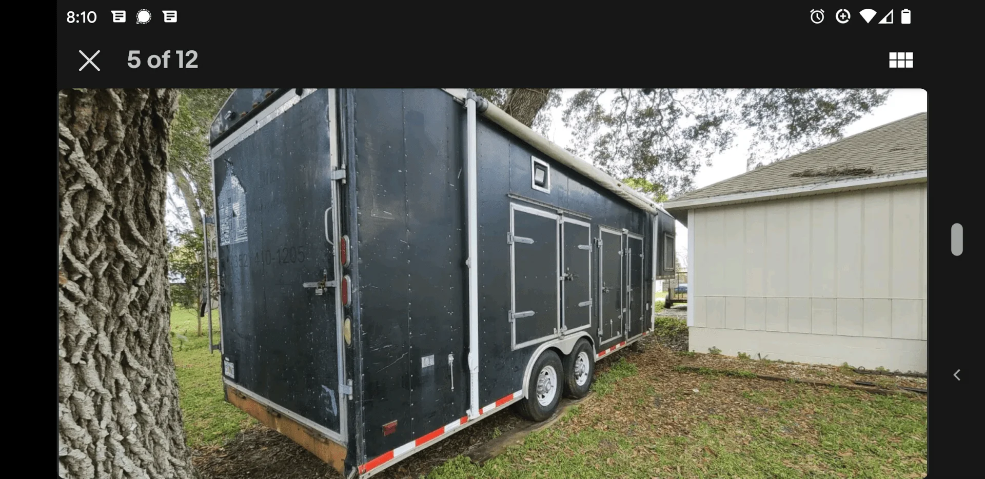

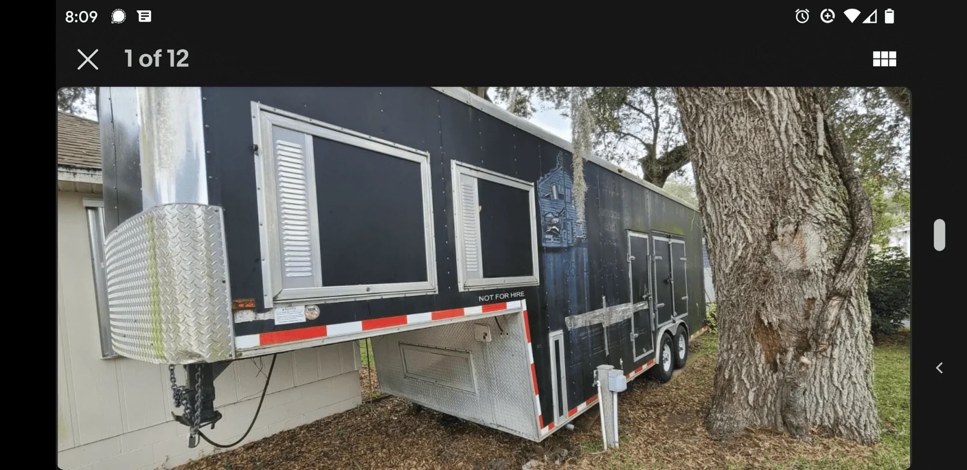

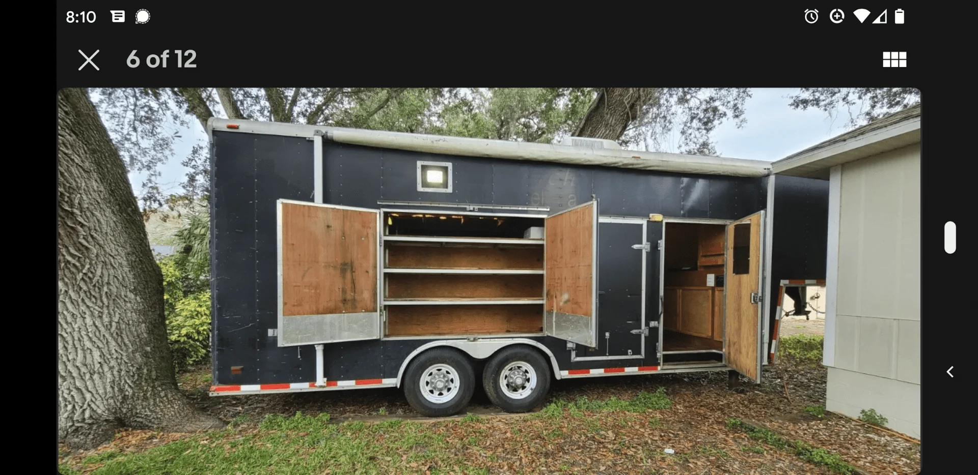

I had found an enclosed gooseneck in Wisconsin that I liked, but after talking/texting with the guy a few times, he ghosted me and deleted the for-sale ad. Searched around for a few more weeks and found this enclosed gooseneck on Ebay in Daytona Beach, FL. These are pics from the ad:

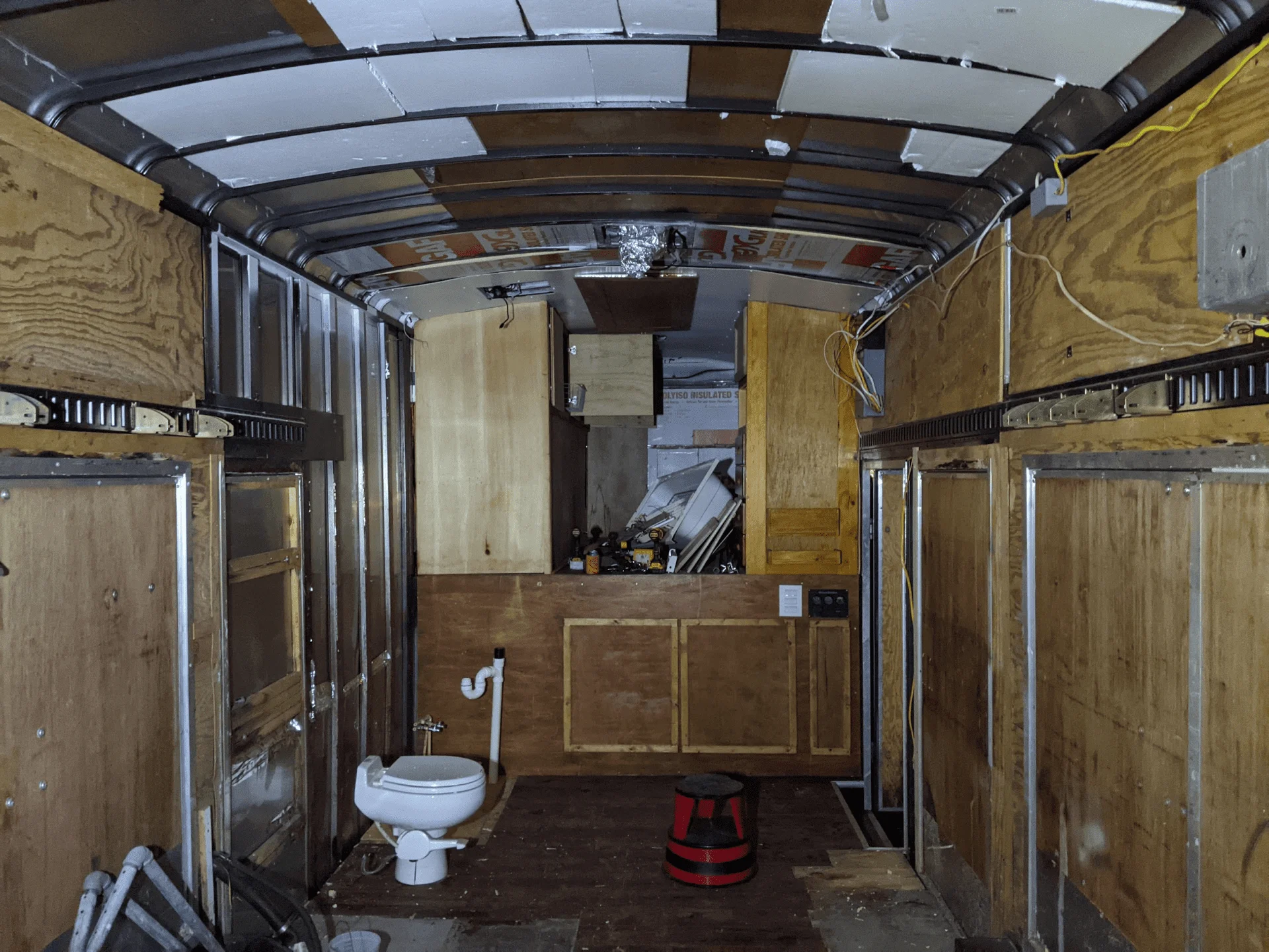

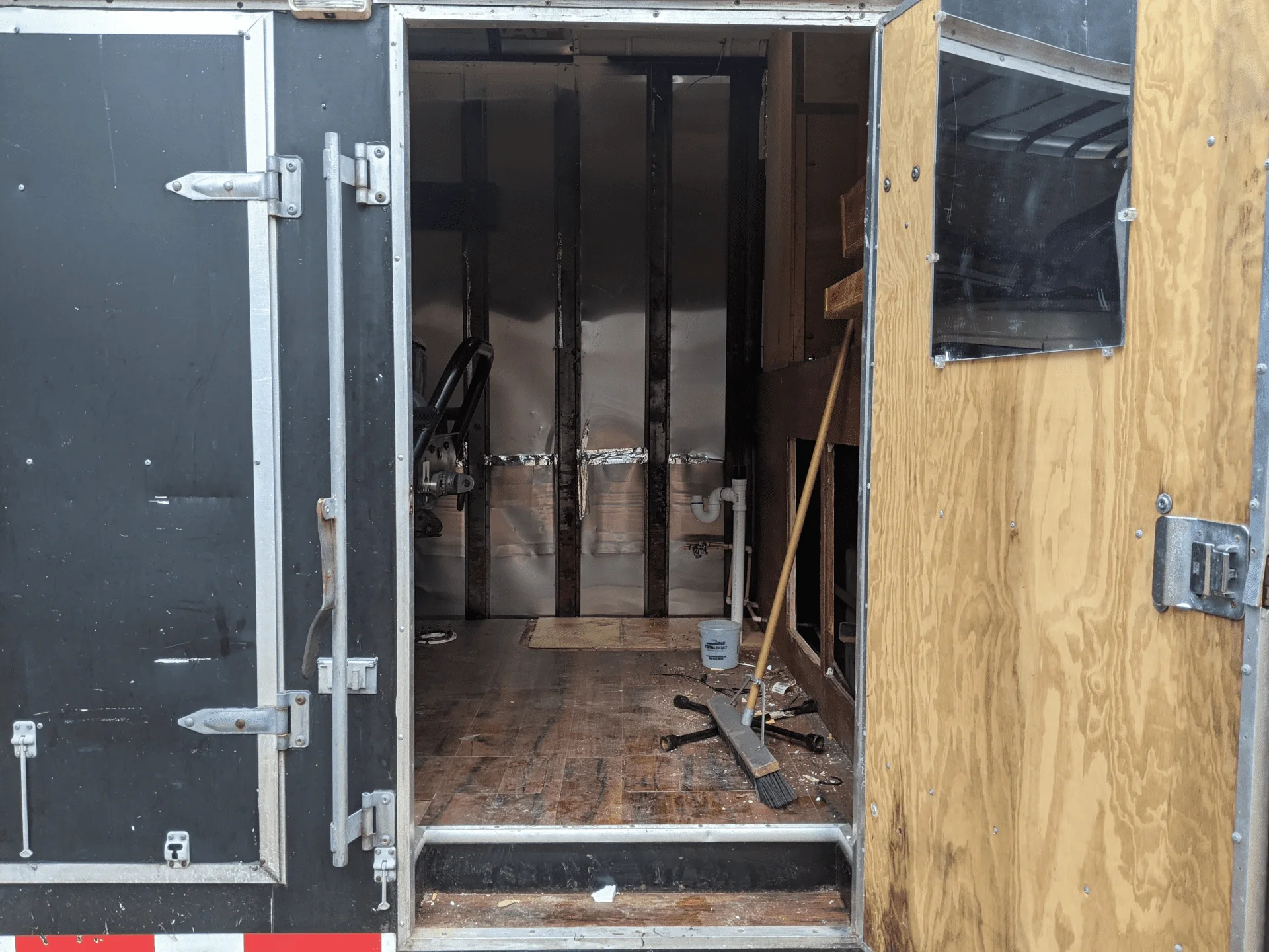

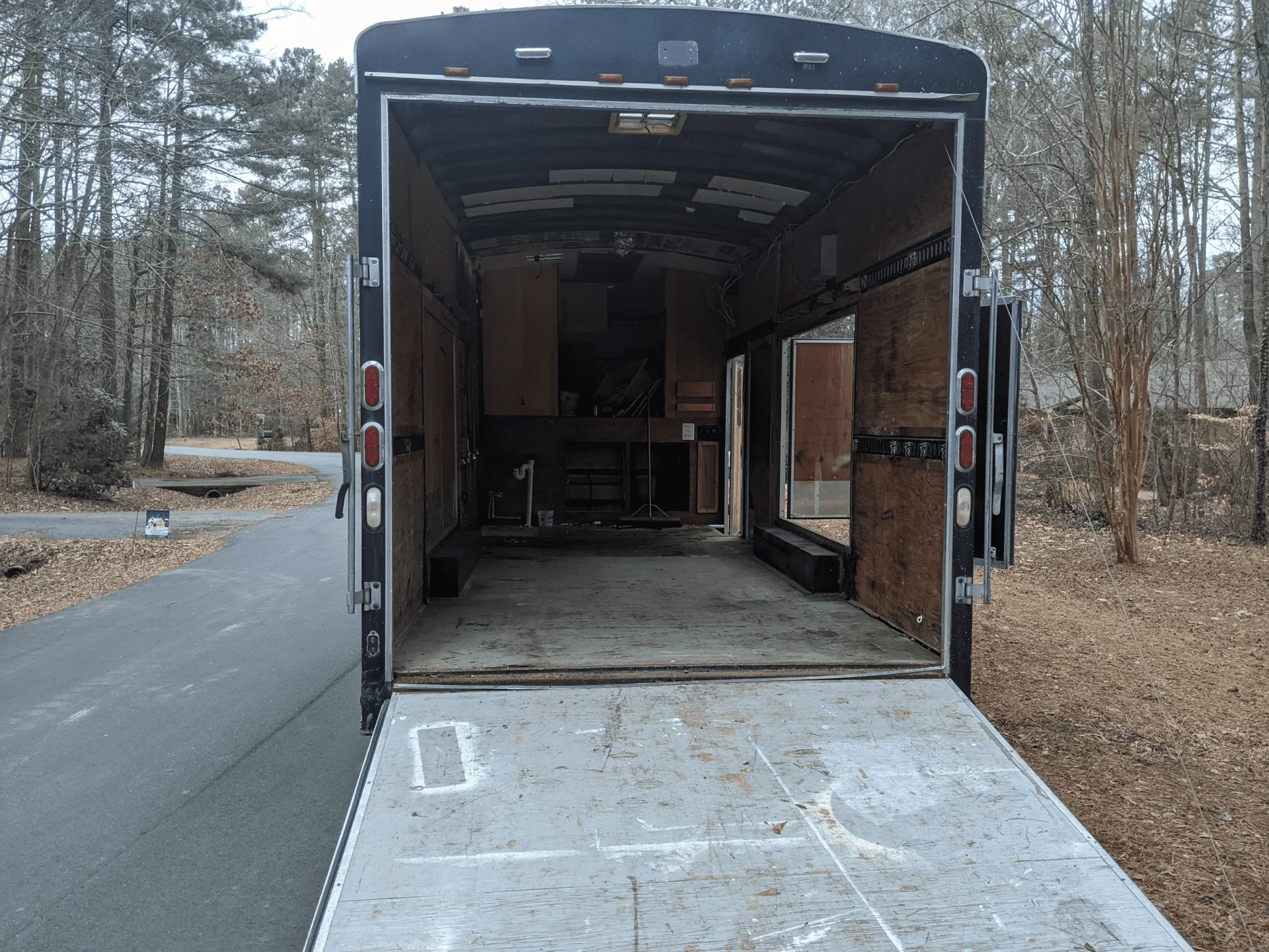

He had it backed up to a tree, so there are no good pictures of the layout, and the pictures are disorienting. This is a picture from the ramp door looking forward:

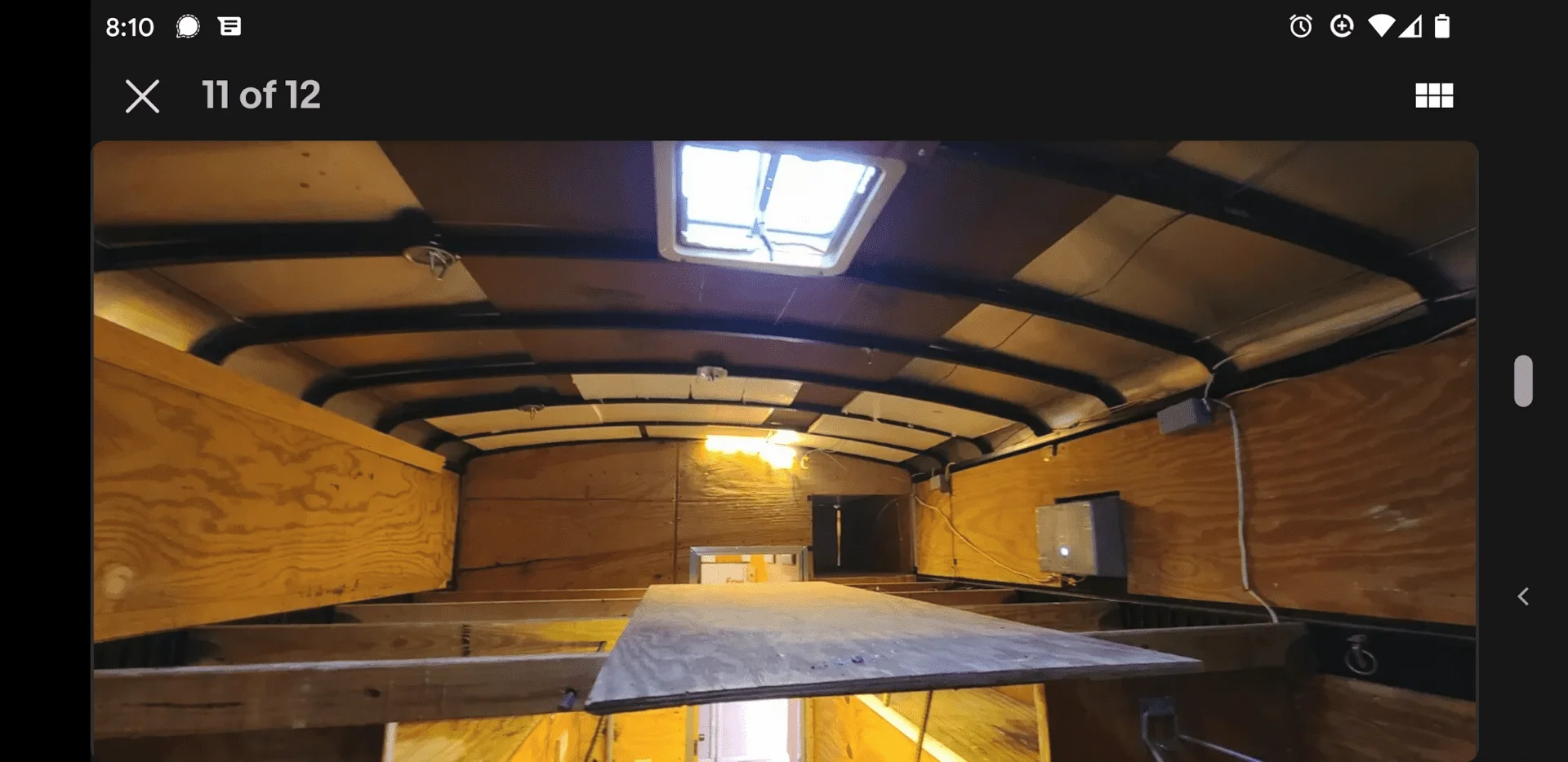

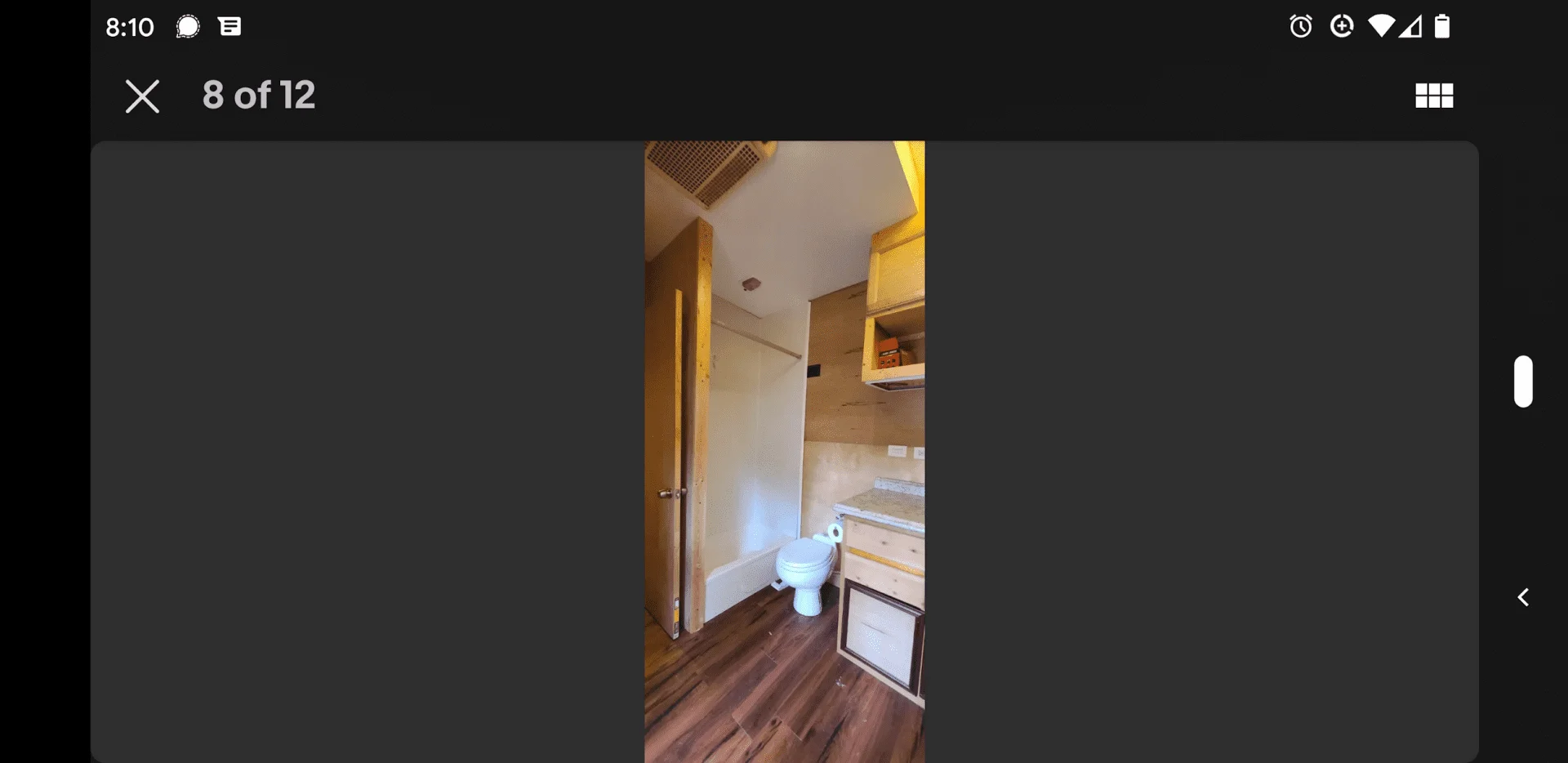

And of the camper section forward of that partition wall:

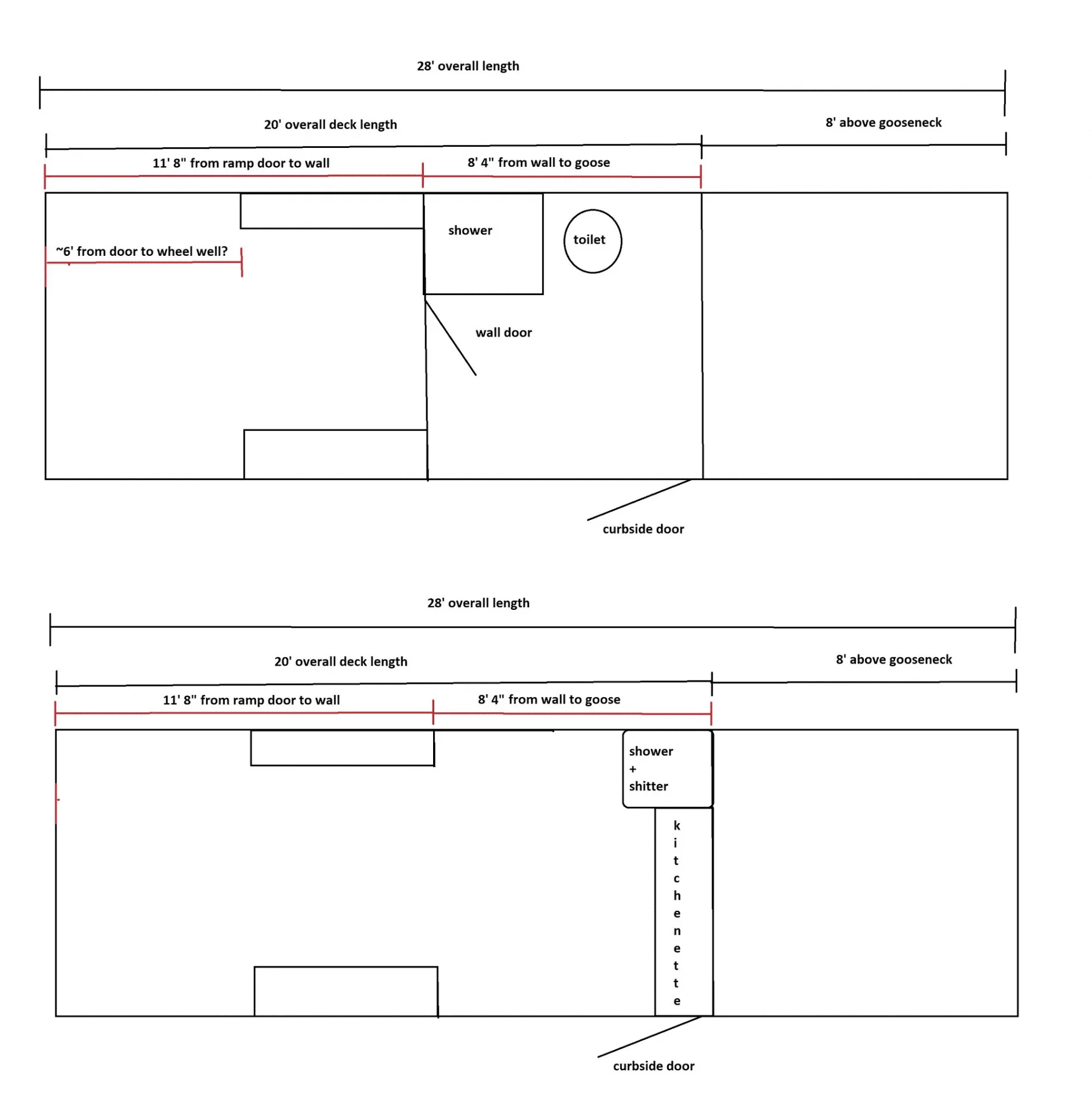

The original layout is roughly shown with the top portion of this mspaint picture. The bottom is what our goal is.

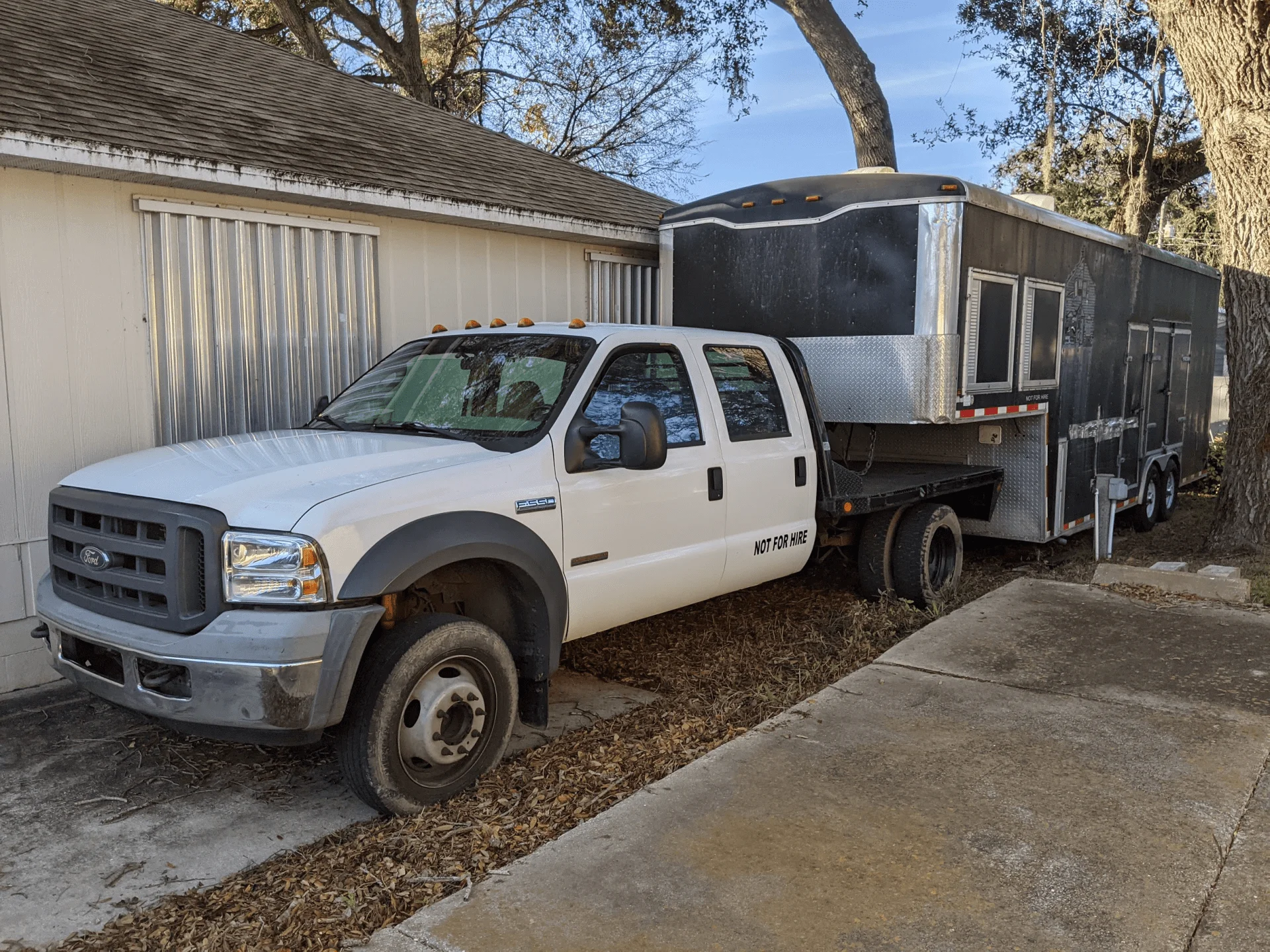

So, @SFROMAN , Rick and I went down to Daytona Beach Friday night, grabbed a hotel, and picked up the trailer Saturday morning before 8am. Cost was $8k, and comes with a Onan 6k DIESEL generator, 15k btu AC/heat rooftop unit, large awning, full RV plumbing system with dump on the proper side (driver's side), full 12v and 120v systems with shore hookups for water and electricity.
Trailer is a 2006 Haulmark enclosed, that this guy special ordered new in 2006. He had it outfitted for working with his general contracting business with side doors for tools, racks in the back for material and ladders, then the camper section for guys to (i guess?) live at the worksite. Generator was used as temporary power in new construction situations where power was otherwise not available. ~28' overall length, tandem 7k axles, ~8' height inside not including the dome roof, ~9.5' long goose. Pretty damn neat!!

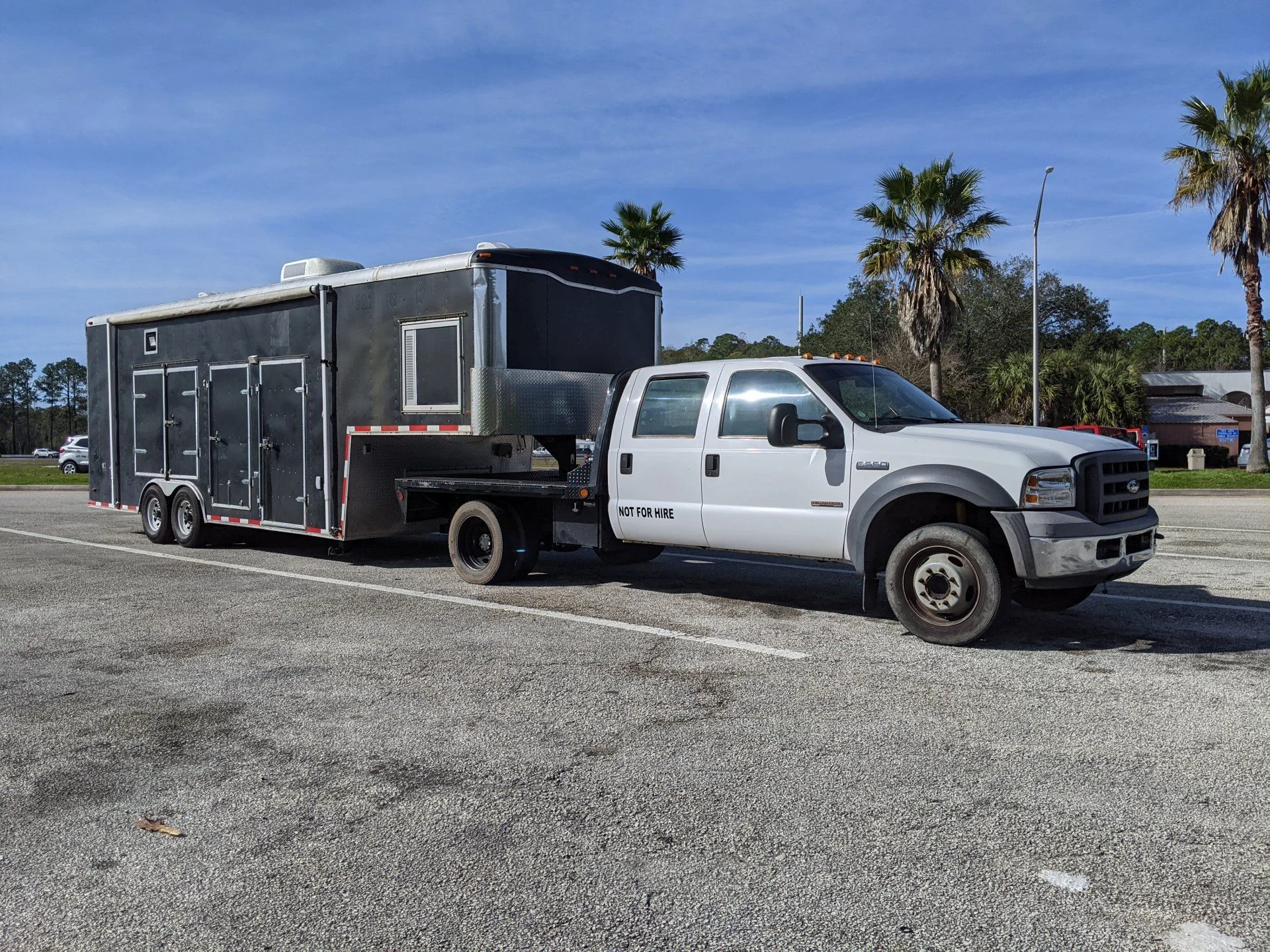

This trailer had been sitting in this spot for ~2 years, so we came down equipped with some tools, a grease gun, and a tire repair kit. Checked the lug nuts, greased the bearings (via bearing buddies) stuck a plug in the spare :lol:, aired it all up and hit the road. One of the four tires is pretty dry rotted, but surprisingly it held for the whole trip.
First stop after about an hour of driving was to check the sidewall temps and bearing temps, to see if anything was getting ready to blow. Everything checked out:
Continued on. Scaled out right at 20k gross, which is a little nuts considering my ferd weighs about 9500# with us in it. Got a shade over 10mpg towing this back home.

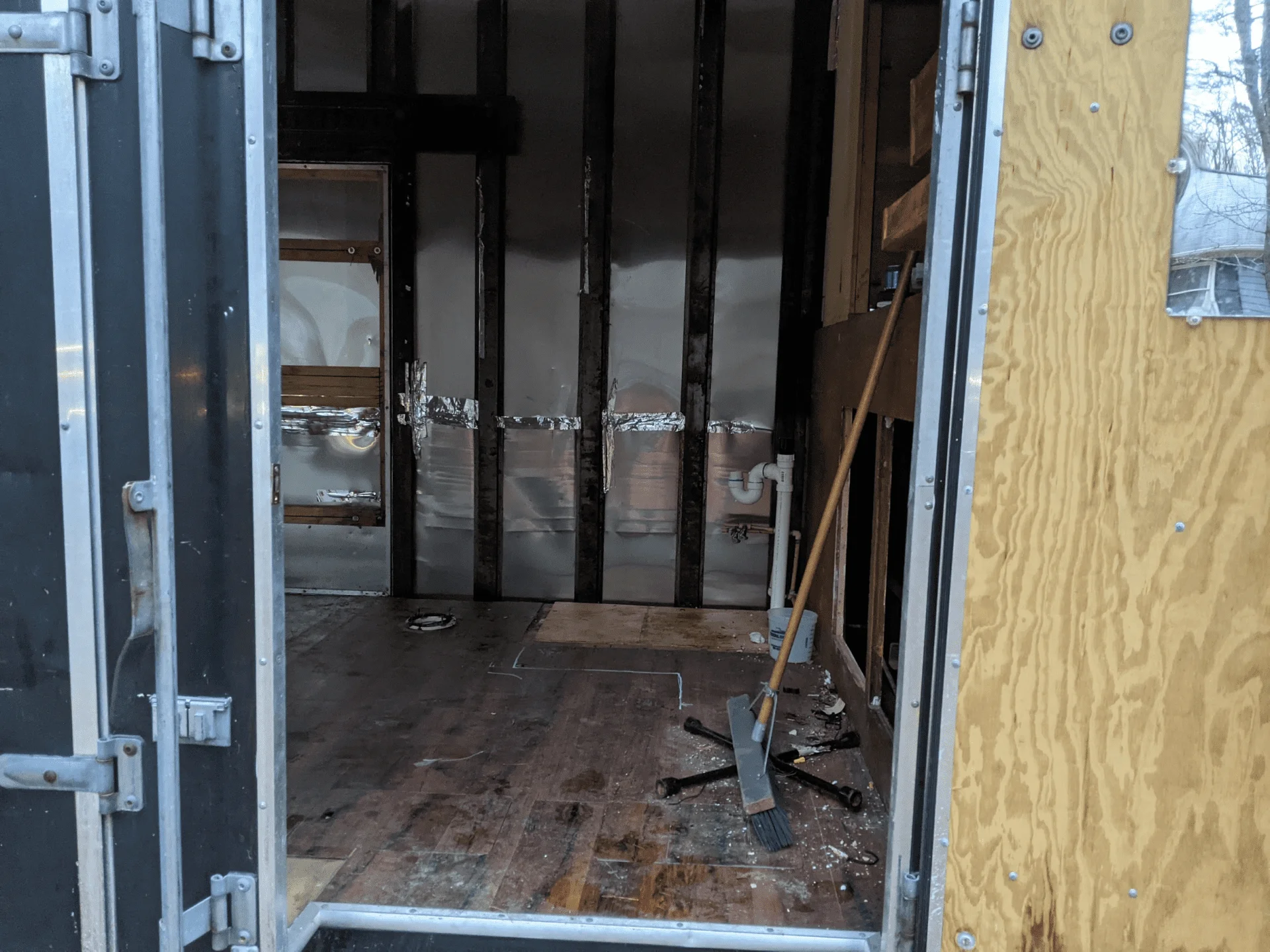

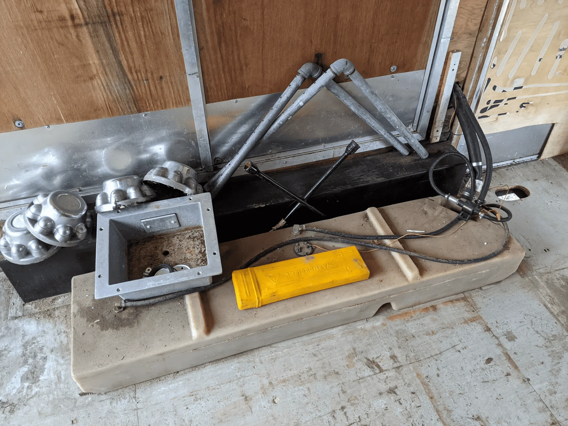

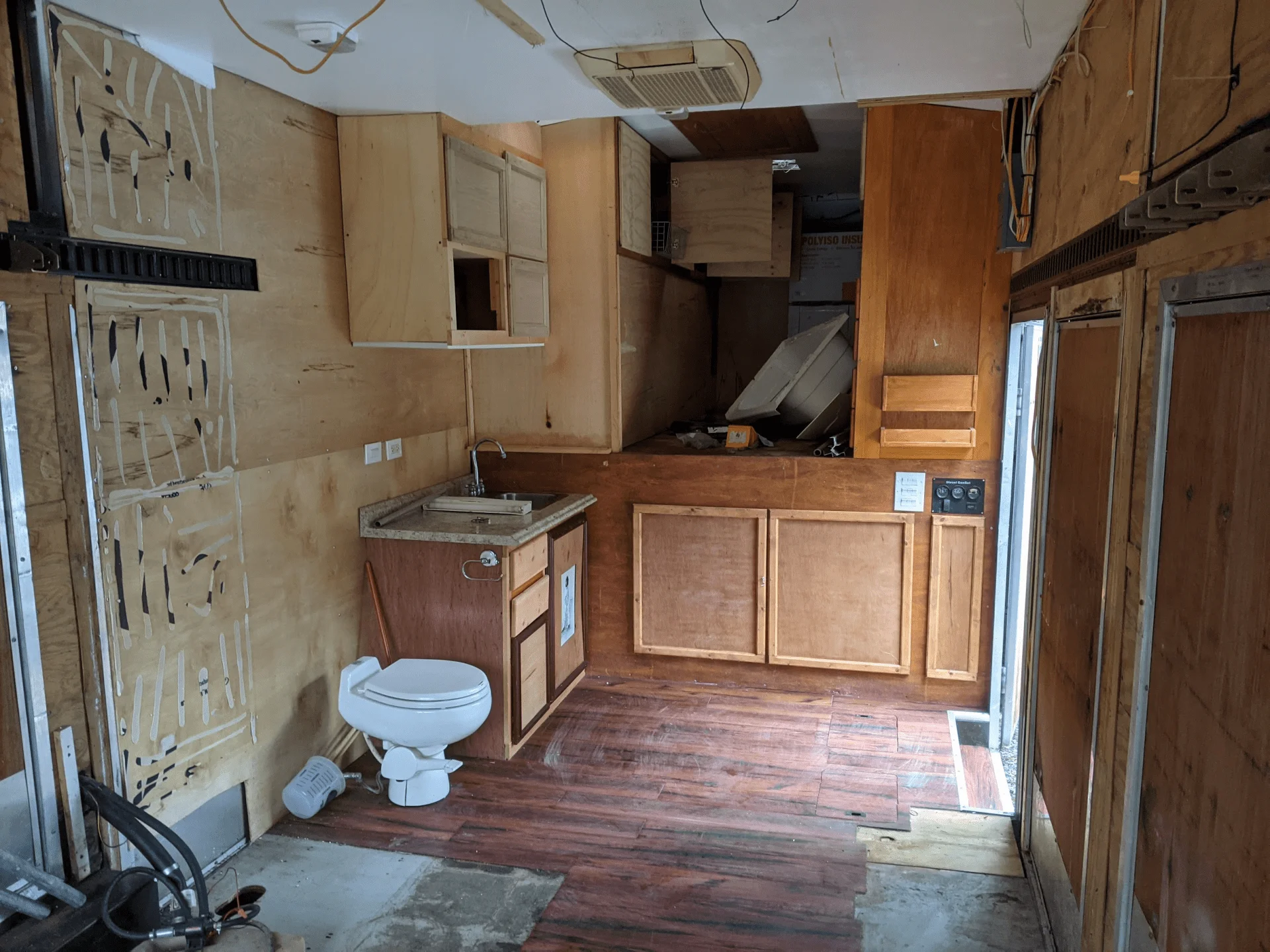

To start us off, Laura and I gutted the trailer yesterday afternoon. Was pretty easy to do, and everything appears to be in really good shape.
Current fuel tank+pump for Onan generator that's up in the goose, along with some misc stuff from clean-up.
Next up, I'll get the onan generator running to test it out, so that I can remove and sell it. Anything 110v I need in this trailer will be powered via my Honda 2200i and/or shore power.
After that, Moonshine test fit :D
Nice toy hauler, for some reason you don't see many of them around on the east coast.
Looks like a great starting point for the build.
She's almost fully emptied out. Will have some more to do, but for now it's good.

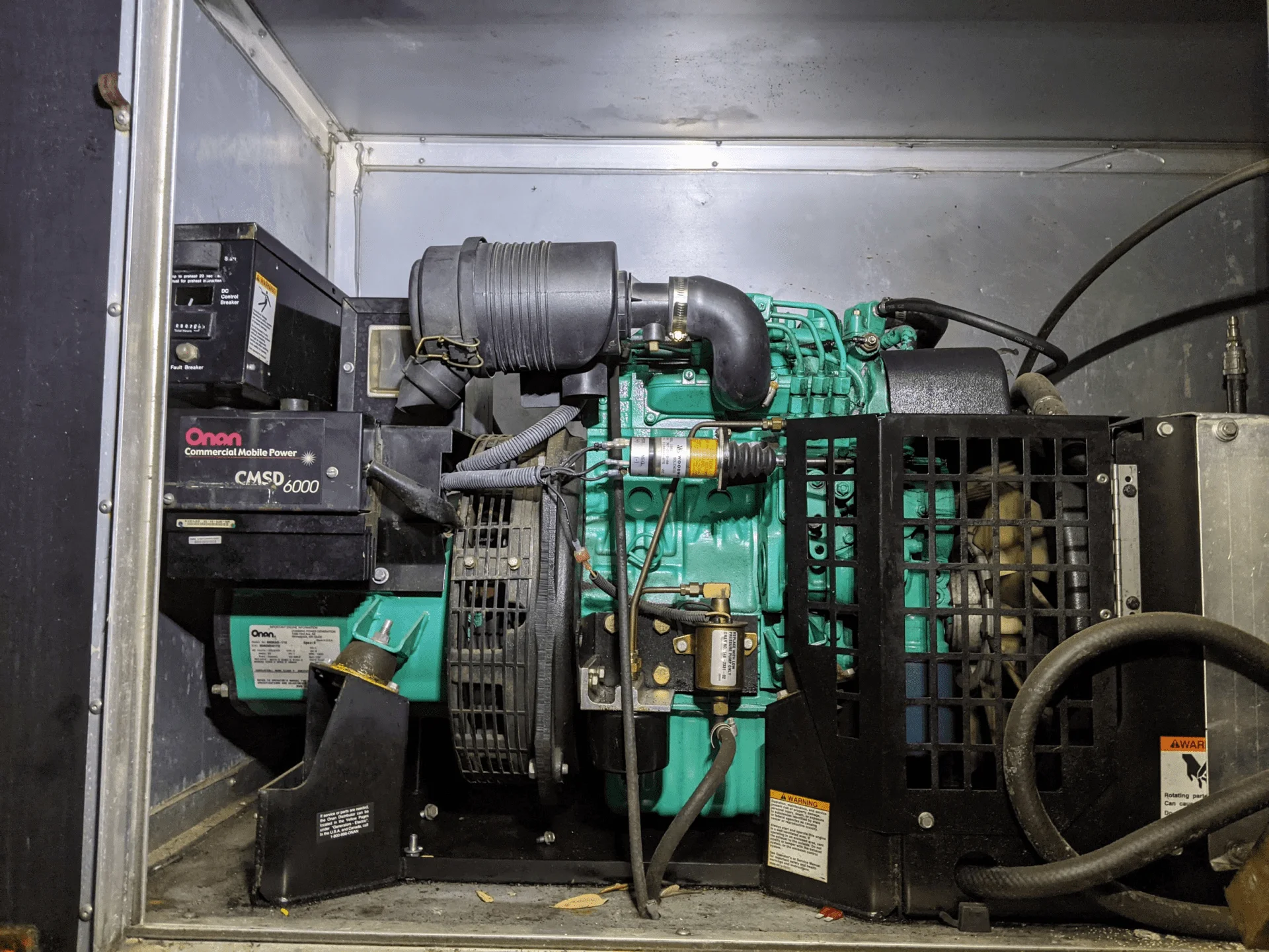

Working on getting the generator up and running. Cummins Onan HDKAS, 6kw 3cyl, 1800rpm, diesel generator. Someone had been monkeying around in the control box:

Got the generator running this weekend. It's way bigger than I need, but it's big enough to power a welder. Pretty neat machine.
Jury is still out if it's too loud to run overnight while we're sleeping.

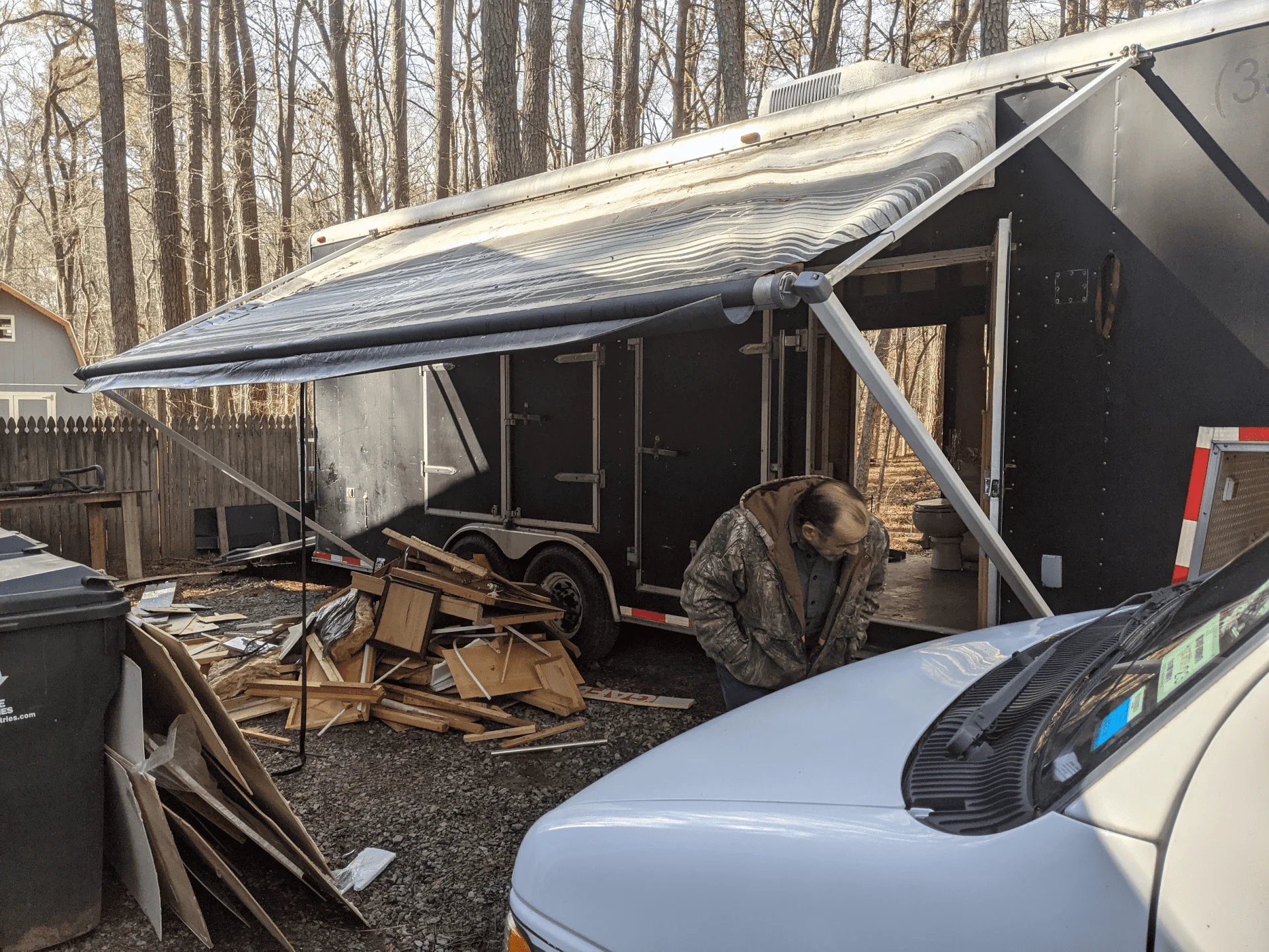

Figured out the awning. The fabric is 15 years old and ripped, but it works!! Need to look into getting new fabric, or if this one can be repaired.

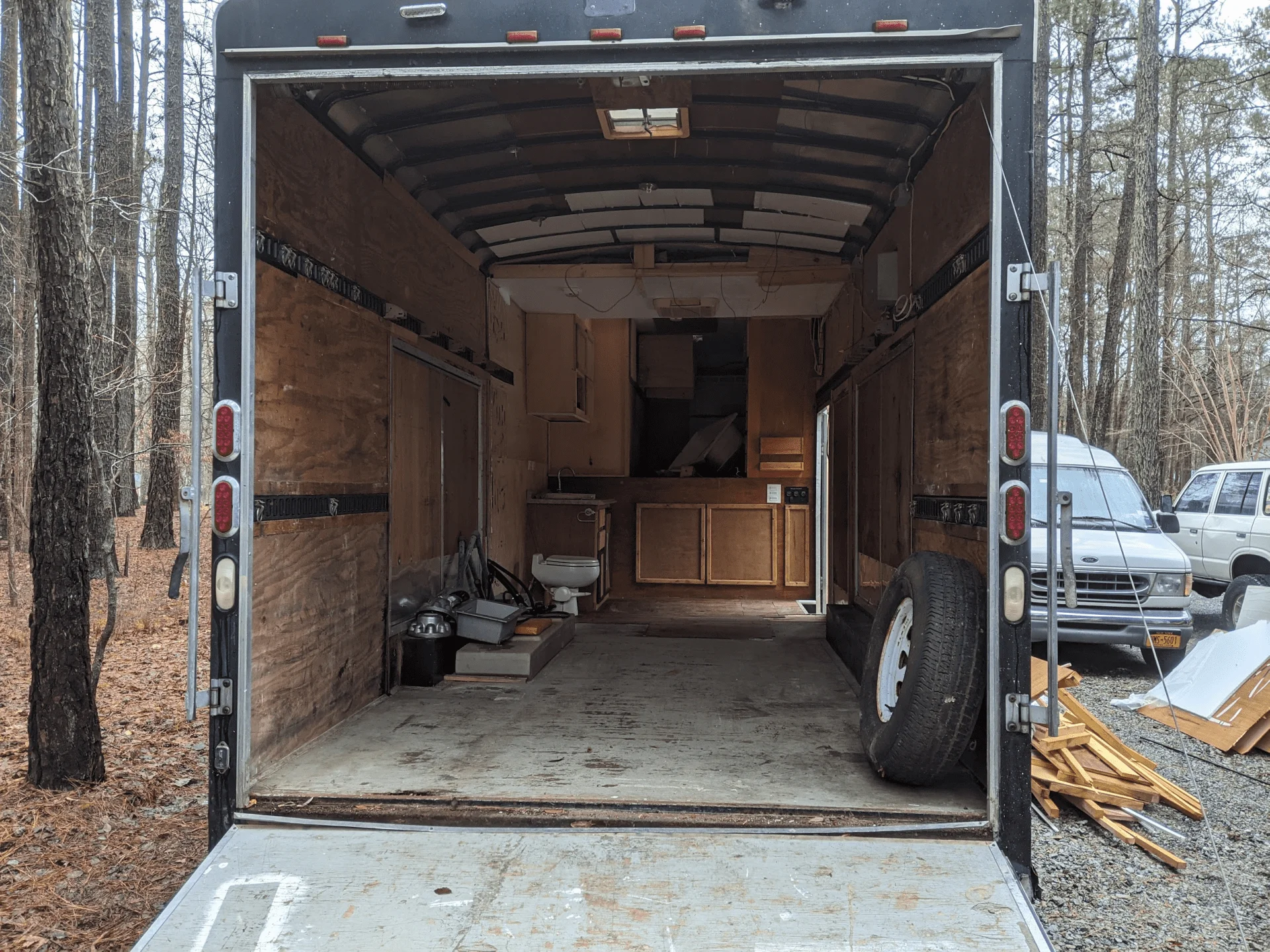

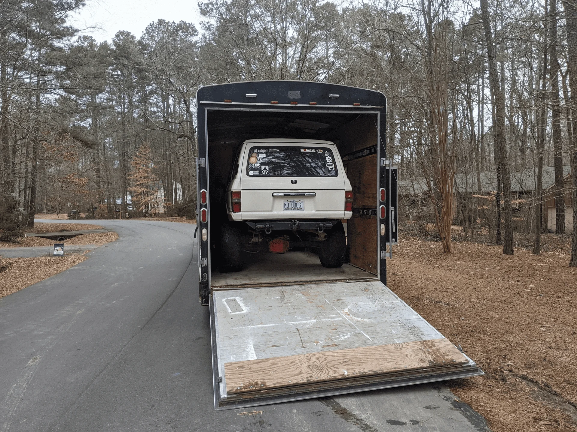

Got her pulled up to the street for a test fit. Moonshine fits pretty damn well. Have ~38" of room from the front bumper to the goose to play with for shower/s***ter/kitchentte. Should be just enough.
Empty pics:
The white scribble on the floor is our rough layout for the wet bath/kitchentte.

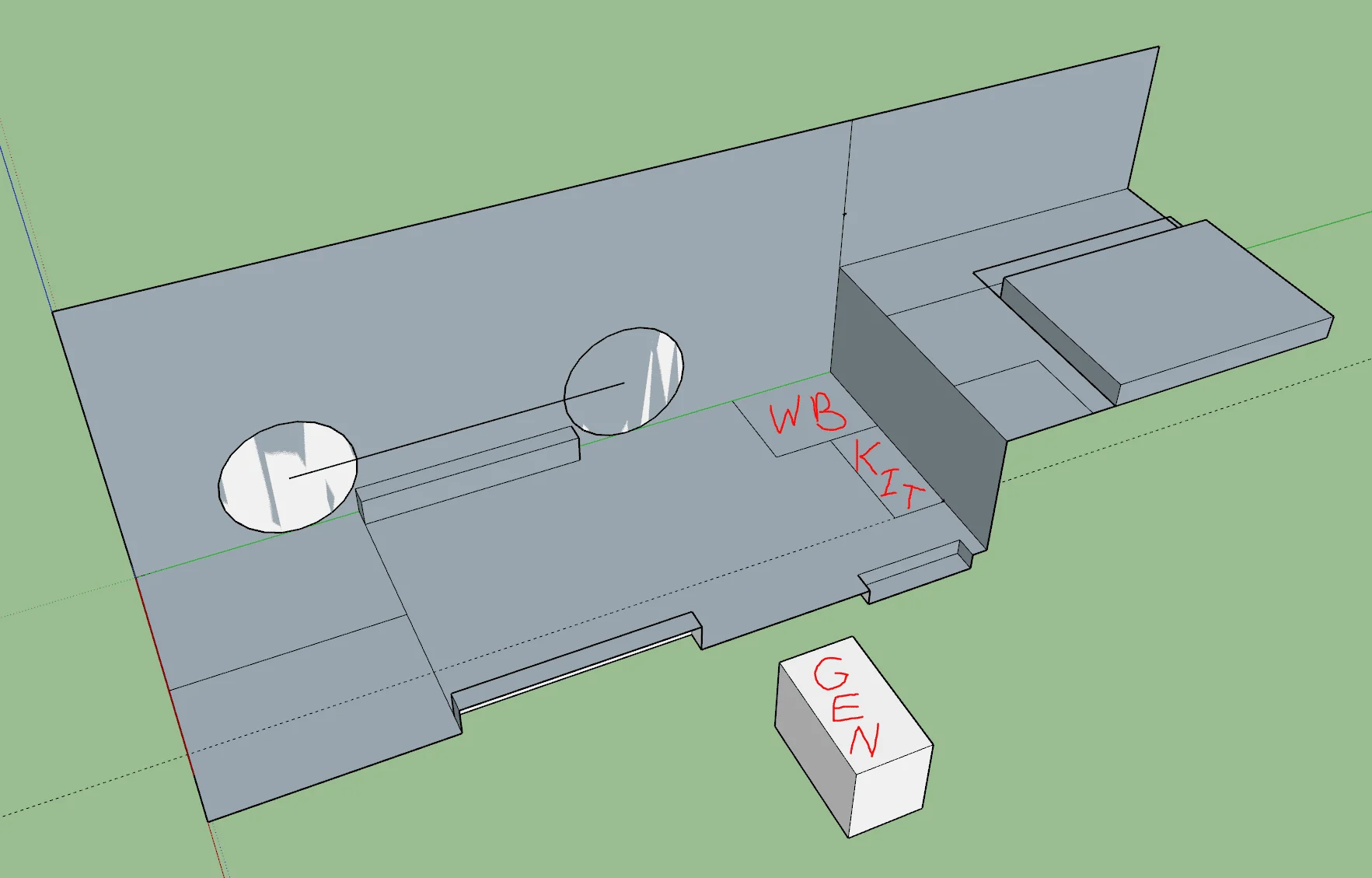

I've decided I'm going to sell the onan generator. It's pretty sweet, but way bigger than I really need, and it just won't fit with the truck in. The onan is 2'x2'x3' more or less, and there isn't that much room. I don't want the generator where it is up in the goose (next to our heads), meaning the only place it *could* go is where the kitchentte will be, eliminating the kitchenette.
Just not worth it imo. The little Honda will do everything I need.
EDIT: So if anyone is interested in a Cummins Onan 6kw with ~900 hours on it, hit me up.
For a perspective, here's a layout picture. WB = wet bath, KIT = kitchenette, GEN = Onan generator. On the side wall is a representation of moonshine's wheelbase and tire size. The generator would just eat up everything on the floor.
