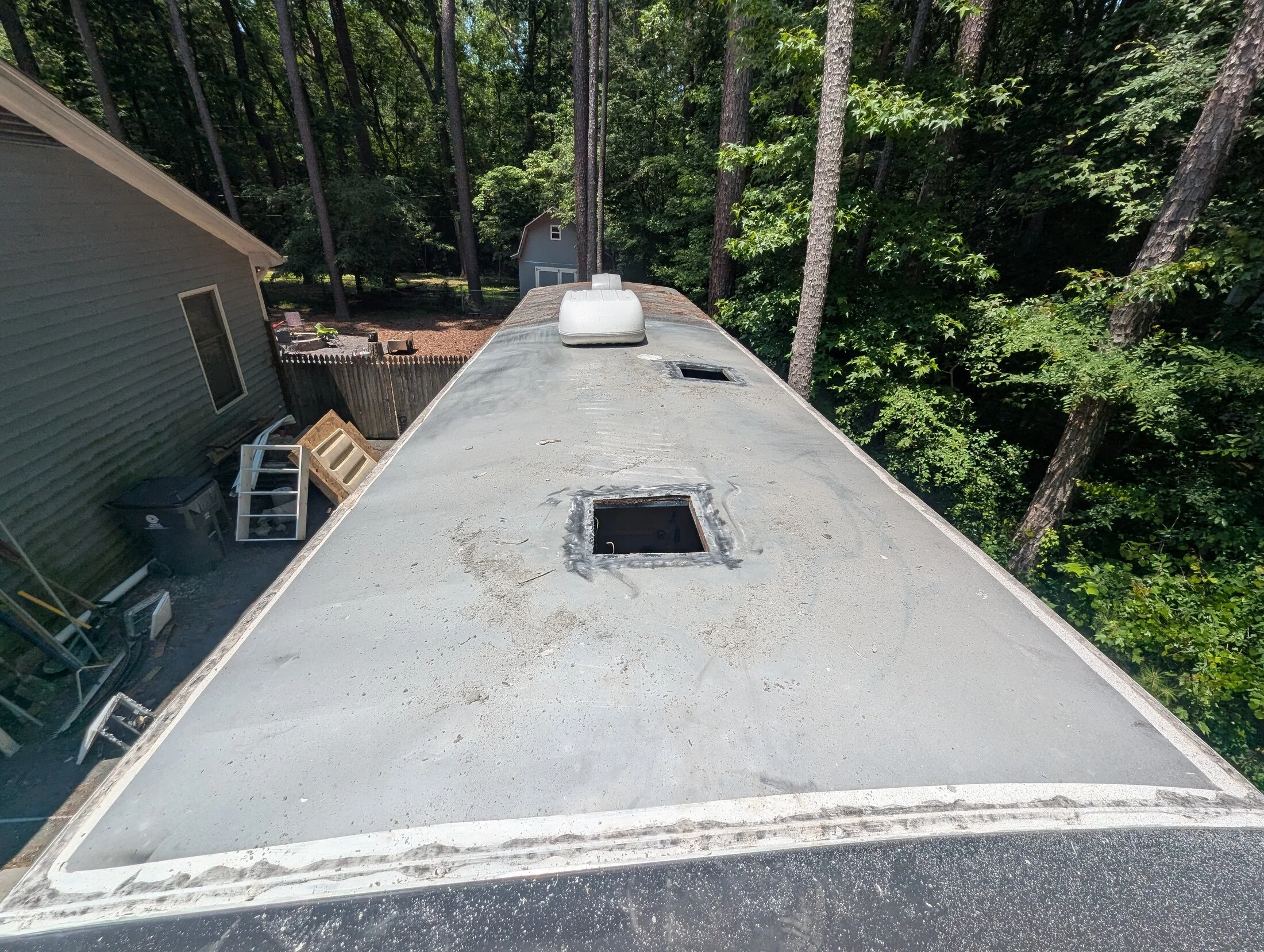

Pressure washing the roof so I can lay out and properly seal the panels after they're mounted. Turns out I can only fit 4 of these panels in front of the ac unit, and only after I remove these two vents.
Onwards and upwards.

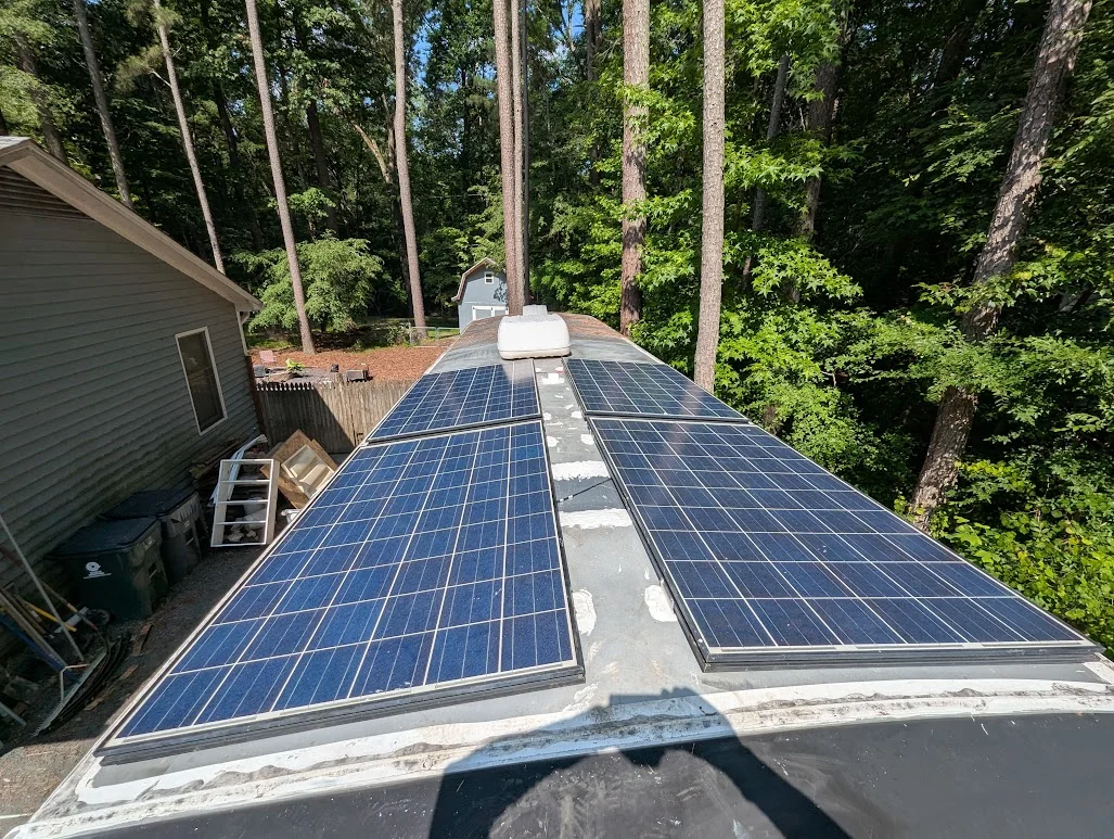

Neglected to order mounting feet for the last panel, but got a good amount done today. Removed both roof vents and filled the holes with some aluminum siding sheet left over, then mounted three panels and the cable entry gland. Good day.
Last panel will hopefully go up tomorrow, then onto the inside component mounting and wiring.
Squirrel proof the wires. Mesh heavy gauge for the win!
Got the last panel up this morning, things sealed up, all panels wired in series, and connected to the entry gland. 127ish volts measured from the leads inside, means success. Next up, inside work, getting the controller mounted and wired.

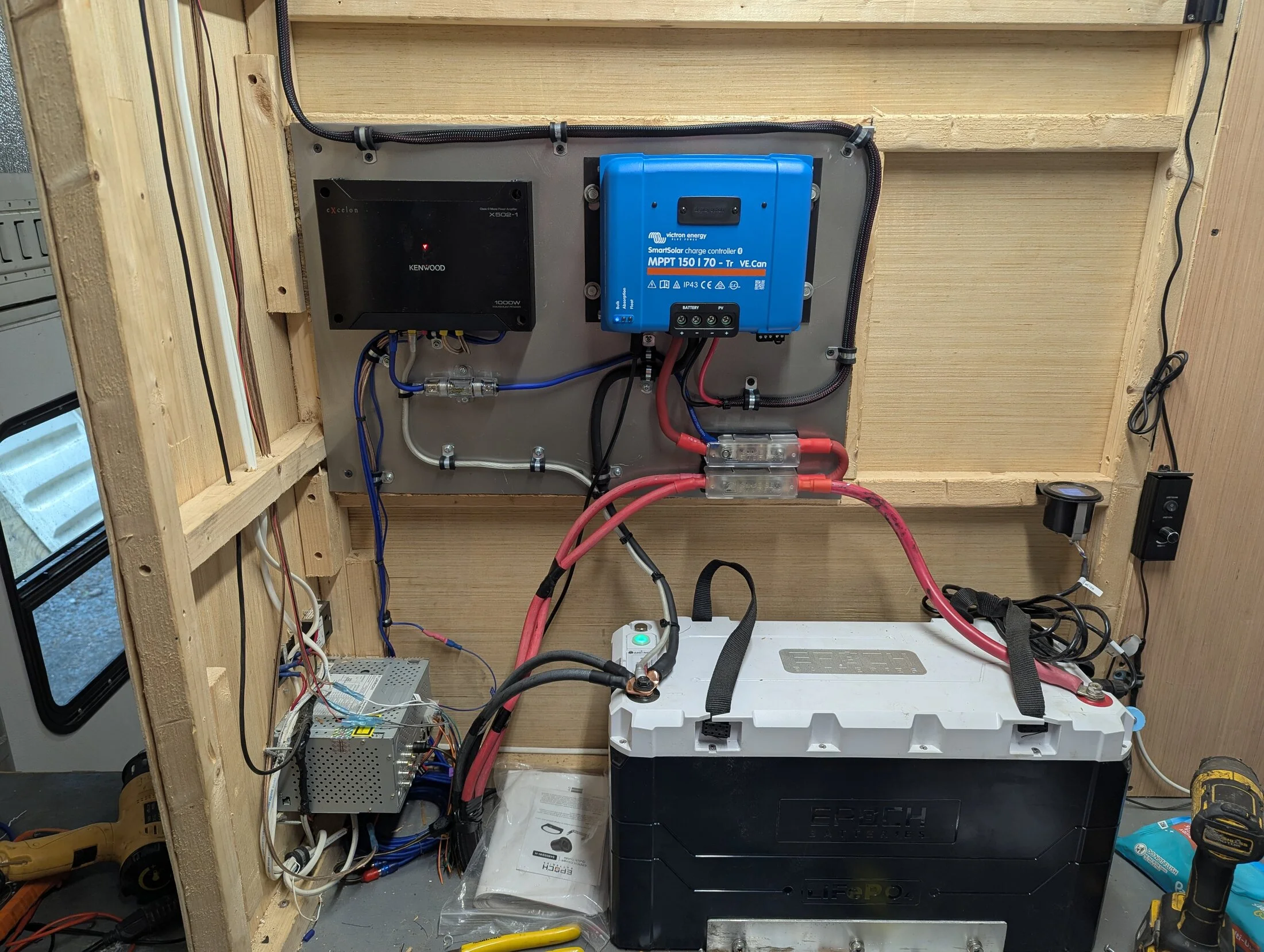

Got to the interior wiring this afternoon. Built a panel to mount components to, and skinned it with aluminum, since the component spec is to mount to a non-flammable surface.
Once that was done, I got to work. Pretty happy with how it neat it is coming out. Once I get the data cable connected to the solar controller, I'll put the anl fuse in, and we'll have solar in the motel.
Very happy that I was able to move the battery anl fuse holder up to the panel off the floor. Love having power cables farther away from my feet.

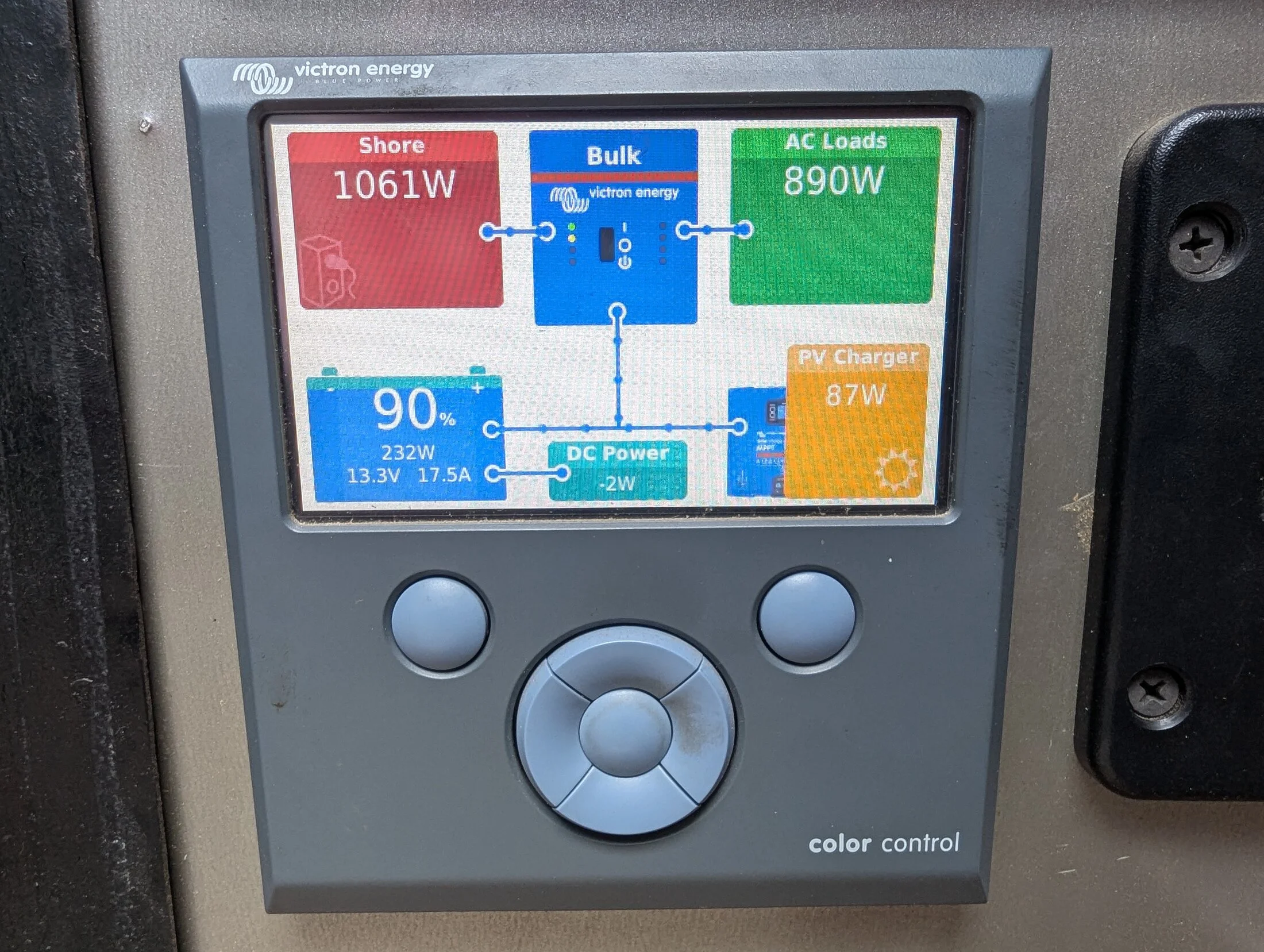

Solar install complete. Monitoring is a little odd, seems I can't connect both my Epoch battery and the SmartSolar MPPT to my Color Control GX via VE.can, since the battery needs a different baud rate than the MPPT. Even though there are two VE.can ports on the GX, they have to be set to the same baud rate, so I can either have the battery or the MPPT connected, but not both. Going to try VE.direct for the MPPT and VE.can for the battery, cable en route.
Regardless of the convenient monitoring, the solar is fully connected and functional. Tomorrow or this weekend, the amp will be wired up.

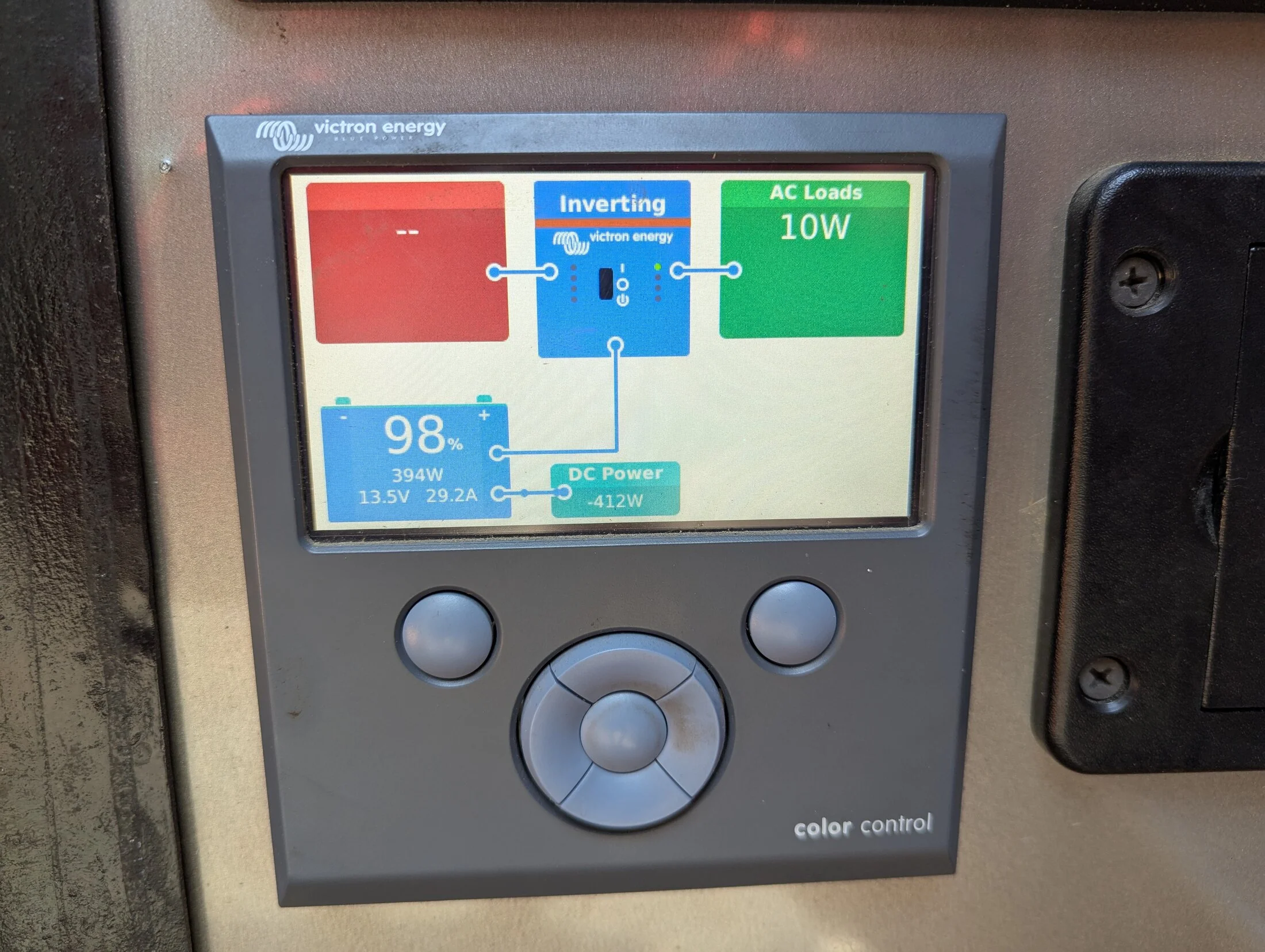

Sunny day example of power generation, at about 10am. A little over 400w. Don't need to keep the motel plugged in anymore! Note the negative DC power rating in the bottom square.
Have a plan to fix solar generation monitoring, will have it in place tomorrow.

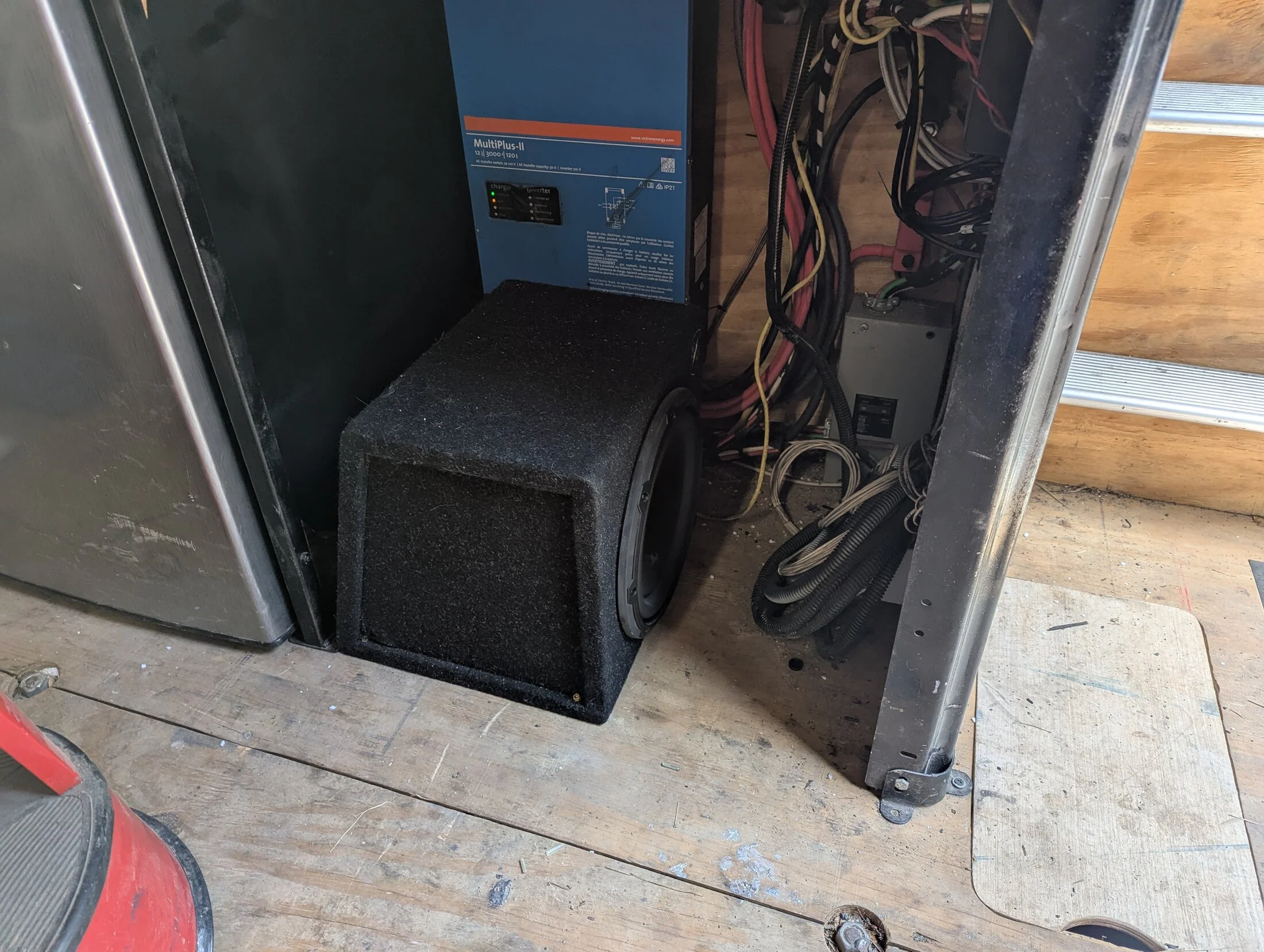

Amp wired up, fused, sub mounted and wired, and the ve.direct cable installed which fixed the mppt monitoring problem. The sub bumps! Thanks @Hokie LX for the sub, you're the mvp!
Ready for GSMTR next week!
I suggest you grab a 1 farad capacitor for the sub - helpful in lowering the overall load when the "bump" happens. Less likely to dim the lights.
Worth putting in even if I don't have any dimming or anything now?
I like them, I look at it like a reserve tank for the sub. When it's smaller like that it's not really that necessary, but running on a battery with no alternator to smooth out the current, it may dim slightly at the end of a night of playing music.
I've got one on all my systems, except for the one that has actual gel batteries inline with the capacitors since the cap wasn't cutting it. That said, you probably won't "need" it and honestly at the end of the night you might like the light show... ;)
If I was buying one, this one would be it. Biggest juice, lowest cost.....
