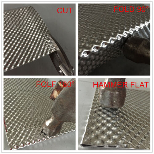

@cjmoon donated some embossed heat shields leftover from a project to my Vera project... Yes I am saying the word Vera. Three times and it may actually show up again......
Anyway, Very easy to mold and bend to the shape I wanted. very similar to this it appears....
I was looking at something very similar mad by heat shield products. Ghosh have an inferno heat shield I was considering but it is pricey. I will be interested hear how rigid the product have is.
