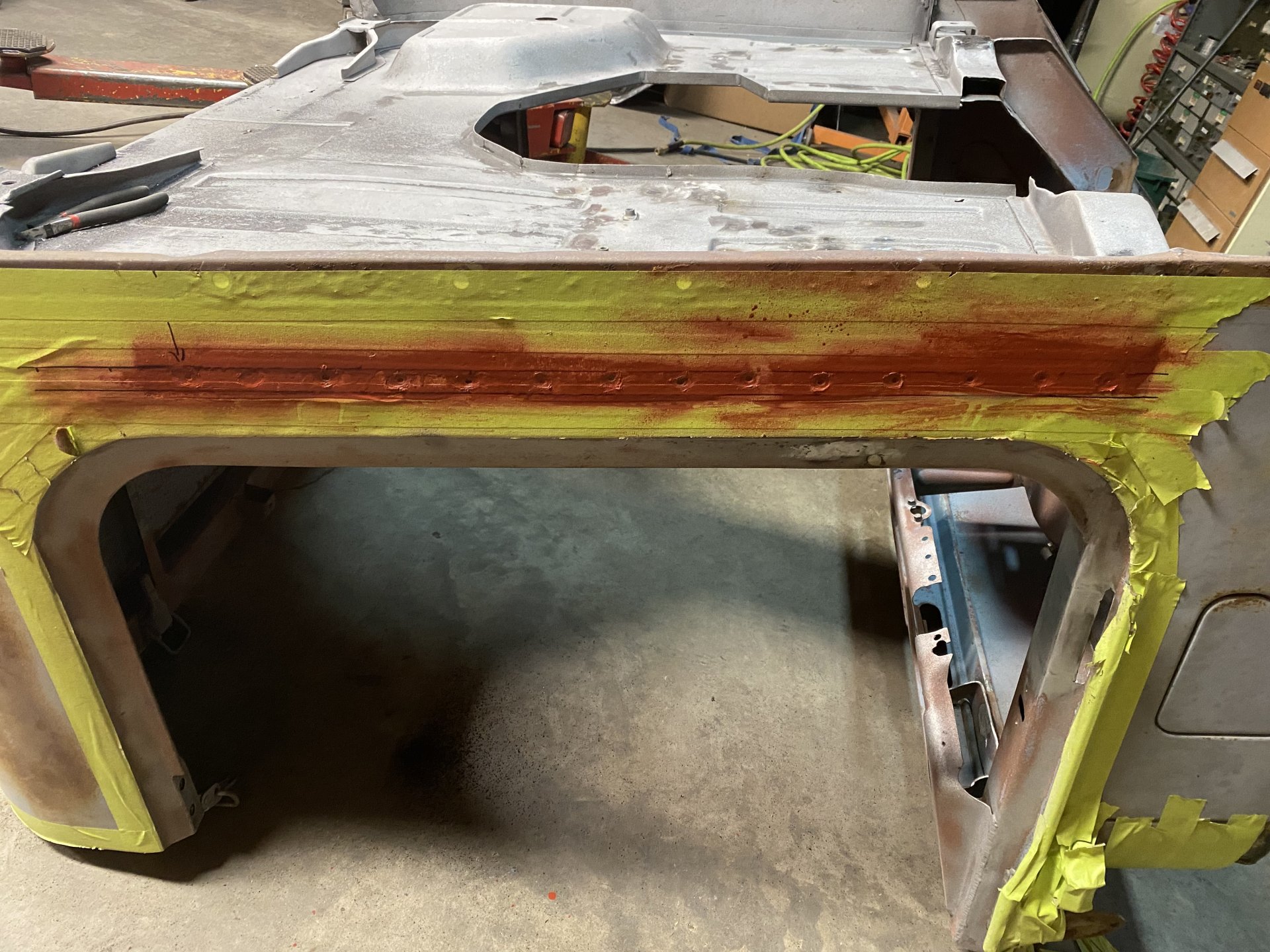

There was some rust under the driver side rocker that I had to cut out and replace. I am not planning to paint the exterior of the 45, so this is how I went about preserving the patina while making the repair.
I cut the rusty section out and blasted the inside of the rocker panel as best I could then treated it with some weld though primer. I got to work and didn’t take pictures of that part.
I placed a couple layers of painters tape on the exterior of the rocker. Then measured and marked out where the spot welds should go to secure the replacement panel. The stock panel I removed had spot welds every 2 inches, so I matched that.
Then I used a small 1/2 inch air power belt sander to sand through tape to bare metal just big enough to allow the spot welder to make clean contact to work. The tape was good for helping to reduce the size of the area I ground down allowing me to preserve as much patina as possible.
After the piece was welded in I cleaned the spot welds with the same belt sander and sprayed the spots with primer. Having the tape all ready in place insured I was only spraying the area that was ground down, so the repaint is minimal.
