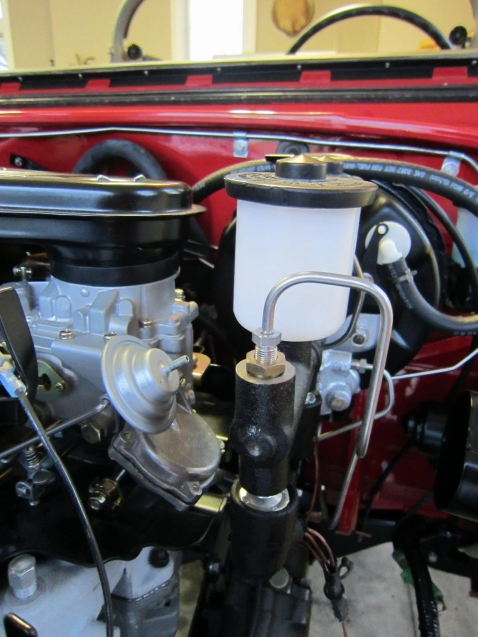

Thanks to Classic Tube for making it right on the brake line that was too short. Now it reaches all the way to the front of the master cylinder as it should.

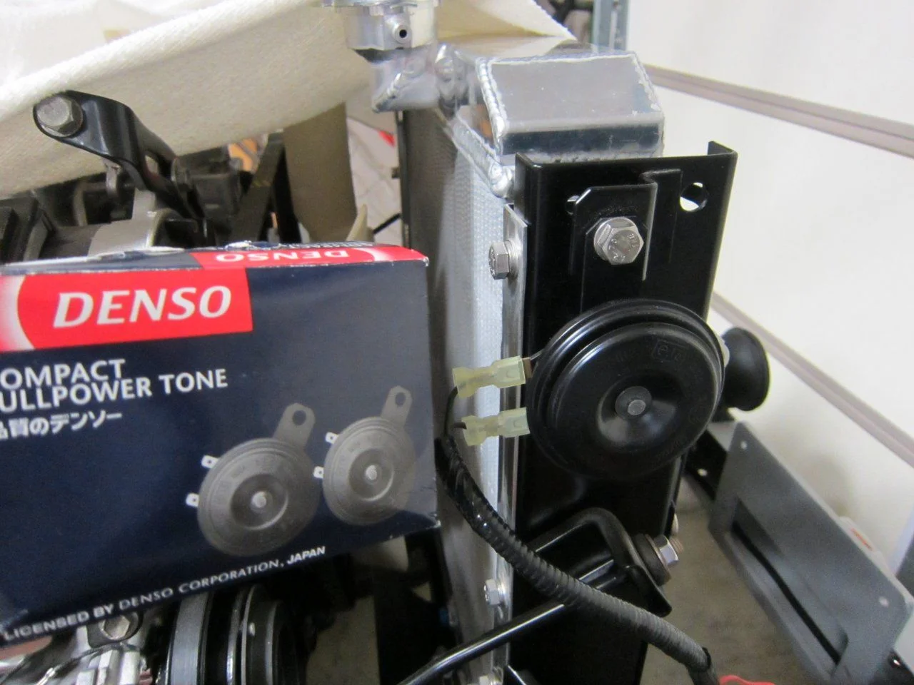

One thing I'm having trouble with is the horns. They don't work, no click, no nothing. Even touching directly to battery I get nothing. I took these apart, cleaned, painted, etc so I assume I painted a surface that should be bare metal. How do the horns work in general. I've tried 3 different ones, same thing - nothing.

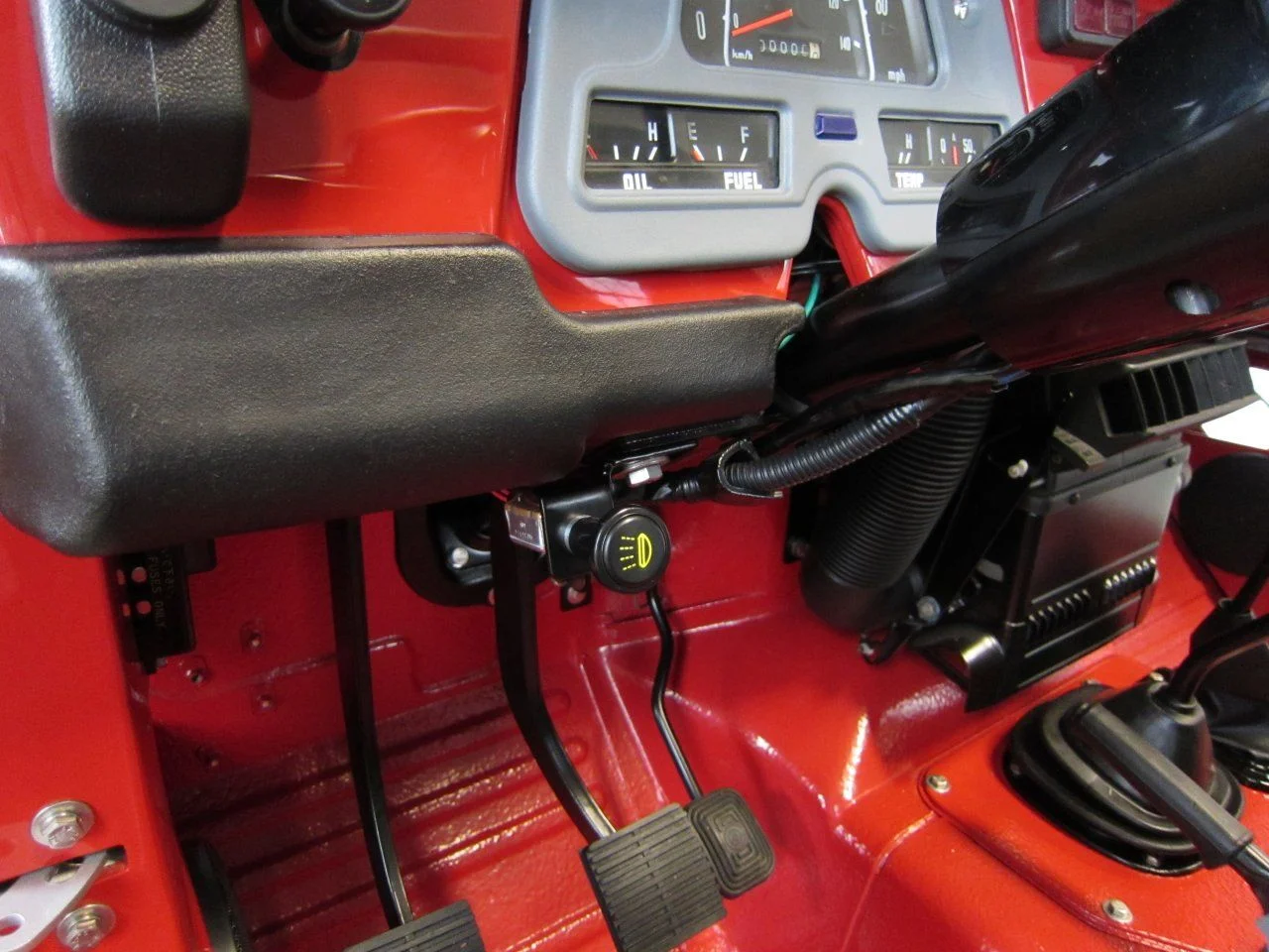

Made a bracket for the fog light switch - powder coated & installed. Also, installed the final fuel tank strap & put some gas in it. Fuel gauge works. :clap:

are you grounding through the mount properly?
not sure, that may be a problem also - with horn attached to vehicle or not, I've wired directly to the battery to see if the horn itself works. If it did then I'd trace the problem through the vehicle wiring to the steering wheel.
I ordered the ebay horn replacements for about $30 shipped from Thailand or somewhere, takes a few weeks to get here. I'll try those next & diagnose problems from there. I should be able to hit the horn button & light up a test light, right? That should confirm the wiring in truck is OK.

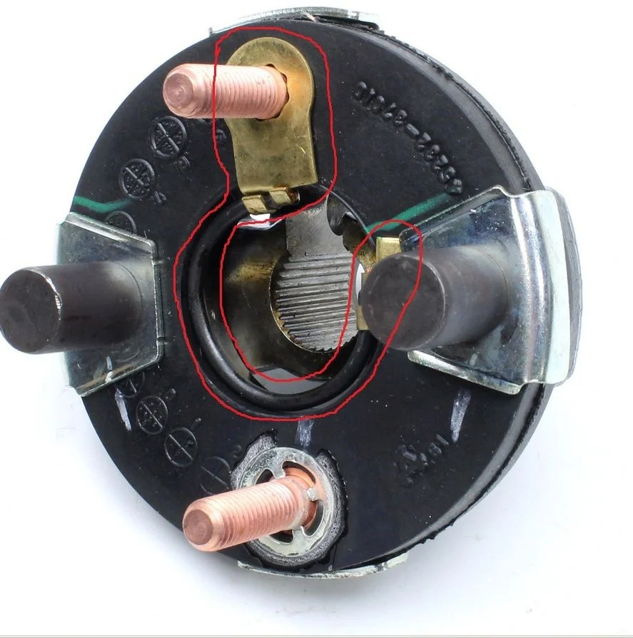

Just went through the same issue with the horn(s). Boosted this tip from another post ref: ground (see pic below)..

So the wiring is fine. I was able to light up the test light by hitting horn buttons. I must have screwed up the horns internally somehow. Oh well, new ones will be here soon.

That steering wheel bracket bolt is a handy mount location. Not sure if it's put to use by many, but I made a bracket for my tach to mount from it. Perfect location. No drilling. And no rubbing/mounting from the steering column. Nice location for the fog light switch! Will have to copy that one day.
