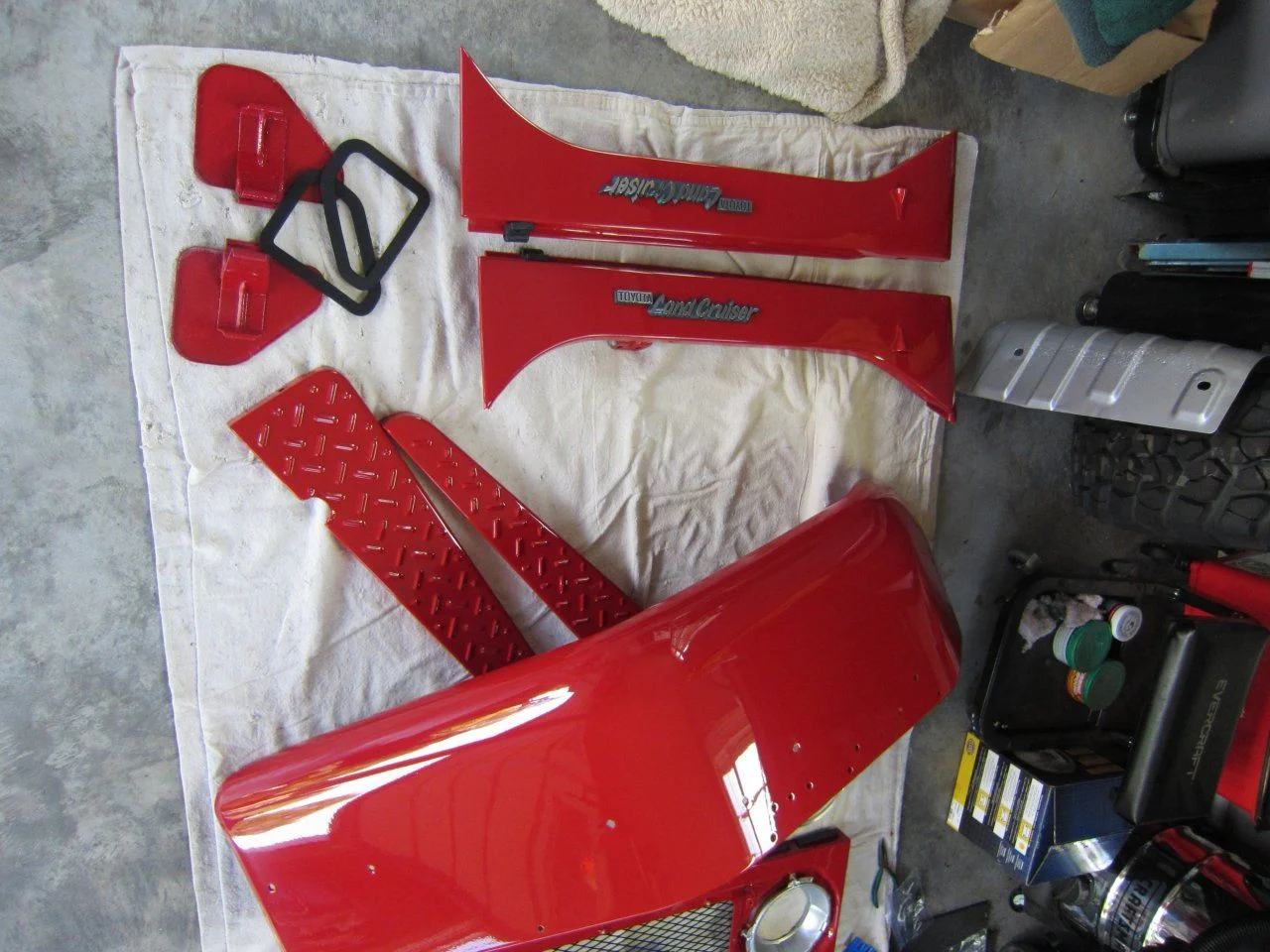

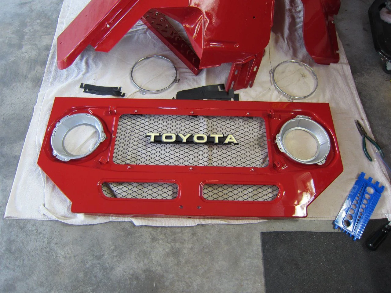

Picked up a few pieces from the painter yesterday...:):bounce:
No good question actually. I asked the same thing. My painter estimated the amount of paint we would need for everything & mixed it all at the same time. If we think we may run short, we will mix another quart and use under the hood, etc where a perfect match is not as critical.
Hood & windshield frame are next, I'll drop those off Wednesday. About 2 week turnaround.

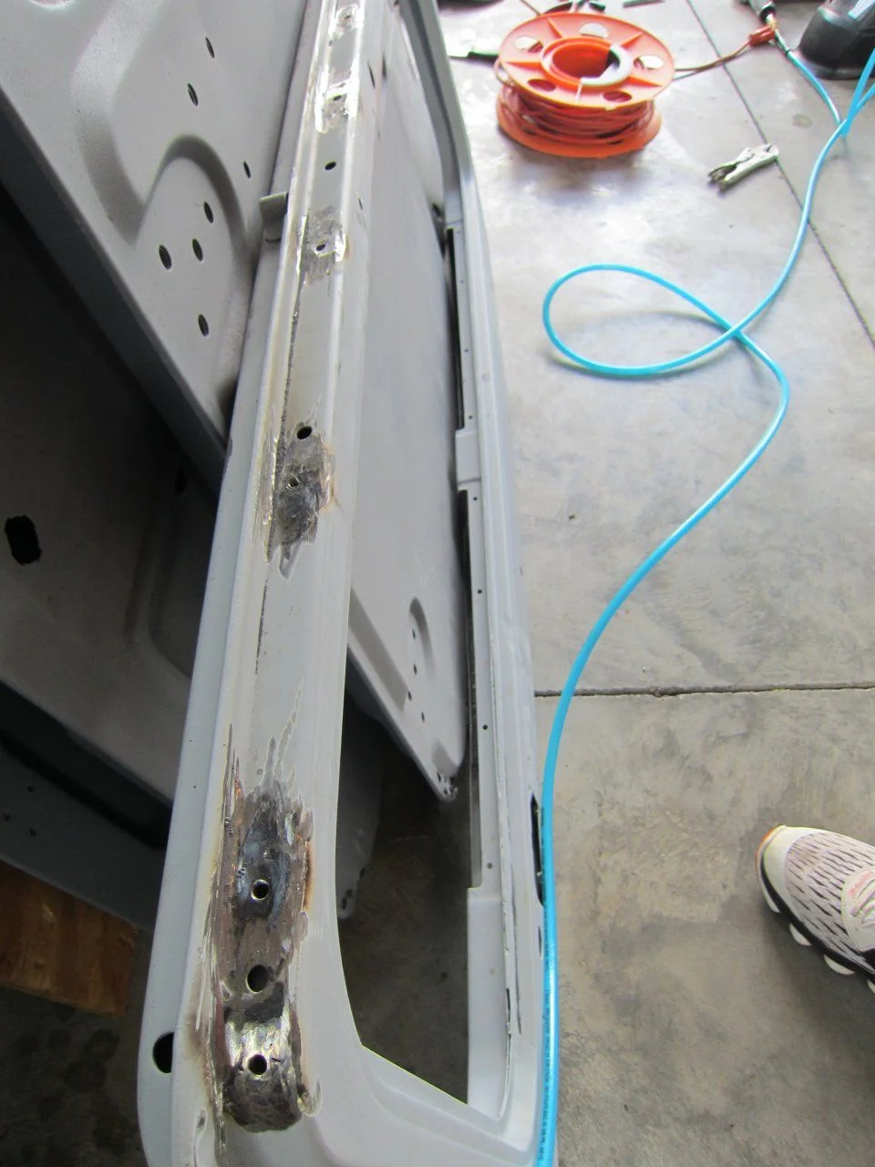

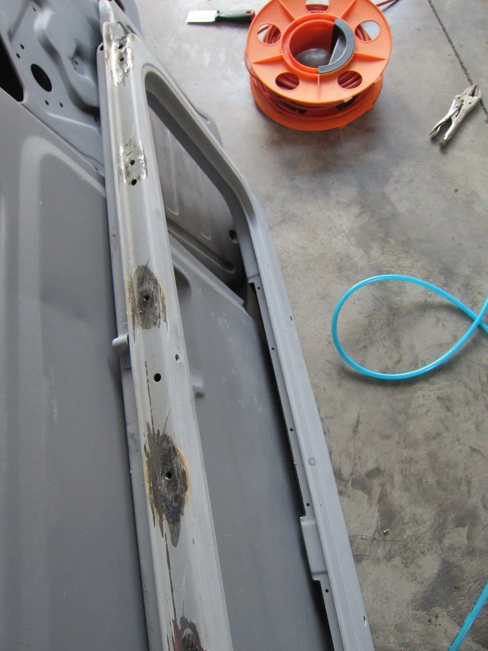

Decided I wasn't happy with the top of the windshield, so I redid the captive nuts I installed for the bikini top rail. Now I can put a 6mm bolt in to hold the bikini rail.

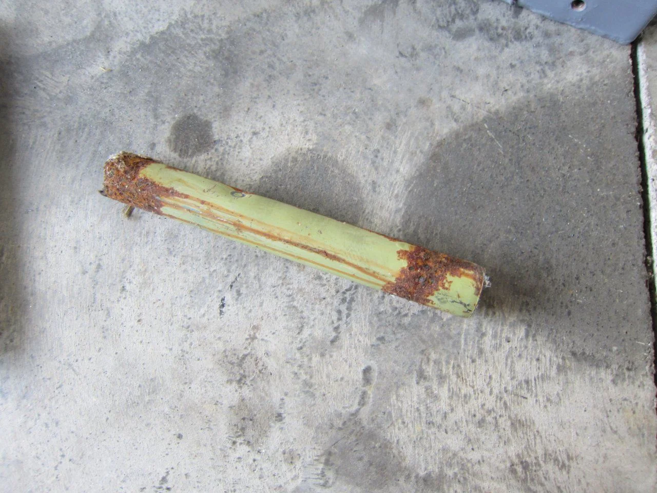

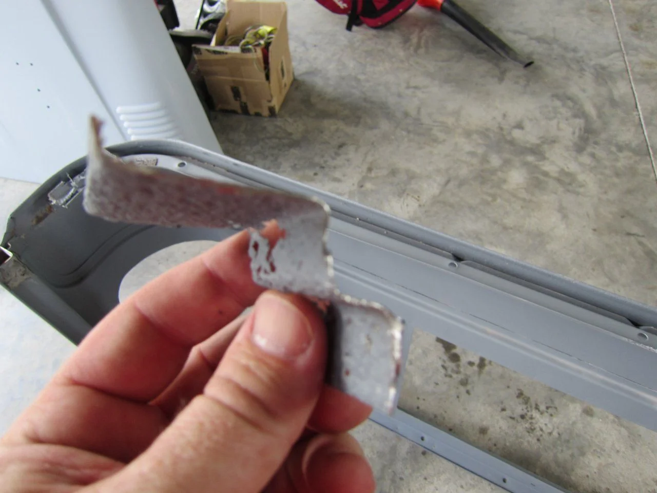

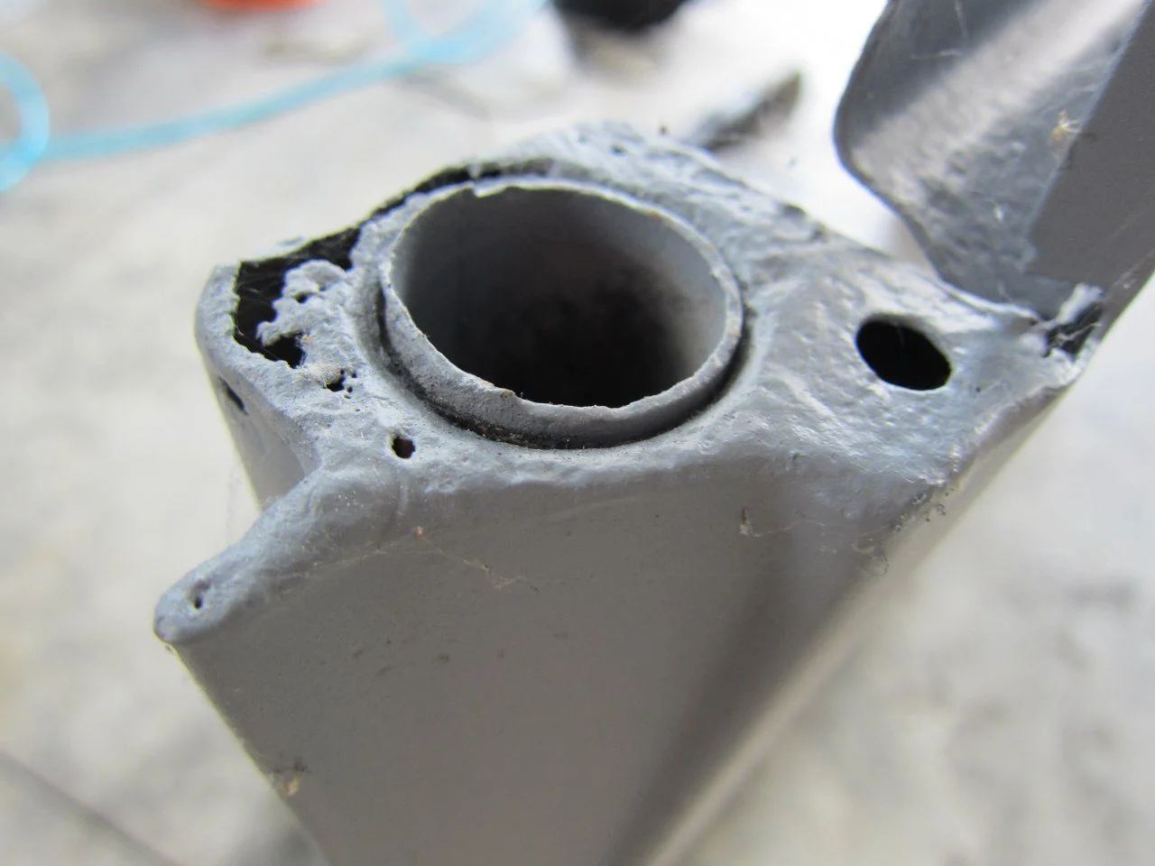

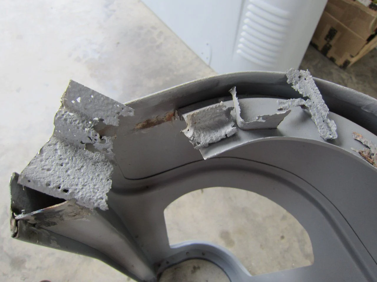

While I'm on the subject of the hardtop sides - any ideas on how to reattach the posts that go into the b pillar? Maybe put a sleeve inside it and weld the sleeve to both the post (loose) and the where it was cutoff? I'll fix the rust too while I'm at it.
View attachment 1284487 View attachment 1284488
Please share plenty of photos of how you repair the rails. I am looking at the same problem
