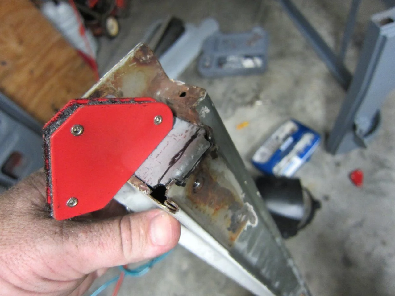

Made a few patches for the side panels and rear reinforcing bar over the amby doors.

I'm just learning myself. These little pieces are pretty easy though I probably have to do more grinding than a pro.

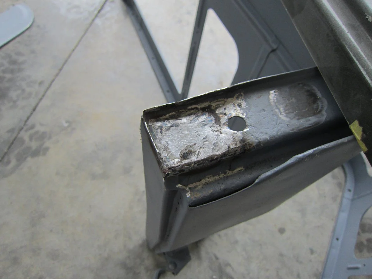

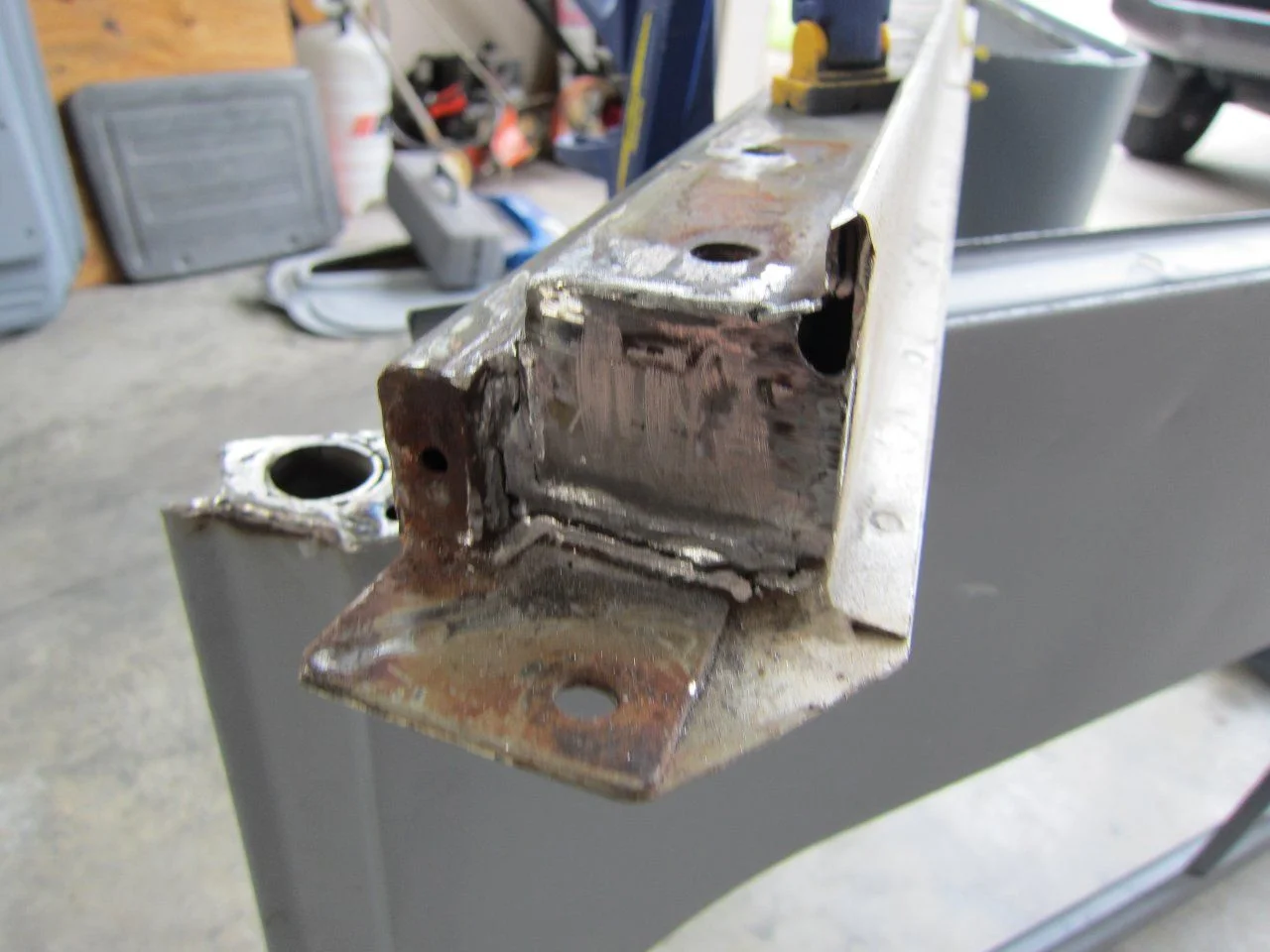

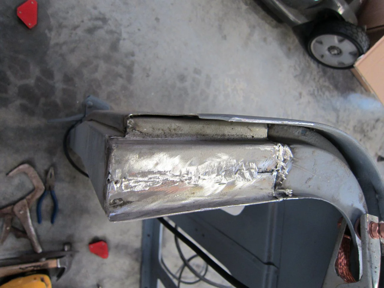

Rear header over amby doors patched. Need 2 small holes for the little rubber piece that goes on the ends. I'll drill it when I find those rubber pieces......
That last pic is timely! I just tor down my hard top today and wondered what that end is supposed to look like. There were remnants of that rubber piece on one end. :cheers:

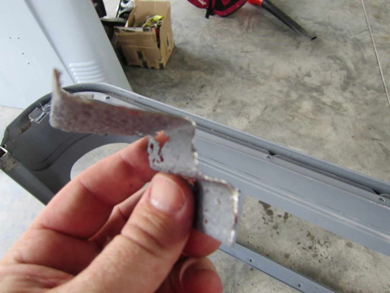

Pry the easiest way is to build a wooden buck and hammer it over with a wooden/plastic mallet.
I took a remnant of the piece I cut out to a local metal shop. They made me a 12" wide piece with all the bends for $15. I did have to manipulate it a little to get everything to line up - the piece I took them was pretty rusted out.
I was lucky as the other end is very solid, so I knew exactly what to do on this end. Let me know if you need more pics.
I was wrong. Paying someone else to do it for $15 is the easiest way.
It was for me anyway, I realize a lot of guys on this forum are way more talented than I am when it comes to metal work. It took them less than 15 minutes with the right tool. I figured that I would have banged on metal for hours and it still not look right. In my case, $15 well spent. Cheers..:beer:

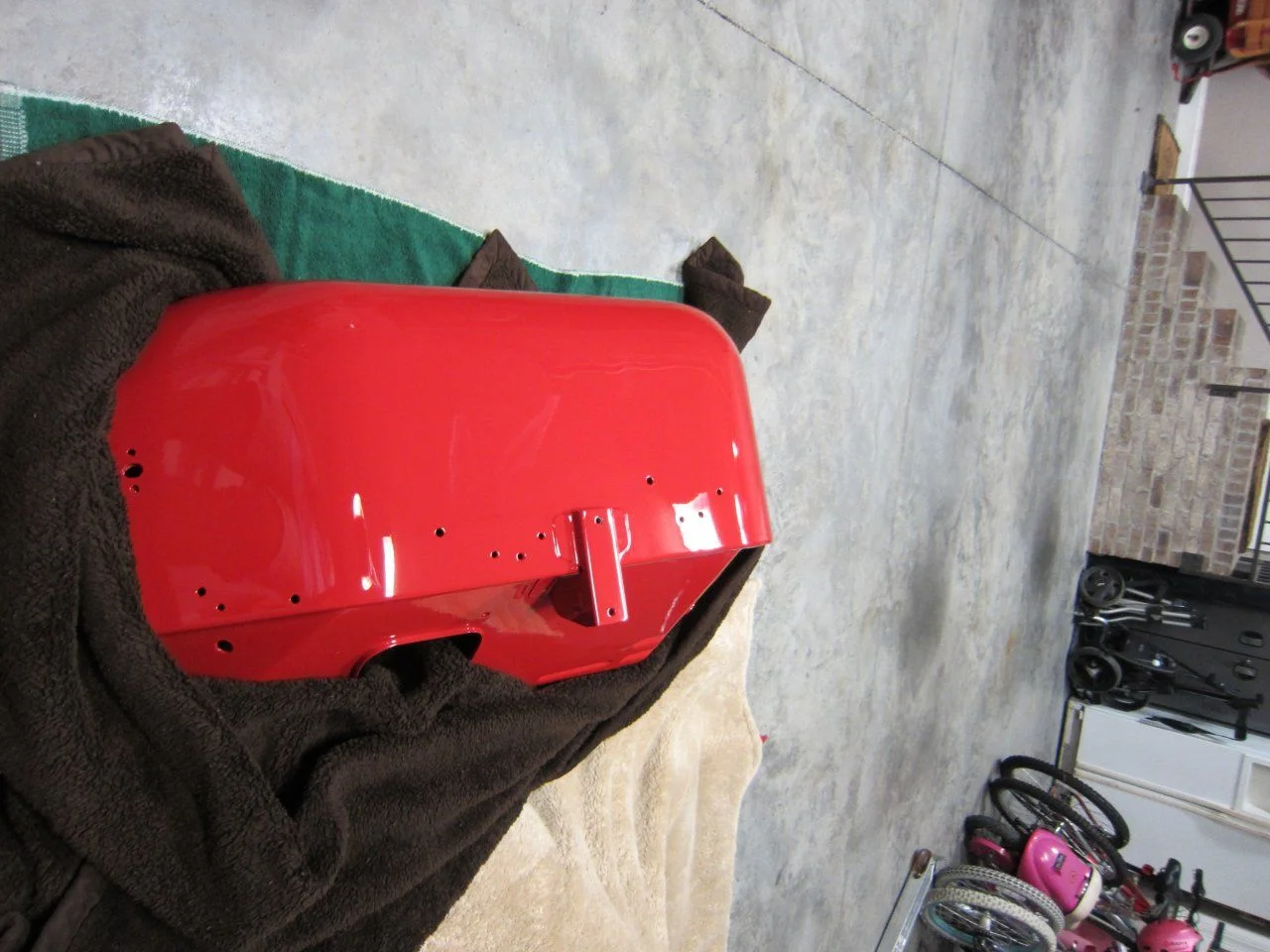

Delivered the hood & windshield frame to painter today & picked up the passenger side fender, gas door, & bib hinge.

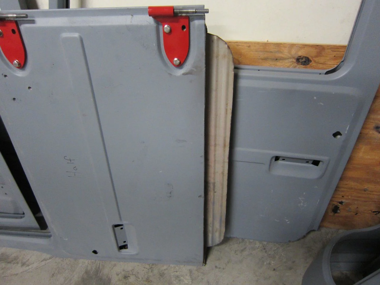

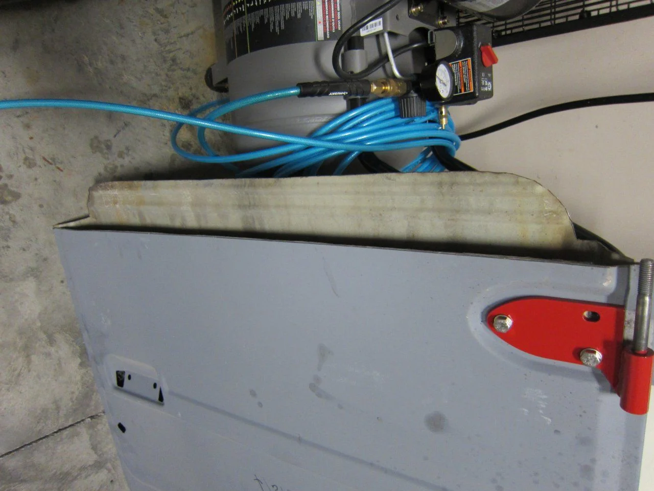

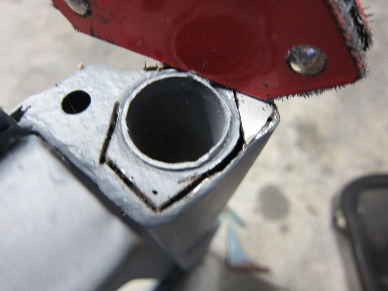

Well I cut the door bottoms off & installed the quick hinges. I'll hang the doors and see if I can get the patch panels aligned properly.
View attachment 1293376 View attachment 1293377
What did you use to cut off the door bottoms? The cut looks very clean. Did you use the new door bottom as a template or guide? I noticed how you rounded the edges of the inside of the door. Why? To save the original interior horizontal lines?
I used a 3" air powered cutoff tool.
I used the patch panels as a template to cut. The inner part of the patch is curved. I guess you're right, it does avoid the original horizontal lines. Take a look at the pics of the Real Steel patches linked below.

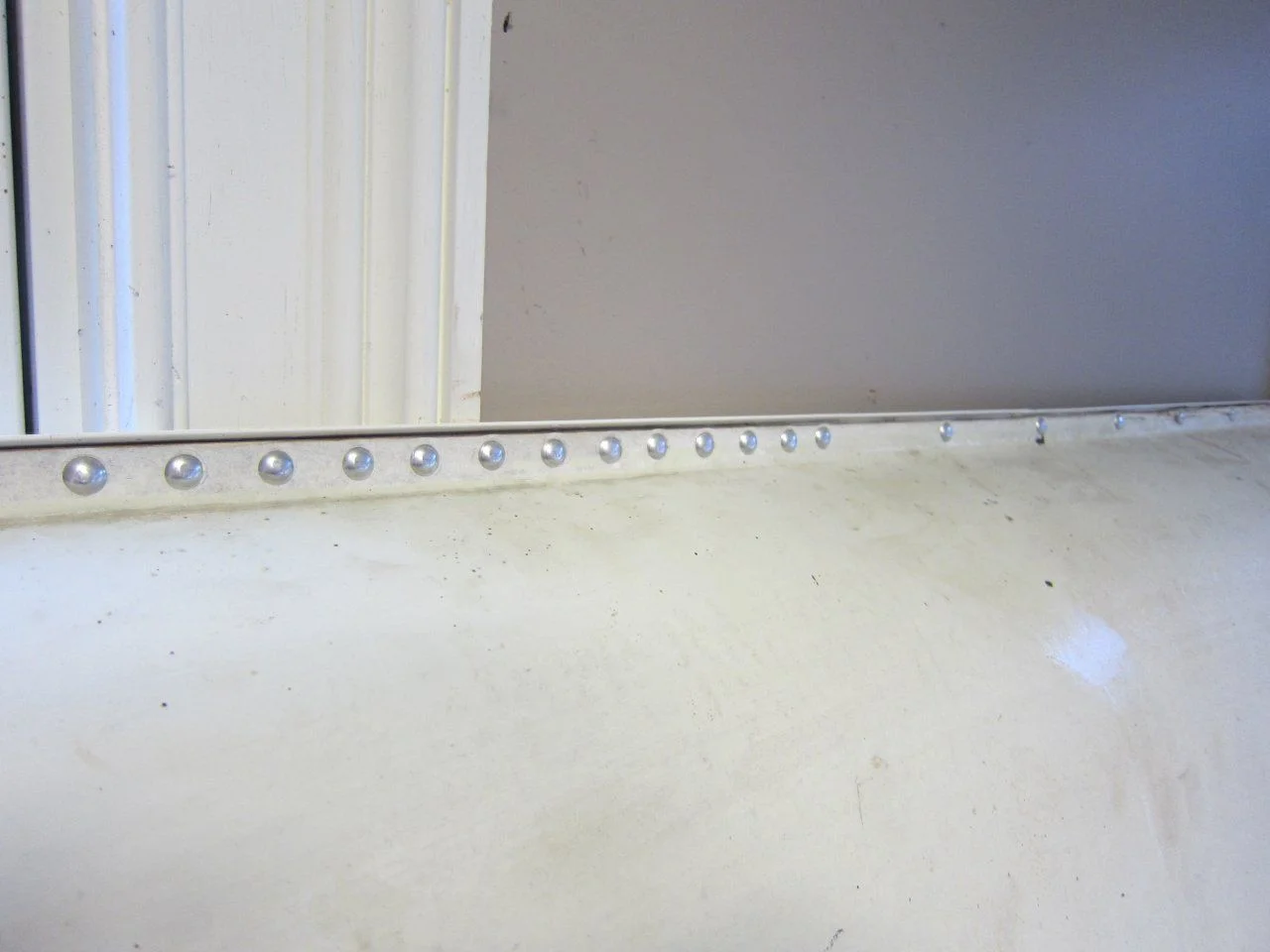

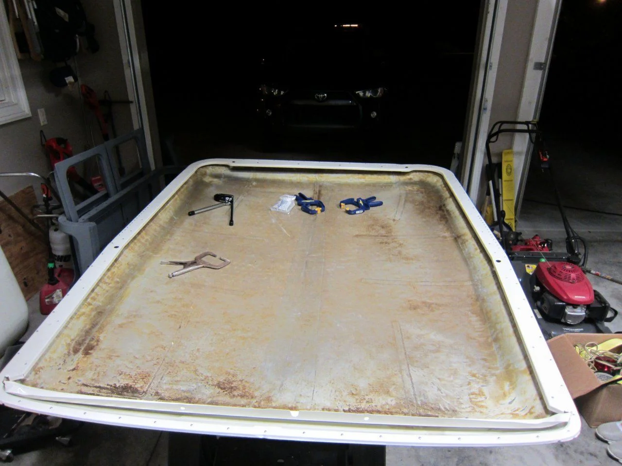

Took a break from cutting up the doors to put 2 tops together. Rivet squeezer is an awesome tool!
Rain gutters were powder coated - they'll be repainted when the fiberglass is painted but I wanted to protect the inside part where the fiberglass meets the rain gutter.
screeeeech......slow down. The tool in the upper right of the last photo, what is it? A rivet tool of some kind? Where did you get it?
That would be a Rivet Squeezer. Google it and youll see tons of different ones (of note they arent cheap!) They are mostly used in the aircraft industry is my understanding (and only time ive really seen them used) but work great for the gutters!
