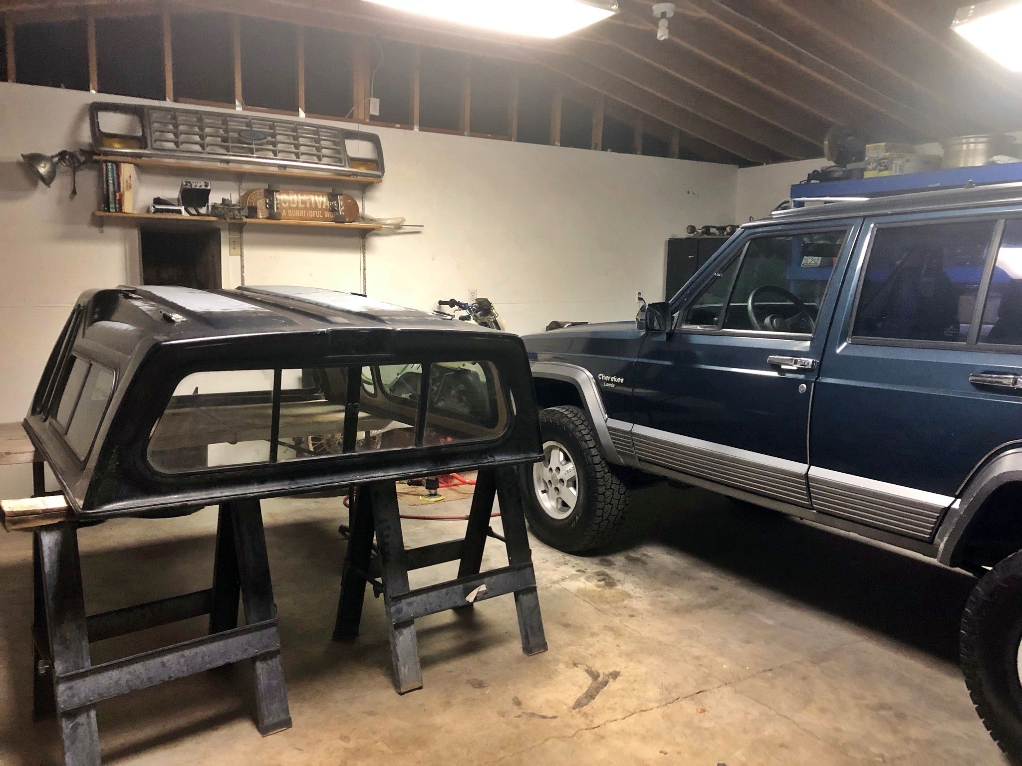

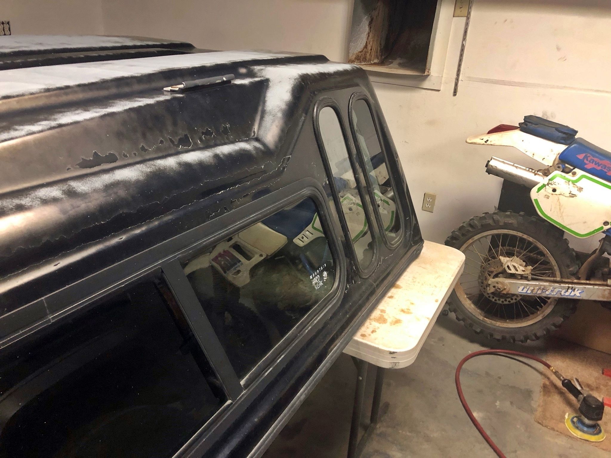

Well guys, I was able to get that window for the camper shell installed! Had to have it custom cut but that's not a big deal. Took it off and threw it in the shop to start sanding and prepping for paint!

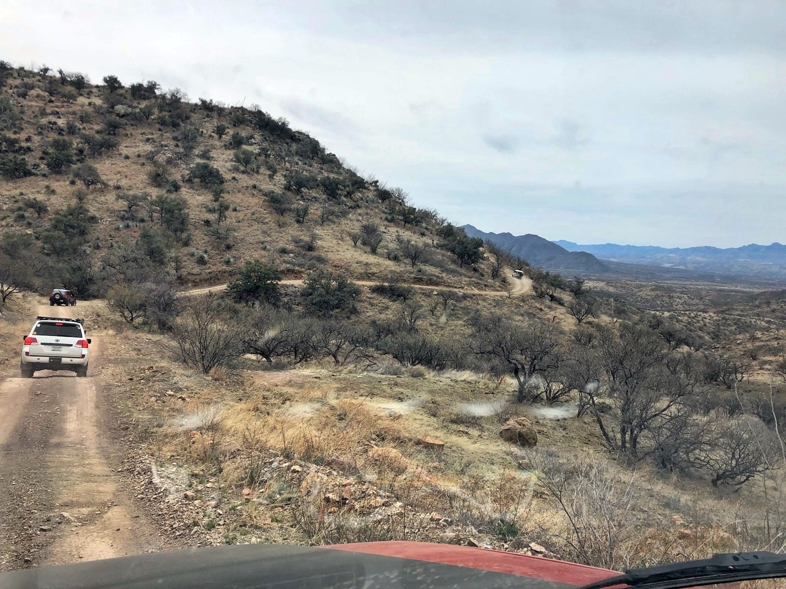

I also spent my Saturday going on a trail run with the local Toyota club (Copper State Cruisers). It was about 100 miles off-road, the first part being relatively easy and the second part being extremely easy. It was more of a overlanding run but was still super fun! I did have a couple chances to use 4 LO and the rear locker. The second part of the run took us to some of the ghost towns in Southern Arizona and right up to the border. Was a super fun day and met a great group of guys – plus the turnout was pretty good for being planned two days in advance!

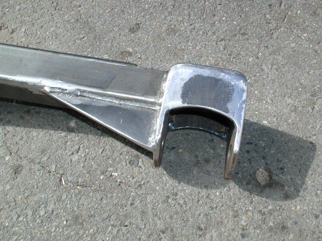

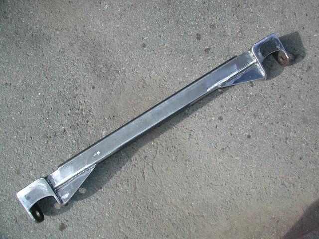

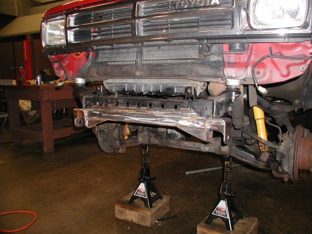

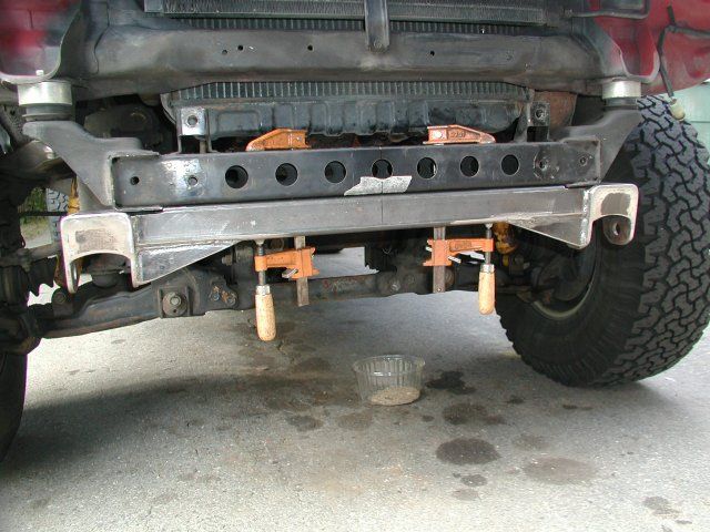

So I just did a quick look back through this thread and the original build thread, but couldn’t find info on the sas. What springs/hangers were used? Because it is a great height.
The spring hanger was homemade by @KLF. It's got OME springs on it but I'm not sure what size lift. I can check and see if the part #'s are still on the springs so you have that.
Here's some pics of the spring hanger.
I'm sure Ken could probably fill you in on what size springs this things running and the other deets.

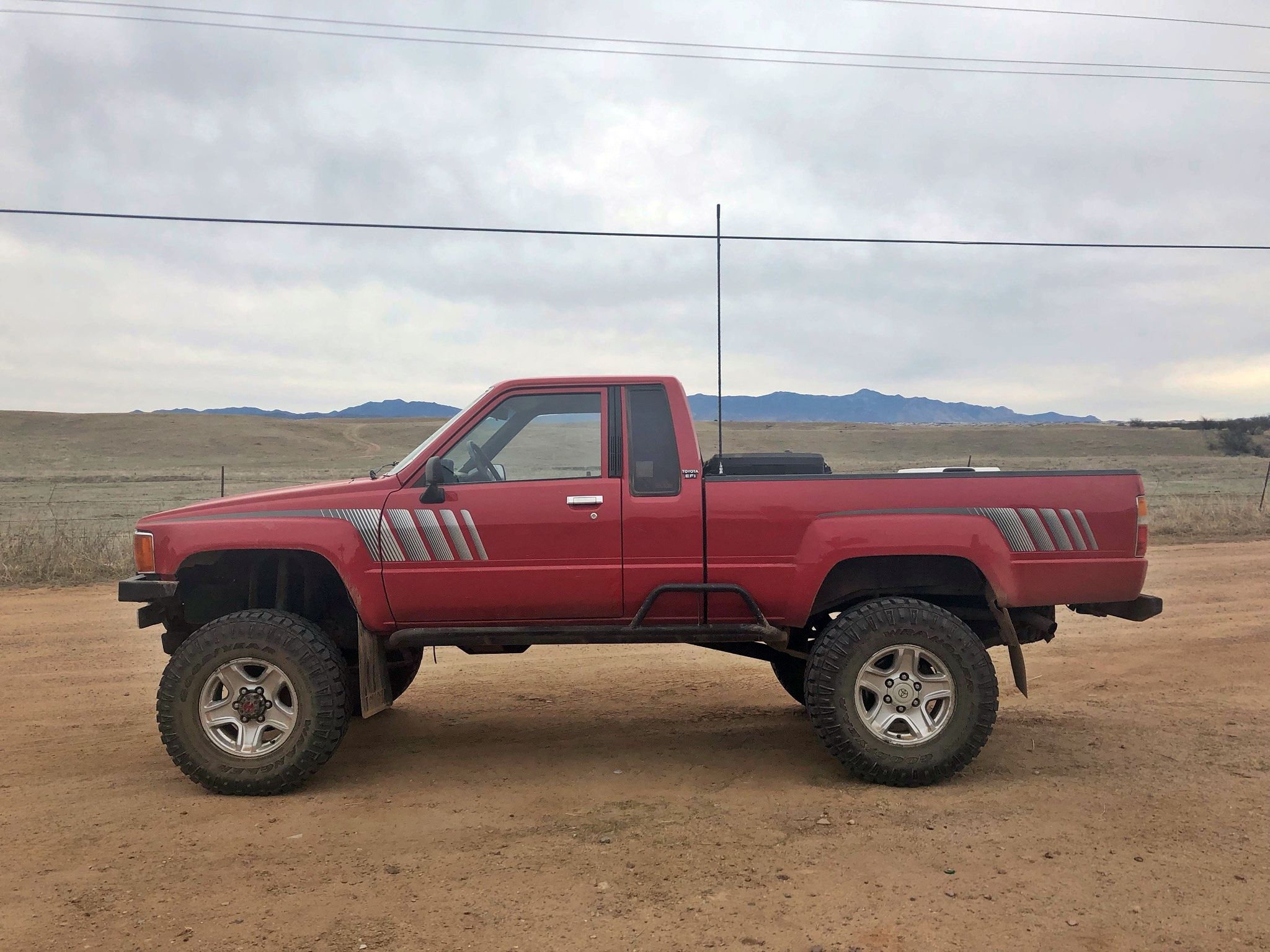

Weird. It looks so low compared to other SAS rigs I’ve seen.
It is about as low as you can get with a SAS, that's by design. I wanted it to pass inspection, which it barely does. But if it was any lower, the tie rod and drag link would hit the frame on the passenger side.
@yotadude520 I don't remember the OME spring numbers, there is a receipt in that binder I sent you from the recent replacement with all the part numbers. Shop name is ScerbFab, right down the street from me.
We’re they springs for a Toyota pickup? Or just something you picked out of their catalog with the right dimensions?
They are the springs and everything that are supposed to fit a solid axle truck of that vintage. The first set of springs I installed on that truck were hand-me-down OME from my old '84 truck, so I designed everything for them to fit. I liked the ride, so when the first set of springs wore out, I just went with the same thing.
