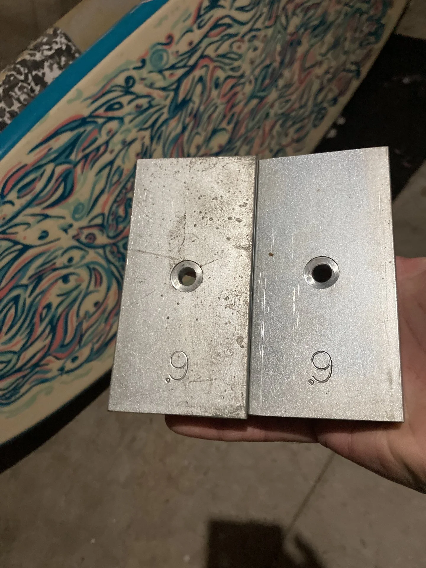

Steel shims to replace the aluminum ones

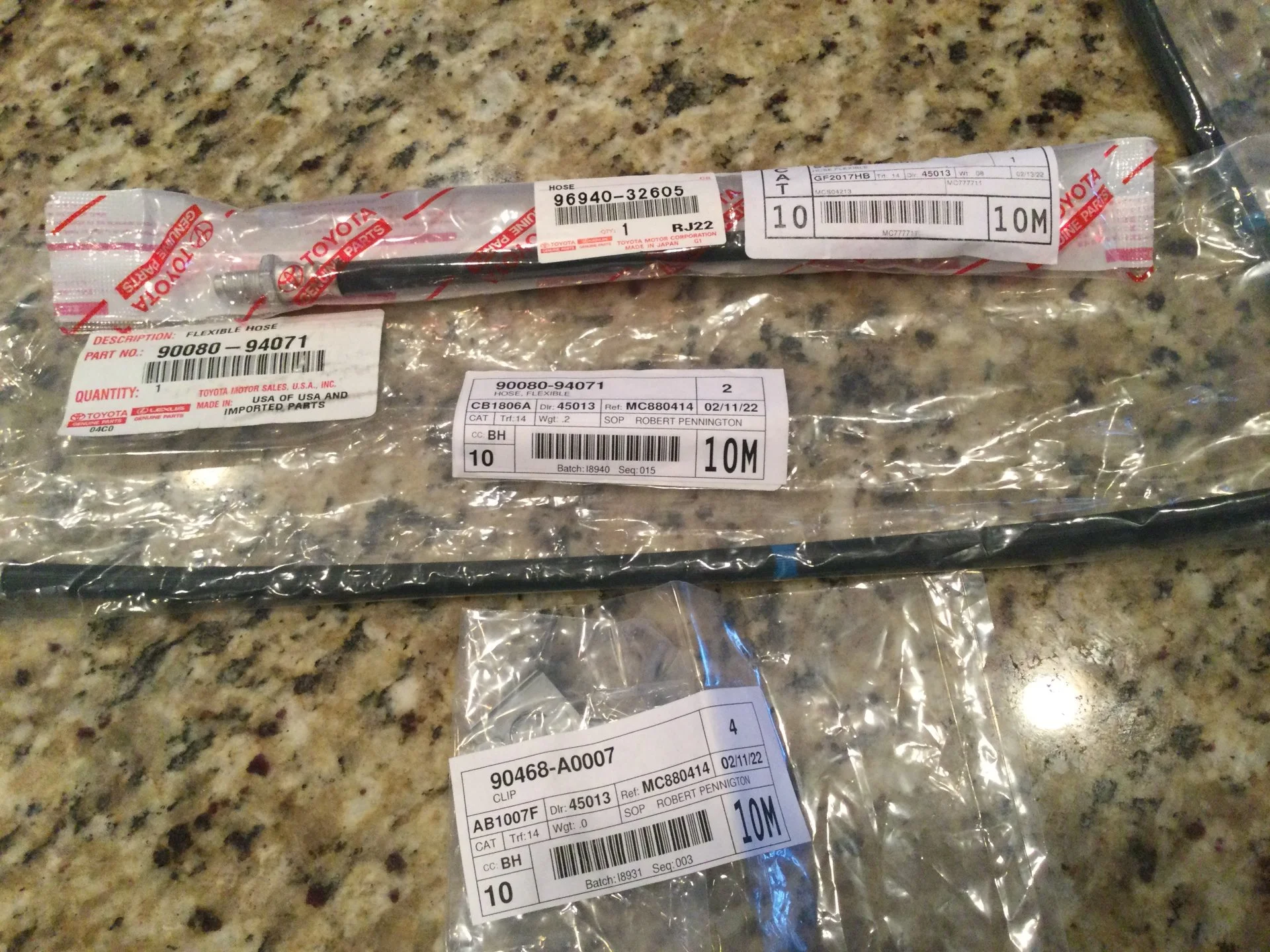

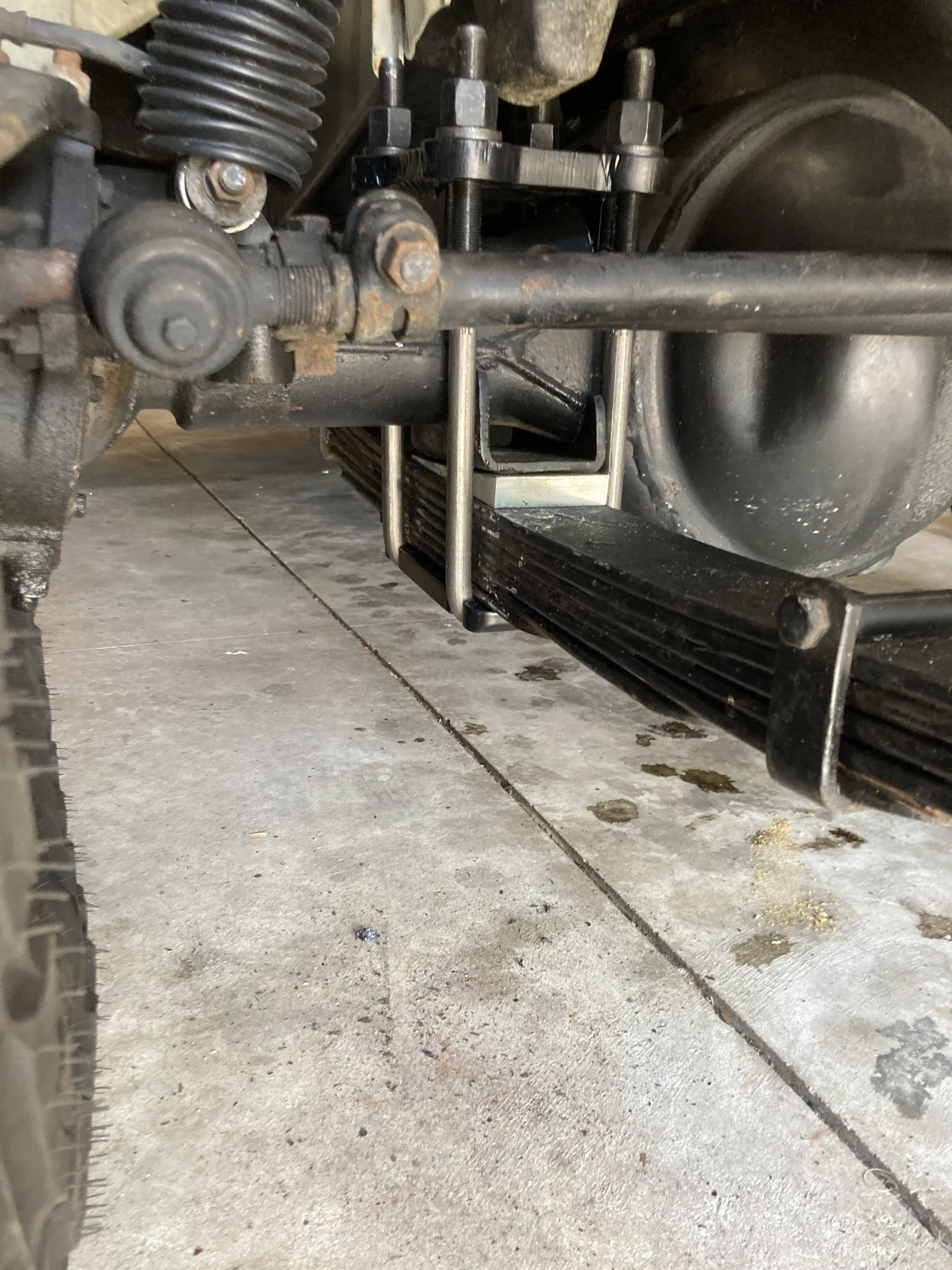

Some progress. The 4plus ubolt flip kit and steel shims went on fairly easy. Had to make a trip to the hardware store to get bolts to hold the new steel shims in place. The center brake hose went on with out a hitch.

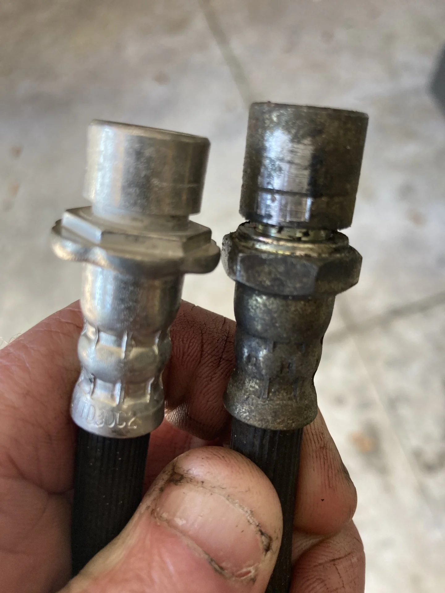

The tundra lines 90080-94071 aren’t rounded in the end therefore I couldn’t get the retainer clip on to secure it to the axle. Ordered OEM and will be returning these.
@Goldbug ……PO left me a huge file with receipts. The lift kit is 2.5 inch HFS from CCOT.
Aluminum 6 degree shims were put on with that lift. I didn’t know if I should change or leave it as is.
So I ordered steel 6 degree.

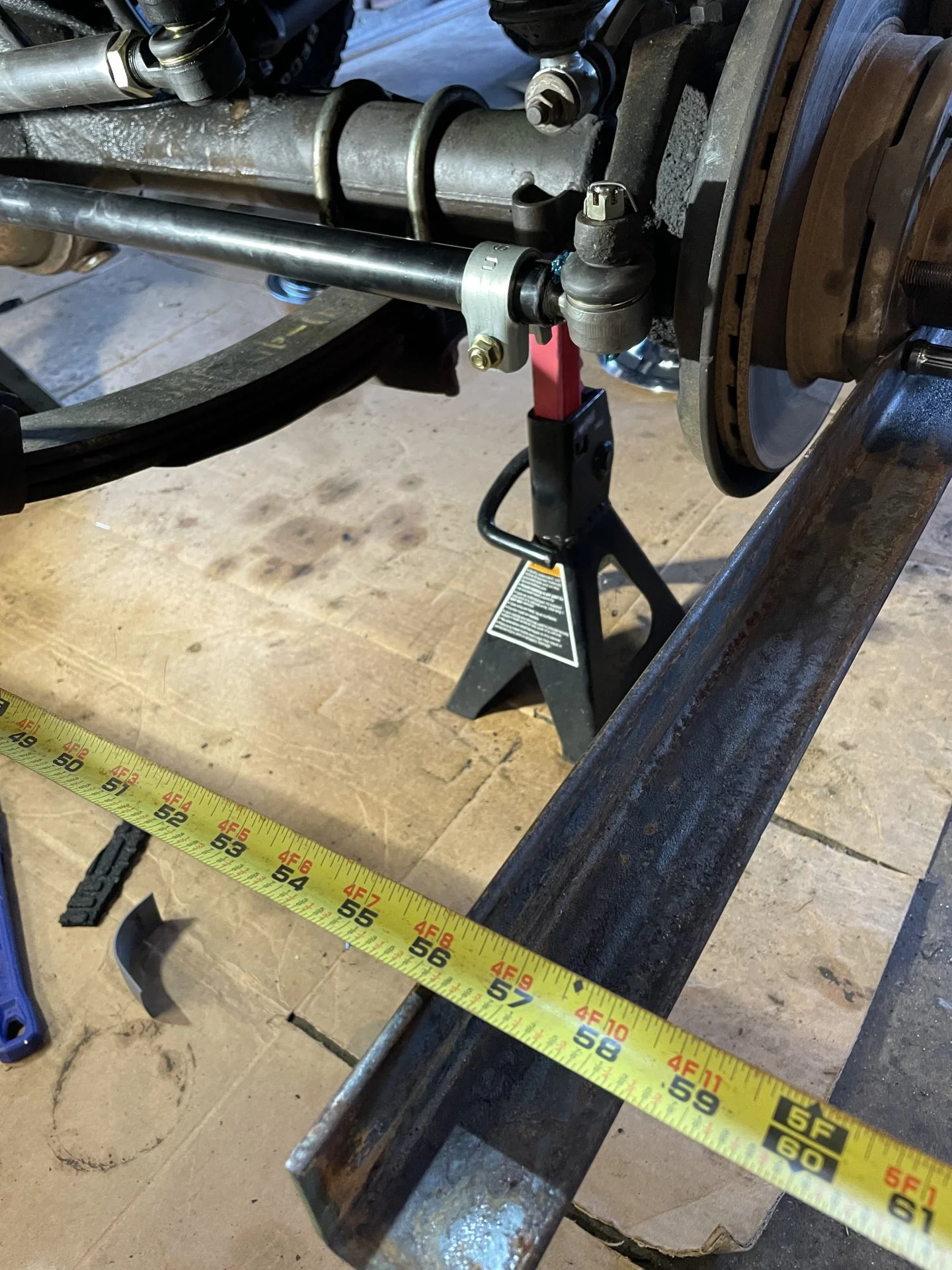

You’re a lucky man. I do think I have a HFS but not sure how high, and no shims currently. Just finished adjusting toe with a home made bracket that worked quite well.

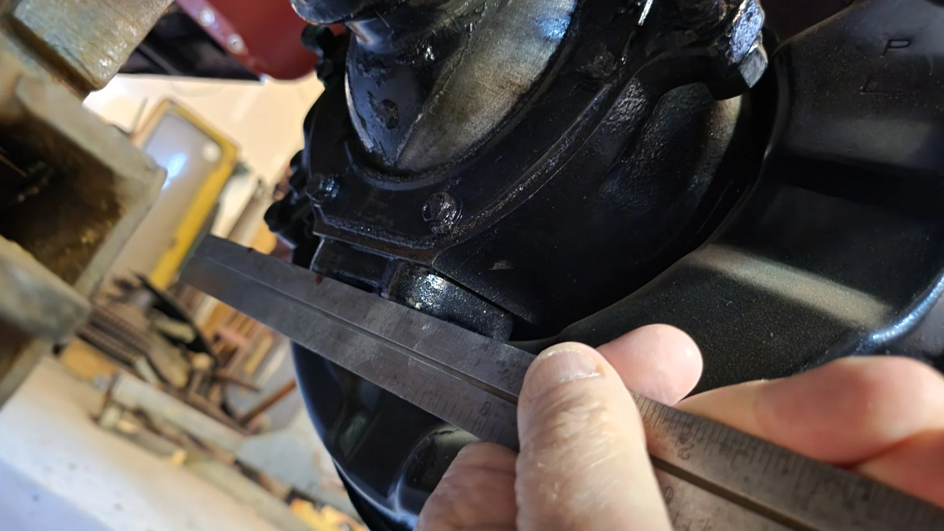

I think I’ll remove my front driveshaft and measure pinion flange. Then order steel from Vaey Hybrids.

What method did you use to measure your caster and decide on 6 degree shims?
Looking at shims and possibly even the flip kit in my near future.
In the past I used an angle finder on the lower trunion bearing cap. You need to be on level ground and all tires have the same pressure. The suspension needs the weight of the vehicle on it. You can do it with jackstands too, but you need to level the vehicle and the stands need to be under the axles. I put the angle finder on the edge of the trunion bearing cap as in the pic below. Don't use the studs, nuts, or washers. It I'll get you close.
This is the most useful post I’ve found so far on caster. Thanks!
Finally found some time to replace those front brake lines. Crazy busy with the kids. Brakes bled

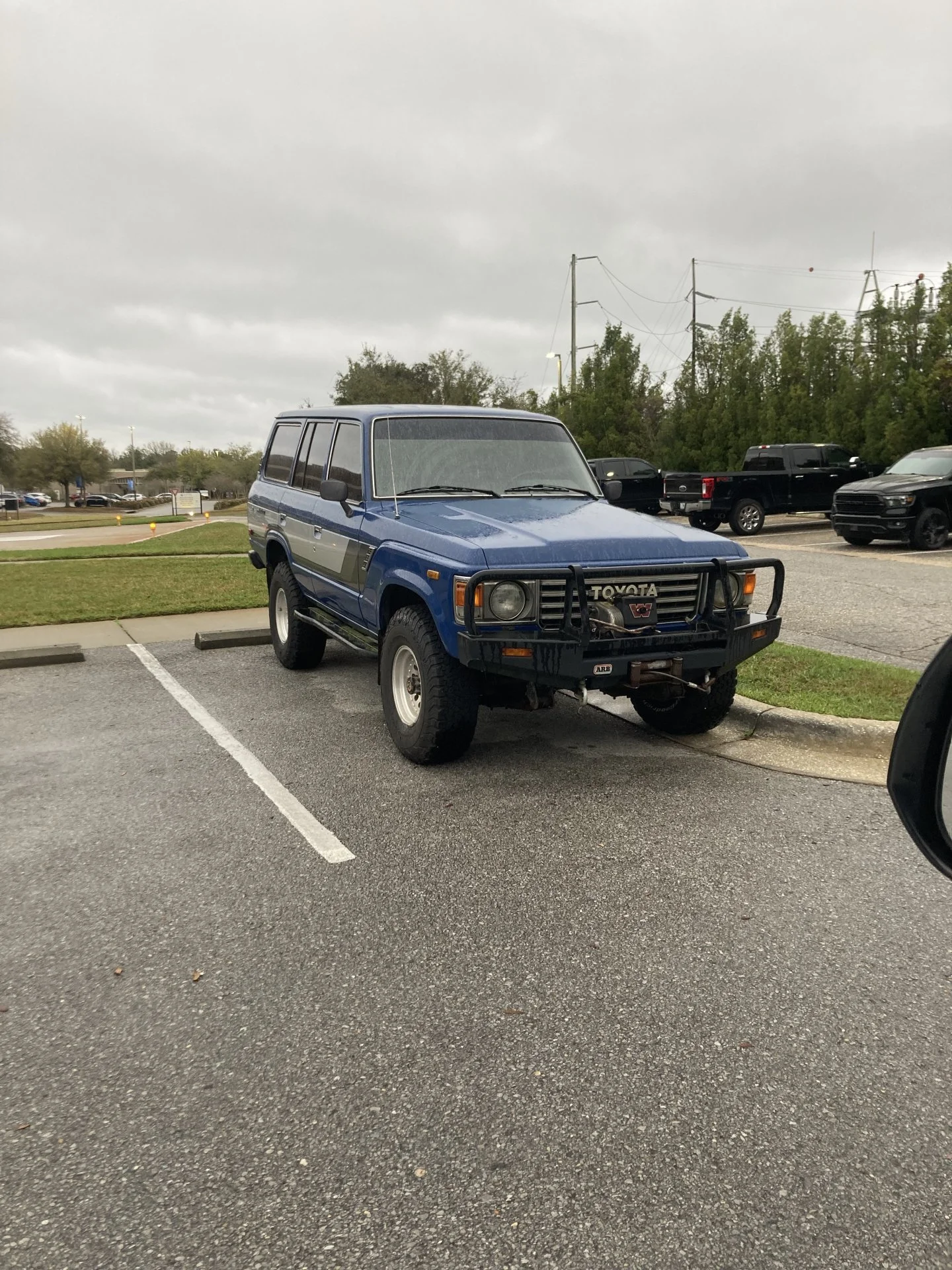

And saw this at my place of employment….have to find who owns it.

And saw this at my place of employment….have to find who owns it.View attachment 2948342
If that’s the one I think it is I believe it’s a h diesel.
I’ve left a note on his wiper a few times over the years when I see it out at McGuires etc. I actually know where he lives from looking at a home in his neighborhood a few years back but don’t want to be to creepy. I sometimes drive it by when stretching my cruisers legs hoping he’ll be outside and interested in cruiser talk.
I’m thinking he works where I work and I’ll find out who owns it.

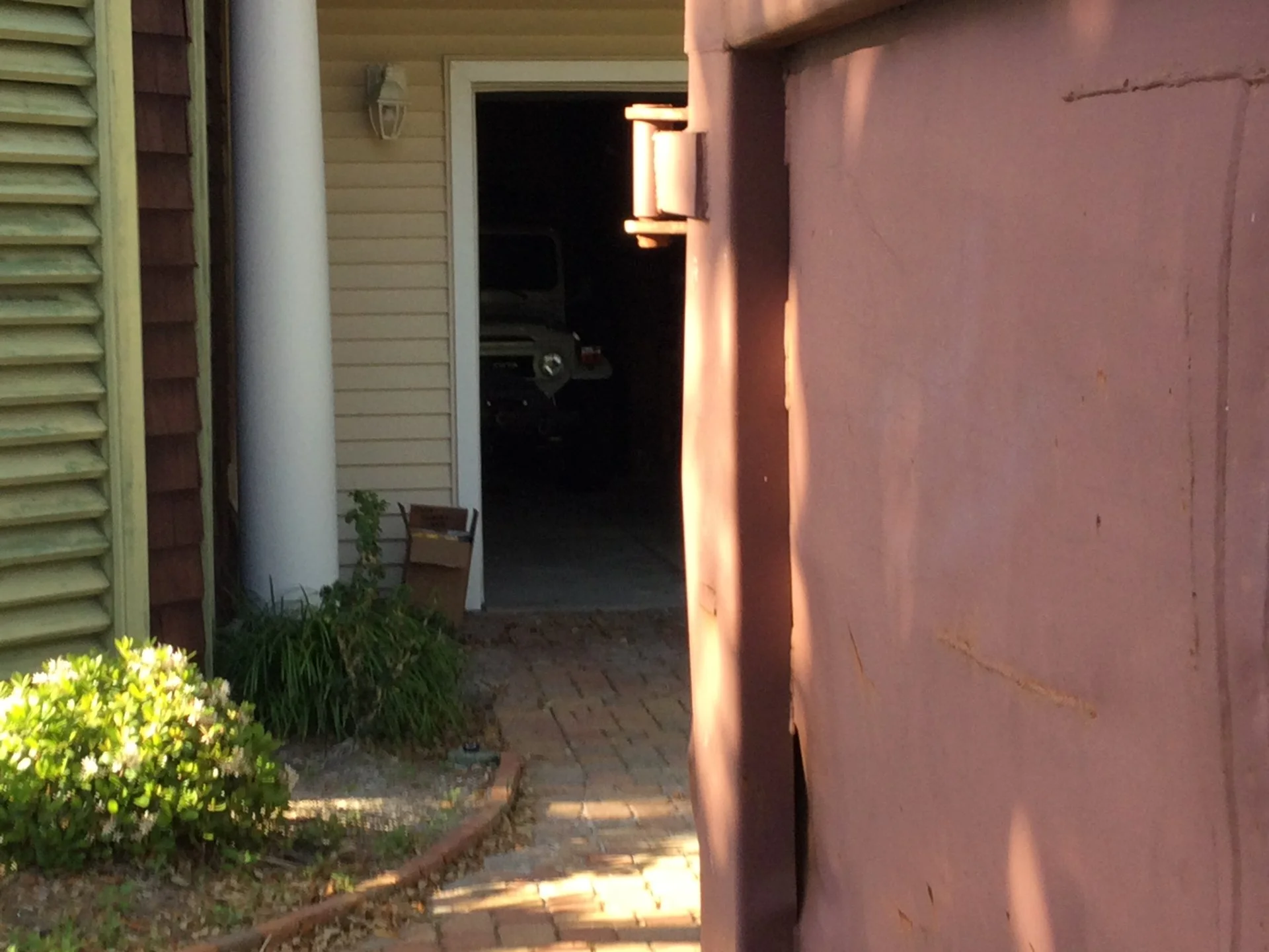

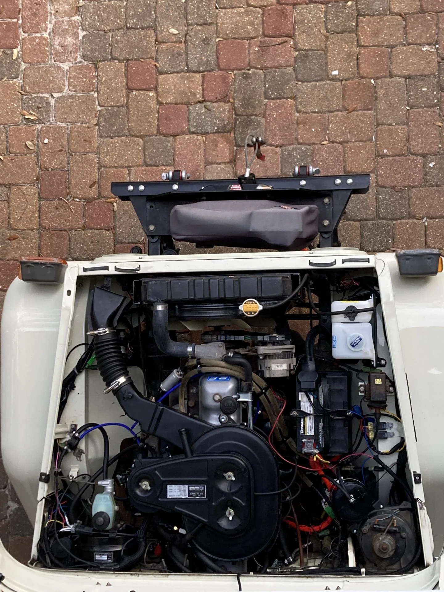

Pulled out of the cave and was able to sneak it between the dumpster and a tree not shown in the photo above.
Talking with @JDNs78FJ40 this afternoon and realized my timing was a bit too advanced. No idea why as I thought I had it set at 10 degrees BTDC Now it’s set at 10 degrees BTDC, idleing at 750RPMs and the IAC on the sniper is reading 2 or 3.
199 miles since sniper install. It is running great. 10.96 mpg
Must have overfilled the tank. Arrived home and found fuel leaking from the line that goes from CC back to the tank.
Fooling with my timing last week my sweet spot is about 8 degrees without a sniper with a freshly rebuilt head. My compression is a bit high and I had some pinging. Need to check vacuum next and adjust the valves.
