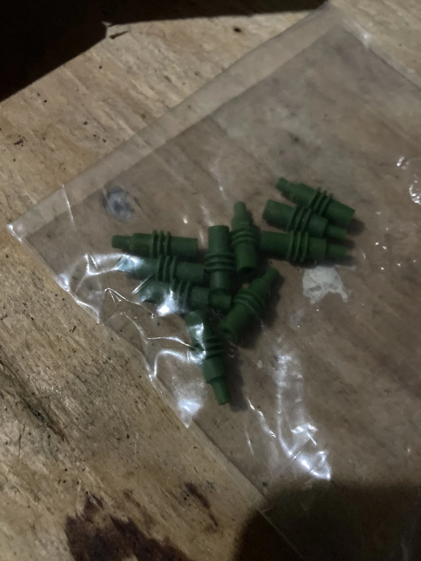

The terminal removal tool arrived as did some rubber plugs which @JDNs78FJ40 was kind enough to share.
Thank you. I will get the 10 pin from the sniper harness waterproofed this weekend. Left work today and had a cousin 4 times removed parked next to me
Thank you. I will get the 10 pin from the sniper harness waterproofed this weekend. Left work today and had a cousin 4 times removed parked next to meView attachment 2917723View attachment 2917724
You are welcome. Glad I read your post and remembered I needed to weather proof my 10 pin connector.
