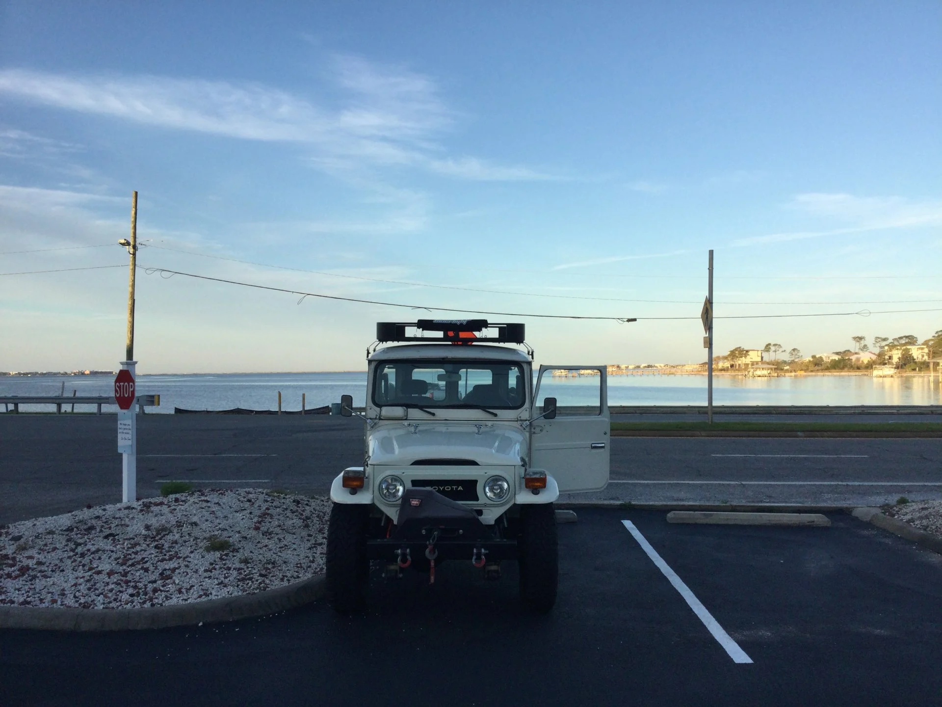

Been driving the 40 all week…..the weather has been perfect. They always look better with water in the background.
If things go as planned she will topless one week from tomorrow.
