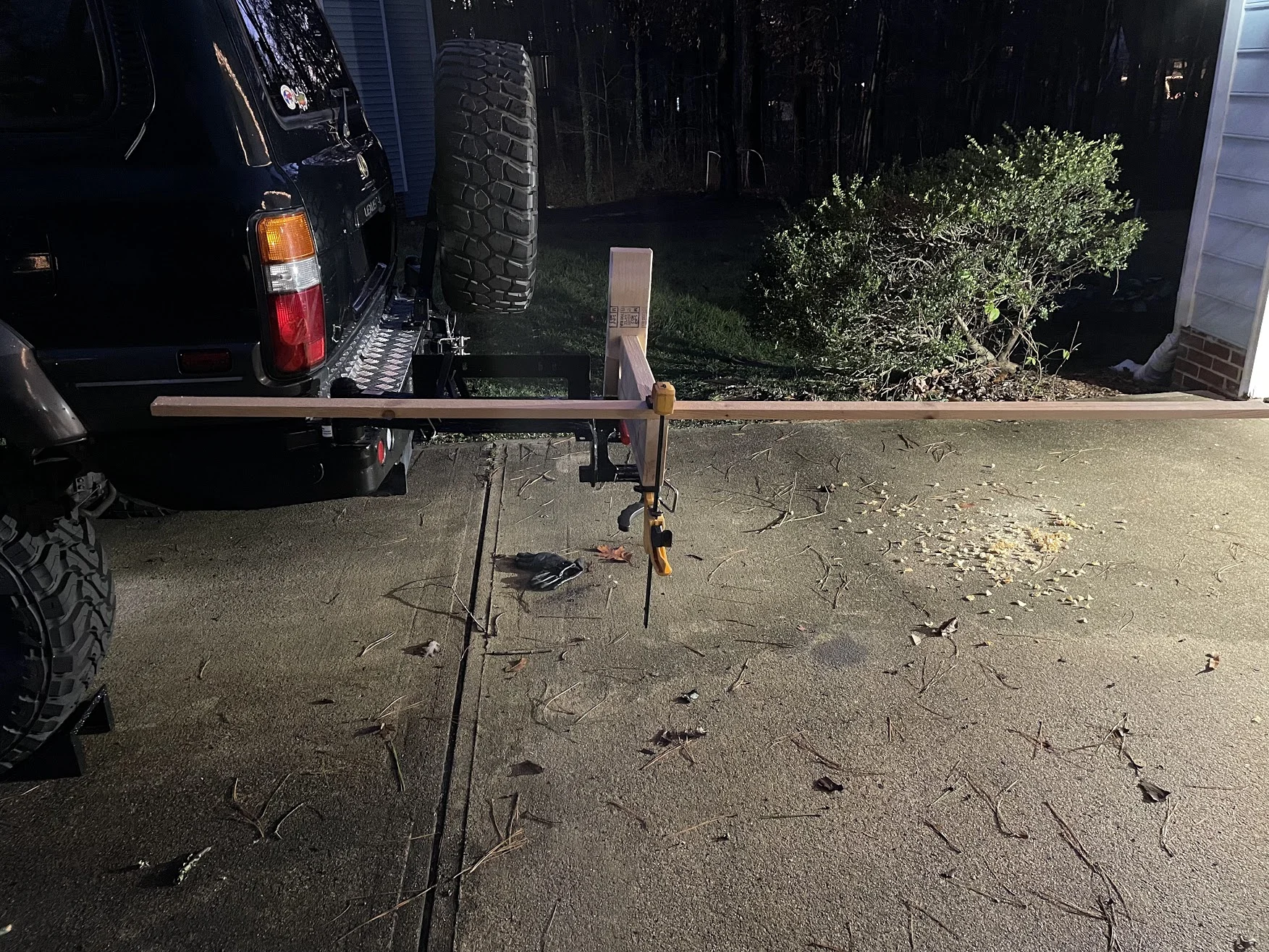

While waiting on parts, some bicycle rack thoughts:
Goals:
Mount the bike rack up on the bumper swingarm, so access to rear drawers / being able to use the tailgate as a seat
Remove the factory hitch receiver.
Be able to attach a 2" receiver for the rack.
This overall represents my bicycle dimensions (the vertical stick is ~5" shorter than my bike):
80" long 44" tall
And the ideal location of the bike (Bike is roughly centered, but is still wider than the cruiser 😅 ).
Ideally, I would like to install something as close to the middle as possible so the bike stick out would be as even as possible from side to side.

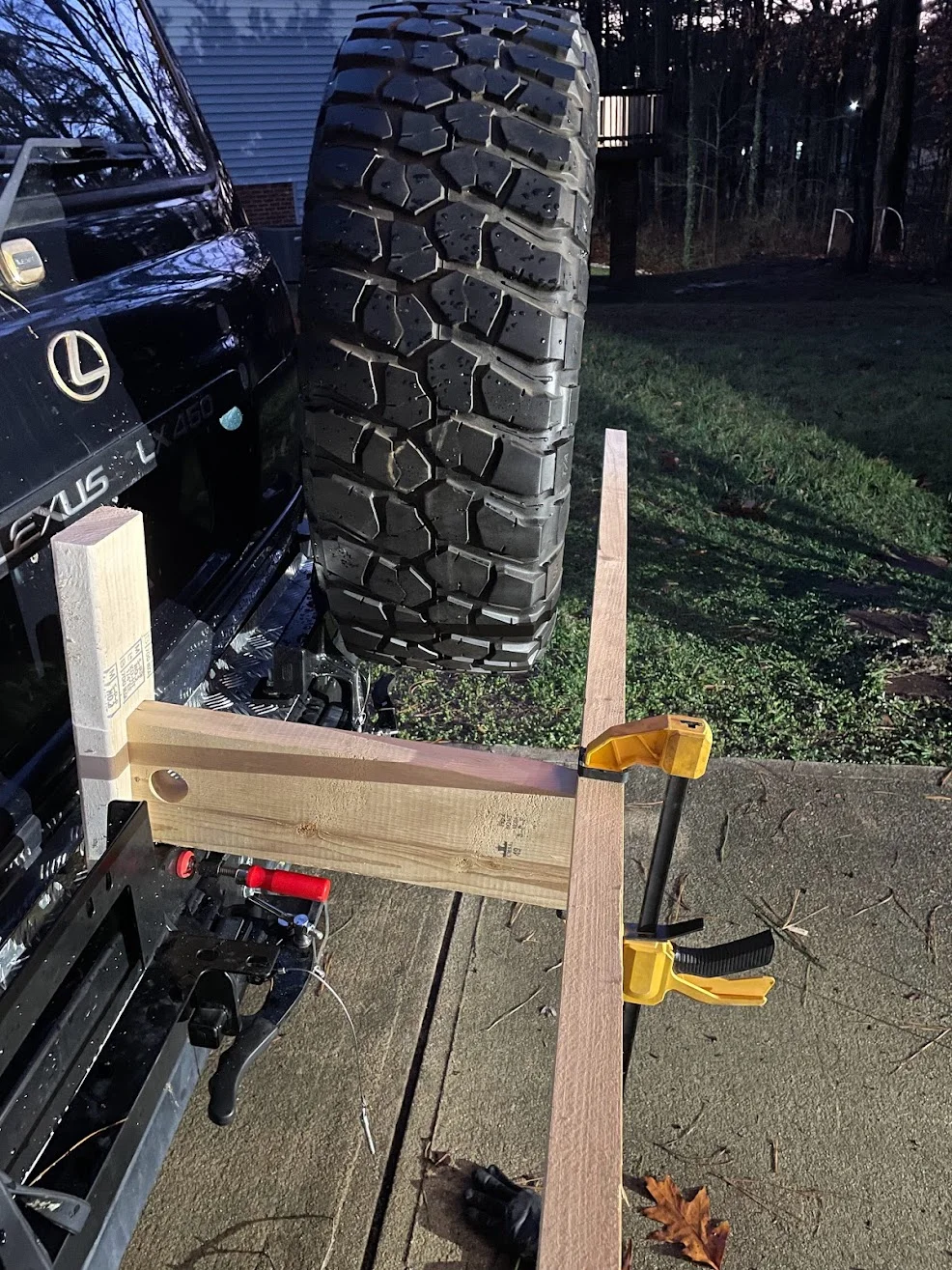

The below 2X6 (piece of wood in the middle) is 5.5" * 18.25" which is juuuuuuuuust the right dimensions.
That 18.25" would include both the hitch / rack assembly and the first tray that the bike sits in would be at ~18.25"

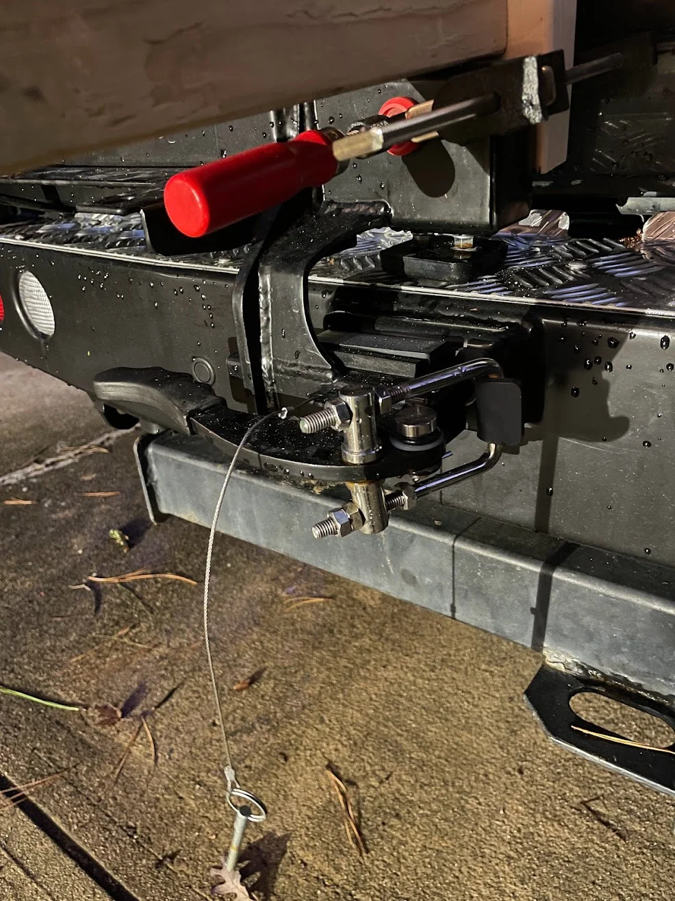

Good news is that where the swingarm has the latch is very sturdy, and there is no play in the arm once the arm is closed up.
Rack at swingout:

I like this idea (and will at some point do the same for the 100--"need" a bumper first). Over on the 100 forum the consensus is that 1UP racks are ideal since they have a better interface with the hitch which does not wobble all over. I know that Dissent and BIOR both offer 2" hitch receivers as a custom option on their swing outs. You know someone that welds well enough to trust your bike to the new receiver? Also sounds like good idea to watch the hardware on the swingout at least for a bit once you add the rack. A few ideas/thoughts are here: Dissent Rear and Swing Arm Bike Racks? - https://forum.ih8mud.com/threads/dissent-rear-and-swing-arm-bike-racks.1231062/page-2

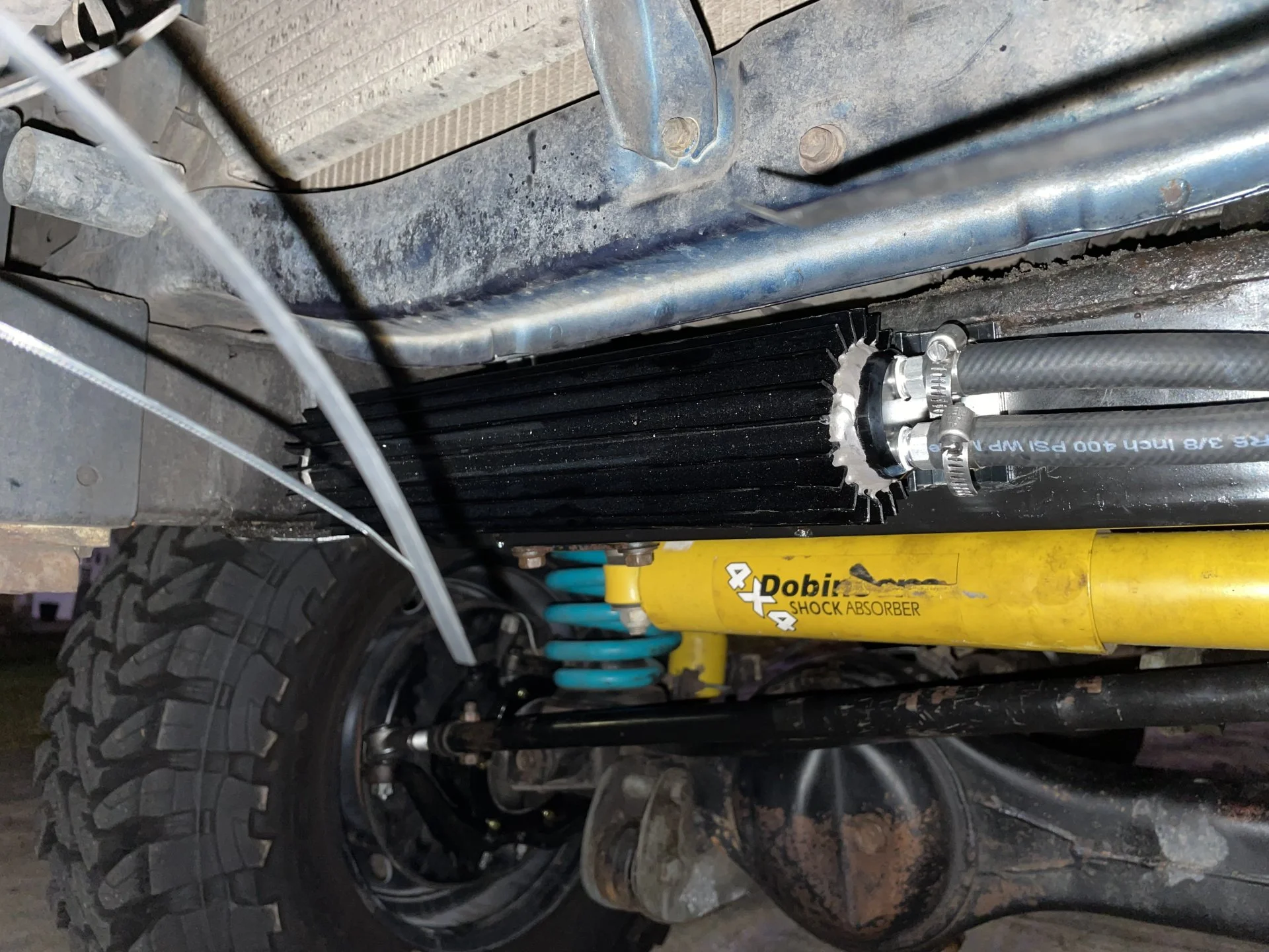

My knockoff Wit's end power steering cooler is in place / bled:
Feels nice to have functioning powersteering again :D :D :D :D :D
