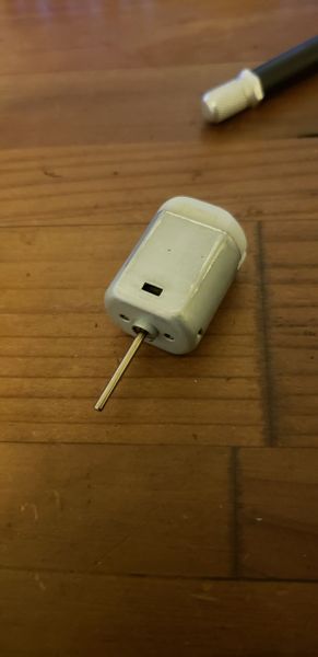

mmm, also discovered today that neither of the rear doors lock when using the power lock system.
Found this thread:

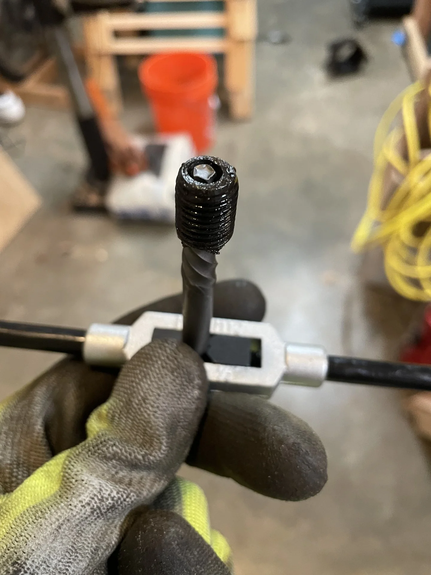

Fixed the issue with the busted stud, thanks to easy outs for working like a champ!

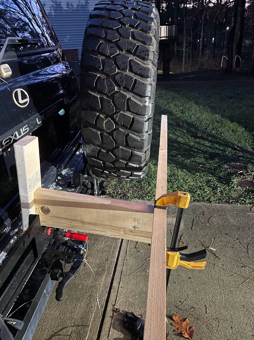

While waiting on parts, some bicycle rack thoughts:
Goals:
Mount the bike rack up on the bumper swingarm, so access to rear drawers / being able to use the tailgate as a seat
Remove the factory hitch receiver.
Be able to attach a 2" receiver for the rack.
This overall represents my bicycle dimensions (the vertical stick is ~5" shorter than my bike):
80" long 44" tall
And the ideal location of the bike (Bike is roughly centered, but is still wider than the cruiser 😅 ).
Ideally, I would like to install something as close to the middle as possible so the bike stick out would be as even as possible from side to side.
The below 2X6 (piece of wood in the middle) is 5.5" * 18.25" which is juuuuuuuuust the right dimensions.
That 18.25" would include both the hitch / rack assembly and the first tray that the bike sits in would be at ~18.25"

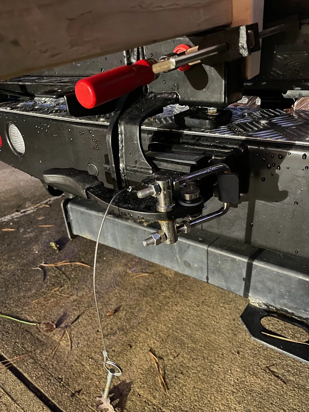

Good news is that where the swingarm has the latch is very sturdy, and there is no play in the arm once the arm is closed up.
Rack at swingout:
