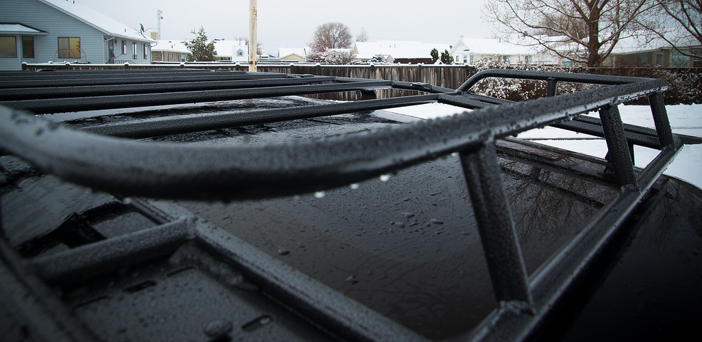

Well, I don't want straight black. I think I need to break it up a bit. I was thinking something similar to this:
I can't be the first to think of doing it in red to match the turbo decals, can I?
Or matched to the bumpers/sliders...
Dan

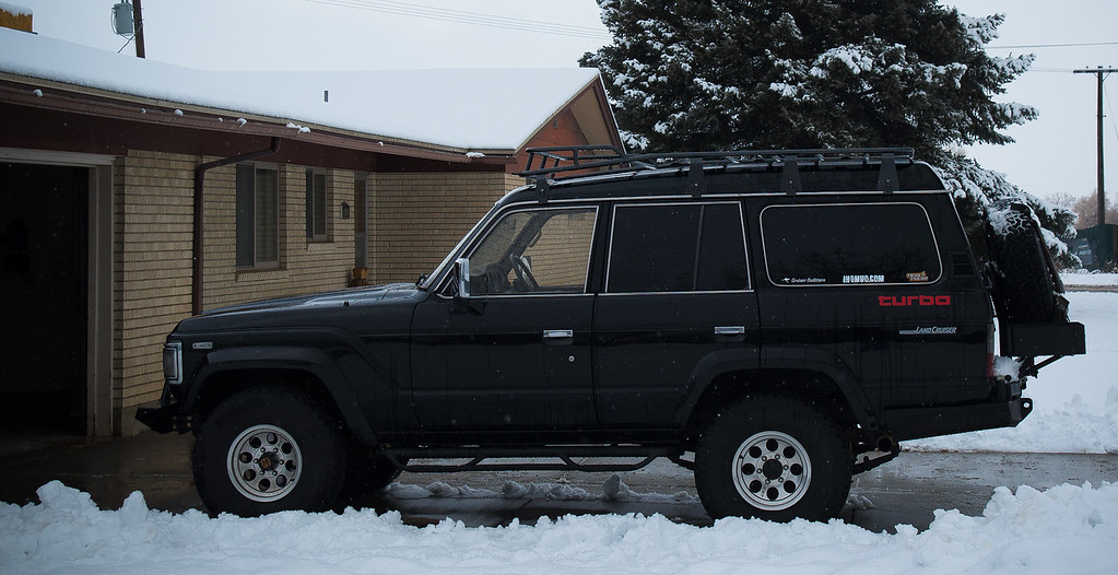

Dan

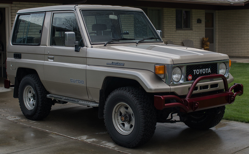

I have thought about that, but I have given the wife so much crap over her choice of color for her bumpers that I'm not sure I can do that! Lol Then again that was red on gold, not red on black! Lol Pic for reference:
Mrs Tibbs needs some matching sliders....
J

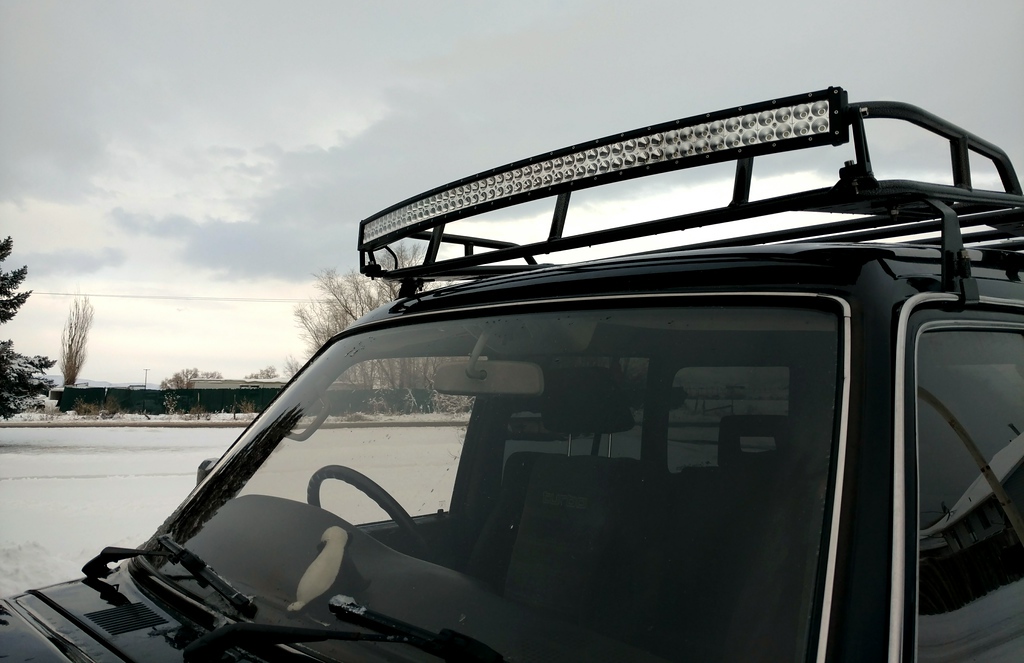

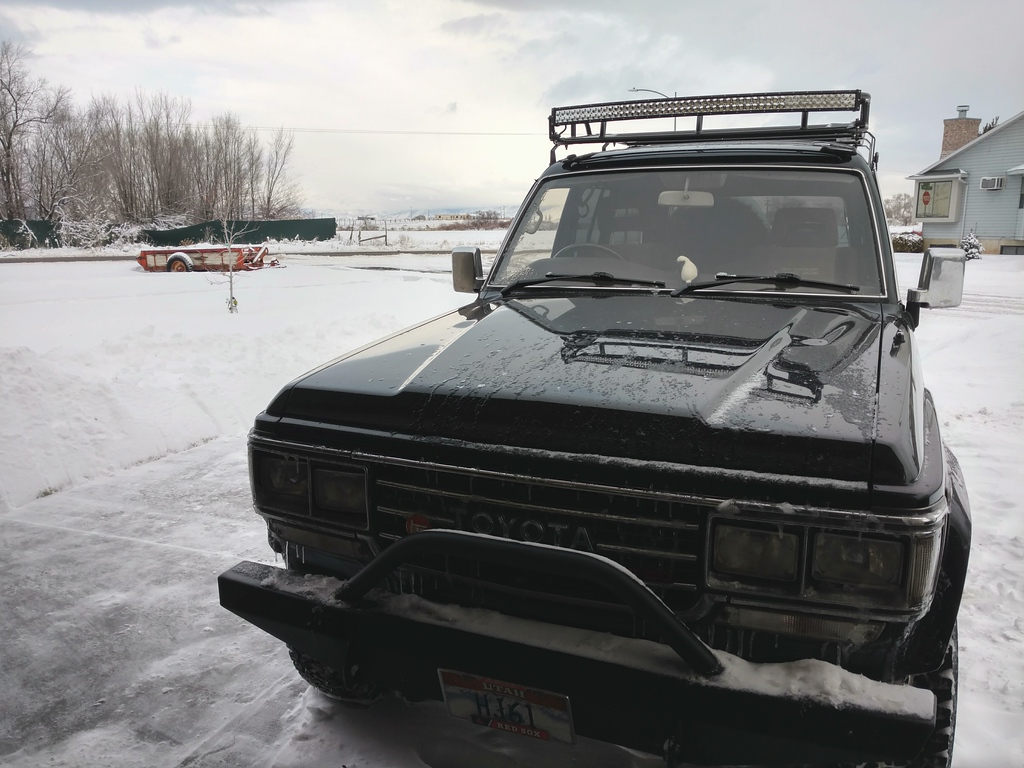

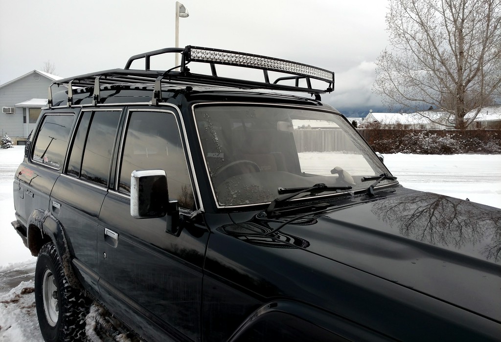

SNOW DAY!!! I went to work this morning and promptly turned around and came home. Snow+wind+Utah drivers= my 1.5 hour to the jobsite would have taken at least half a day. Instead I came home and tried to get something done on Stoffel! But, 20F temps and wind that is normal for Wyoming didn't make that easy. All I got done was installing the LED light bar on the new rack, and that 15 minute job took about an hour with all of the warm up breaks I took! Anywho, I think it looks pretty sharp up there! I did swap out some of the supplied hardware for hex head SST bolts and used medium duty thread locker to at least slow down any potential thievery. I hope to have it wired up in the next month or so if it will ever warm up a bit here! Thoughts??
