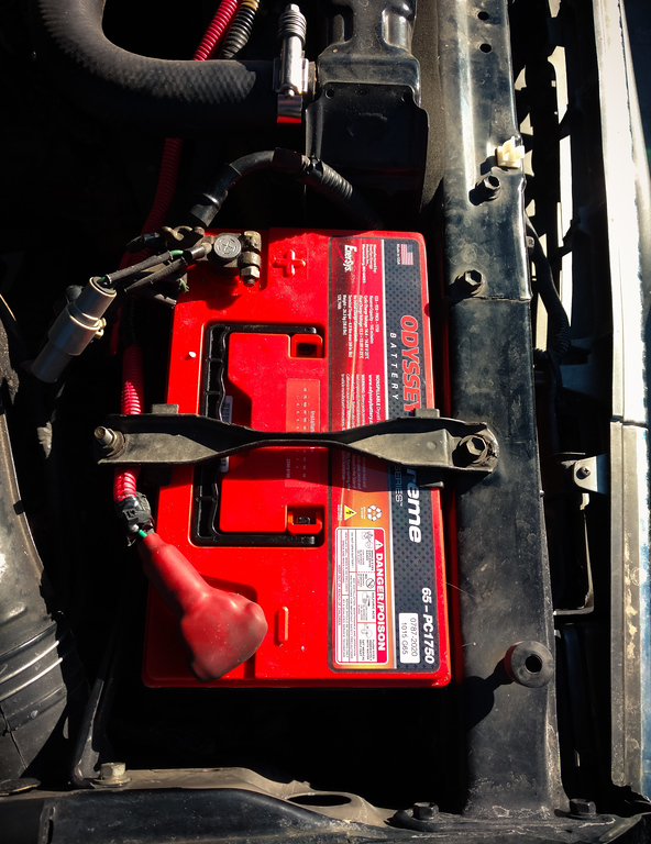

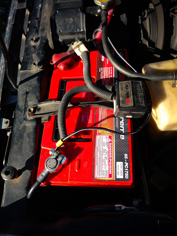

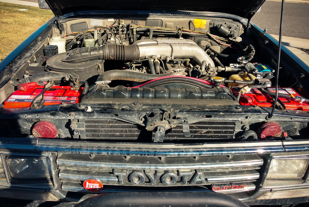

Thanks for all the kind words! It's been a blast updating this rig. The wife and I wanted this to be an expedition type rig that we can jump in and go anywhere, anytime. I think we are getting to that point! There are still more plans for the future but we are pretty damn happy with it as is. Speaking of upgrades, today I threw in two new Odyssey batteries. I opted for the 65 group size over the 34 group size that was in there for more CCA's and well, because I could!;) I did have to make some wood spacers to place under the batteries because they were not as tall as the stock size and extend my ground wire to the chassis, but I think it will be worth it!

Side note, while replacing the batteries I noticed a wire coming off the positive side (24 volt positive side) leading under the vehicle. I removed the battery tray on the left side and saw that it leads to a motor of some sort and then goes under the rig to......nowhere. Seriously, it's a thick gauge wire (battery cable size) that appears to have enough lead to go to the front of the vehicle but is not hooked up to anything. Any ideas what the hell this is for?
And no, in my infinite wisdom I did not take a picture.:bang:
Nope, it's about the size of a solenoid on a starter motor. Looking at some electrical drawings it appears to be part # 38630-60070, but I have no idea what it is for and why there is such a large lead wire coming off of it going to nothing?:meh:
Its appears to be a magnet switch for the winch. Which would make sense as the size of the cable would be appropriate for a high amp draw winch.
Expensive little booger - cheapest I found the OEM part for was $230.00 - on the high side it was $487.00! Don't loose that lil jewel.
