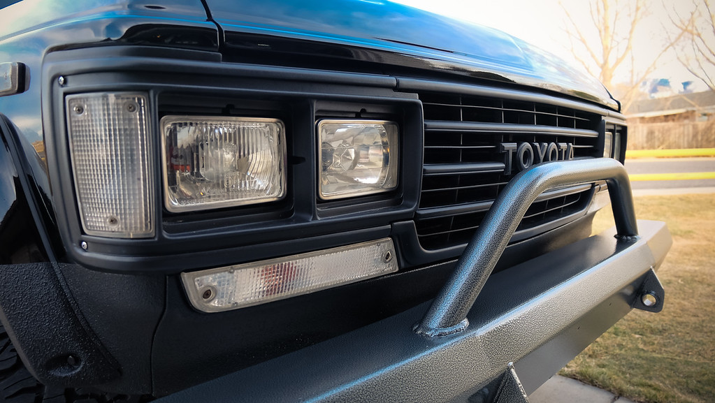

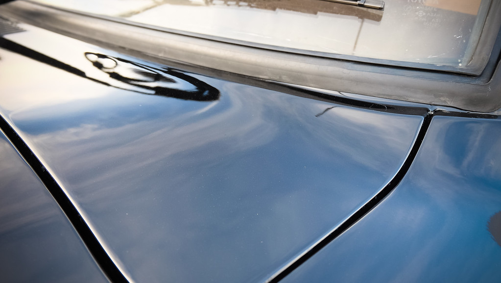

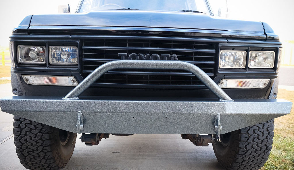

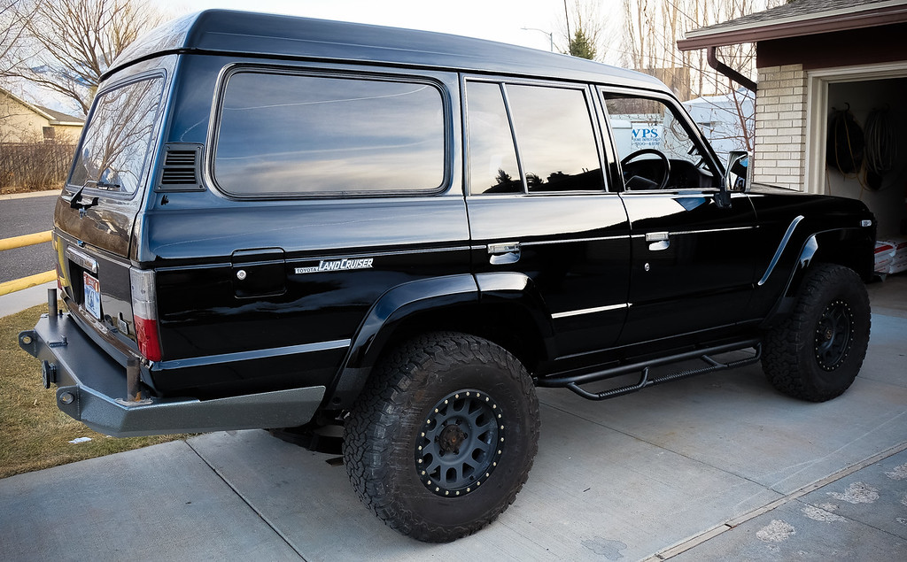

Got it back from paint last night! I'm still putting the pieces together but so far it's looking great!!
Looks phenomenal. Money well spent enjoy it!

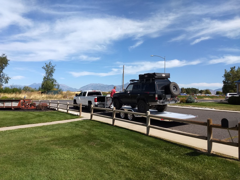

DEFEAT!! I give up!! I have been fighting issues with the brake system that might actually be an issue with the vacuum system??!! I don't know, I just know that I am done throwing parts and money at it. Sooooo, off to the mechanic it goes and I can throw parts and money at him until it's fixed!
So far I have replaced the brake booster, played with the master cylinder, replaced pads, and even replaced the vacuum pump at the insistence of a different mechanic. Nothing, nothing is working and I still have a hard pedal with next to no brakes at all. Also, it has started to keep running when I turn the key off at times (hence the vacuum issue??). I'm at a loss here, off to the mechanic. Damn.
