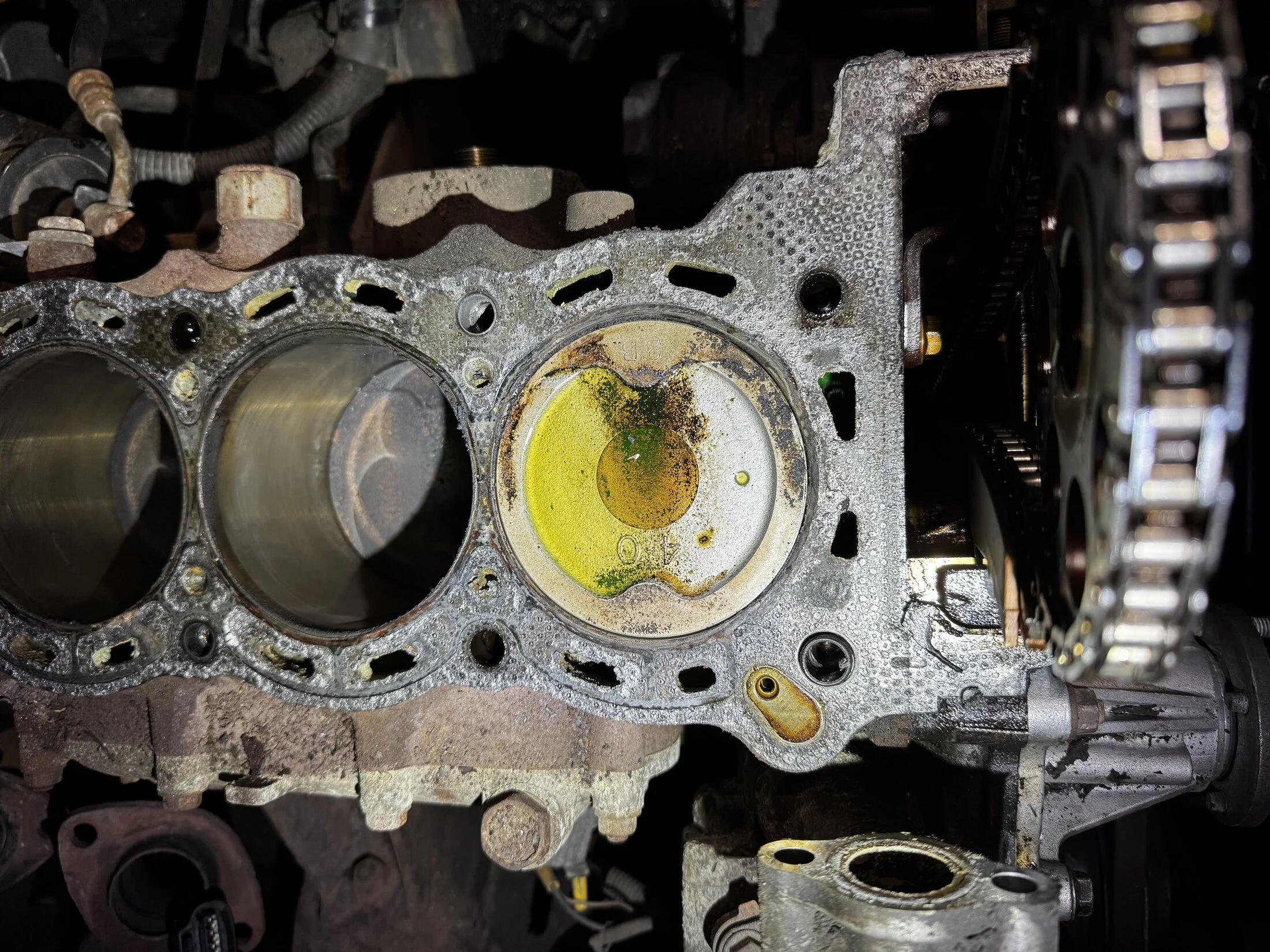

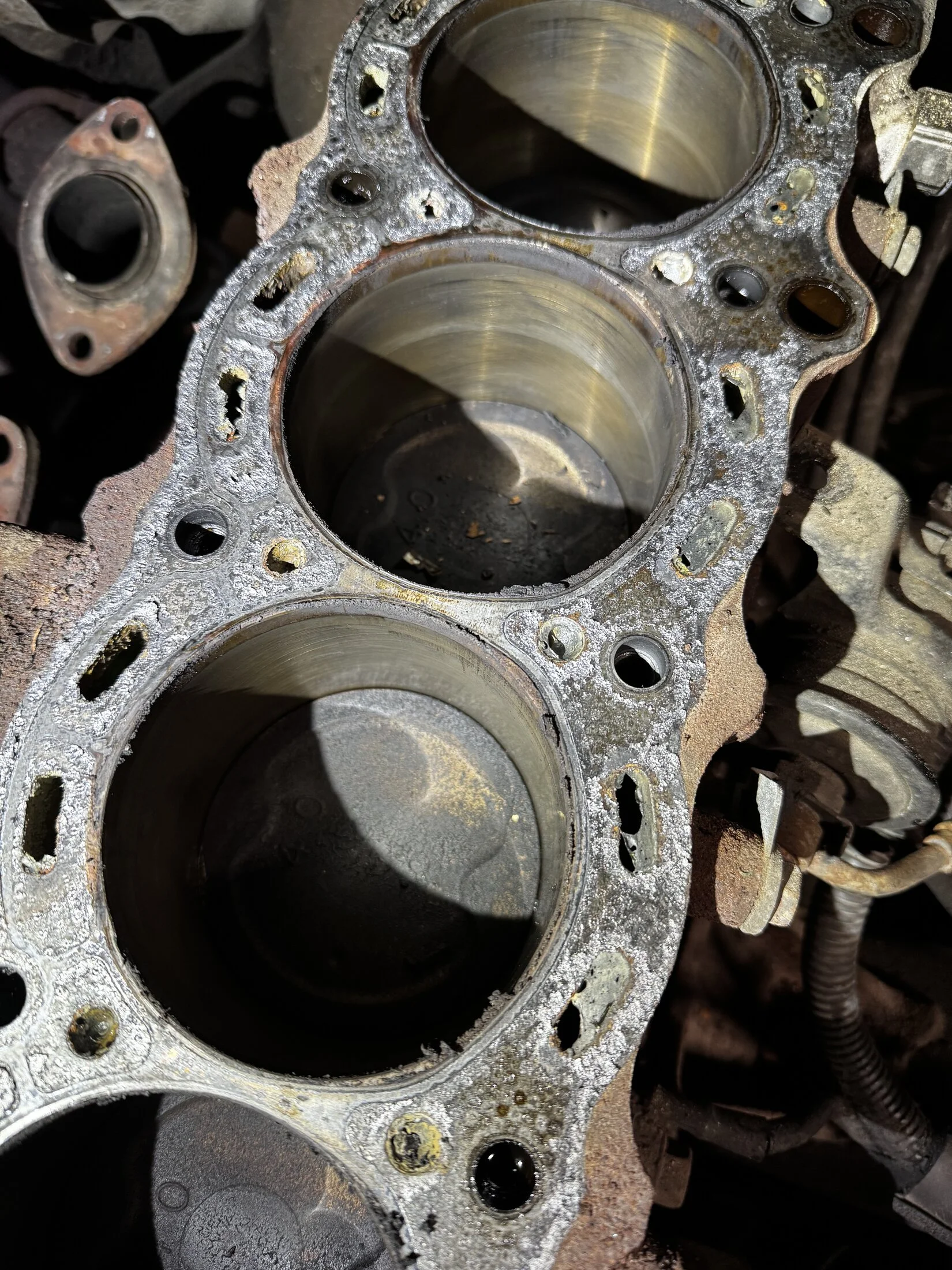

Unfortunately after removing the head they have claimed that my short block is toast and my cylinders have been previously sleeved and are no longer round and therefore cannot be repaired. Additionally my timing chain guide is broken.
Is this truly a time for a new engine block ?

Well, someone is pulling your leg.
That engine is not "sleeved" because it's a gas engine, not diesel.
I can still see the cross-hatching on the cylinder walls and minimal wear. There are no offset shiny areas within the cylinder walls.
Tell us the conditions of head gasket failure. What, when, and how that happened.
Yes, it's very possible the timing chain guides are broken.
Have the head reworked, install new timing chain and guides.
I would specifically ask for actual cylinder measurements on each cylinder (using a bore gauge) then you can determine if the cylinders are out of spec.
Of course, the person doing the measurements must know how to PROPERLY use the tools to measure them.
I always question shops when they automatically say you need a rebuilt engine.
If you need, order a new 1FZ short block direct from Toyota and all the timing chain and kit parts. About $4500 for the short block.

There's nothing hideous in those pics, but hard to say from two pics.
Option A should be . . .
Find a new mechanic for a second opinion.
Or take a heap of pics of the cylinder walls, the top of the block , the head & combustion chambers.
(I don't see where the head gasket failed??, although #1 piston sure looks steam cleaned)
Option B . . .
Clean it up, install a new head gasket and timing chain guides (4/5 of the disassembly is already done), and continue to run it.
The pics of the cylinders look pretty decent.
I guess the sump oil is probably already contaminated, but if not, an oil sample analysis could tell you if there's any signs of bearing failure.

I second this the picture tell a different story then what the shop is saying.

Nothing there looks particularly alarming and timing chain guide broken isn't uncommon.
Are they assuming the head gasket which is still sitting on the deck of the block, is the deck and hence they think they can see sleeves?
To my knowledge, no Land Cruiser engine since ~ 1985 has had cylinder sleeves from factory.

What they are seeing is the headgasket is not perfectly round for the valves. The cylinders still have cross hatching!!!
That shop is not one I would trust for major work.
I echo the comments above, as soon as they said it had been sleeved before, you know something is wrong. Even if it had been rebuilt, these can be rebuilt at least two times before a new block is needed. They were meant to be rebuilt.
As stated above, more pics would be good and without the head gasket in place so we can see the surface of the block. The cross hatching in the cylinders are still easily seen. As long as there is no pitting where you can feel it with your fingernail, get a new head gasket and have the head rebuilt. It should be good for at least another 100k.

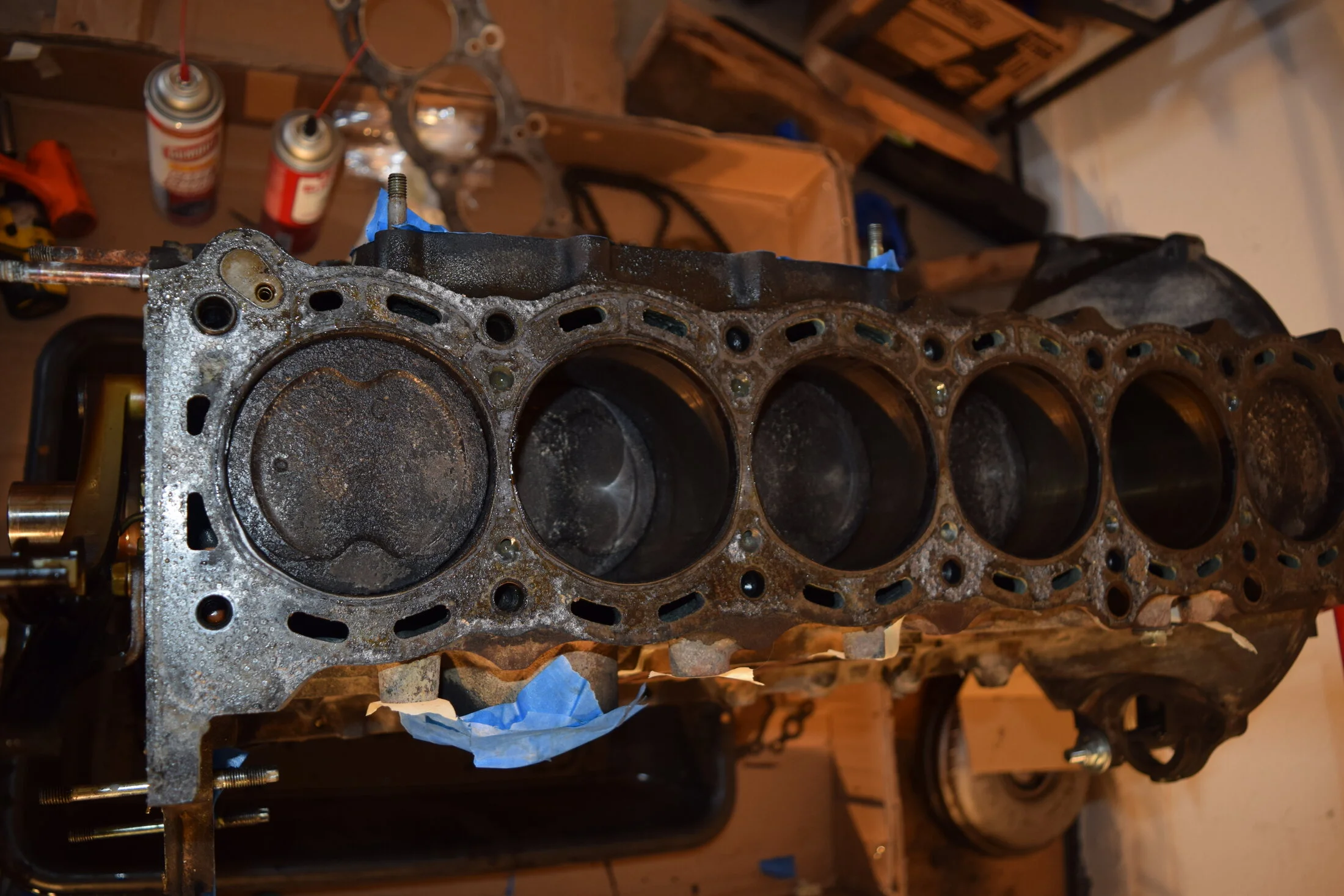

I rebuilt mine 45k ago with several people saying it was not necessary, just to replace the head gasket. Mine looked worse than yours does.
I haven't been inside of one of these motors (yet), but it looks to me like the crosshatching is a little random, so maybe rebuilt once already? Also, the water journals look a bit crust from the top at least, so I'd plan on a full rebuild (by someone else), or a drop in from a running truck to get you out of there without too much pain. That said, @Fj80oregon does offer a great option too, and if you look at what he does, for a very fair price in my opinion.
