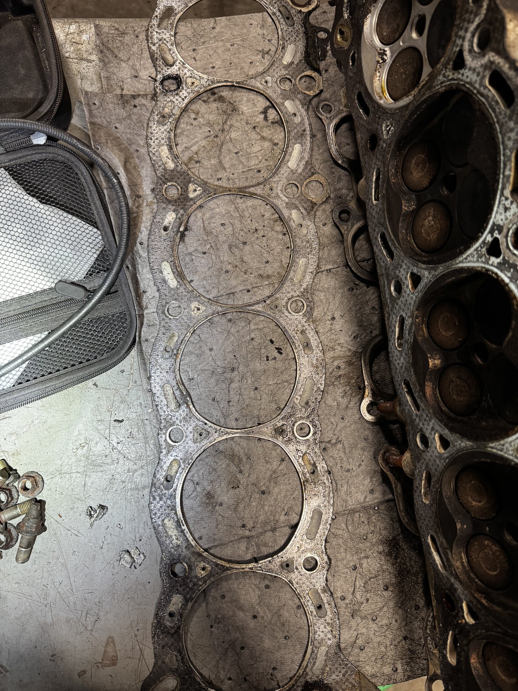

So… regarding the head gasket failure… I was driving highway speeds 65mph… noticed the temp gauge rising, which I knew was very unusual. Pulled over and allowed her to cool down for a while… no obvious leaks anywhere and the (entire cooling system had recently been replaced with a new koyorad radiator and all new OEM hoses, including a rear heat bypass).
I drove for about another 0.1 miles and found a lot of white smoke and saw the temps start rising again. pulled over and called for a tow. I never got the temp needle into the red, but assumed it had to be the gasket. The shop made the final diagnosis.

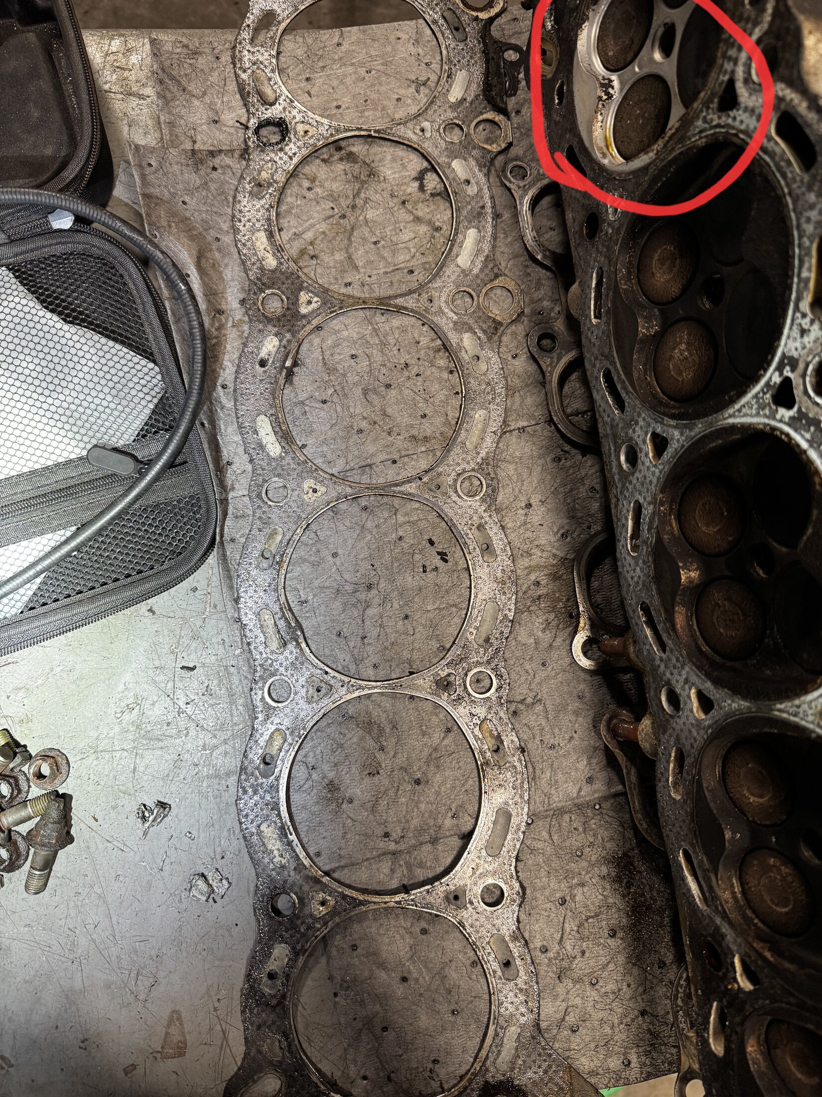

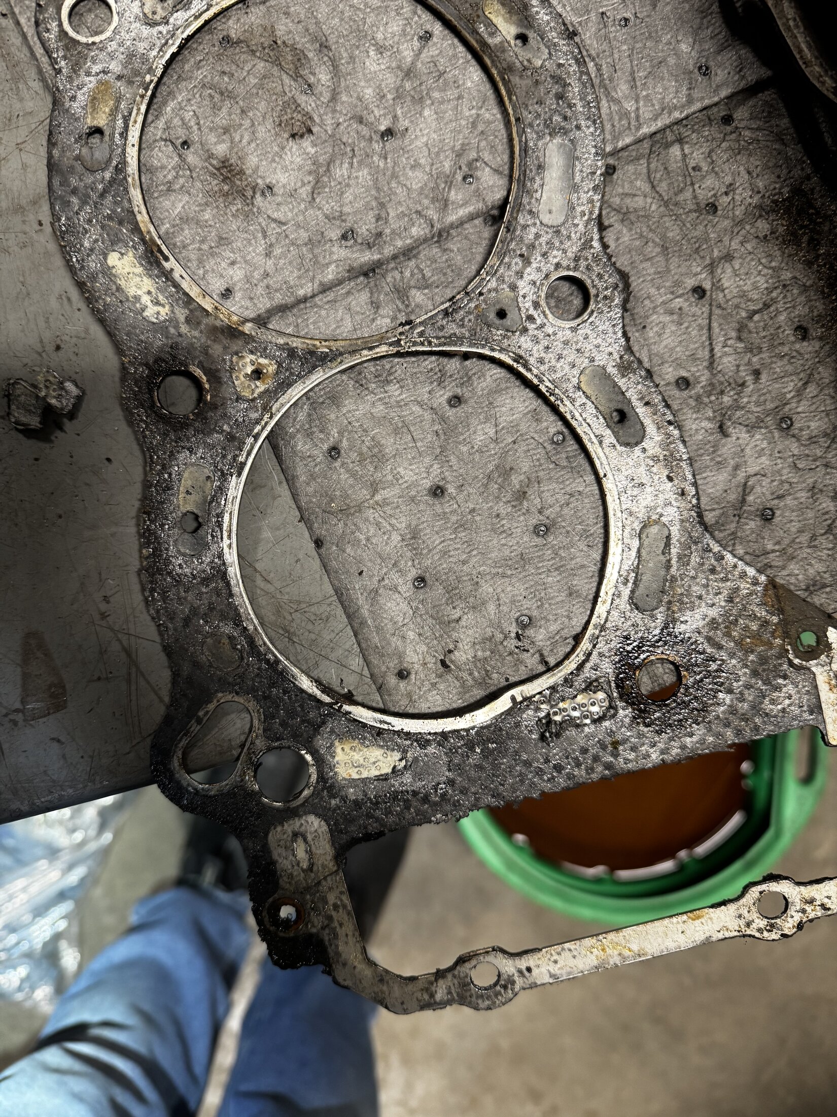

Attached are a few additional pics of the gasket. Kinda looks like failure at cylinder 1 and 2.. I’m definitely no expert.
I haven't been inside of one of these motors (yet), but it looks to me like the crosshatching is a little random, so maybe rebuilt once already? Also, the water journals look a bit crust from the top at least, so I'd plan on a full rebuild (by someone else), or a drop in from a running truck to get you out of there without too much pain. That said, @Fj80oregon does offer a great option too, and if you look at what he does, for a very fair price in my opinion.
In my eyes, you've done a lot of great work already on this rig so you should know it pretty well, a new heart and she'll last you a lifetime from now on...starting with another truck, you never know what you are getting. Yours looks to be in great shape body wise and you've done the suspension refresh too...I say keep her rolling and in your name!

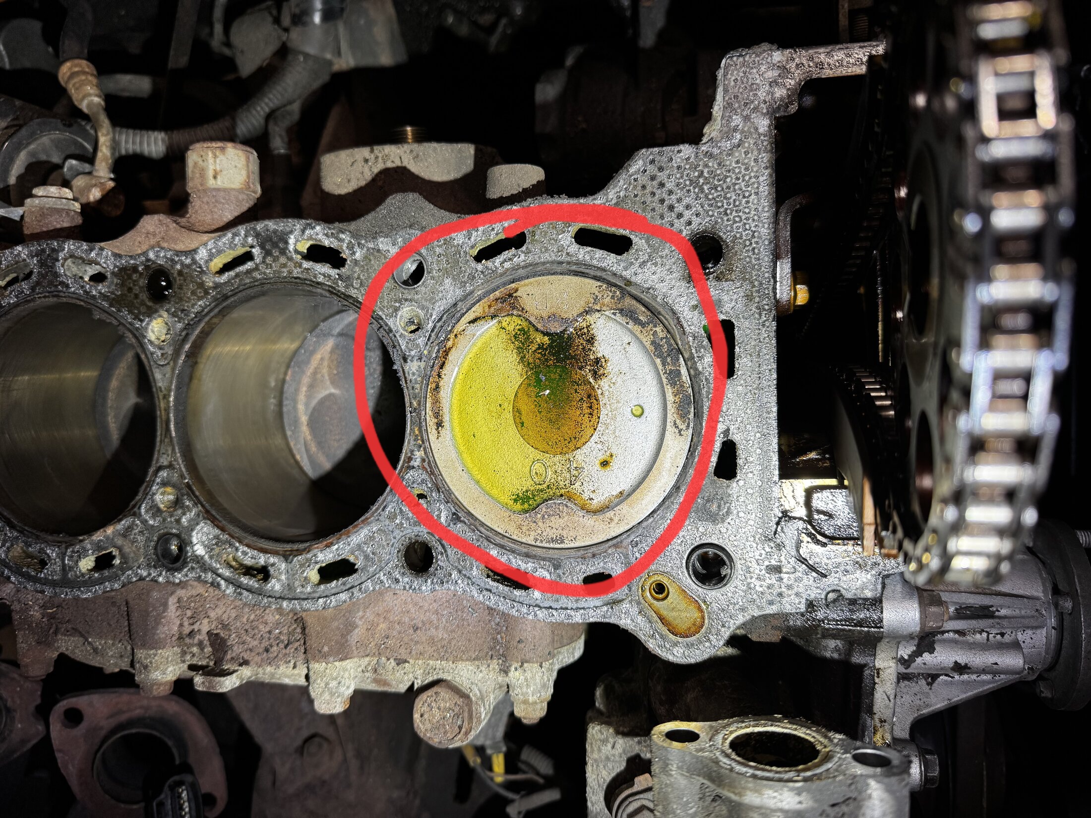

Cylinder #1 is clearly affected.
Both the #1 piston and combustion chamber are steam cleaned. Markedly different from all the others.
I don't think they are wrong that the head gasket failed.
But I would want them to explain wha
t leads them to say the block has been sleeved and can't be rebuilt?
But I would want them to explain whaView attachment 3807331View attachment 3807332t leads them to say the block has been sleeved and can't be rebuilt?

What I can see is the head gasket was failing in several places, not just the one that allowed coolant into #1. Be interesting to see how the cross hatching is on that cylinder. If water has been leaking for a bit of time, it can take out the cross hatching. I see no signs of that block being sleeved.
If the gasket material is cleaned off, one will see no sleeves on the bores( that is a first generation head gasket, that engine has not been opened up before).
