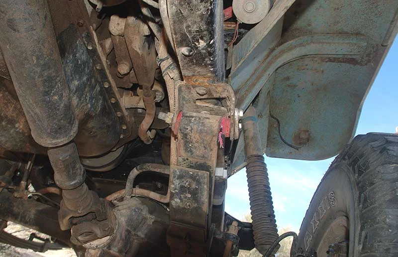

the DSRTRDR is getting some TLC . . .
...and, it's got yet another broken spring pin... :grinpimp:
yeah, this :rolleyes:
attachment.php
We've not been able to correlate spring pin failures to specific incidents.
This break is nicely visible because we tried to flex the suspension in order to determine tire/tub contacts. That may have bent the hanger... The previous breaks were only visible to the trained eye.
Tools R Us has suggested to go to FJ60(?) springs with the bigger spring eyes, allowing for bigger bushings, and RuffStuff spring hangers.
If I remember right, that suggestion was agreed to be tabled in order to prevent mission creep? :)
I am not so gung-ho on it since there are even fewer suppliers for 60 springs than for a 40
