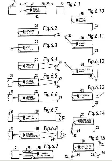

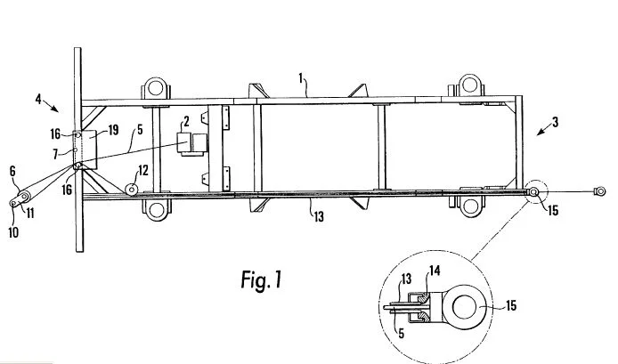

partial hijack: There's a guy in England who builds up defenders and calls them an Ibex. He puts a winch under the center of the truck, then runs a block in the rear and a hook in the front--- w/ winch cable threaded through the frame rail. I've always thought that looked like a great setup instead of winch on front and rear. Saves 80lbs (1 winch vs. 2) and puts the weight in the center instead of in front of the springs.

That is a patented "Foers" winch system and quite ingenious. I think that system would would on an 80 and could work with the rear mounted winch.

The one thing you don't get that way though is any redundancy. If you have front and rear winches, if one craps out, you have a backup - though I wouldn't want to be switching them on the trail.
The second thing you don't get is the ability to use one winch to keep you from sliding sideways down a hill, while the other pulls you forward. Sometimes being able to pull the rear sideways out of a rut, or at least enough up on the the edge of the rut to keep you un-hung up is valuable.
Not to quibble, but the Foers system will do this and much, much more. In fact, one of the neatest features is that you can set your rig up to be like a tram where it not only keeps you from sliding sideways but you can drive your rig along the "tram line" with relatively simple rigging. There is a post that I made in the "recovery gear" section with diagrams of the various ways to rig the system. Amazing flexibility.
Discussion of the Foers system in this thread:

I could see an 8K winch mounted off the crossmember running synthetic, would cost me 70 lbs right at the suspension location. I have a really wide hawse :D
