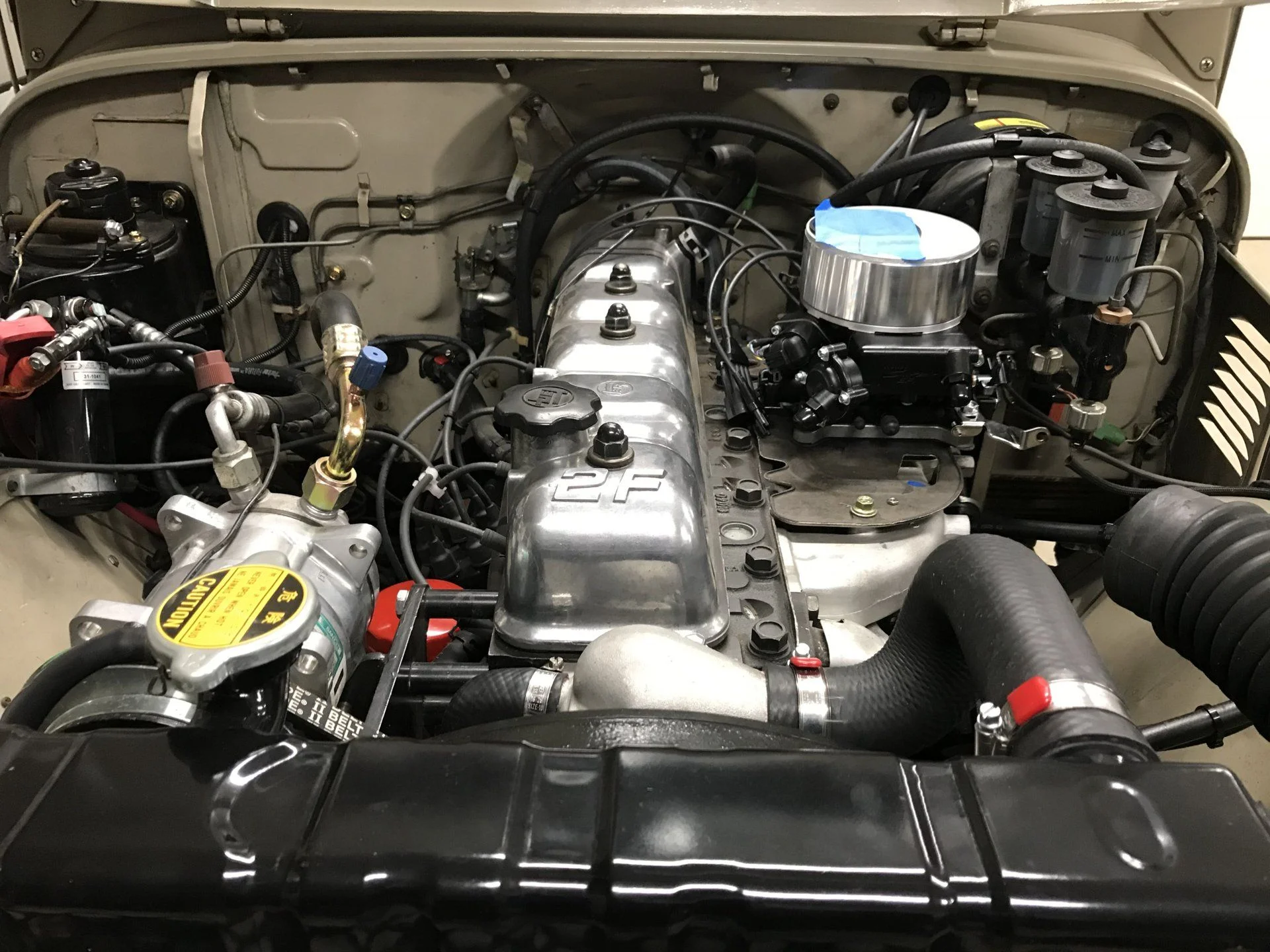

A little progress last night.
More progress:
Installed the coolant temp sensor
Installed the O2 sensor
Removed the old fuel lines & brackets
Also the custom wired carb cooling fan system has been removed as well, and the original washer reservoir will be reinstalled. I've tagged all items and have one box to keep all these items located should need arise to reinstall the original Aisin Carb.

ceylon - I took inventory, but didn't keep up with the accounting. I will say that all the Sniper parts came from Mosley Motors ( @FJ60Cam ). Cam has been very good to work with, answer questions and highly recommend using him as a source for a Holley Sniper kit.
I fabbed up a few brackets for the throttle cable connection to the gas pedal as well as a bracket to hold the Sniper fuse & relay. There are other odds and ends I purchased, which I'll try and go over at a later date.
I'm also installing an electronic FJ60 distributor & coil pack that I've had reworked by a MUD member. As you can see in a pic from a previous post, there is an orange filter. The orange filter (Stihl chain saw gas filter) is for the dizzy intake air, and I've drilled a hole in the bottom of the air filter housing for the suction side.
