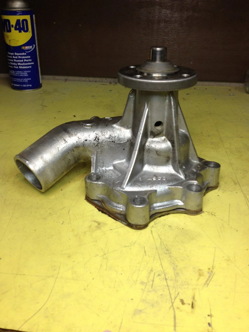

Being that this: IMG_2411.webp Caused this: IMG_2330.webp

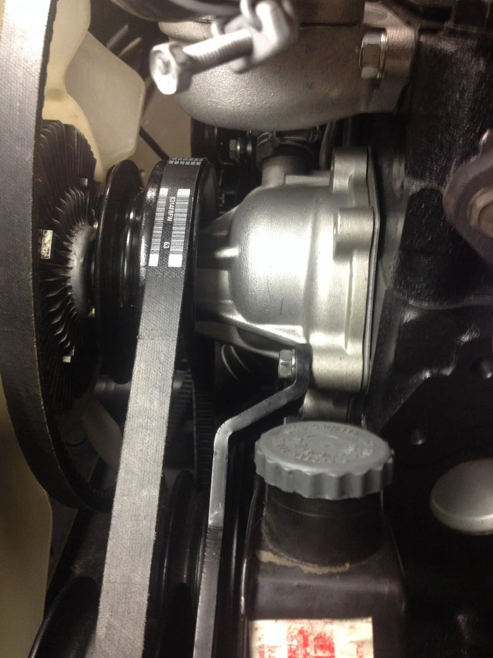

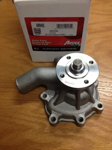

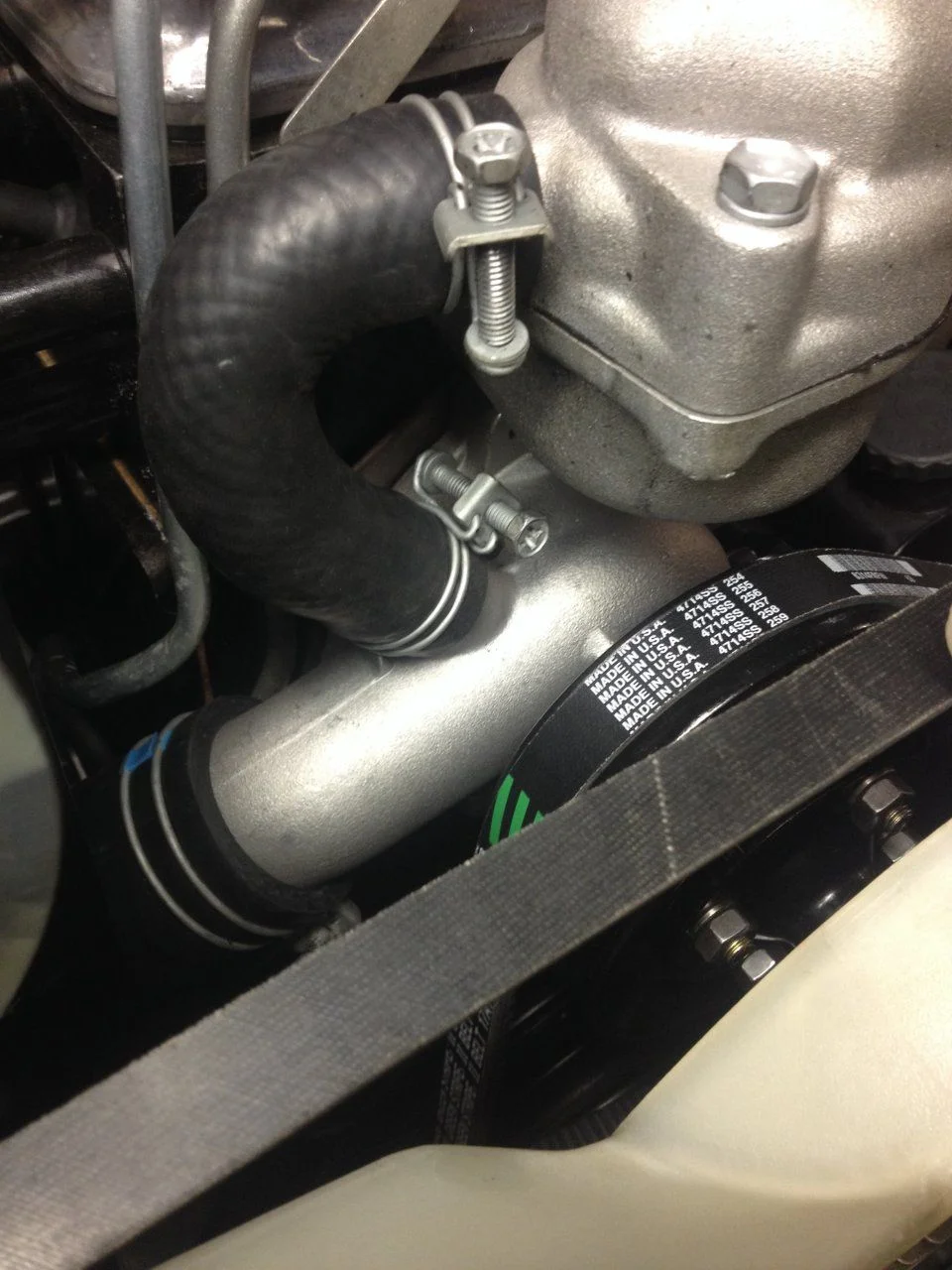

Purchased and received my new Airtex 9493 water pump last Friday. IMG_2388.webp Installed it Friday night. IMG_2391.webp IMG_2394.webp
Filled it up with coolant Saturday, burped the system, drove it around.....parked it, and was happy to see no coolant on my basement floor.
Makes me feel good wrenching to keep up with maintenance on my rig. Heck if an Architect can do it, then........well, then I'm just plain happy! :)
Great job Rick!! Glad to see your rig is leak free once again!:beer:
Thanks Mike. I believe I've resolved the water pump issues. I can see why the Airtex 9493 water pump was advised. If you look at it's casting, verses the Aisin WPT-063, the Airtex body/housing is actually closer to the OEM design for the water pump with clutch fan and no oil cooler.

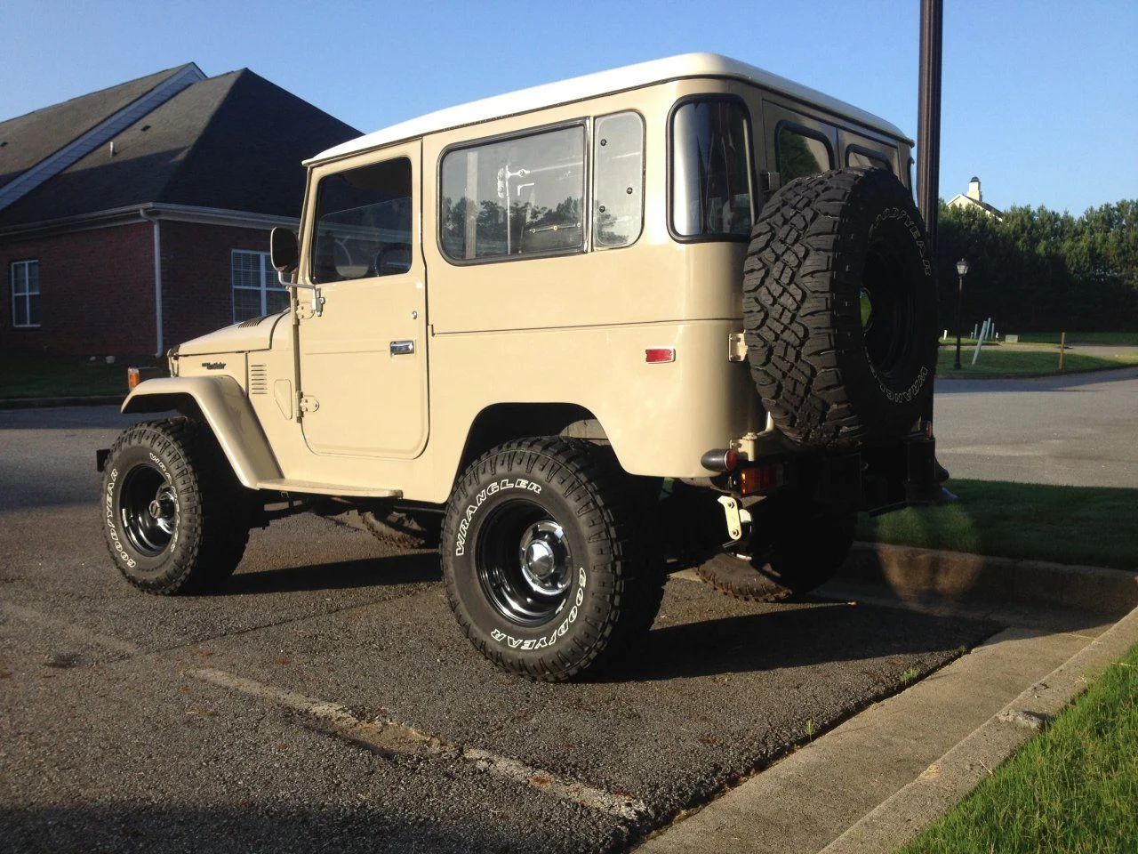

Awesome, Rick. Gotta love a complement like that. Sharp looking rig!!!
As for today, I drove it to work. Back to being my DD... It show does shine in the early morning sun.

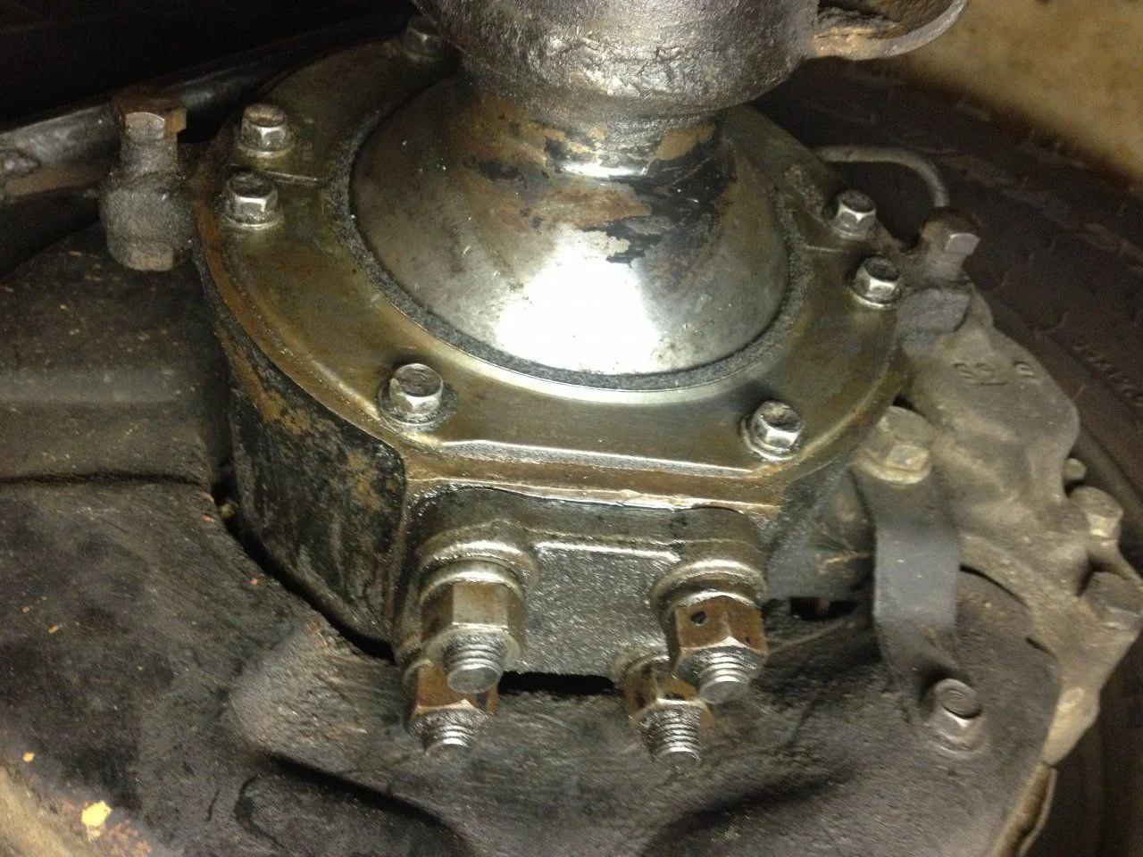

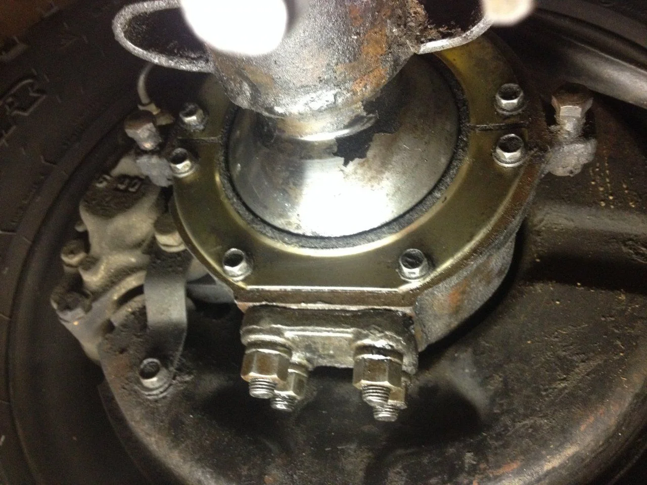

Just been driving my rig lately....but did clean my balls recently! Here have a look.
Thought I needed to possibly rebuild the knuckles, but now they look just fine to me.

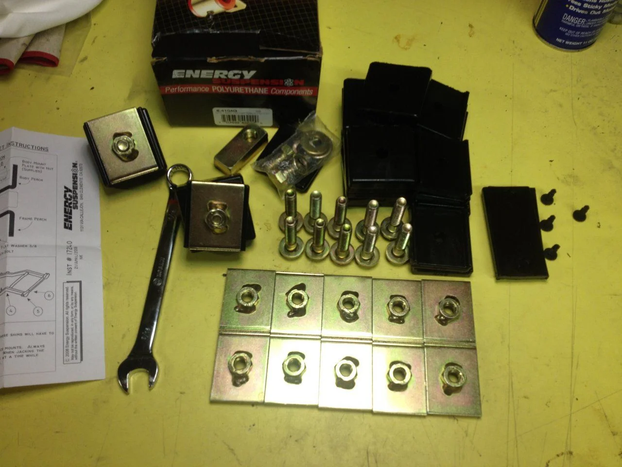

However, I spray WD40 on all the body bolts, getting ready to install this:
