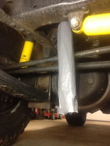

Started to make progress on my water pump installation last night. First, got the radiator drained. Was told this could be messy, so I took a WalMart bag, rolled it up, taped the side to form a tube, loosed up the drain stopper a little, took two small zip-ties and cinched the bag/tube to the drain cock, put a 5 gallon bucket under the tube and finished removing the stopper. The radiator drained into my "Poor Man's" funnel and into my bucket with no mess. Here have a look.

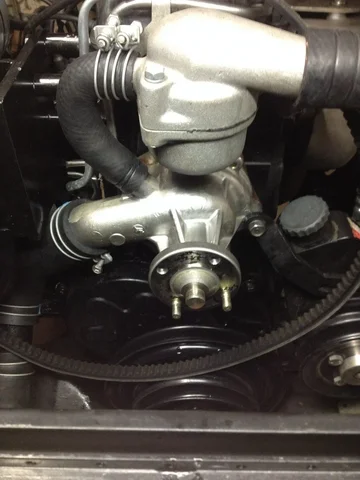

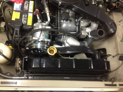

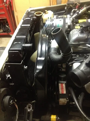

Progress last night, got the radiator, fan shroud, fan, and fan clutch removed. Now I have room to wrench on that pesky ole water pump.
Whooot - Whoooot......small victories, me so happy!
An update. I may not have made a mess draining the radiator, but when I unbolted the water pump..........a huge mess was made. Goodness sakes, my 5 gallon bucket probably had 2 gallons in it, so the other half of coolant capacity is in the block below the top outlet of the water pump. And there is about 4 plus inches between the top outlet on the WP and outlet on the block.....It had to go some where, so my basement floor was it's best option.
None the less, It's almost ready for the new water pump. Minor clean up, get the new WP and I'll be set to reverse the sequence.
