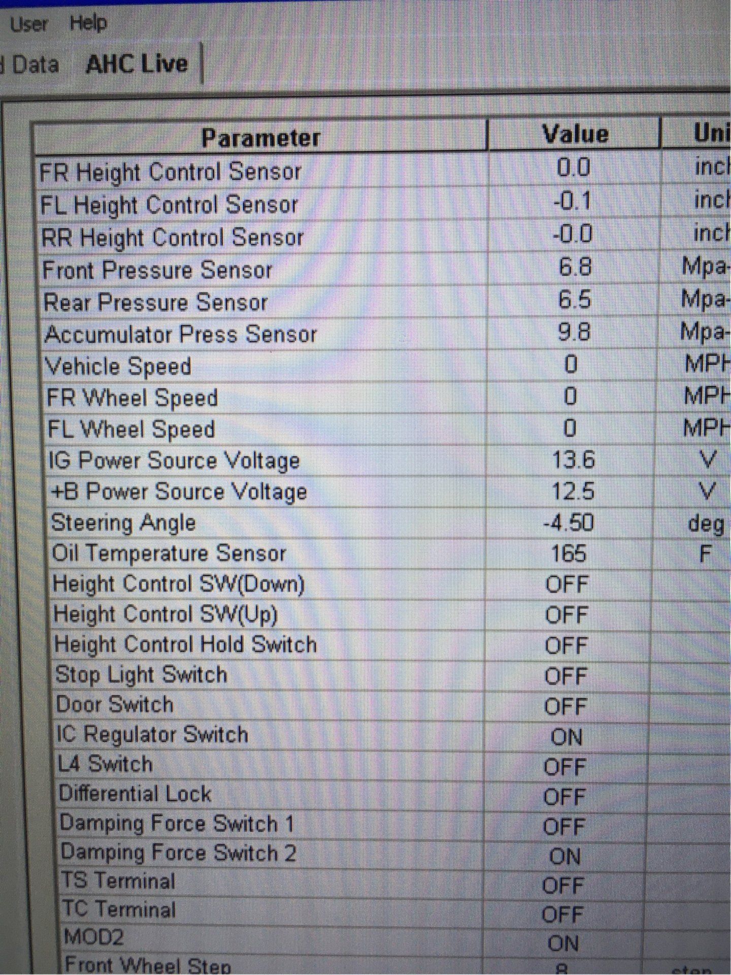

Right now the pressure is the same on rear as it was before the new springs, but I'm sitting about 1.5" higher in the rear than I should. If I can get it down to where it should be, I'm sure the pressure will be quite a bit lower. Adjusting the sensor up, is just going to raise it higher.
I guess I'm starting to think I'm going to need a new rear sensor. That sucks because it worked fine before the new springs.

To give you all an update, sure enough the rear mounting bracket was bent. It was difficult to tell, but I stuck it in my vice, bent it a bit the way I thought it should go, reinstalled it, and my truck dropped. After adjusting the sensor height to get the rear at 20.5", my new pressures are below. All is well in AHC land again. Not a huge difference in the rear, but the ride is very noticeably improved. It doesn't sink so low in the rear after going over bumps and feels much more planted on the road. Well worth the $250 for the springs.
So if you have a rear end that is sticking up in the air, check to make sure your sensor slider bracket, adjustment arm, and mounting bracket are all nice and straight!

Very nice! When you replaced the springs, did you add in 30mm spacers that are commonly recommended? Also, did you take a pressure reading before the spring replacement to compare to the new numbers?
I did not add a spacer, I thought I can always add it later if need be. I wanted the ride to be as stock as possible. Pressure before the new springs was about 7.0, so about 0.5 difference.
