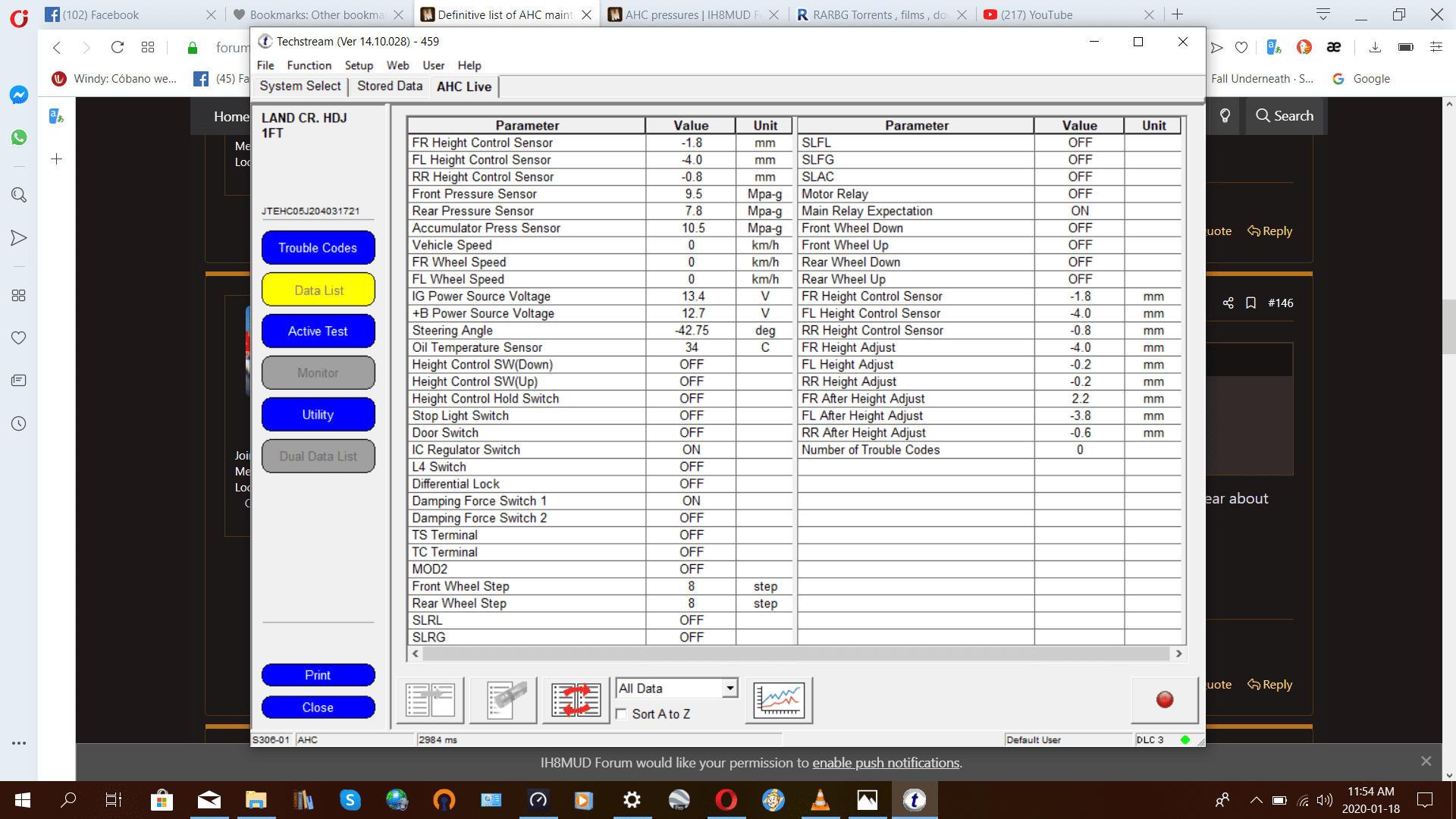

In need of some help. I ran techstream and started around 7.7 Mpa-G in the fronts and cranked the TBs about 9 turns clockwise. Now my pressures are at 6.7 Mpa-G but it's still boucy on the dips and still feel the cracks on the road. I've checked tire pressures and they are good, and right now getting about 7-8 graduations from low to high. Any suggestions or ideas on what the issues are? You think it's about time to replace the globes? Thanks!
2007 LX - 152K
Both Fronts - 19 1/4"
Both Rears - 20"
Front neutrals - 6.7 Mpa-G
Rear neutrals - 6.7 Mpa-G
Accumulater pressure - 10.2 Mpa-G

Quoted neutral pressures are within the specified ranges if vehicle is at correct height -- front: 6.4 to 7.4 Mpa; rear: 5.9 to 7.0 Mpa. The vehicle does appear to be a little low compared to the recommended distances hub-to-fender of 19.75" at front and 20.50" at rear. Neutral pressures will increase somewhat if these heights are adjusted, front then can be readjusted at torsion bars, rear may require new springs or spacers to reduce neutral pressure.
Test result of 7 to 8 graduations at AHC tank appears borderline if done at correctly with vehicle height and neutral pressures within specification and AHC fluid in good condition. Just a fluid change/flush may help as a first step but one or more of the four 'globes' (called 'gas chambers' in FSM) may have reached their 'use-by date', meaning aging and inevitable deterioration of the membrane in one or more 'globes' has led to loss of nitrogen with vehicle now riding mainly on the springs or torsion bars and with reduced damping, giving a bouncy ride. If so, replacement of all 'globes' is the next step. New 'globes' should show ~14 graduations at the the AHC tank.

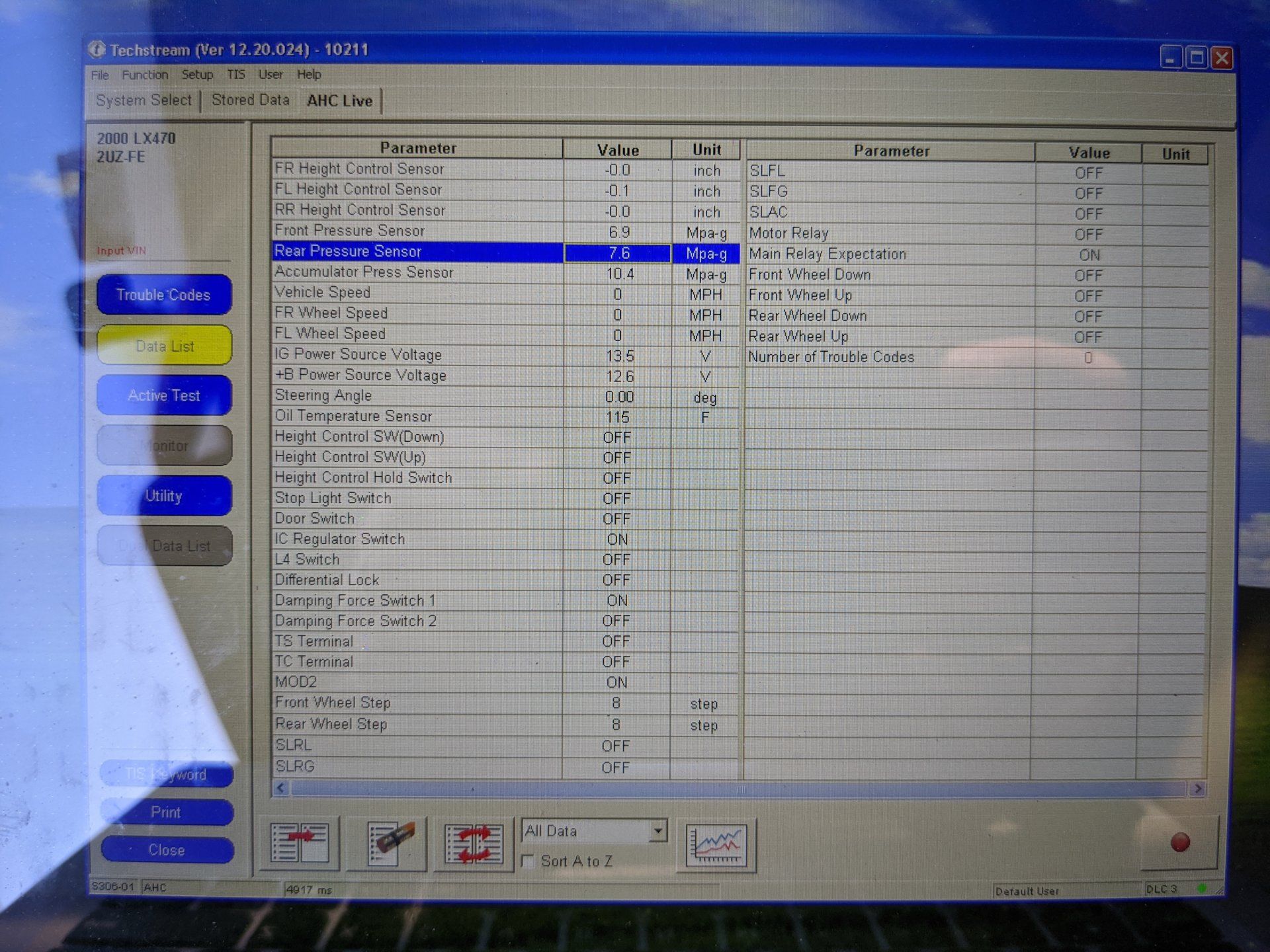

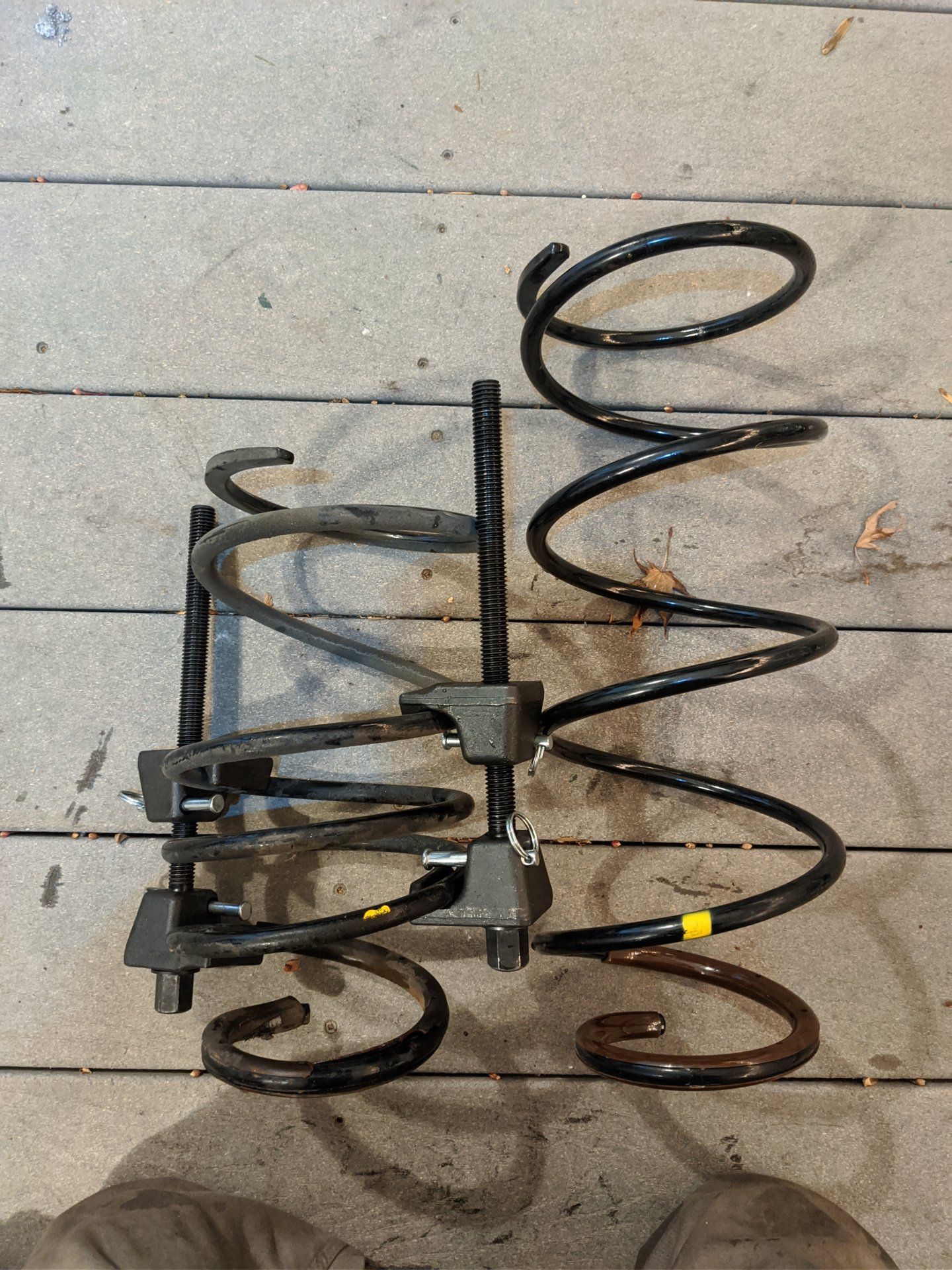

I installed my new Lexus AHC springs with 30mm spacers on top. I used spring compressors, because I had them With the temp sensor unplugged and all the new stuff in I'm still seeing high pressure in the rear. 6.9 Front, 7.6 Rear now. Measured and readjusted the TB a couple of times and this was the best I could get. Hard to find a really level spot to check, I'm always worried I'm not on a flat enough spot.
Kinda bummed, I thought it would be much lower. Any ideas @PADDO ?
The new springs looked exactly the same as the old ones, side by side, but I know that's not and indication of wear. I thought it would be more dramatic old vs. new. No history of springs ever being replaced. I installed new Plieades globes, new shock cushions and bushings, and a nice bleed with Lexus AHC fluid prior to installing the new springs.
Should I have bought King Springs instead?
Anyone want to buy new AHC Springs and/or 30mm spacers? :confused:
Anyone have any thoughts on this?
Front at 19.75" rear at 20.5", level side to side, pressure in the front dialed, but rear still high.
Guess I need King Springs????

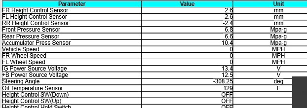

Thanks to all of the AHC gurus out there! @PADDO @uHu especially. I have read and tried to digest all of this string. and taken the recommended steps that are within my limited mechanical capabilities, except for messing with the height sensors. I have bled the AHC system, stock rear springs installed today and I tweaked the Torsion bars to arrive at the vales listed above.
The truck is riding well (much better), but there are two things I would like some advice on :
1) I am still a little low on actual height. Would you recommend that I make adjustments to the height Sensors?
RF= ~19.5"
LF= ~19.5"
LR= ~20.5"
LR= ~20.25"
2) If I make the height adjustment, would i expect the Rear Neutral Pressure to come down at all? The new springs had very little impact on the neutral pressures.
3) Oh, and one more thing: How do I "zero" the steering angle on my 2007? will that change the values or the drive quality?

Zero is just centering the wheel until it hits 0 while doing the test.

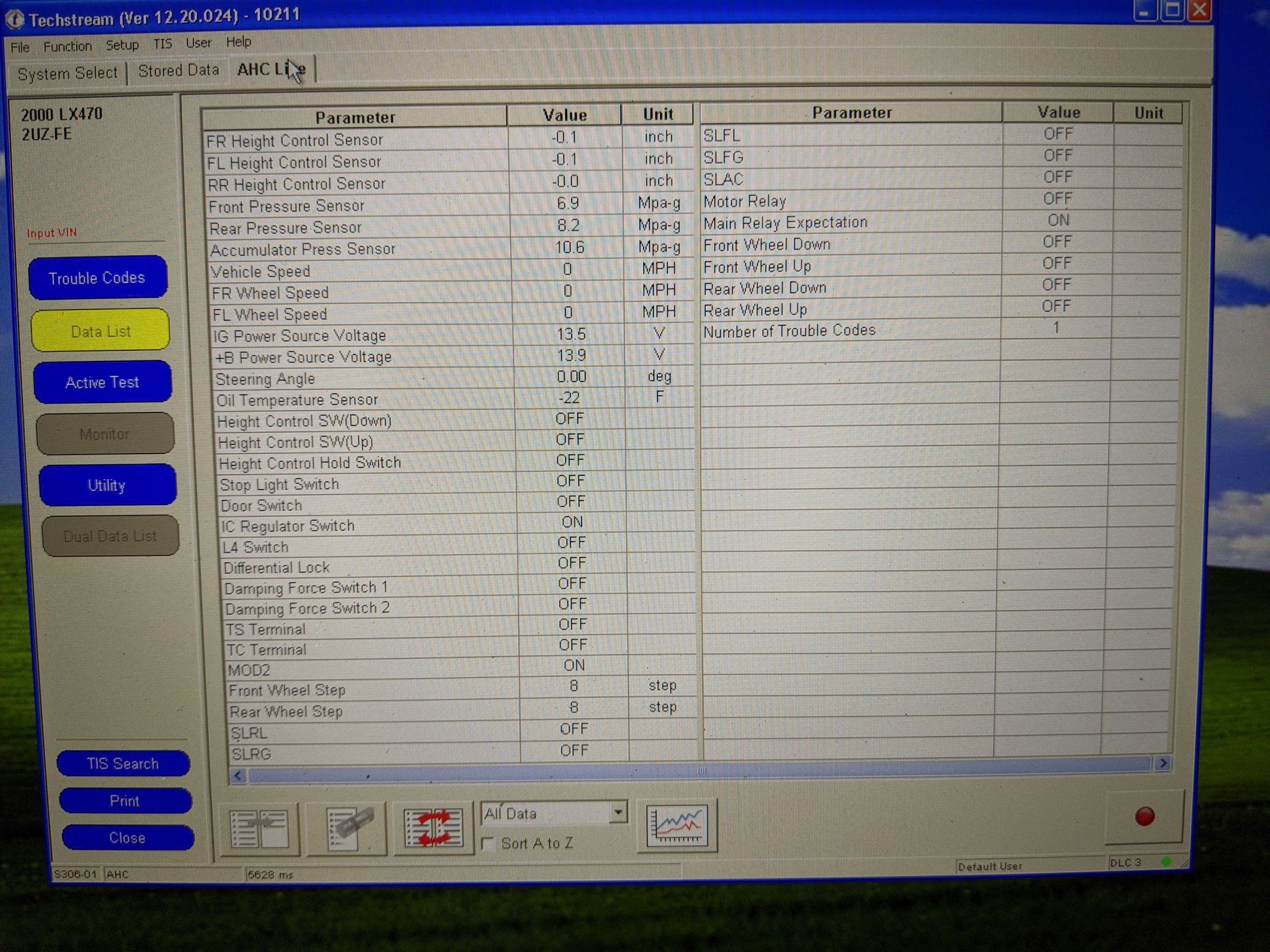

My remaining issue is that the vehicle takes 28 to 30 seconds to lift from AHC “LO” to AHC “N” while FSM suggests 10 to 15 seconds. Partial blockage somewhere? Friction between rear springs and internal airbags slowing the lift? AHC pump and/or the long cylindrical height accumulator nearing end-of-life?
Revisiting your post from last year @IndroCruise . Did you get any further with the AHC?
I see two issues, which might be connected. One is the long lift time from Lo to N. The other is that your screen shots always show the height readings well under zero. 5 mm isn't that much, but always 5 mm lacking is not normal. The whole idea of the Automatic Height Control is that the pump lifts the car until the height sensors reach zero. For the fronts the values are averaged (if they are not too different), and the raising will stop when the average is zero. Normally it will stop within 1-2 mm above or below, both front and rear.

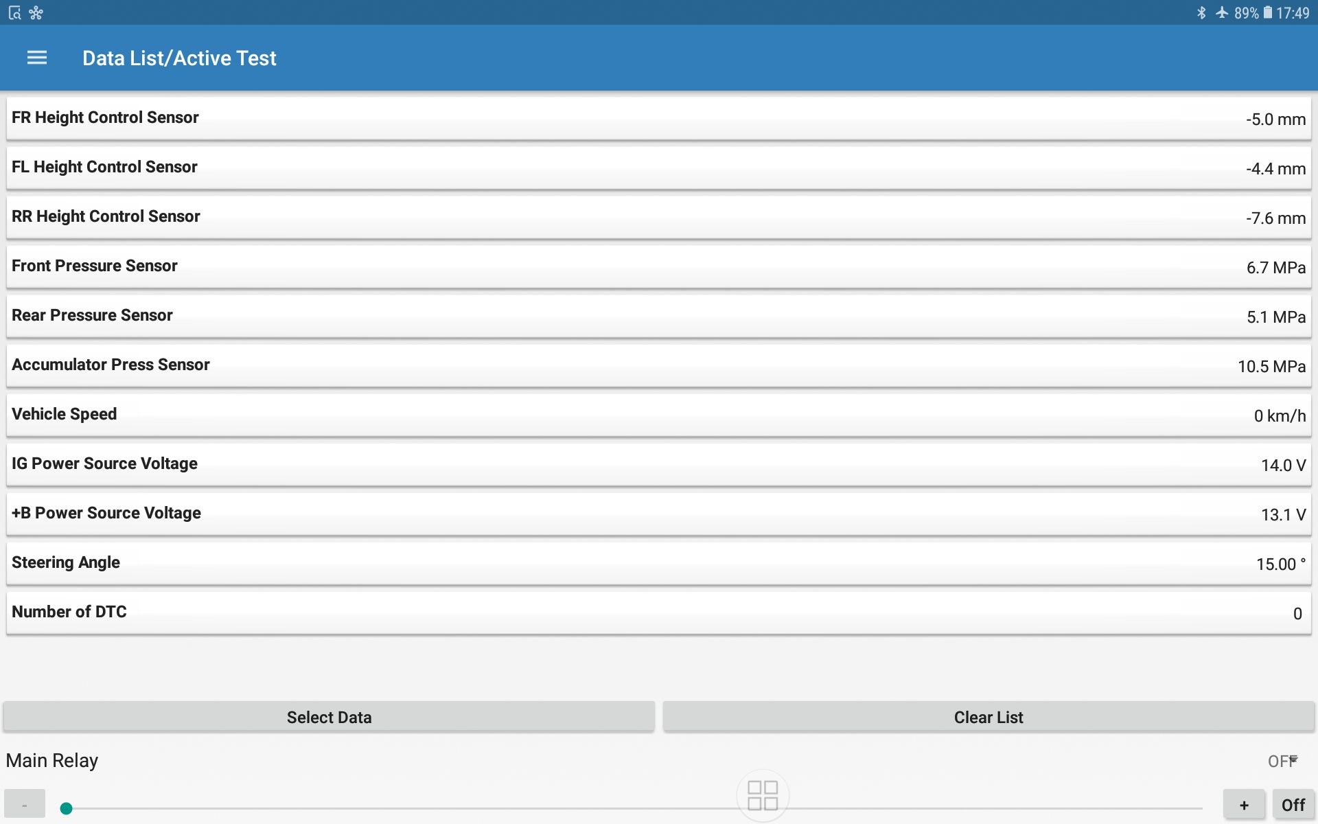

@uHu, should the sum of the fronts and rears equal zero? Or should the sum of the fronts (L/R) equal zero? I've got the numbers below. My question was whether I should manually adjust the sensors as I am ~.5 inch low hub center to fender. If my front height sensors should add up to zero, then I am not in as good of shape as I thought I was...
I'm a newbie on this stuff. Sorry if this seems like a simple question or I am confusing the issue.
@uHu, should the sum of the fronts and rears equal zero? Or should the sum of the fronts (L/R) equal zero? I've got the numbers below. My question was whether I should manually adjust the sensors as I am ~.5 inch low hub center to fender....
The fronts should add up to around zero. Do you get these values each and every time you move from Lo to N? (On a horisontal, level surface)

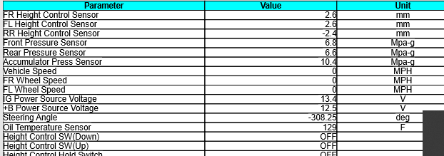

I finally got a reliable teckstream cable to run on Win 10 and thought I would tackle my AHC pressures before I install an ARB front bumper next week. I have read through the monster thread on "All things AHC, but they mostly deal with Gas engines and non dual tank versions. I know that the diesel model has heavier torsion bars but that is about all I know as different. Here is a shot of my pressures after L to N on fairly level ground. my rear is at 20" and the front is 19.5" with 3/4 full main and full aux tank.Can some one please tell me if I should be cranking my T bars to fit gas statistics or what? When I go from N to H , H flashes then goes back to N. If I turn the key off, then on again, it will be at H. I have an e copy of the 04 FSM but it does not cover the AHC system, is there an active link to one?. Sorry for the rambling. Thanks I appreciate your input.
