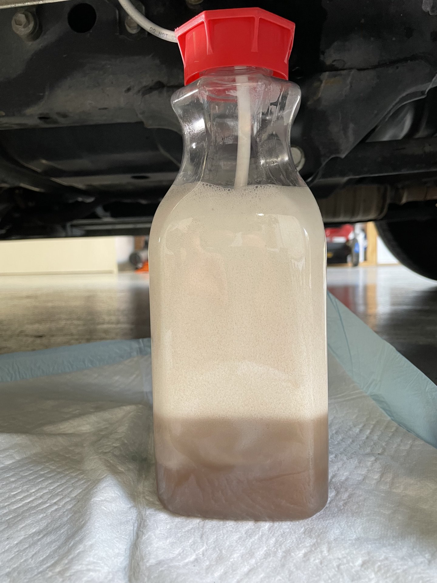

I replaced all 4 factory globes a week ago and did the initial flush before globe R&R with 2.5 1L bottles that were bought Jan 2021 batches E8736 and E8737.
The fluid sat in my garage for a year so I filtered them with 2 layers of coffee filter and no gel was caught. They were not contaminated and my AHC pump's working well.
I cycled another 2x2.5L metal cans through the system to make sure the fluid's all fresh with new globes, AHC pump's still perfectly fine.

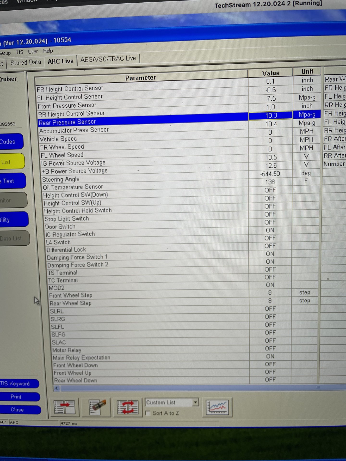

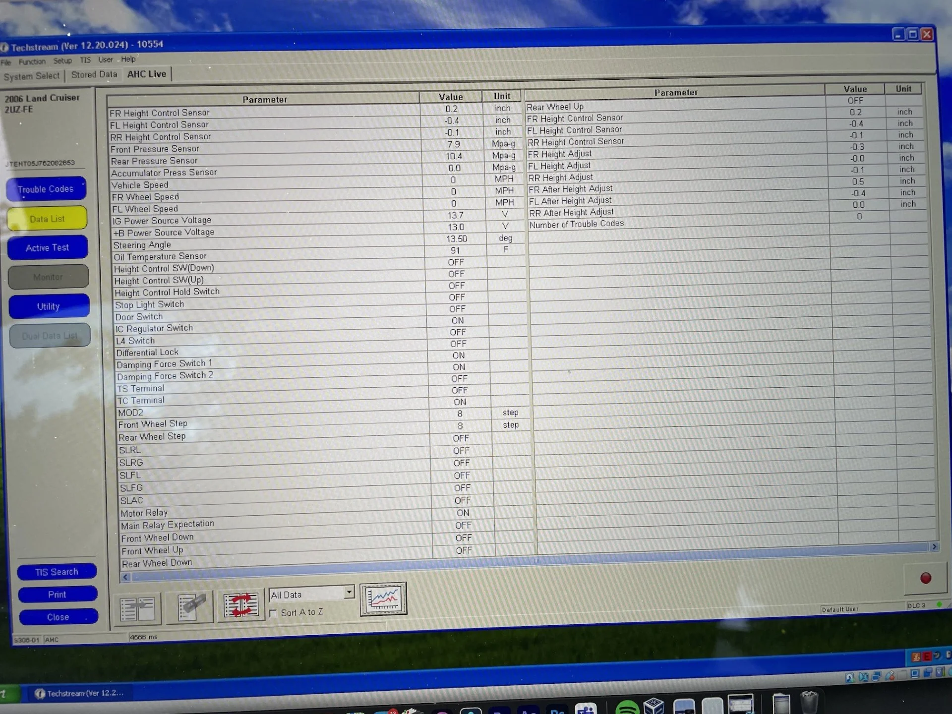

started to get a rough ride today and ran tech stream, came up with these numbers:
Front Pressure - 7.5
Rear Pressure - 10.3
Accumulator Pressure - 10.4
Looks like the rear is way out of spec.
Current mileage is around 170k
I do have a Dissent rear bumper and swing out but I have King springs (Done 6-19-18) to help compensate.
AHC Fluid was refreshed using the Prado method at 154,800 miles (Done 10-28-17).
Up until today I had no complaints with ride quality.
Would you say it's time for new Globes? Do springs wear out that fast? I'm embarrassed to admit that other than 2 HIH and one trip out to Joshua tree this truck is primarily a commuter vehicle for me. So not worked too hard.
I'll add that the rear appears to be sitting real low, even when I cycle from L to N. It is late and the mosquitos are out so I can get more data tomorrow, but this is what I discovered today after work.

Without meaning to offend, it helps if the complete Techstream screenshot can be shown. The pic given cuts off the line “Number of Trouble Codes”. Are there any DTC’s on this vehicle? If so, which ones?
The screenshot does show ….
  • some differences in Height Control Sensor readings – not “near zero” but do not seem extreme – was the vehicle on a level surface at the time of the measurements?
  • Front AHC pressure – OK
  • Rear AHC pressure – way too high at 10.3 Mpa – has this been a long term pressure??
  • Height Control Accumulator pressure – OK,
  • IG and +B voltages – OK,
  • Steering angle – not straight ahead (-554.50 degrees),
  • AHC Fluid Temperature – seems hot at 138degF (Cause? Difficulties raising? Many Raise cycles?),
  • Other switches and settings look normal.
Actual tape-measured hub-to-fender distances are not given at each wheel -- was the vehicle on a level surface at the time of the measurements? Has the vehicle been cross-levelled? Is the vehicle showing a ‘lean’ on a level surface? Is the vehicle height contributing to AHC over-pressure?
What time is taken to raise from "LO" to "HI"?

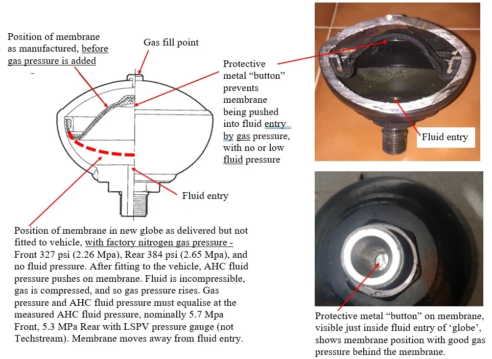

One of the things to remember here is that the AHC pressures by themselves tell nothing about ‘globe’ condition. The weight of the vehicle is shared by Rear AHC system and coil springs at the Rear, and, shared by Front AHC system and torsion bars at the Front.
Even if the nitrogen pressures deteriorate, neither the share of weight carried by the AHC system nor the AHC hydraulic pressures change, not even if all ‘globes’ have failed completely, lost all nitrogen pressure, and filled completely with AHC fluid. This is because it is not the 'globes' but the AHC Pump which provides the hydraulic pressure to raise the vehicle to the selected "LO", "N" or "HI" height -- using the so-called 'shock absorbers' which actually are hydraulic struts.
There is no available method to measure directly the nitrogen pressure in a ‘globe’ to establish its condition – because the gas filling point is sealed and no valve is provided.
The ”HI-LO Test” (see FSM reference far below) is the only method Toyota/Lexus offer to test the overall condition of the ‘globes’ (altogether, not individually). This test relies on the displacement of fluid from the ‘shock absorbers’ measured at the AHC Tank between “HI” and “LO” heights remaining constant over time in a stock vehicle. However, as the years go by, the membranes in older ‘globes’ deteriorate, nitrogen pressure is lost gradually and so there is progressively less force behind the membranes to push fluid back to the AHC Tank in this test.
Over time (10+ years) fewer ‘graduations’ will be observed at the AHC Tank as a result of the declining contribution from the 'globes'. In this way, this test gives an indirect indication of the condition ‘globes’ (altogether, not individually).
When the difference in observed number of graduations is around 14, the ‘globes’ are as new; when the observed number of graduations falls to 7 or less, with the AHC pressures within the FSM-specified ranges, then the FSM recommends change-out of all four ‘globes’. Usually, steadily deteriorating ‘ride quality’ also will be noticed as the ‘globes’ approach this point. Yes – it is possible that only one or two ‘globes’ have failed on a vehicle, but like other ‘wear’ parts such as tyres, brakes, etc – when one is worn, usually the others are not far behind. Note that when AHC pressures are not in the FSM-specified ranges, then the results of this test are not comparable with FSM numbers.
All that said, if the ‘globes’ are original or 10+ years old and/or if the ‘globes’ have been subject to ongoing extreme AHC pressures on the fluid side due to heavy loads, then earlier than usual deterioration of membranes in the ‘globes’ and valves throughout the AHC system must be expected. It is possible for final membrane rupture to seem sudden, although the weakness will have been developing over a long period.
So new ‘globes’ may be in your future anyway.
As mentioned, the Rear AHC pressure of 10.3 Mpa is very high, compared to the FSM-specified range of 5.8 Mpa to 6.7 Mpa – especially when KING KTRS-79 coil springs have been fitted.

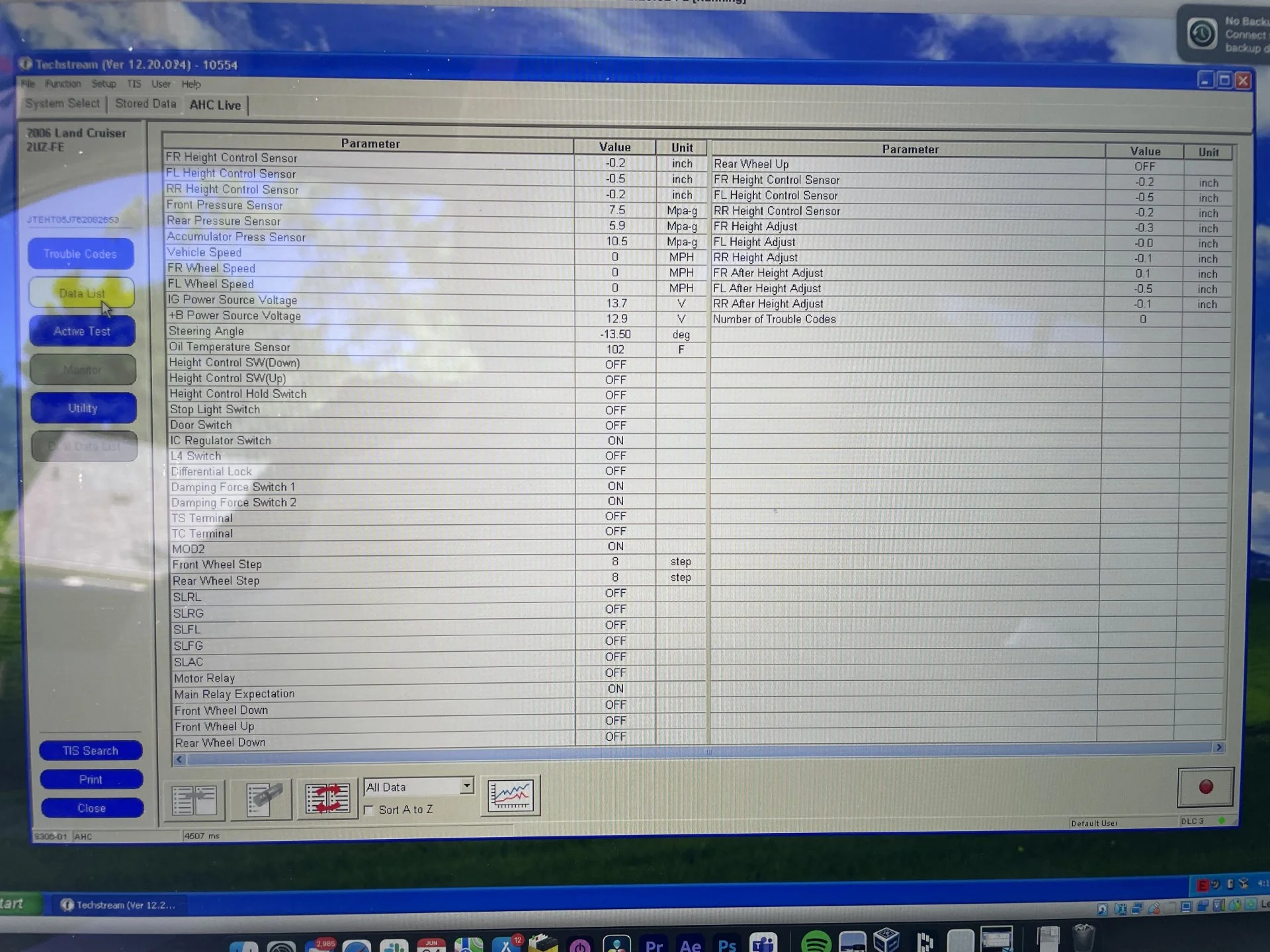

I am going to start trouble shooting this live today. I am measuring all this in my neighborhood street, it is level enough that it passes the Vehicle in N with no brakes and it doesn't move test. It might have a slight crown, but I believe most people would call it a level street.
I don't know, the ride was pretty good up until yesterday, that prompted me to dig up the old tech stream cable. The last time I checked was years ago.
My wheels were turned, I've corrected that below.
Could be two fold, it was 95 degrees yesterday and I had done repeated attempts at raising and lowering the vehicle to try and figure out what was going on.

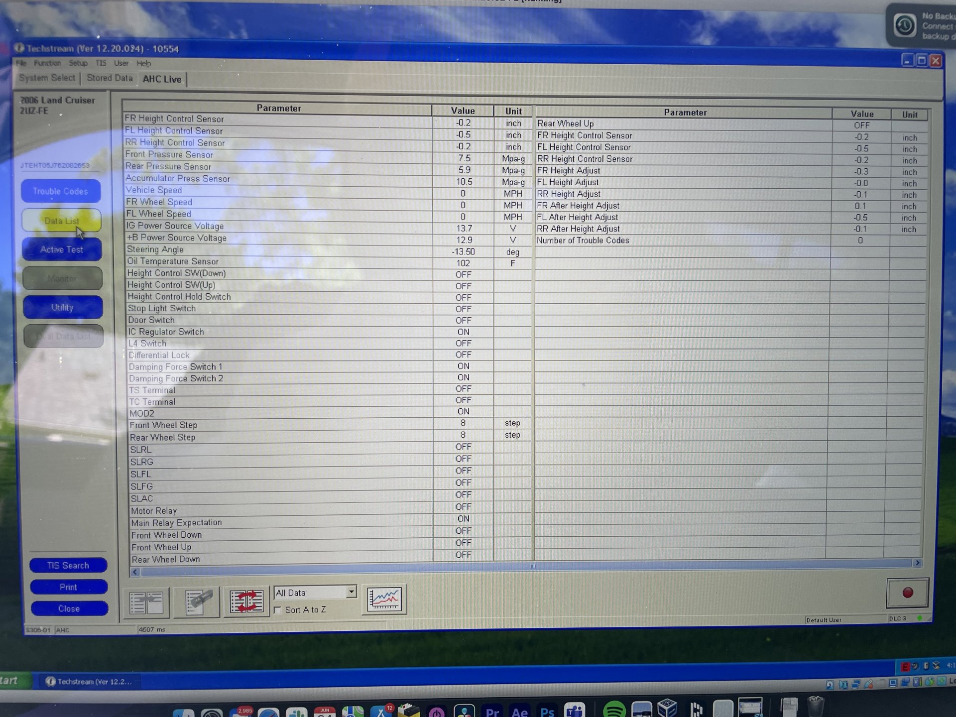

Measurements as of this morning in N:
Cold, undriven:
FL - 19 1/8"
FR - 20"
RR - 18 1/2"
RL 18 1/8"
After driving aprox. 1 Mile:
FL - 19 3/8"
FR - 20"
RR - 18 1/2"
RL - 18 1/8"
The rear is sitting noticeably lower than it should be, this was not the typical ride height before this problem popped up.
Attached is the tech stream screen while doing those readings:
When trying to raise the vehicle from N to H the rear raised significantly but the front remained low. The AHC light in dash flashed in the H spot then returned to a solid Green N. This resulted in the following measurements:
FL - 19 1/4"
FR - 20"
RR - 25"
RL - 24 1/2"
It took 50 seconds from L to a flashing H to a solid N with the rear raised up.
At this point my battery on the laptop died so I had to come in and charge it. I am going to let it charge a bit and run a cord out to the street so I can continue working, but these are my findings so far.

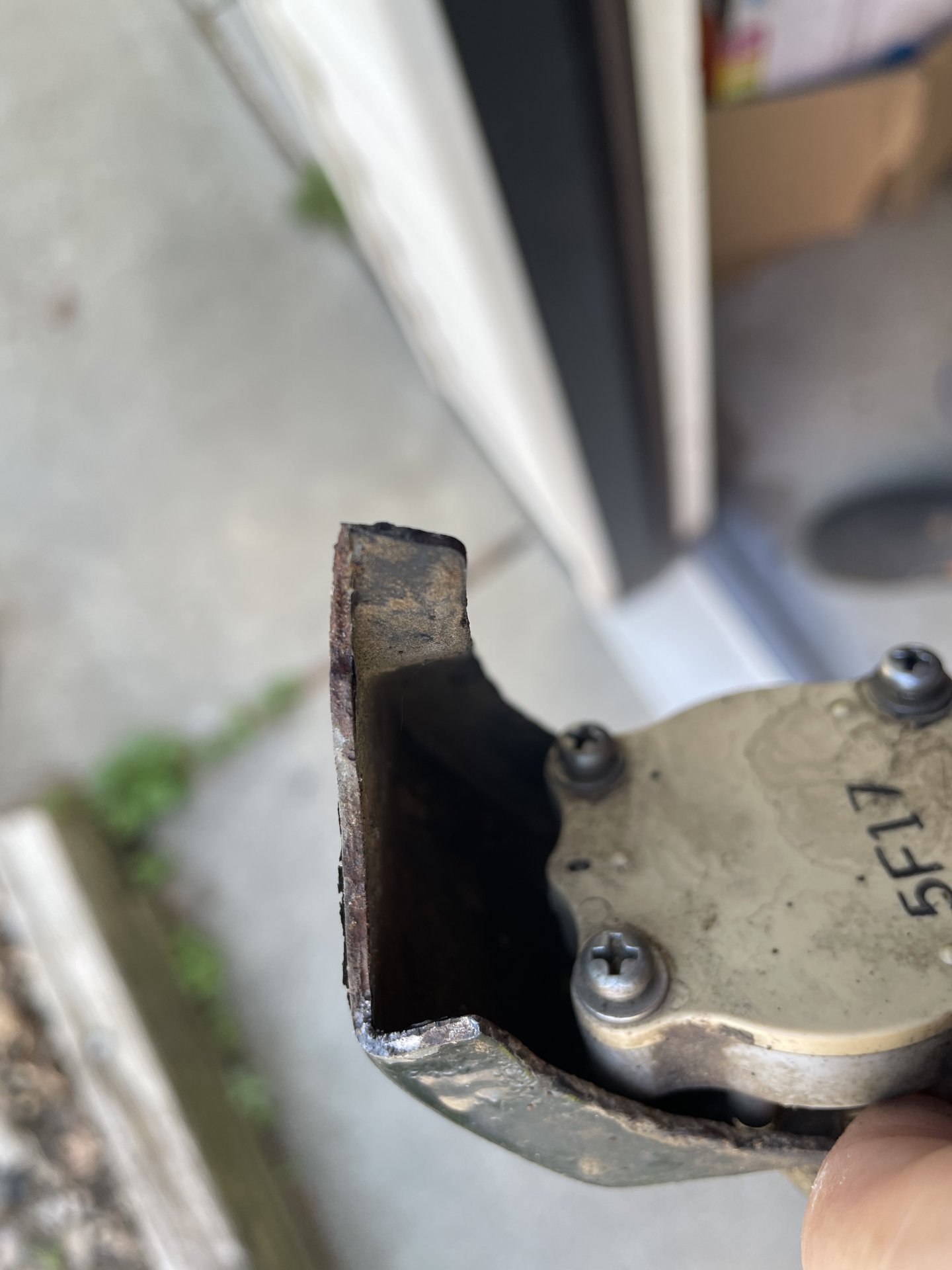

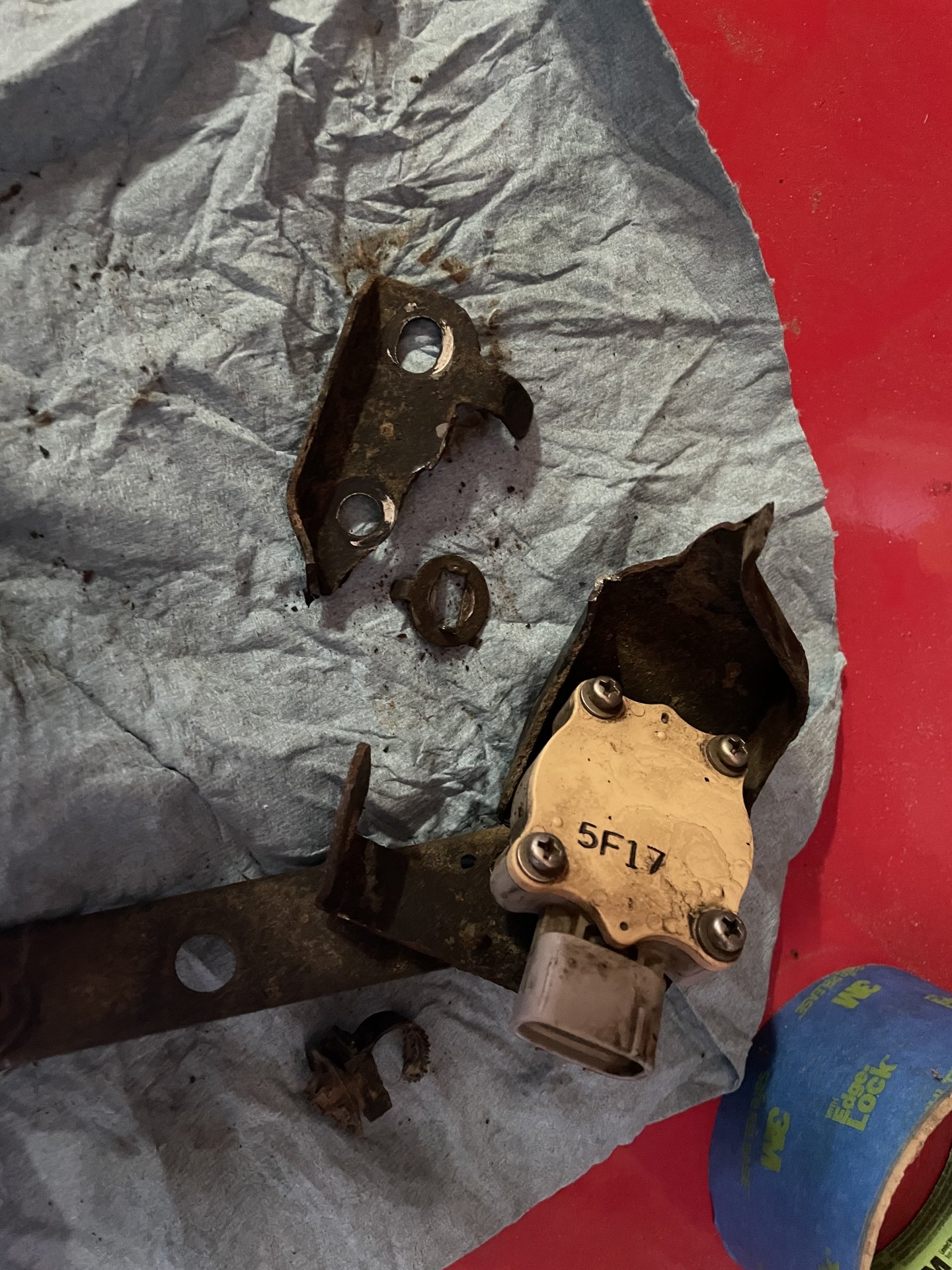

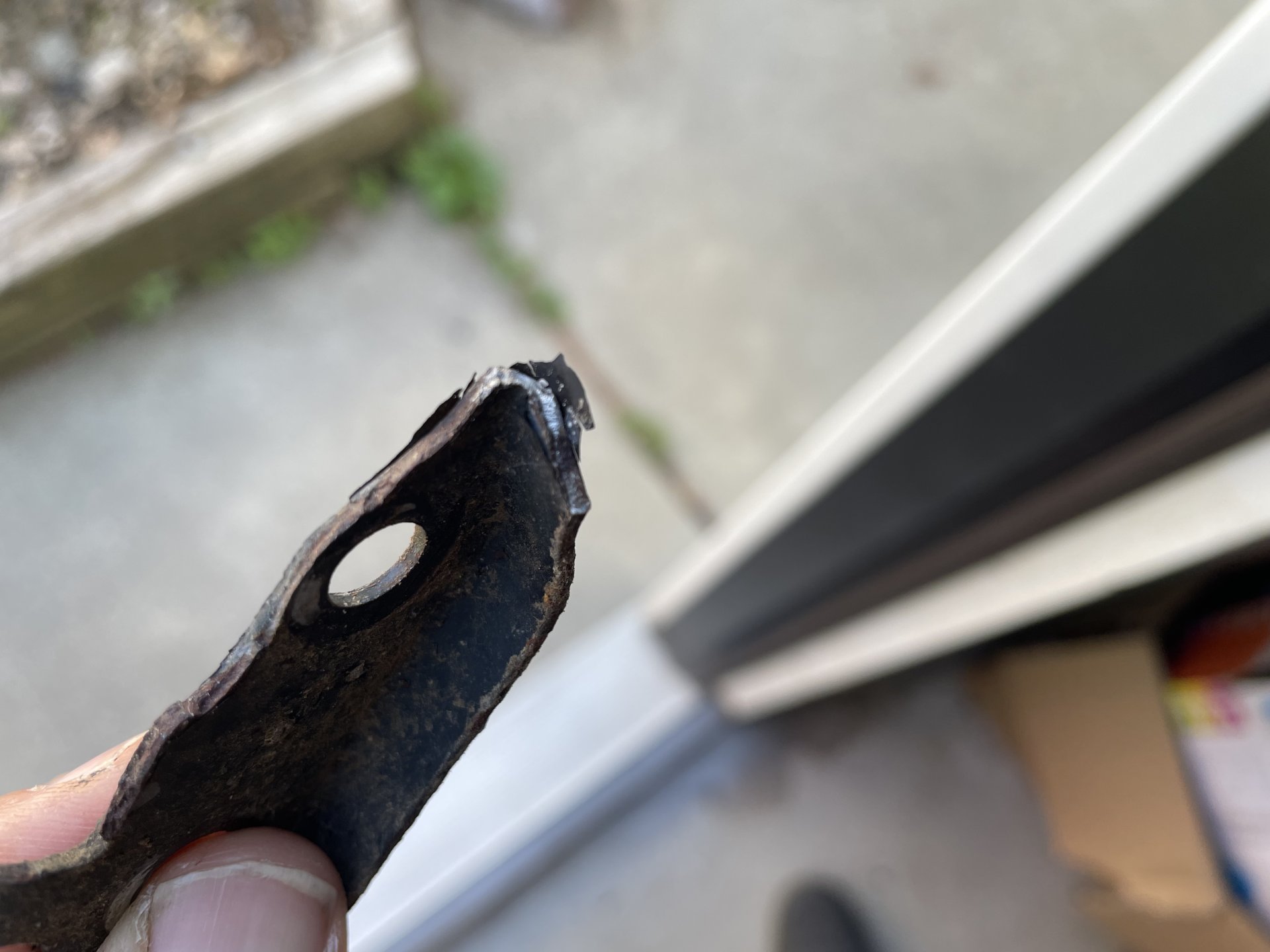

Ok, well, I think I might have found the problem. The rear height sensor was broken off it's mount. Must have either rusted through or been hit by some road debris. Time to order a new one and cross my fingers. Any opinion on OEM vs Aisin?
Also, no matter what brand I pick it's going to be a few days before I can get this part. Anything I can do to get this into a "limp" mode so I can drive to and from work? If I disconnect the plug and remove the sensor will it ride at N setting without height control or will that mess something up?
On physical hub-to-fender heights measured with a tape measure:
The measured side-to-side Front heights (Front Left to Front Right) are not within the FSM tolerance for cross-levelling. This may only be due to road camber, small as that may be, if measurements were taken in the street. Suggest take measurements on a garage floor, or floor in a carpark under a building, or anywhere you can be reasonably sure that a constructed floor is level, not in a street nor anywhere that has a significant fall for drainage purposes.
If the differences in Front side-to-side tape measurements are confirmed, then adjust at the Front using the torsion bar adjusters per FSM explanation.
The standard hub-to-fender heights favoured by IH8MUD members for a stock vehicle regardless of tyre size are
Front: 19.75 inches (both sides)
Rear: 20.50 inches (both sides).
These are not FSM specifications but are easily measured and widely used approximations which are good for most purposes, much less fiddly to measure than the FSM-prescribed dimensions. The numbers will be different for a vehicle which has been lifted.
On an AHC-equipped vehicle, ‘ride height’ at “N” selected height is set or adjusted by moving the Height Control Sensor adjusters, and not the torsion bar adjusters.
The FSM-indicated time to raise “LO” to “N” and raise from “N” to “HI” should be about 15 seconds for each step (“LO” to “N”, then “N” to “HI”) for a new and healthy stock vehicle. Your raise time from “LO” through “N” to “HI” of about 50 seconds seems reasonable, given age and weight of the vehicle, and suggests that the AHC Pump still is capable of doing its job. Be aware that the AHC Pump (which is a small positive displacement gear pump) does wear and does have internal strainers which can be prone to blockage. This is a robust long-life pump but eventually some diminution of pump performance is inevitable. Longevity is enhanced by regular changes of AHC Fluid at least in line with the frequencies in the Owner’s Manual (earliest of 60,000 miles or 6 year intervals) but better if more like 30,000 miles or 3 years, and, by keeping AHC pressures under control. AHC Pump replacement is neither difficult nor expensive, if and when required.
Your tape measurements at the Rear at “N” suggest that the Rear of vehicle is at “LO” height regardless of the height setting at the console switch. Suggest check visually to see whether the Rear of the vehicle is resting on the bump stops. At “LO” it should ride above the bump stops but there will not be much clearance.
The symptoms -- posture and behaviour of the vehicle -- are consistent with a failed Rear Height Control Sensor.
However, please be aware that if the Front Height Control Sensors are of similar age, they are not beyond suspicion as well.
Best to start with replacement of the known damaged Rear Height Control Sensor, then review vehicle behaviour and symptoms.
As noted in other Posts, absence of Height Control Sensor DTC’s (C1711, C1712, C1713) does not provide assurance of healthy Sensors.
If this was my vehicle, I would be prepared to drive it carefully at town speeds on sealed roads avoiding rough surfaces, while waiting for a few days for the replacement Sensor.
You could try using a cable tie or similar to position the Rear Sensor arm in mid-swing (corresponds to “N” height if the Sensor is electrically healthy). This may give some strange effects. Personally, I don’t think I would bother – but there is no downside to trying this to see if it works as a short term workaround.

On Aisin versus Toyota/Lexus Parts:
I bought the Rear Sensor seen in the picture found via the above link as a Toyota/Lexus Part Number from Partsouq -- but it is stamped "AISIN". This no surprise -- AISIN is a major supplier to Toyota/Lexus --and Toyota is a significant investor in AISIN!! Direct purchase from AISIN may be cheaper.

On the Techstream screenshots:
The second screenshot shows Height Control Accumulator pressure of zero. This may only mean that the measurement was taken too quickly, before the Height Control Accumulator had been recharged, which happens at the end of the raise cycle. Allow 30 to 60 seconds after the dashboard AHC light has stopped blinking and then be quite sure that the AHC Pump has stopped before taking AHC Pressure measurements. Otherwise, non-operation of the Height Control Accumulator may indicate that there is another problem to pursue.
Both screenshots show very high Rear AHC pressures of 10.3 Mpa and 10.4 Mpa. This is puzzling when the Rear of the vehicle is low and so the Rear AHC pressure actually should be low. Sadly, this may indicate that there are other problems. Hopefully these readings are due only to inconsistent signals being received by the AHC Electronic Control Unit (ECU) from damaged Height Control Sensor(s) and causing aberrant behaviours.
Best to start with the obvious replacement of the Rear Height Control Sensor and go forward from there.
Has anybody seen anything like this? I can read the Data List, can perform active tests with the solenoids, but I can't read & clear DTCs?! I get this error when selecting AHC from System Select & when trying to switch to Trouble Codes. This happened during the struggle with the pump and motor couple of weeks ago, immediately after trying to read the system with the solenoid block behind the accumulator disconnected.
The "Number of Trouble Codes" in the bottom of the Data List is cumulative - it keeps growing and survives battery disconnects.
The system is running & performing fine, but I can't see the error codes ☹️
I was hoping to find an AHC ECU to test with, but all I can get access to are pre-2002 (89290-60021), while I need 89290-60041 for post 2002.
Don't know -- but would be very suspicious of ECU when presented with memory faults. The FSM is vague ....

finally got my rear height control sensor and slapped it in the truck. Set the adjustment bolt as close to center as I could eyeball and fired up tech stream.
Here’s the numbers.
I’ve cross leveled the front but looks like I will need to tighten down the TBars to get the front in spec but the rear looks good. If anyone else has a dropped rear end with high pressures like I was seeing I would suggest first thing would be to check the integrity of the rear sensor.
Did the ABC last week due to real bouncy ride. Made some adjustments to torsion bars, got the heights and pressures to spec but graduations was less than 7 and still bouncy. Determined my globes were bad. Got my new globes and replaced them this weekend. It included another flush with the new globes. Lots of bubbles. Guessing it’s from nitrogen leaking from 3 out of 4 globes. Just guessing three were bad because after taking off the globes, more bubbles were coming out the globe like if you were doing a leak test on a tire or gas line with soap. Two of three globes failed the “pencil test” but one of it passed but still think it’s bad cause the bubbles kept coming out when I left it alone with oil sitting in the reservoir.
Here’s one of the globe’s flush. 3/4 being bubbles.
I can report that bouncy effect is gone along with the bubbles during the final flush. Will be checking the pressure and height again in few days.
Here’s the numbers.View attachment 3042267 I’ve cross leveled the front but looks like I will need to tighten down the TBars to get the front in spec but the rear looks good. If anyone else has a dropped rear end with high pressures like I was seeing I would suggest first thing would be to check the integrity of the rear sensor.
Were the ball joints of sensor arm frozen in place?

The following numbers explain ….
New ‘globes’ ex-factory are specified (see FSM) to have been filled with nitrogen at 327 psi (front) and 384 psi (rear).
When the attached FSM-specified test procedure is used to check overall condition of the four ‘globes’ on the vehicle at correct AHC fluid pressures, expect 14 graduations of difference in fluid levels at the AHC Tank.
When this declines to 7 graduations, the FSM recommends change out all ‘globes’ – too much nitrogen pressure has been lost, probably over 10 or more years, damping performance is seriously impaired -- rough ride.
What then is the remaining nitrogen pressure behind the membrane? It is not measurable and it may not be linear with the measured reduction in fluid volume – meaning that it is not clear whether the nitrogen pressure at 7 graduations has fallen to around 150 psi (say half the factory fill pressure). Whatever, it still will be a big number, for example, more than three maybe four times the pressures that most people use in tyres on a sealed highway.
The ‘globe’ in the bottom right of the pic below came off a vehicle still showing 8 graduations – changed out a little early prior to a major cross-country trip.
The “button” in the centre of the membrane can be seen in the expected position just below the fluid entry passage into the ‘globe’.
The “button” is not going anywhere – even with a mighty push on any “pencil” against (say) 150 psi nitrogen remaining pressure behind the membrane!
The point is that using the "pencil test" to indicate remaining 'globe' pressure and condition makes even less sense than checking the pressure of a large road tyre by pushing a pencil against the sidewall, even with only 40 psi behind it.
The “pencil test” is only a "depth gauge", definitely not a “pressure tester” and not even a useful indicator of remaining nitrogen pressure in a ‘globe’ in fair condition.
