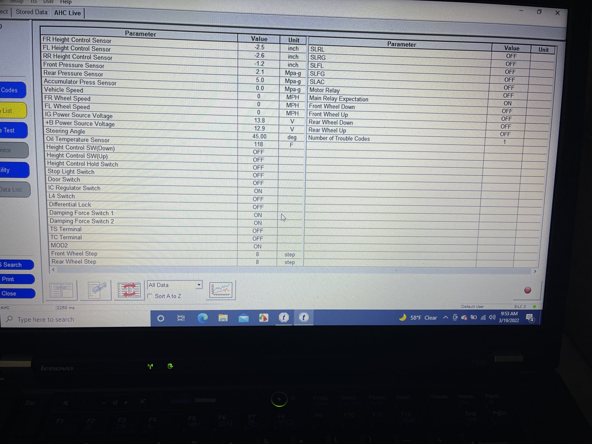

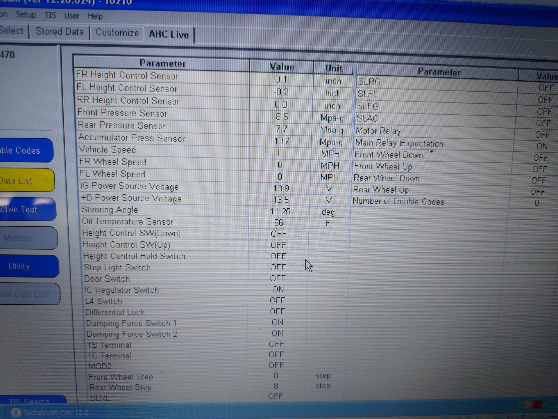

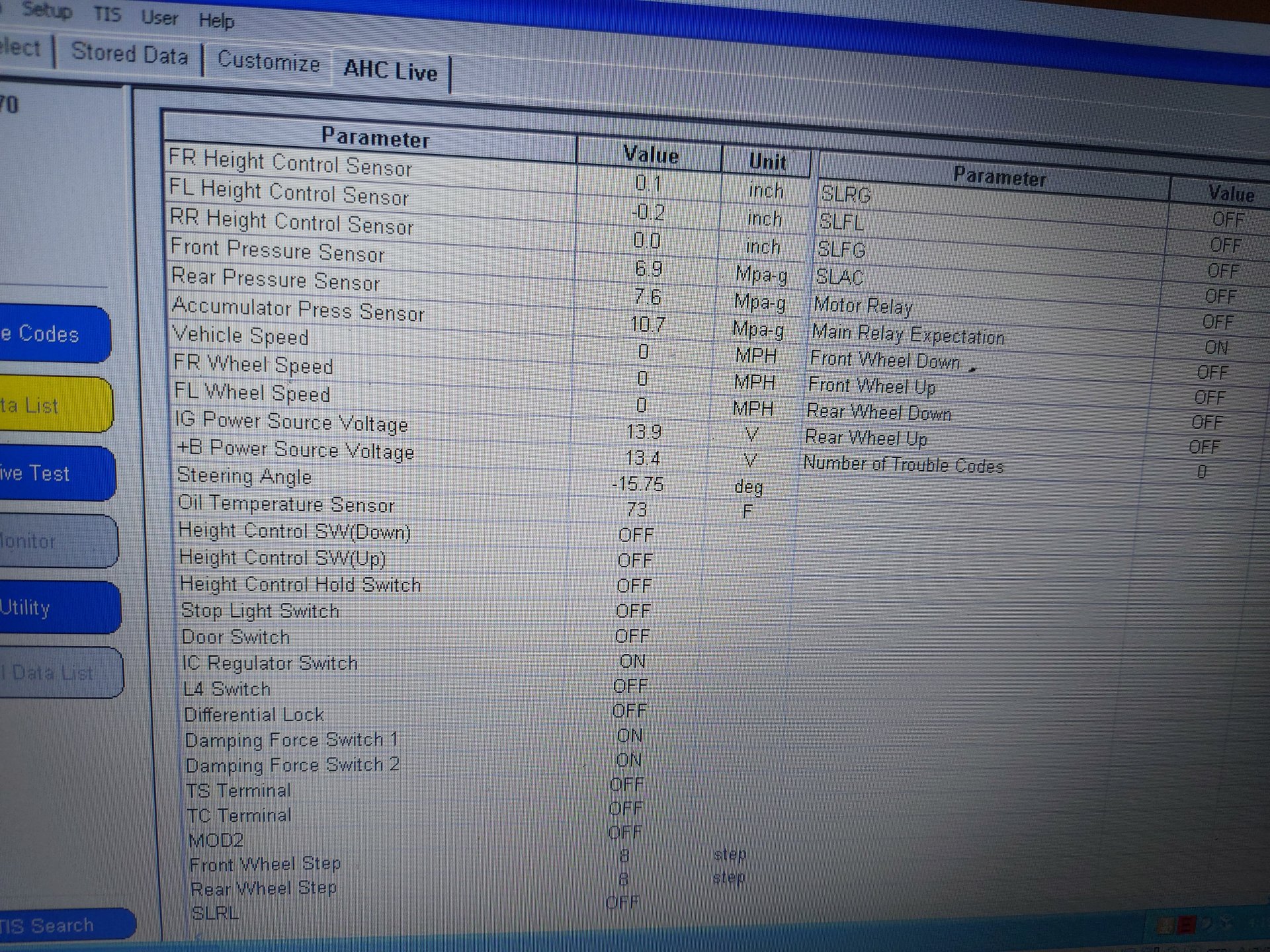

After 2 days fighting to connect TS to the car, I got from here:
To here:
Healthy numbers I'd say. Except for the rear pressure sensor, so I'll order new springs soon.
Very happy with the ride quality now, but still to be improved

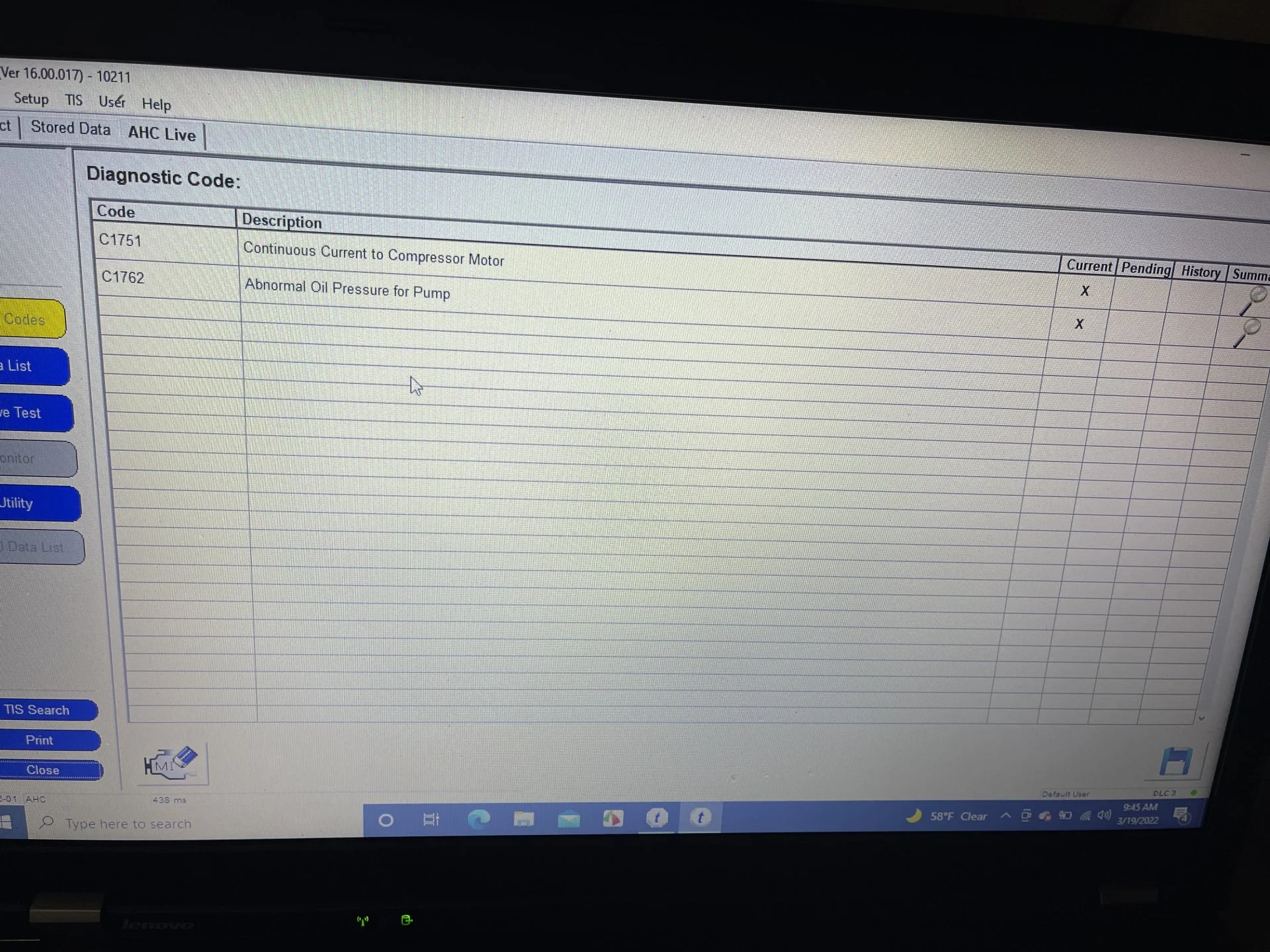

Today morning all of a sudden my rig dropped to low on my way to work. Came back and took this screenshot. Seems like no pressure on the accumulator. What should I try?
Look for leak
I emptied all four sides now there is fluid inside the globes or accumulator anymore. There’s no leak. Also oil is not going down from the reservoir. I filled it up and it stayed the same. I forgot how to do the manual way. I remember last year I push one pin on the diagnostic port and then push low high and it forced to work. Can’t remember. Again there’s no leak under the car.

I flushed the system last year. It worked fine all this time. All of a sudden it went down while driving. So I emptied all four corners including accumulator then topped of the reservoir. Even though reservoir was on correct level when it went down. But after I emptied all 4 corners it’s not taking anything from reservoir. It stayed them same level as before. No pressure and there’s no more oil coming from any corners after I opened each valves.

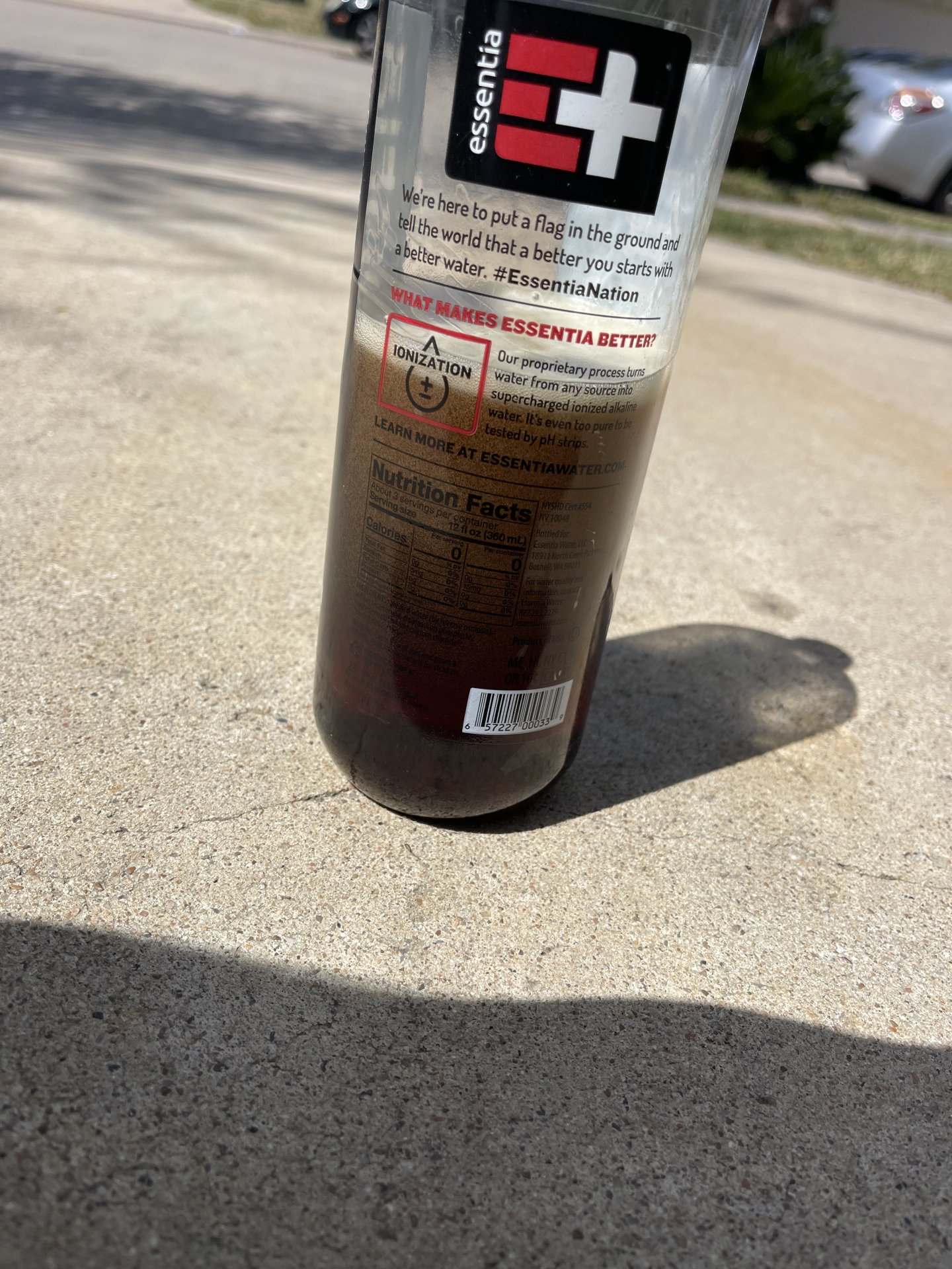

I just bought the Toyota 2.5L AHC fluid from eBay but heard there’s a bad batch of it. Anyone watching this thread have any insight? Should I use it or return it? Is it beneficial to strain it first through cheesecloth or something?
I used plastic small black bottles from Toyota dealership
I have a metal can that I bought from a Toyota dealership. I plan to put it in the car tomorrow so hopefully it's ok?
I believe all the bad batches were taken out of circulation unless you bought it from a private seller or something.
Someone feel free to correct me if I'm wrong
Many of the Toyota AHC fluid in black plastic 1 liter bottles, have been found to have jelled. Seems mid to early 2021 (a lot of reports out of TX), have jelled. It may have to do with plastic reaction with the fluid.
