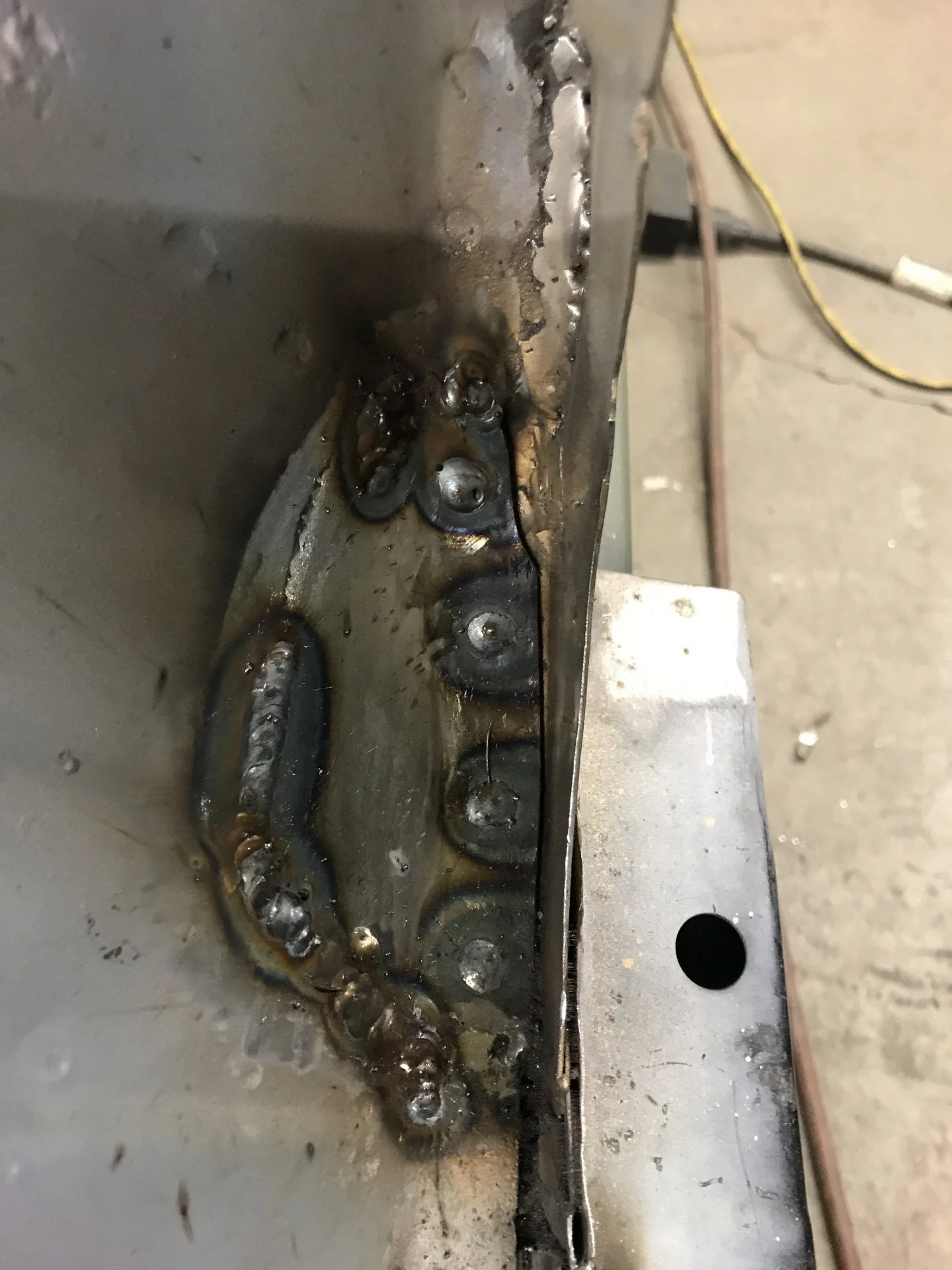

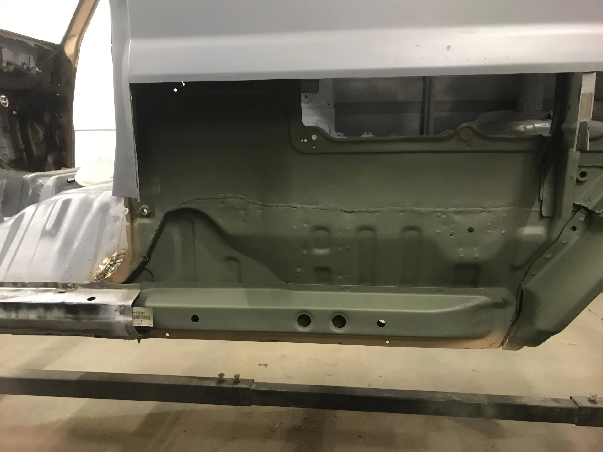

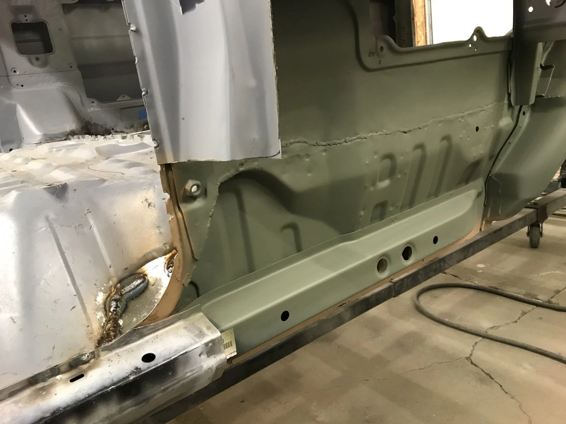

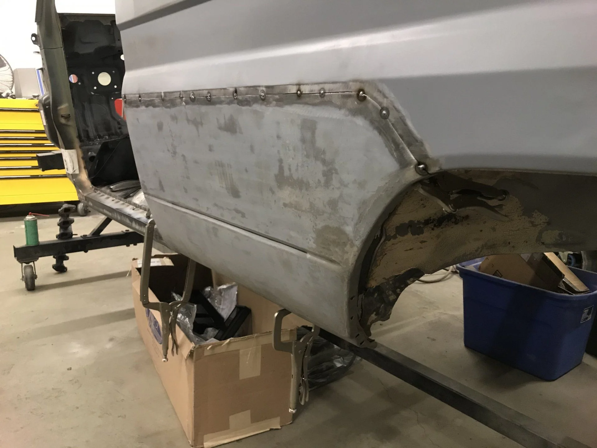

Big crack is welded up now.

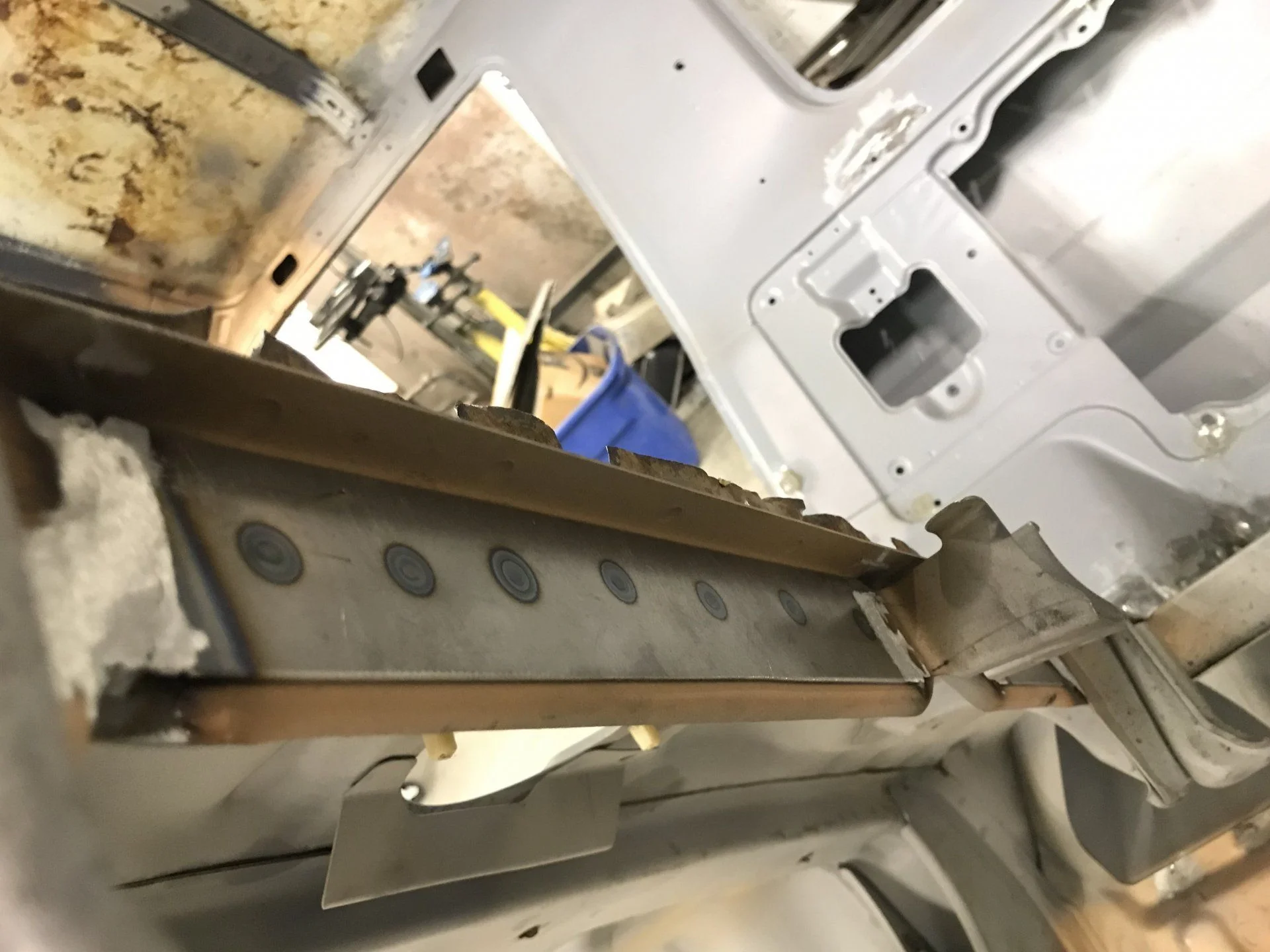

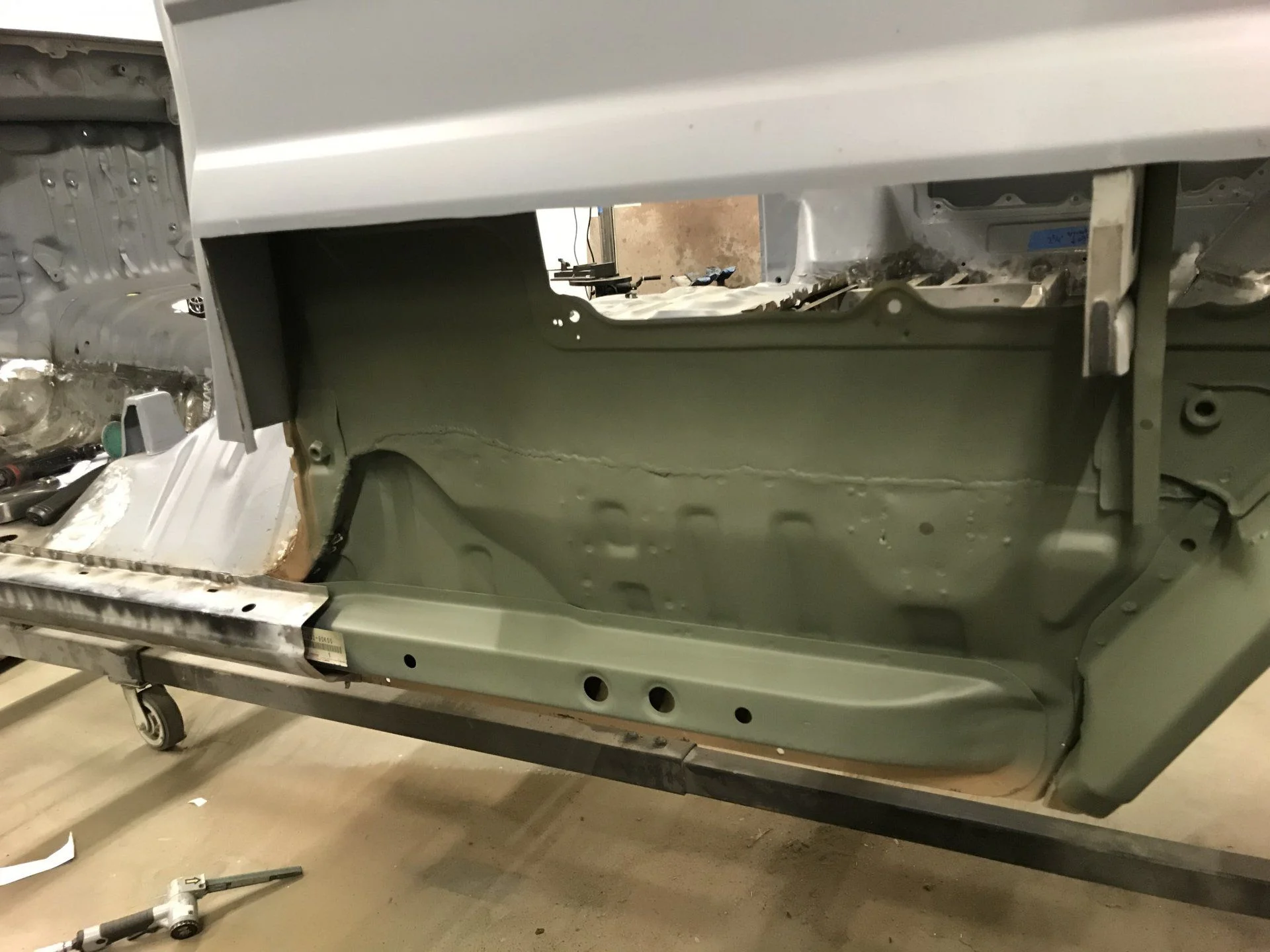

Inner rocker is all welded in.

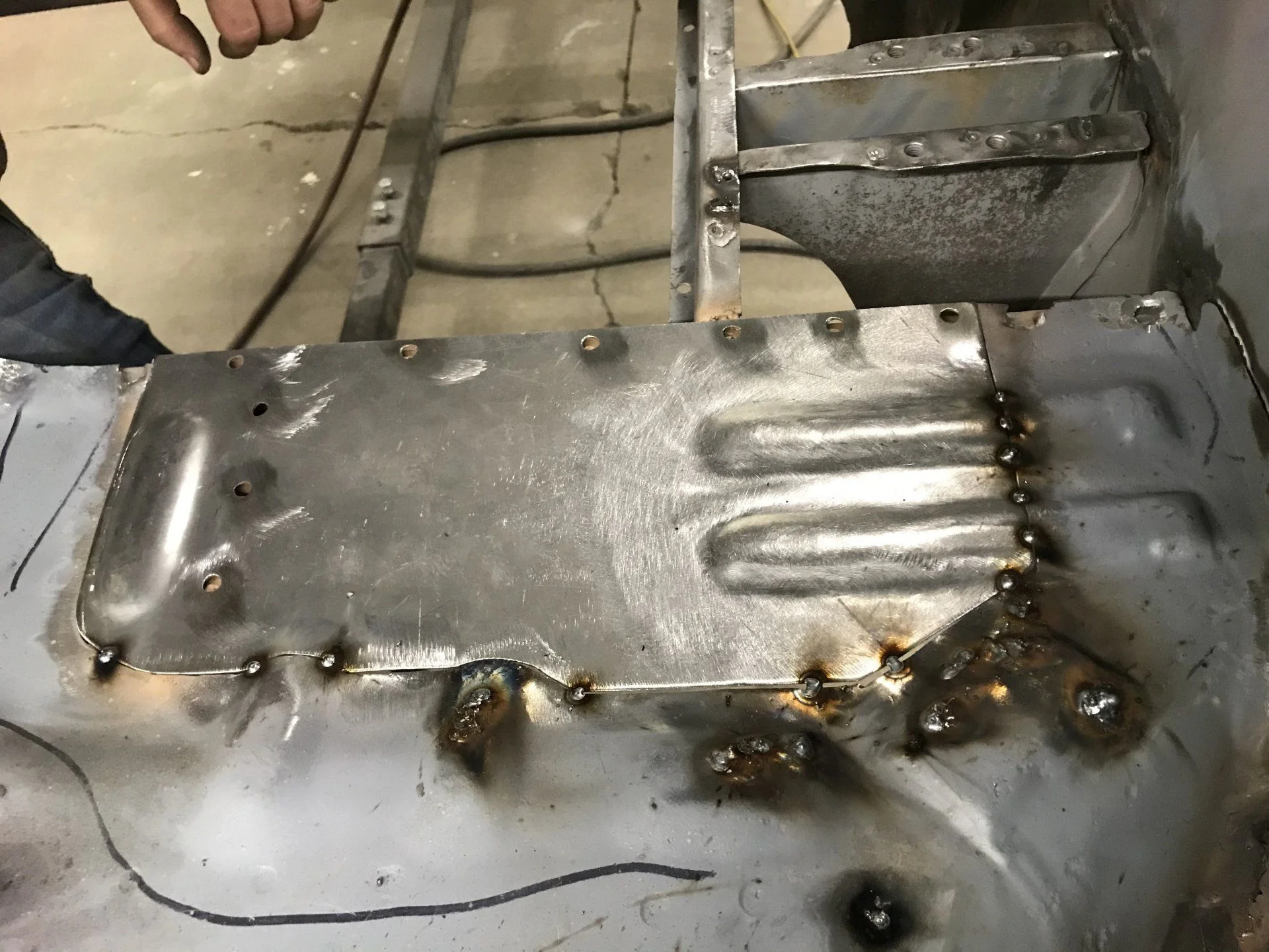

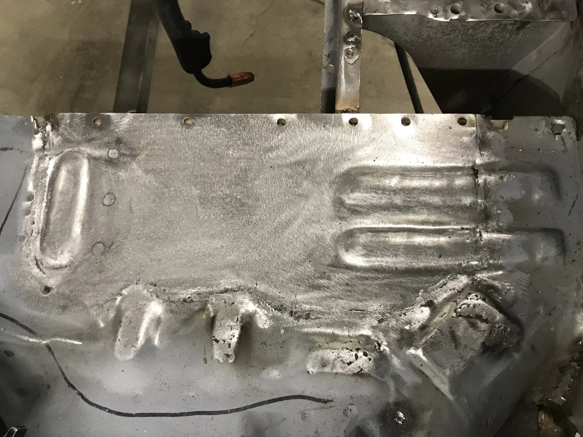

This spot that can be seen previously in the thread is now patched, clean up to do still.
Other side of the crack.
Cheers

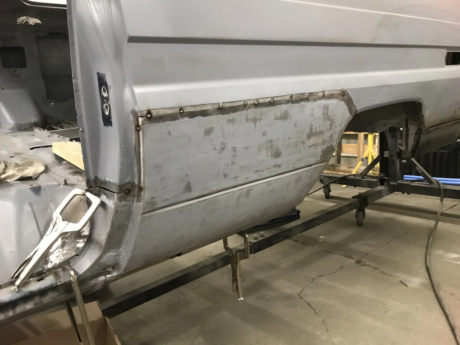

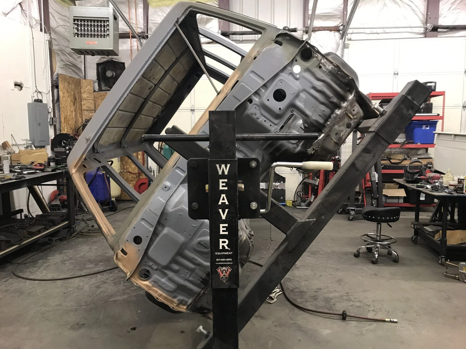

Oh and in case you are wondering why we have a huge gaping hole in the side of the Troopy! 😂

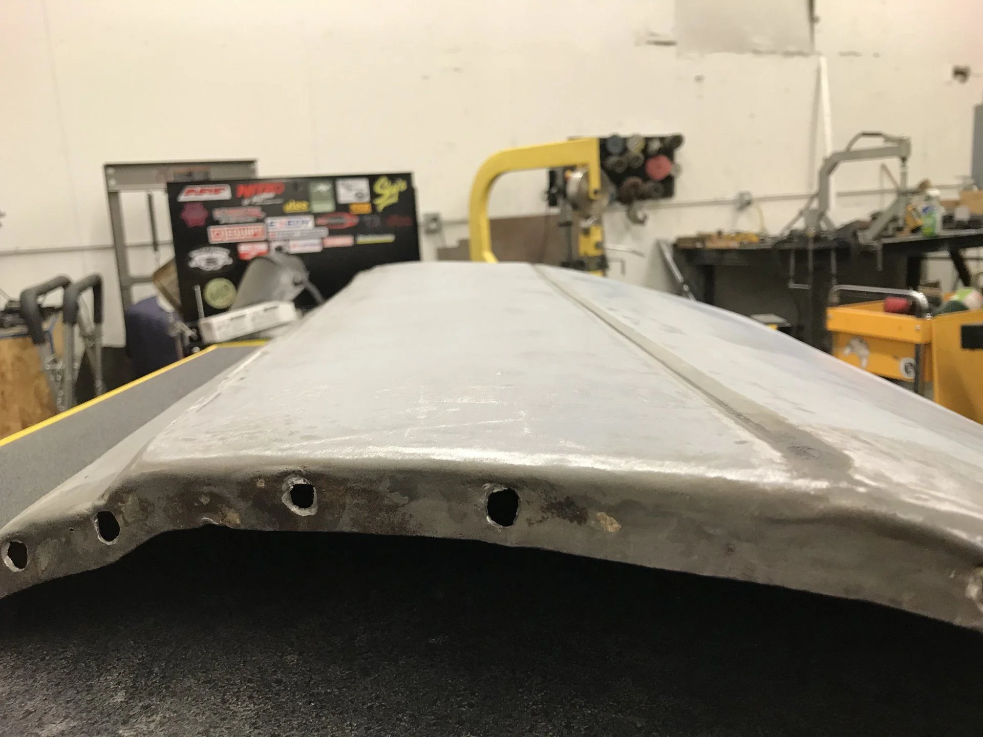

This is the rashed quarter I have talked about before. The Troopy took a hit in this area at some point in its life, hence the rash and crack. My guy who is doing the work now who by the way is crazy good at this stuff feels he can straighten up the panel he cut out and weld it back on vs making a new panel. He is real good with the hammer and dolly so I am looking forward to watching it unfold. In fact he has a 4yr degree in auto resto and has been doing this stuff since he was a teenager. So with his skills (which far exceed mine) we are now taking the Troopy in house to final prep before paint. The only thing we will be outsourcing is the actual spraying of the paint which I have a friend who owns a “collision shop” who can handle that part no probs. He just has no interest in any kind of resto anything since they crank out insurance work day after day.

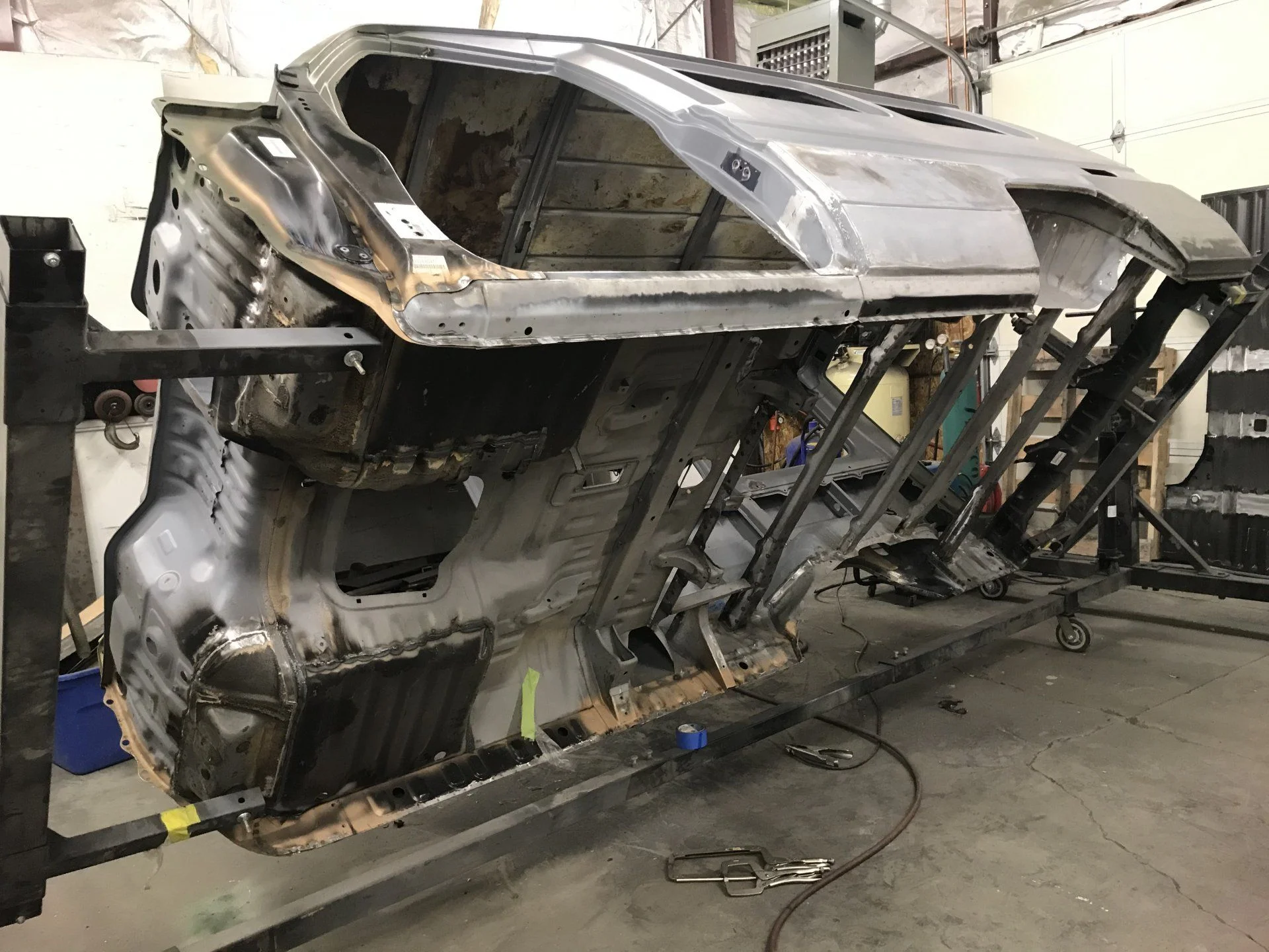

It’s amazing to me how much dirt and crap is still in this body even after all the cleaning it’s been through. And my wife wonders why I’m a bit OCD with our cruiser. I just need to show her this thread and she’ll understand. 😂

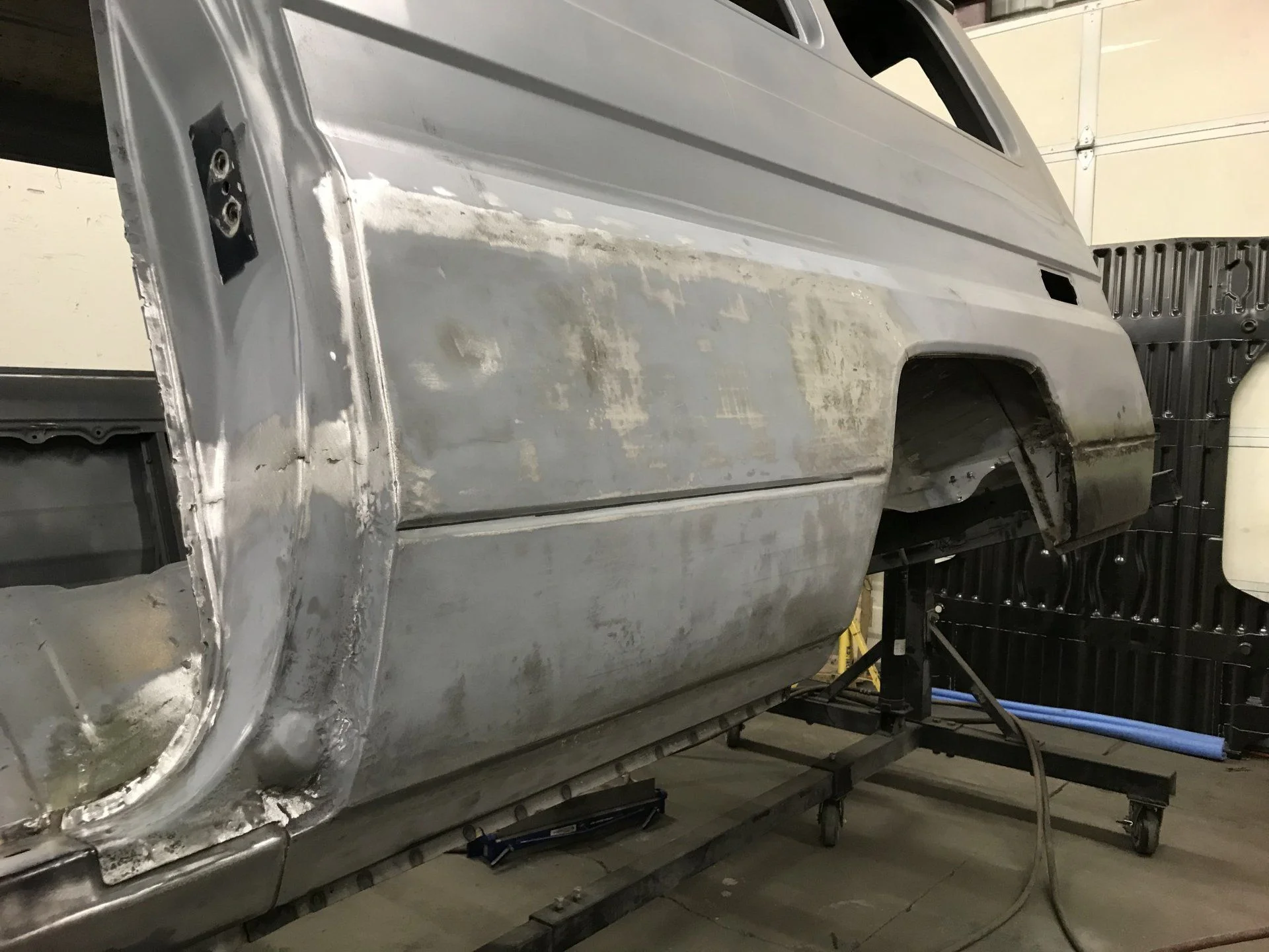

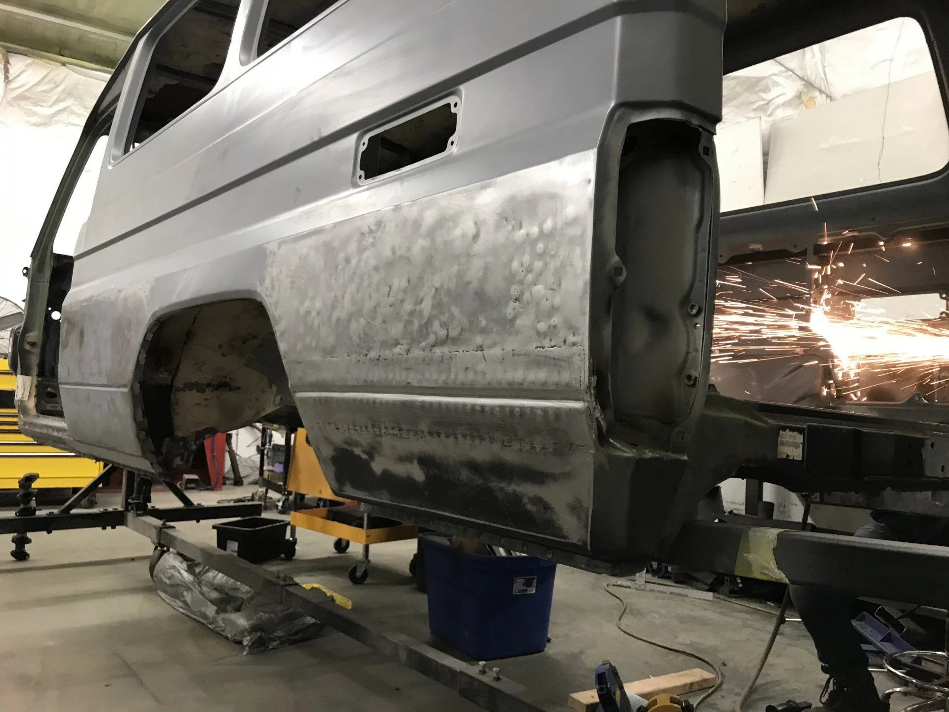

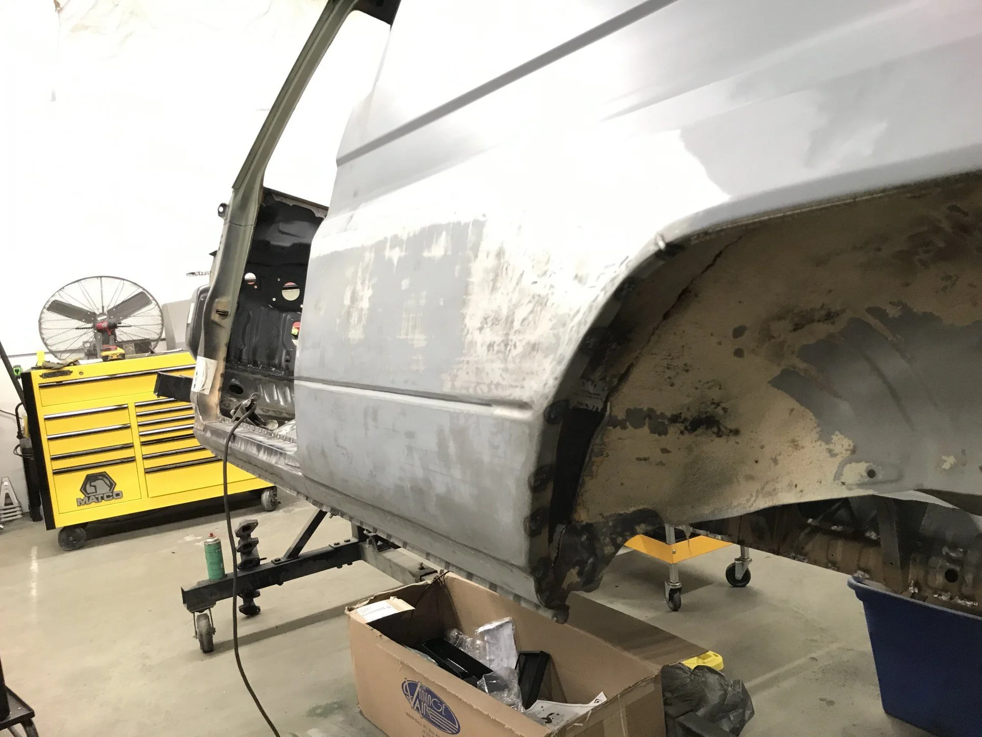

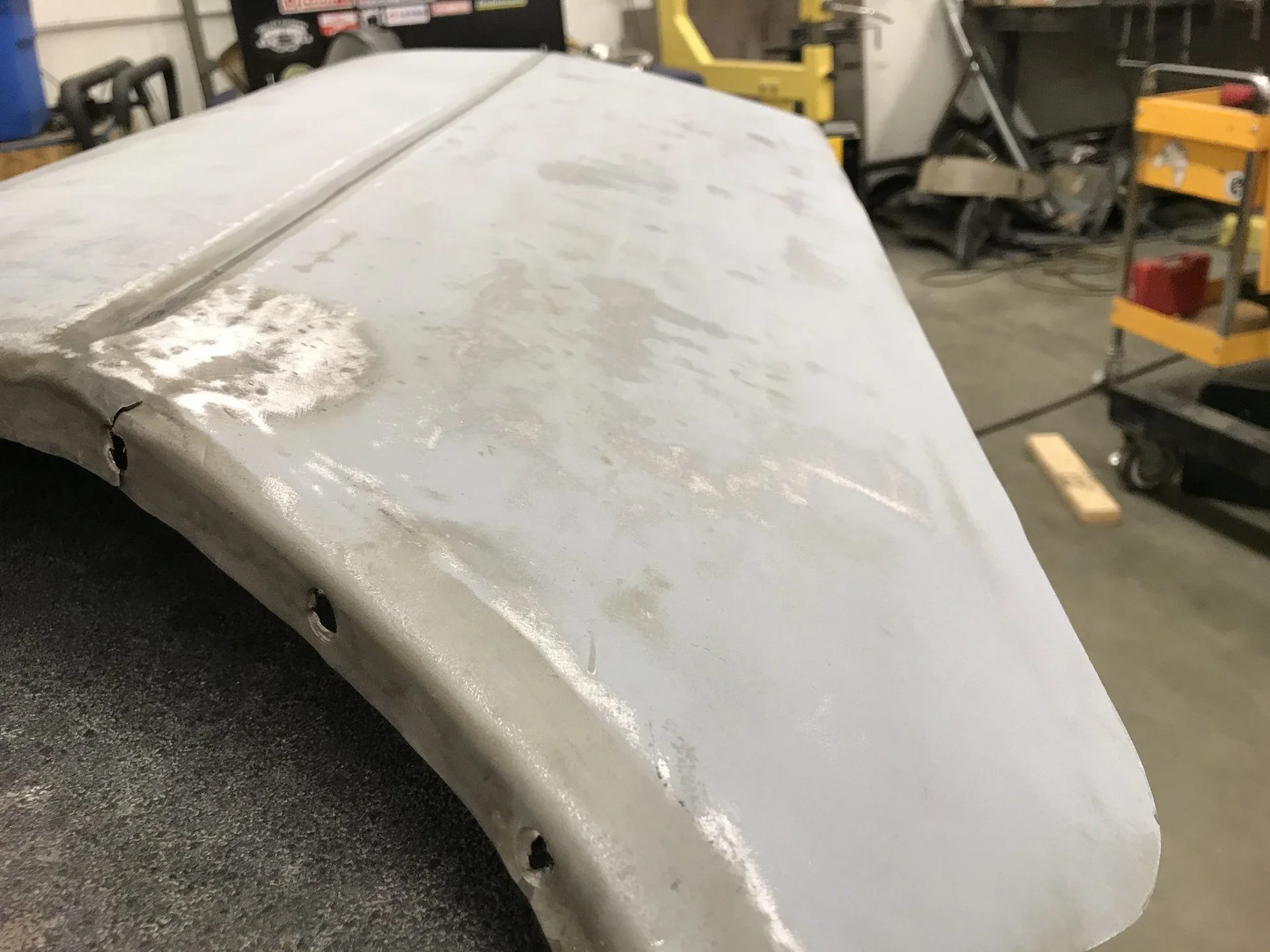

Probably a bit hard to tell in pics but this LHS quarter panel we cut out is nice and smooth now.
It was absolutely rashed so happy about this.
Cheers

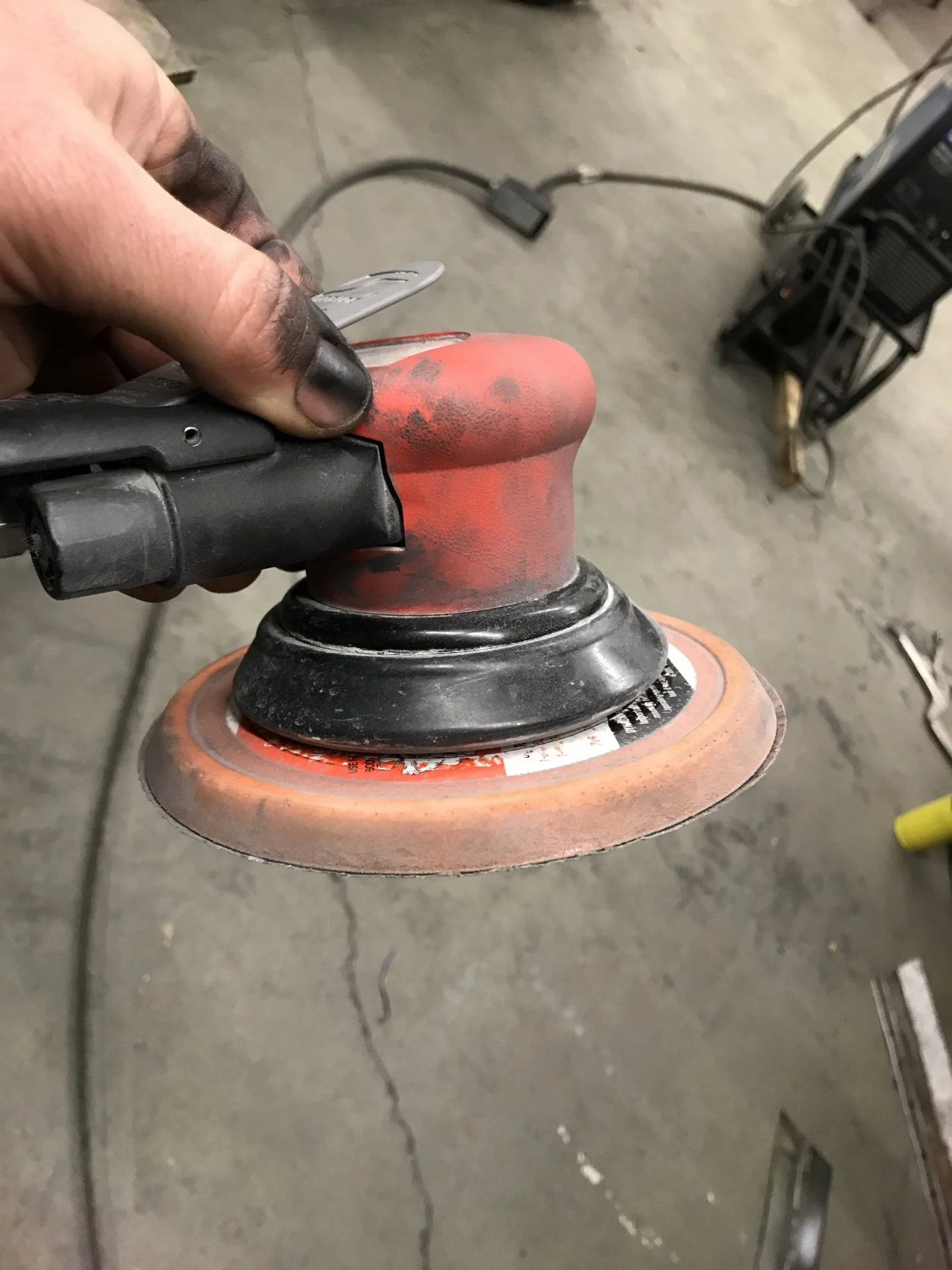

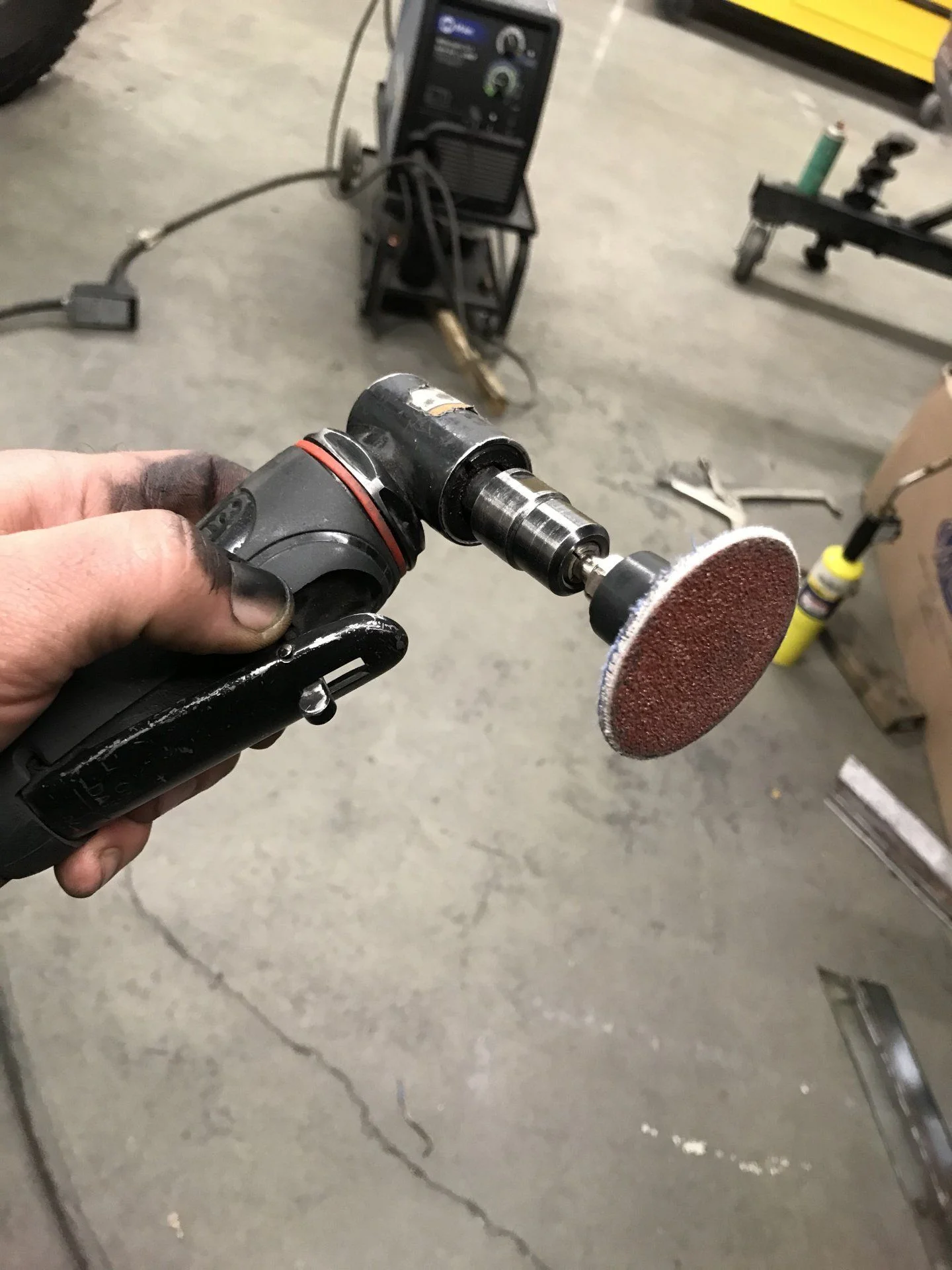

What are you grinding with? Flap disks? I've gotta do some panel replacement soon and these pics are helping me get an idea of what I'm getting into.
All of these.
Cheers

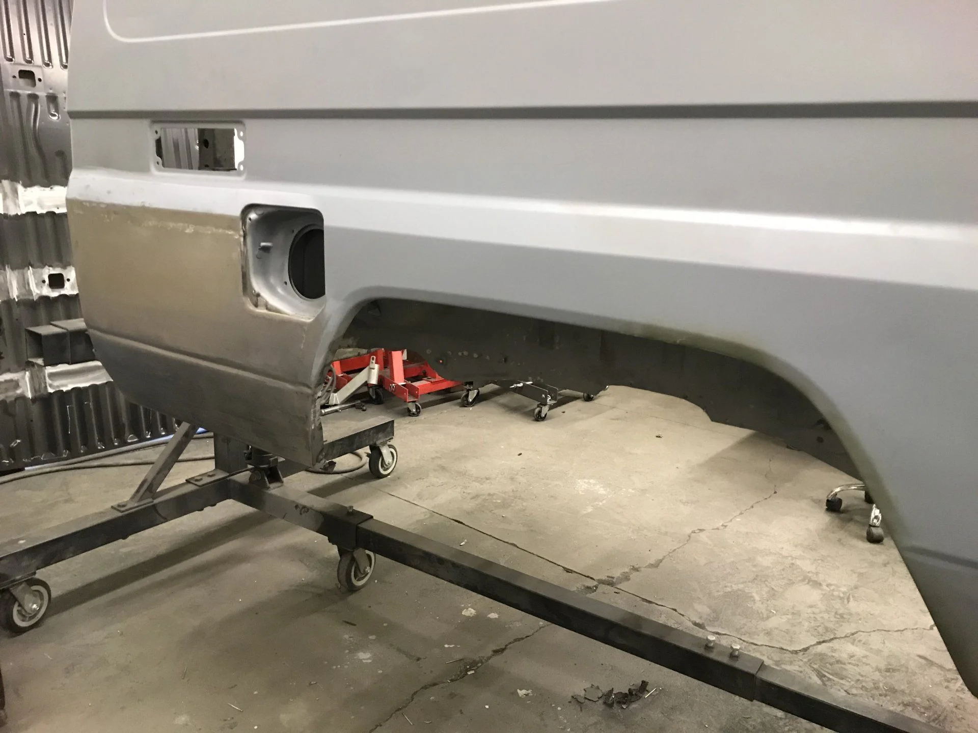

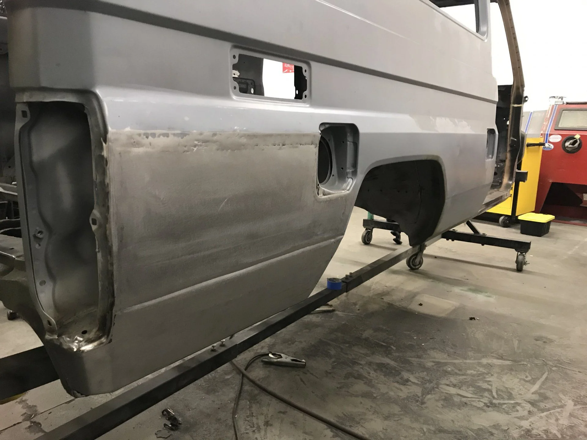

Nice strong lower body line now and this entity side of the Troopy isn’t so rashed anymore.
Cheers

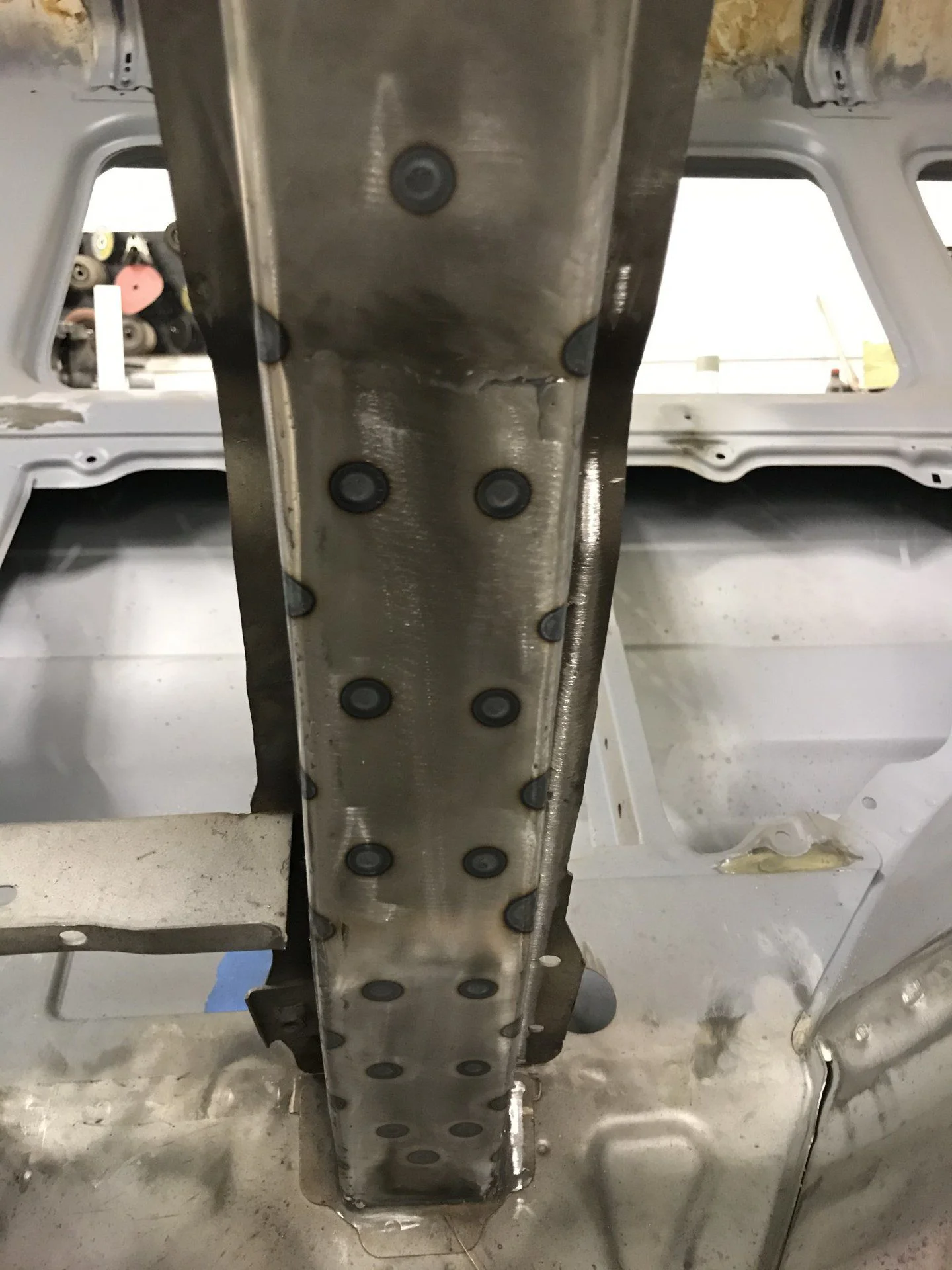

Rear floor crossmembers just about done and prepped for the next step before fitting the floor.
