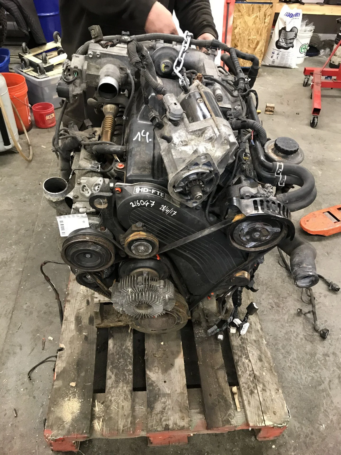

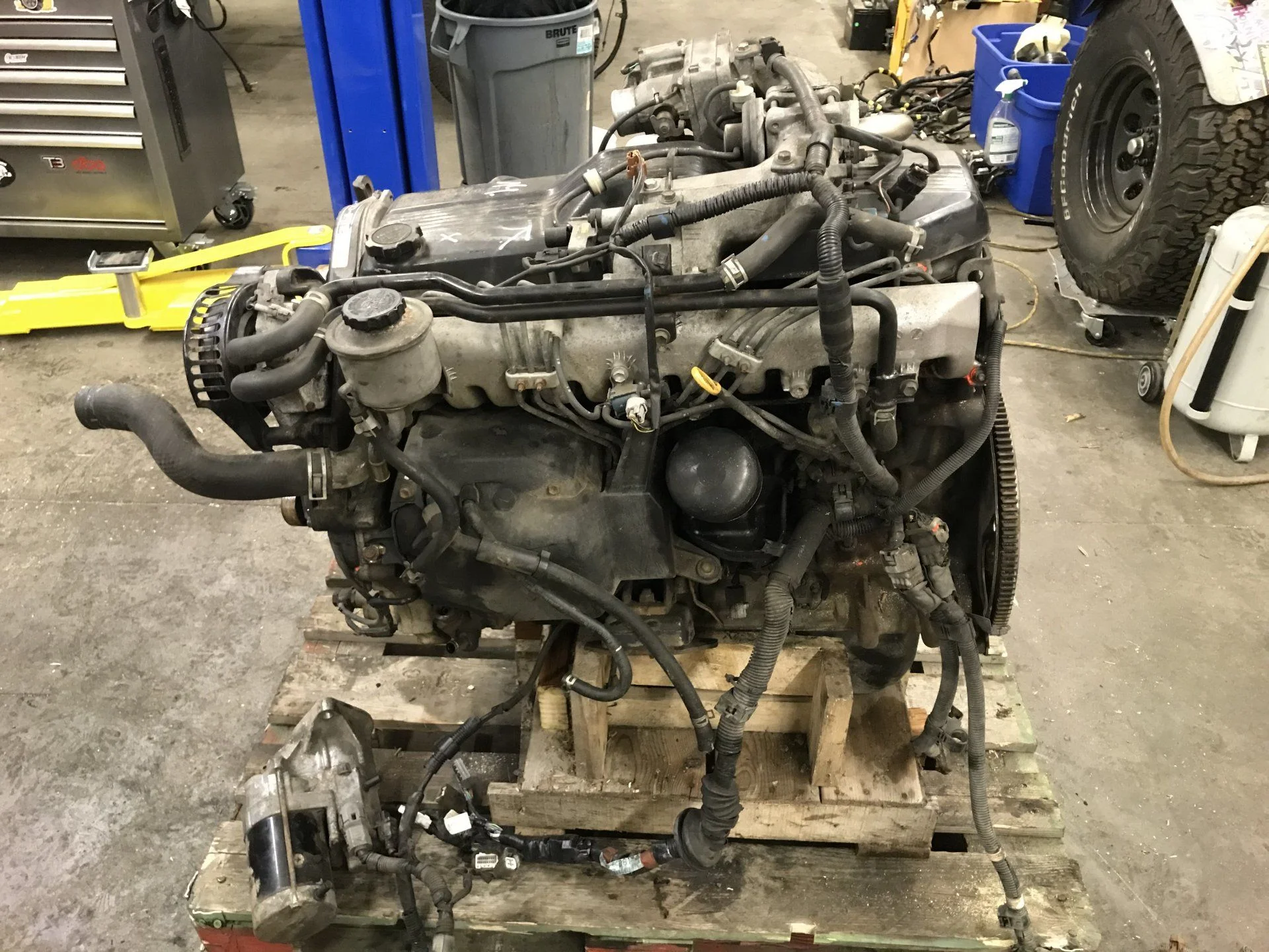

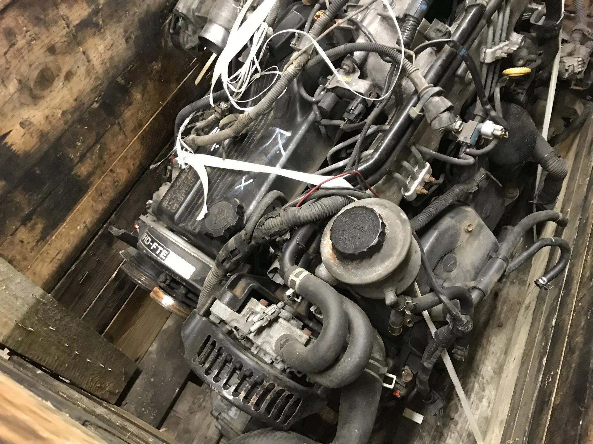

So is the date on the timing cover the last time the timing belt was changed? The date when the engine was pulled? The date when it ended up in the junk yard? Do we have any documentation of its history?
Take a picture of the block casting on the front RH side and let’s get a date on engine manufacture...
EDIT: Sorry if I’m overstepping my questions, Tony.
Timing belt and kms when changed. You can de-code it, give me time.

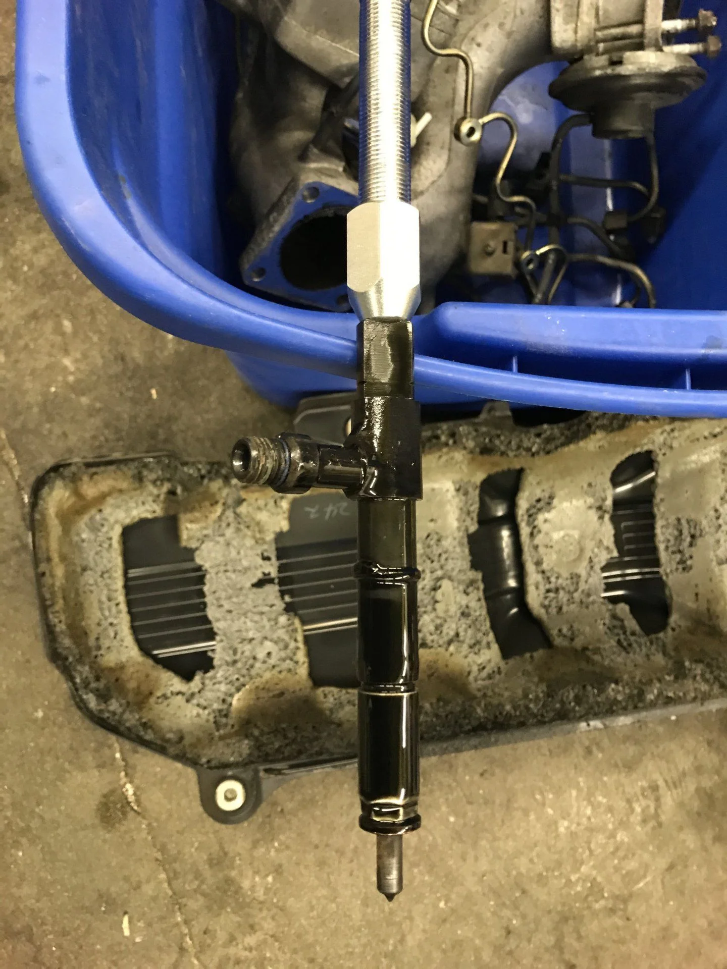

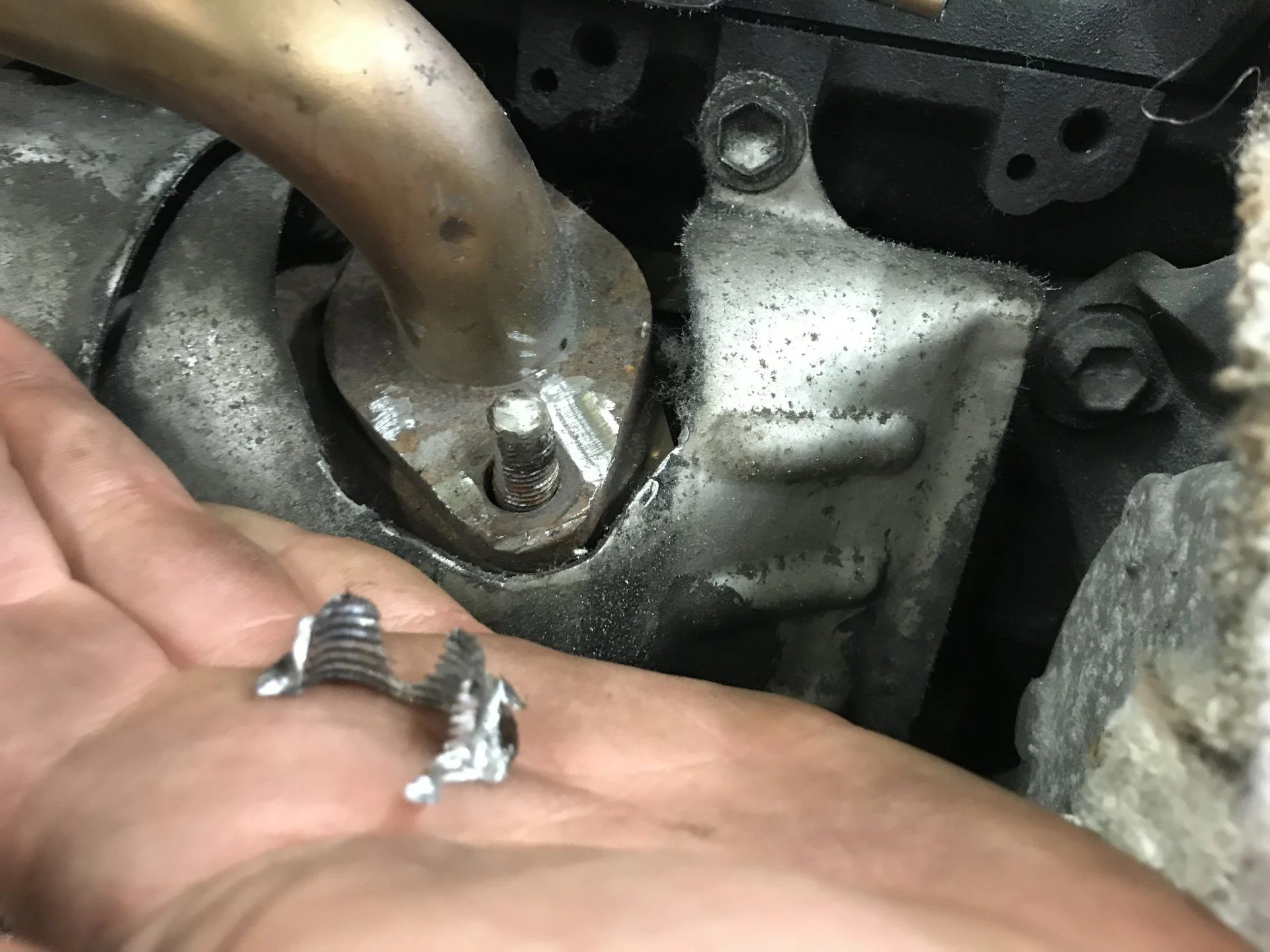

So if you ever struggle with pulling FT or FTE injectors, this is the way. Super easy and these were stuck good.
I don’t think this injector has ever been out, no way to know for sure besides the super old and rock hard oring on it.
That looks pretty good.

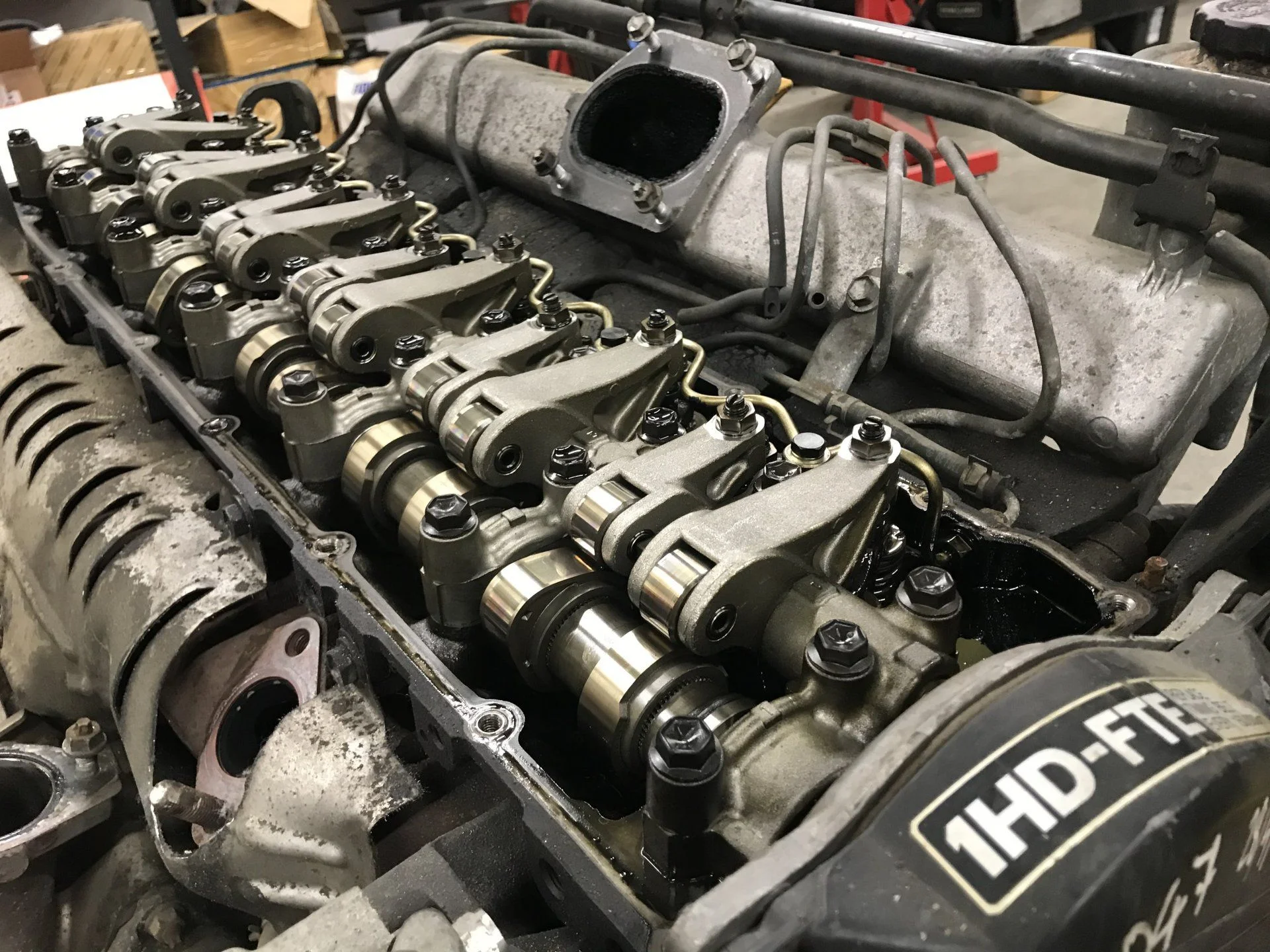

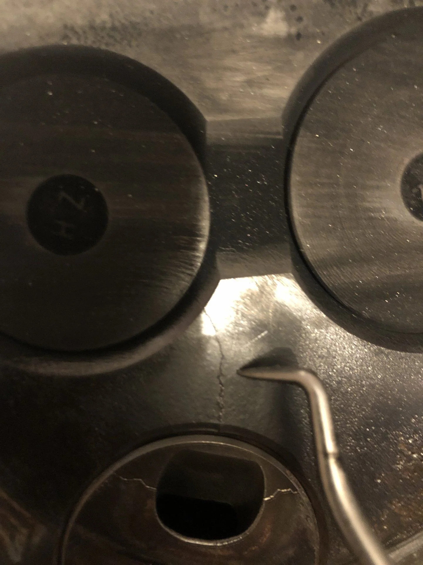

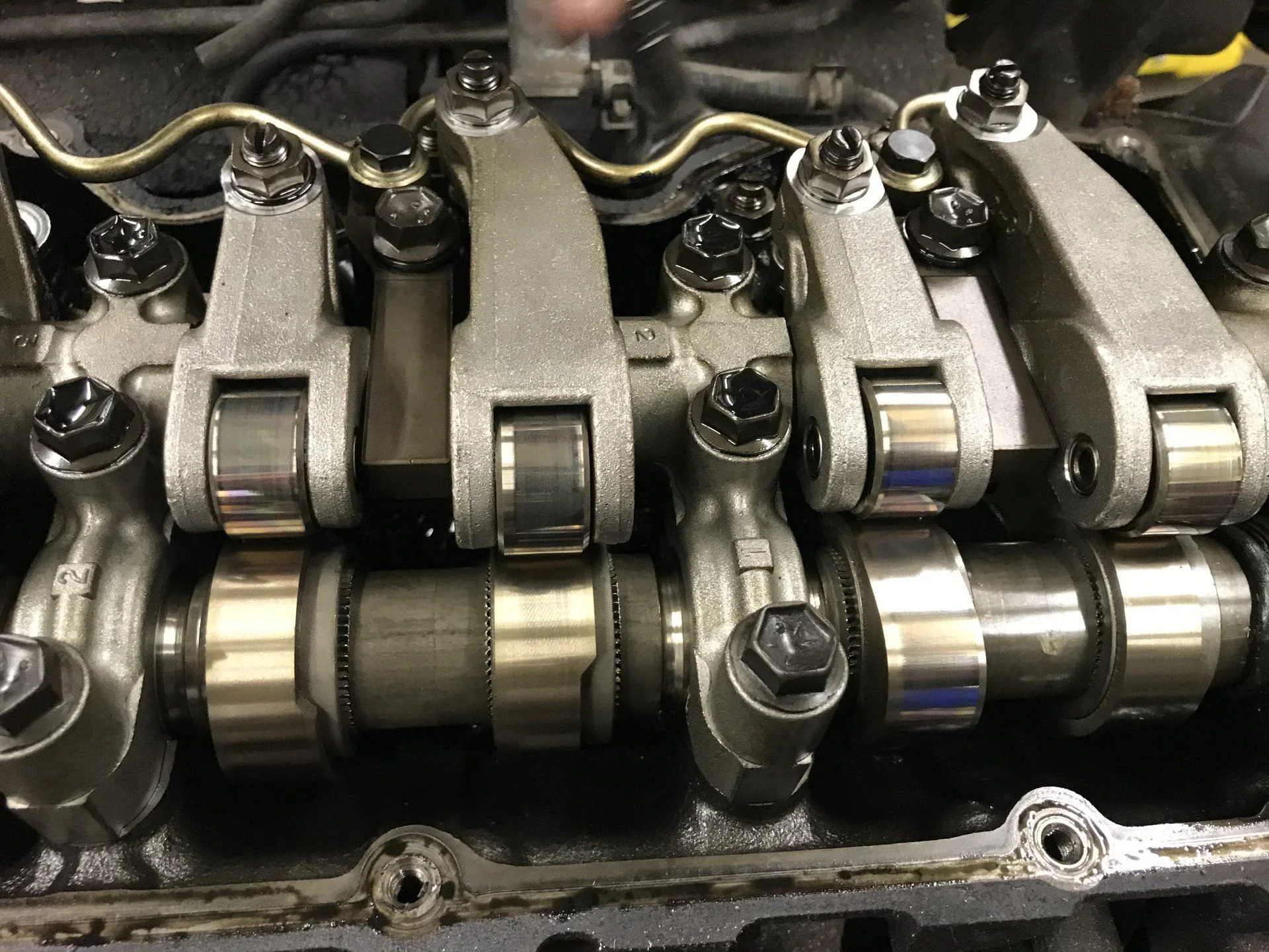

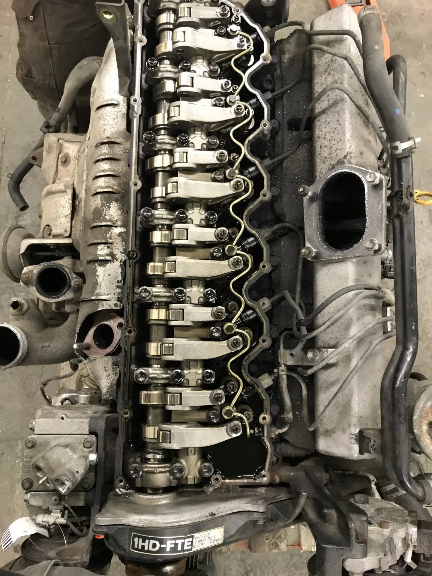

Compression is tested on this FTE. Cold test obviously and we did check one cylinder wet.
I will leave it up to Tony to post results if he wants and what I feel any issues are.
We have tested x2 FT’s and now one FTE in the last week. So I am probably going to start a thread in the diesel section to discuss what we are seeing in my shop on these engines.

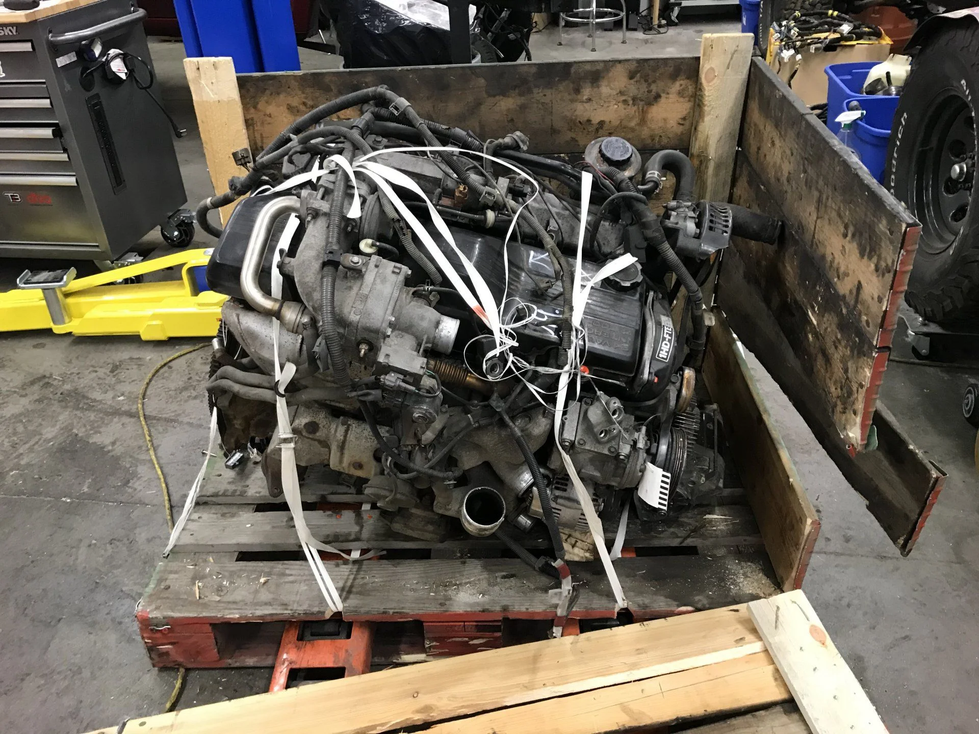

If I Were To guess, I'd think it very difficult to find one that has not been worked really hard.
Well, it's to bad we can't just buy OEM long blocks all day long.
Oh well, these engines can be rebuilt multiple times.

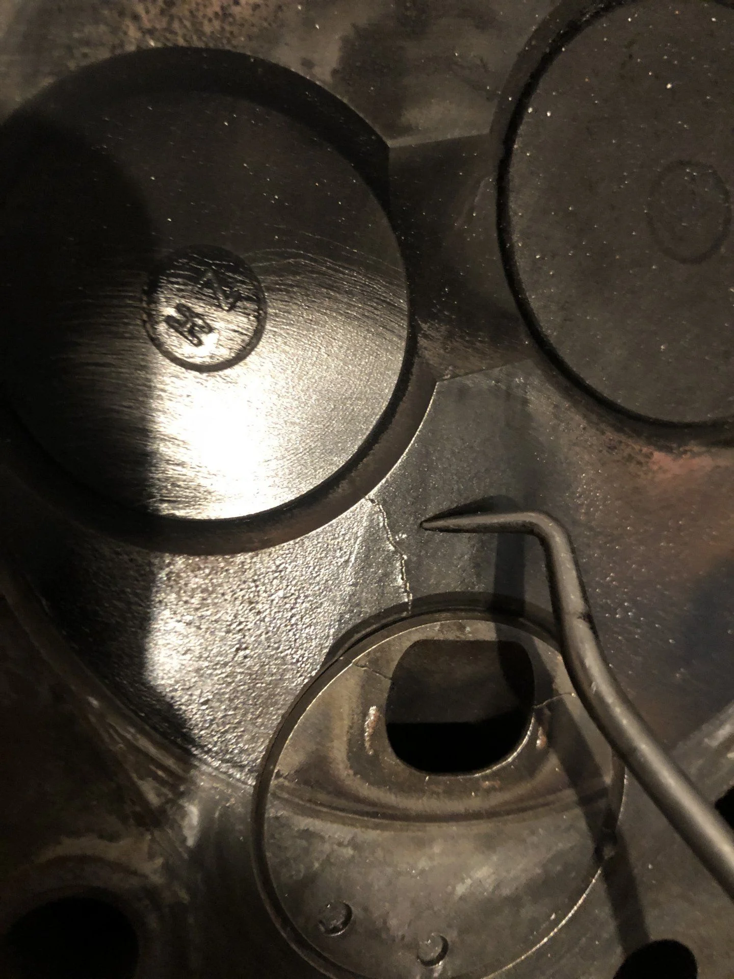

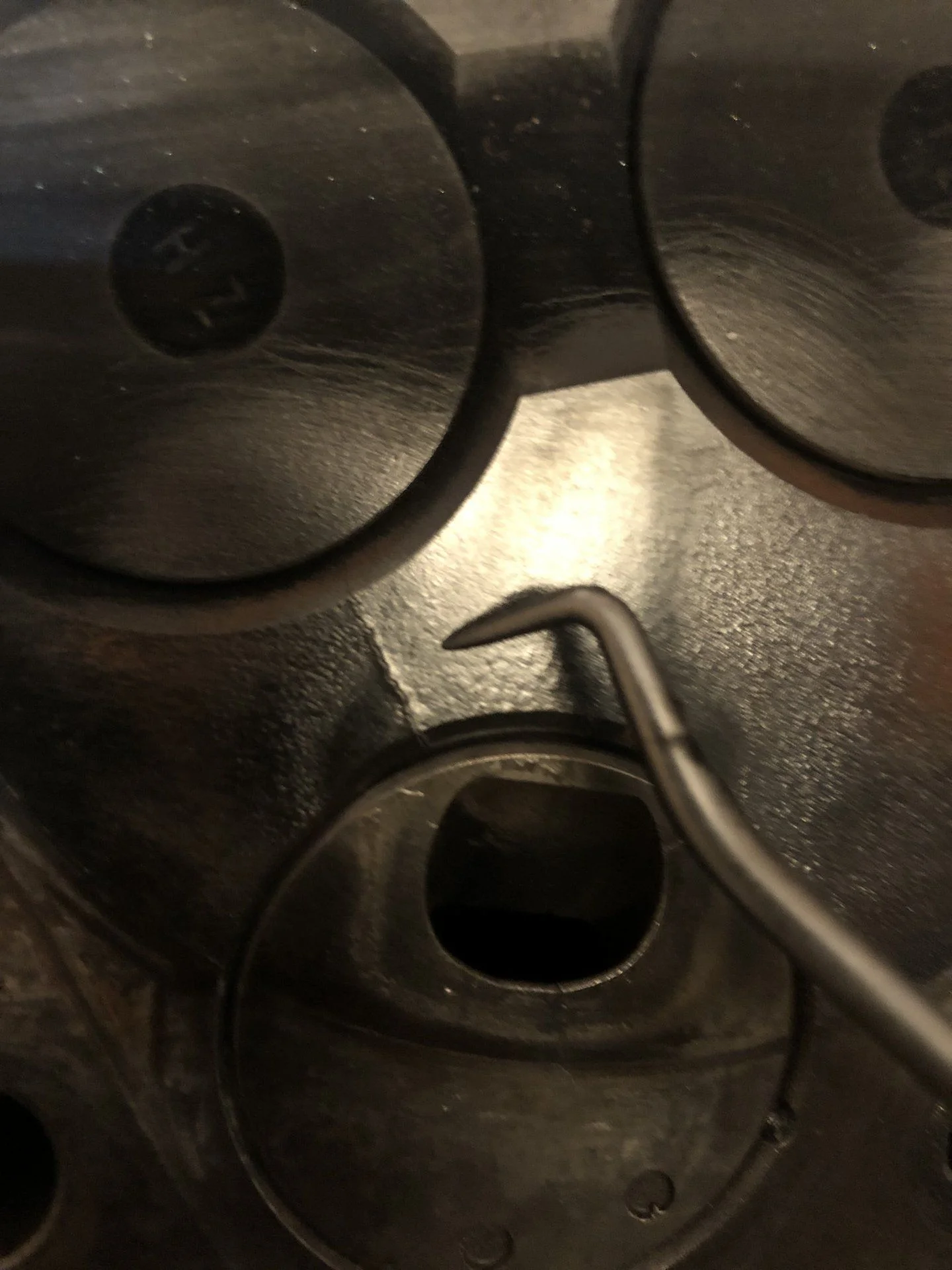

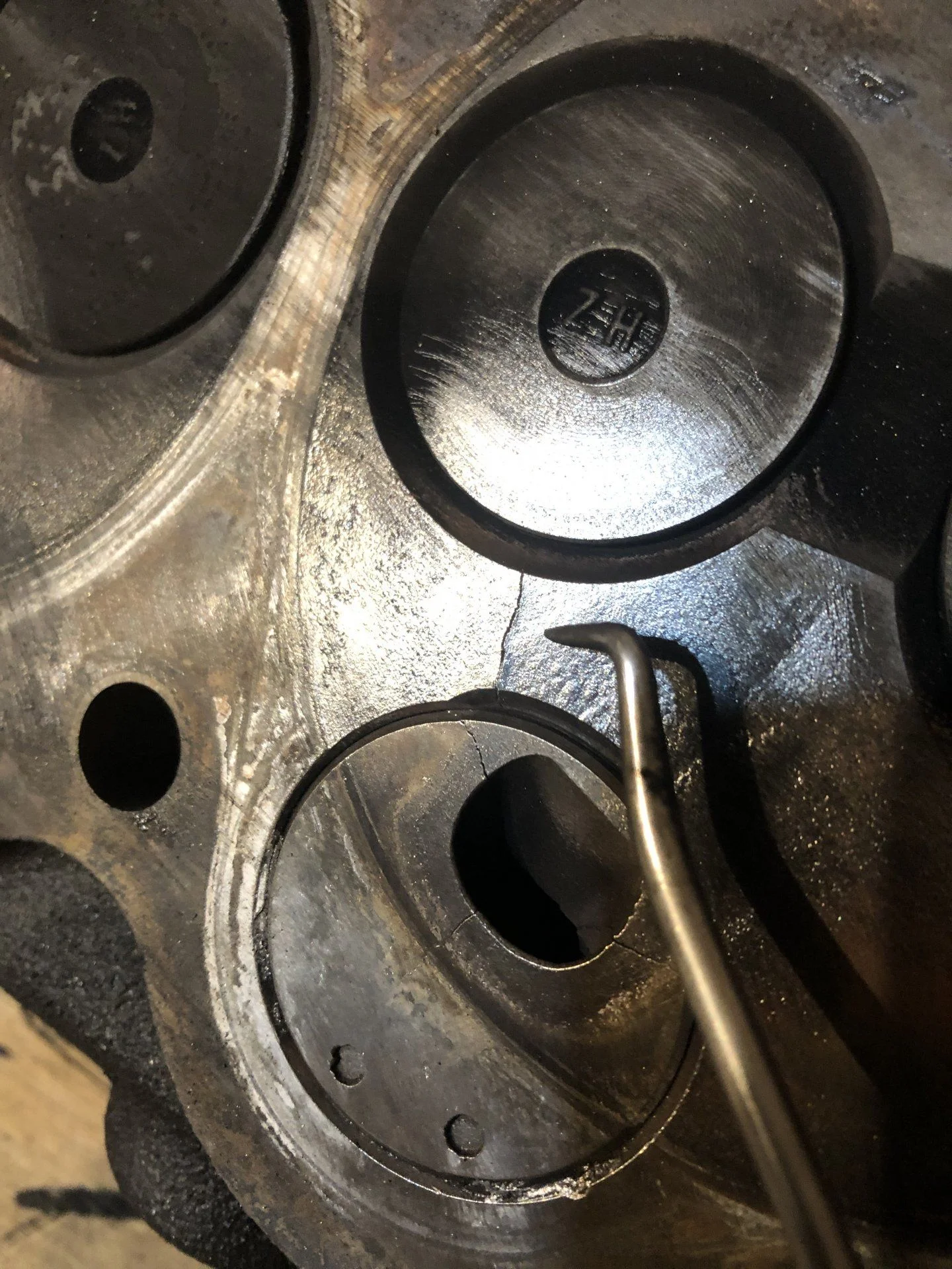

I planned on having the head pulled, reworked, and a full gasket job done anyways for peace of mind. So it is what it is.
I'm not too worried about it.

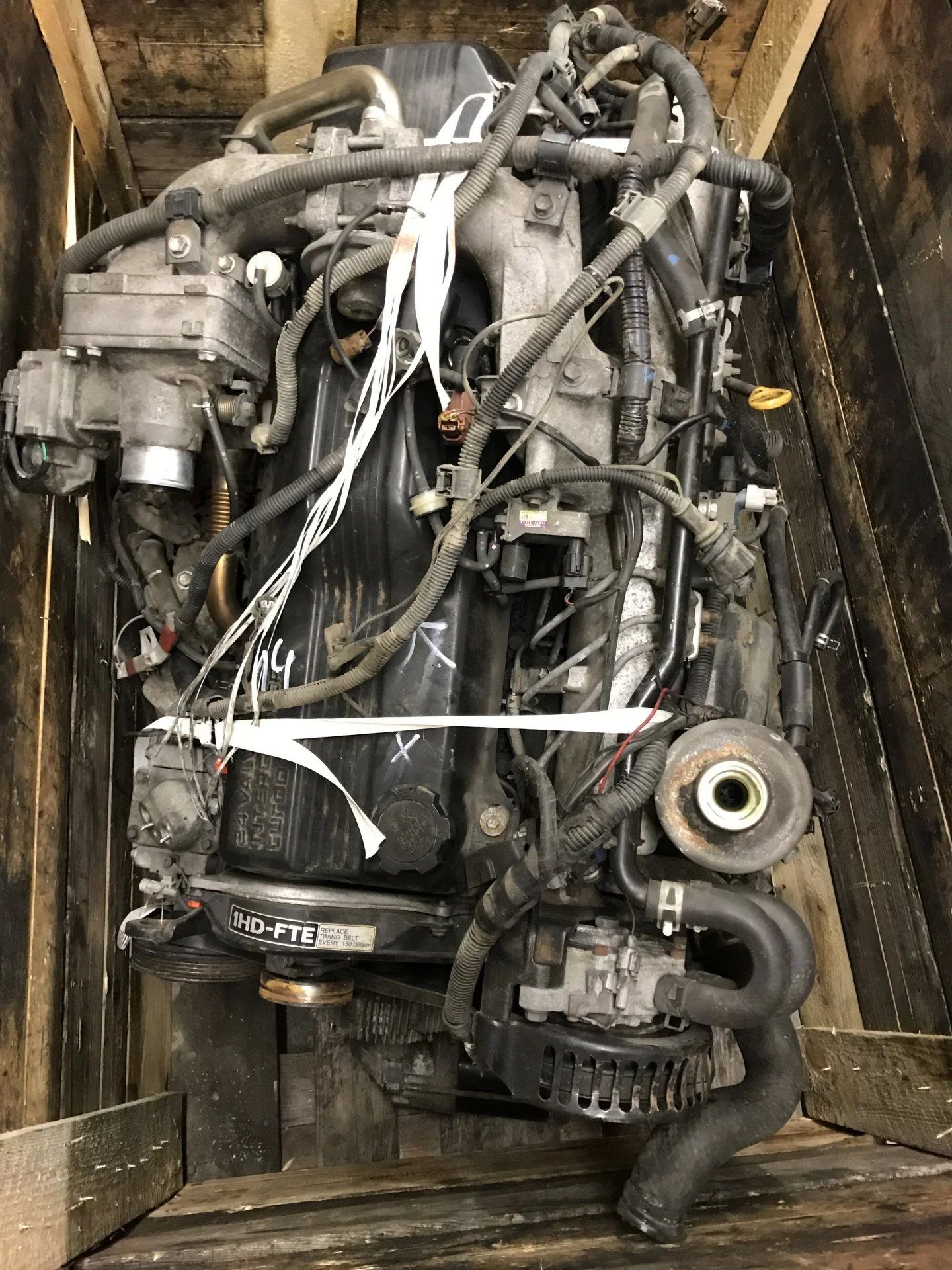

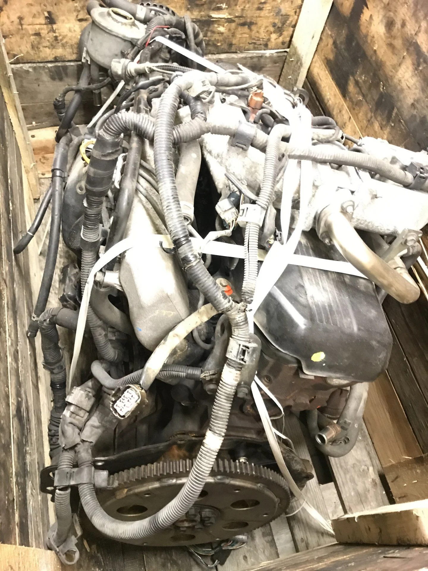

I got this FTE for a fairly decent price.
