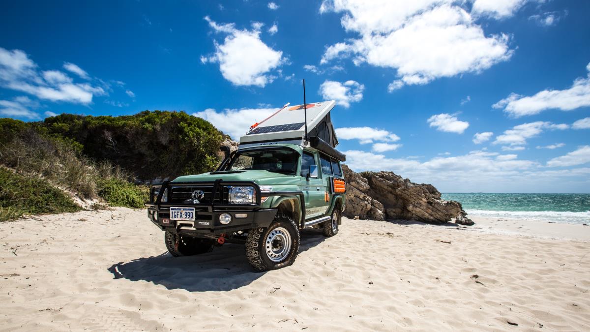

I don't remember which direction you decided with the front end, but after spending another two weeks in Ethiopia, I think the updated front end really looks great in person. The old looks cool, but is so narrow, plus has old school sealed beam round lamps.
Every year I go, I see tons and tons of cruisers. Every ambulance is a troopy, plus many NGOs have troopys. Jealous of your build.

Still up in the air.
We had a few '07+ 70s as well as a few pre-'07s at our location on the deployment I was just on. I could go either way. Depends if a good set comes up for the right price. It would only be purely asthetics since the added clearance isn't a game changer.

Keep in mind that the wide nose really covers up the front wheels when using the 80 axle.....not sure if that is an issue for you or not.
Will you run an 80 rear? Wonder how that will fit under a troopy body?
The 79 pickup bed is really narrow and the rear 80 axle width is pretty wide. Requires flares and some skinny wheels to get them flush. We have some 16x8 stock 80 series wheels on my roller right now and they stick out a mile....especially without the flares on it...makes it look even more exaggerated.
Also with the wide nose on the 80 frame, there becomes some grey areas with fitting a proper 70 series wide nose bar on an 80 frame. You're either matching the body or the frame....or adapting the frame to fit the 70 bar. We're going to mod the frame/bar I think as I want the proper bar for a wide nose truck with flares. Probably will do a Dobinsons bar on this build. I believe they offer one, like ARB, that fits flared trucks.
