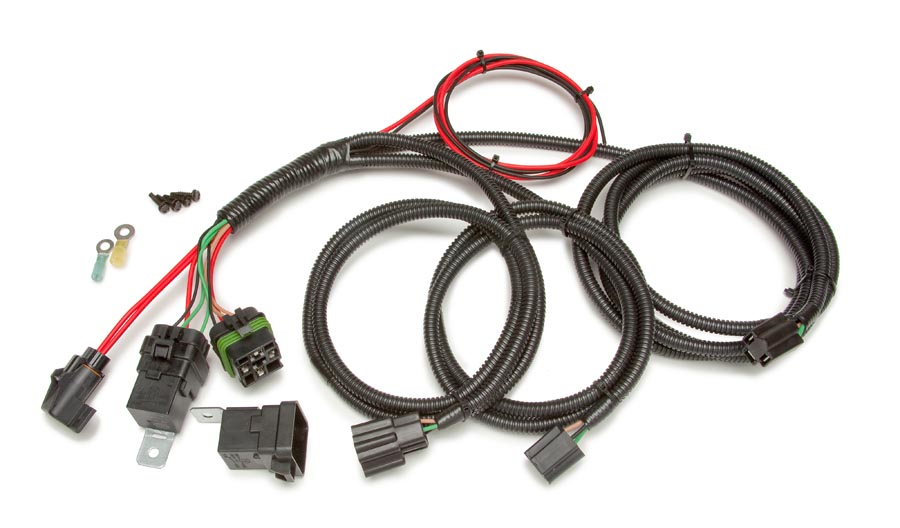

You might also consider a headlight wiring harness upgrade. The way Toyota wired the headlights, there is a ton of voltage loss.
I am doing this in the PZJ70 so will have more to report back on it soon. I bought a kit rather than build it myself.
Cheers
Ended up with this. Not cheap but looks complete. I should probably order two so I can clean up the BMW's wiring too... meh the Troopy takes precedence.
