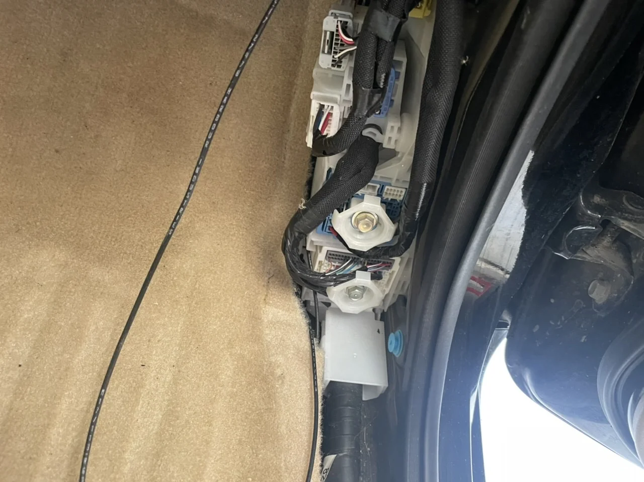

Installed my Tesla unit and no sound. I've double checked my wiring of the new unit and sent pics to EC Offroad to verify I didn't do anything obviously wrong. I am beginning to think I must have damaged or unseated some connector somewhere. As it happens, I did have the foot kicker panel off to access the area on the floor by the passenger door sill. I had done this weeks ago when I installed a antenna cable for my Ham radio. Maybe the FL1 plug has been kicked as I've been in and out of the truck about 1000 times doing the Tesla install. Nothing obvious is loose.
How to I test any of these plugs? Would seem I'd have to know what pin does what.
At this point, I am going to first inspect as many connectors and fuses as I can and if that doesn't find anything, I think I'll pull the Tesla unit out and reinstall the OEM stereo and see if I have sound. If I still don't have sound, then I will know I have something wrong in the truck wiring. If I get sound, that will mean it is the Tesla unit itself or the Tesla unit wiring harnesses. ugh.
Edit: is this the FL1 plug (bottom one with bolt retaining thingy)?
