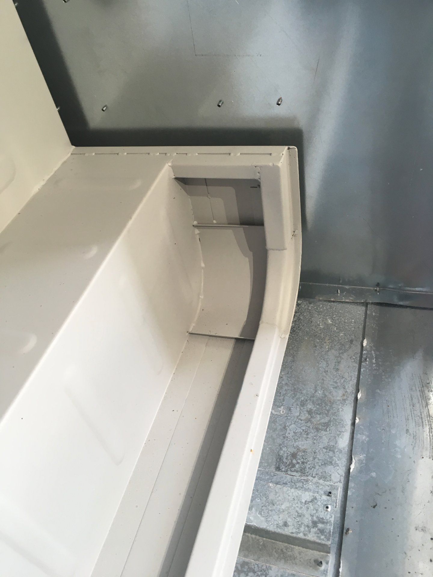

So what about the tub I got? Well...first of all ...you need to see the crate it came in. I've had vehicles themselves that aren't built as good as the
crate this came in. It looks pretty bullet proof for shipment. Its also a bear to deal with due to its size and weight (~500 lbs). I finally got it off my trailer yesterday by building a boom on my front end loader....lifting each end up onto rollers that I had in the shop...and then slowly rolling it off with a couple of helpers.

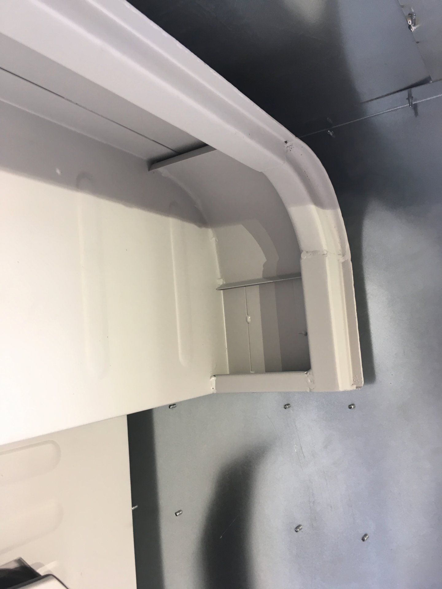

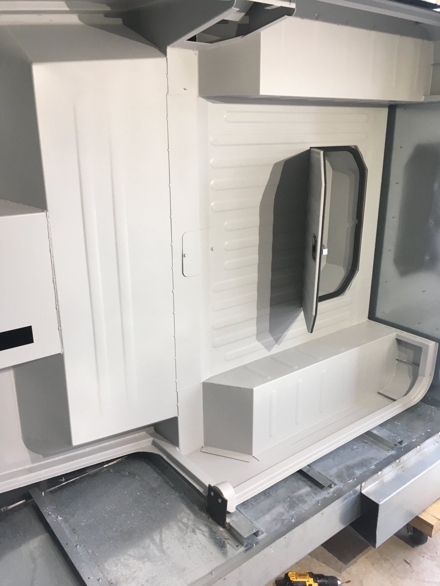

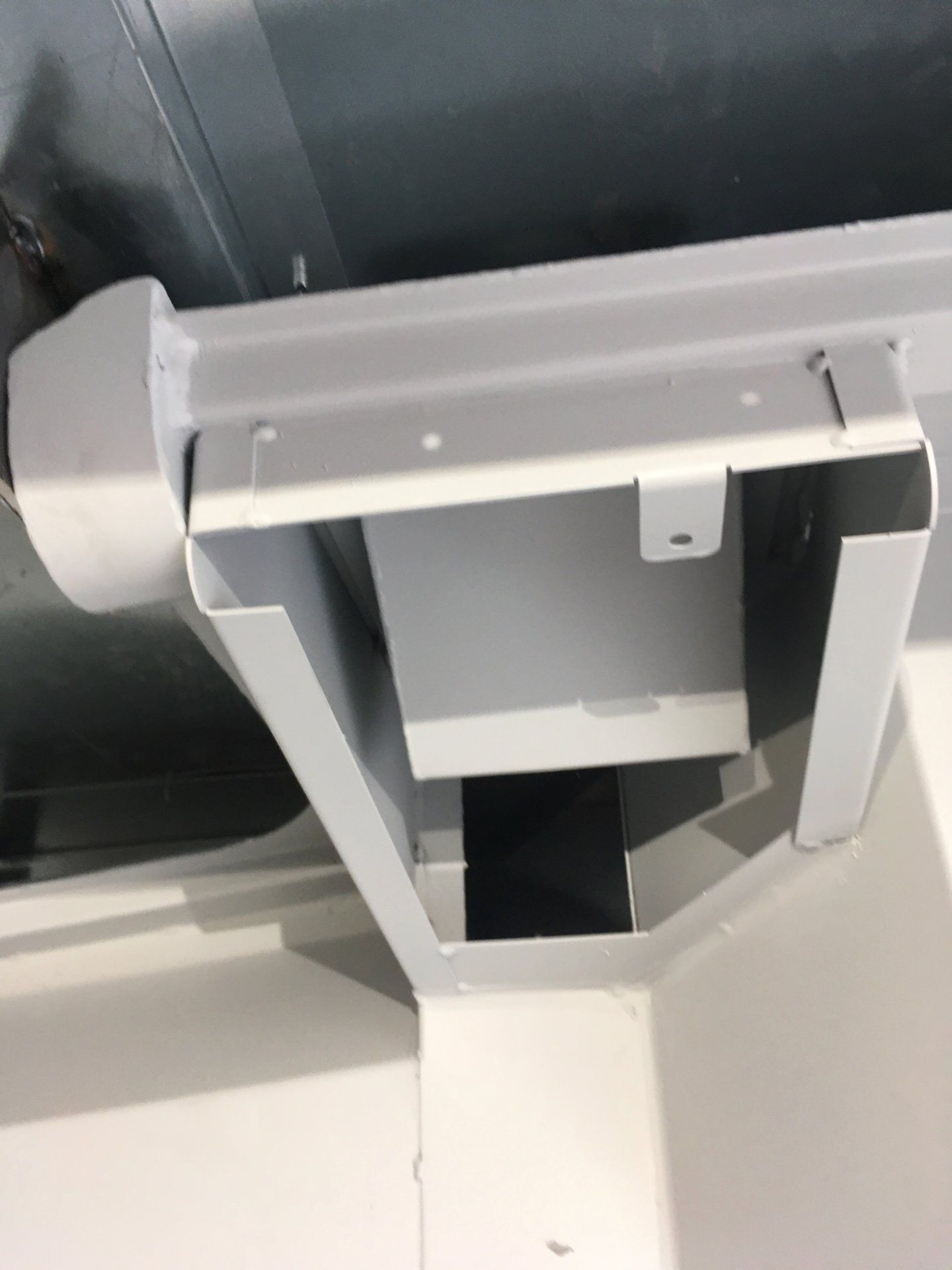

So you'll notice things we already knew about these tubs... They aren't complete for the hardtop given that the pillar does not have the center hole for the quarter panel post and none of the screw holes are present for the attaching the quarter panel itself. We've talked about this in other threads ...and I expect to use something like nutserts.
Additionally you'll notice its not set up for the seats. There are missing posts on the riser area where the seats mount and the center is also missing. In the rear there seems to be good reinforcement for attaching the tire carrier...but of course the mounting is not present.
Now ....instead of carping about whats missing...I'll gladly state it looks like a stellar build. Every joint butts up nice and the welding looks top rate. They gave me a shot of primer that looks good and complete. I will start measuring within the week to see how close it matches up to my stock tub.....and I'll also try and figure out how I'm going to get it the rest of the way out of this crate.

I have not installed it yet, I’m just finishing the front 1/2 to match this. The mounting is made a little different way to the B-pillars, which could cut off if needed.
1907280
But I like this, just grind and weld B-pillars flat and you have solid mounting and easier go get it straight.
I think I’ll replace the spot weldings (to the front 1/2 tub) by M6 bolts, then I can take it off in parts in the future if needed.
Since I don't have an aqualu...I really can't compare. I'd actually anticipated an
even closer match to stock with the Teseven than I got. When looking at the pics
and order form...I was thinking they were practically indistinguishable from stock.
However, now that I've seen it in person ... you'll see that the trans tunnel and
seat setup look very different. As of last year when I ordered...I really could find no
quality pics of this thing...so I was a bit blind.
Now...I'm not disappointed (yet) but have yet to plow fully into it.
Lastly my flux capacitor just doesn't work with aluminum. It only works
with stainless steel cars. I doubt I'll achieve 88 mph though.
