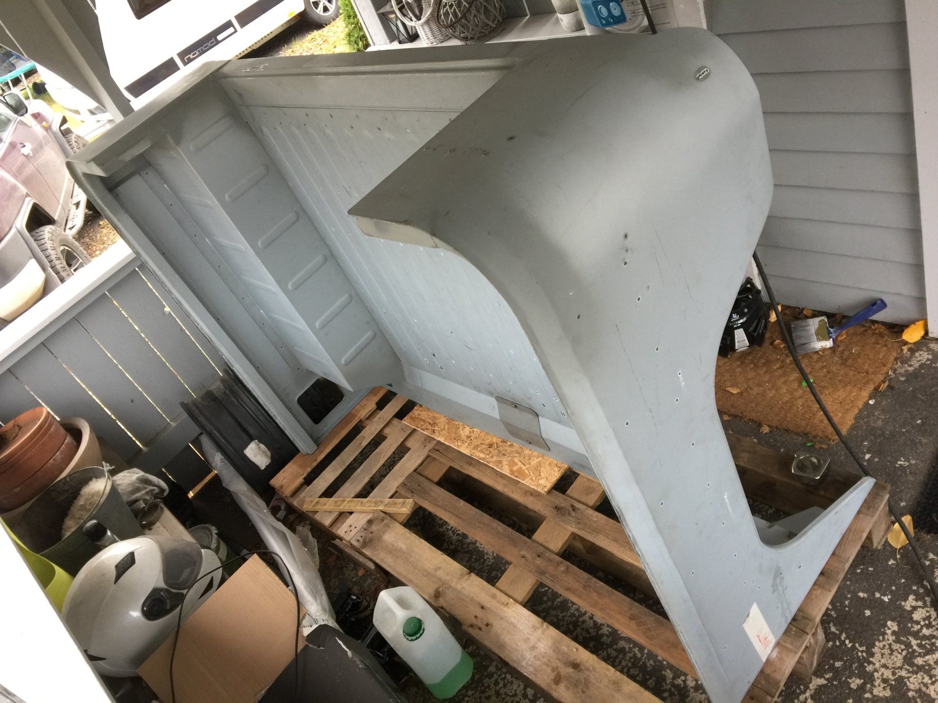

I got mine about week ago. Looks good to me. All screw holes for hard top and holes for the rear mounting bolts missing, but I knew that. Made of 1.5 mm thick electroplated sheet metal.
I think this is supposed to mount a little different way than the original rear quarters, this have a lip with 90° angle, original is straight and spot welded to the B-pillar lip. I think I’ll cut the B-pillar lip and weld it over, then weld the tub to them.
I got free mounting kit (bolts/rubber blocks) for the tub because of the delay.
I am happy about the end result, just took time quite much more than promised.
