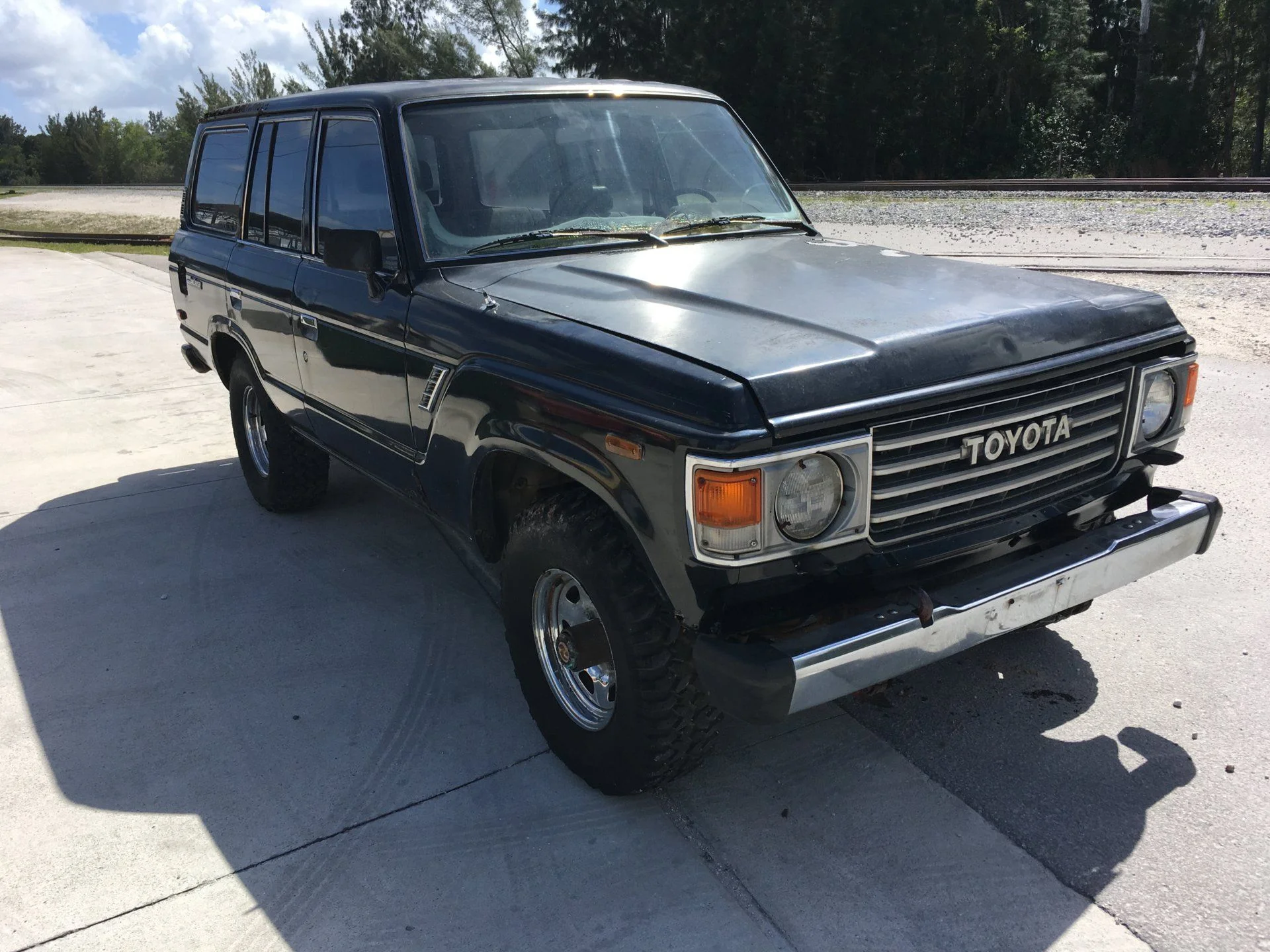

Last week (Feb 20, 2019) I purchased my 1987 FJ60 @ 197k miles in South Florida. The cruiser needs a lot of work and I couldn't be more excited to start on it.
1914586

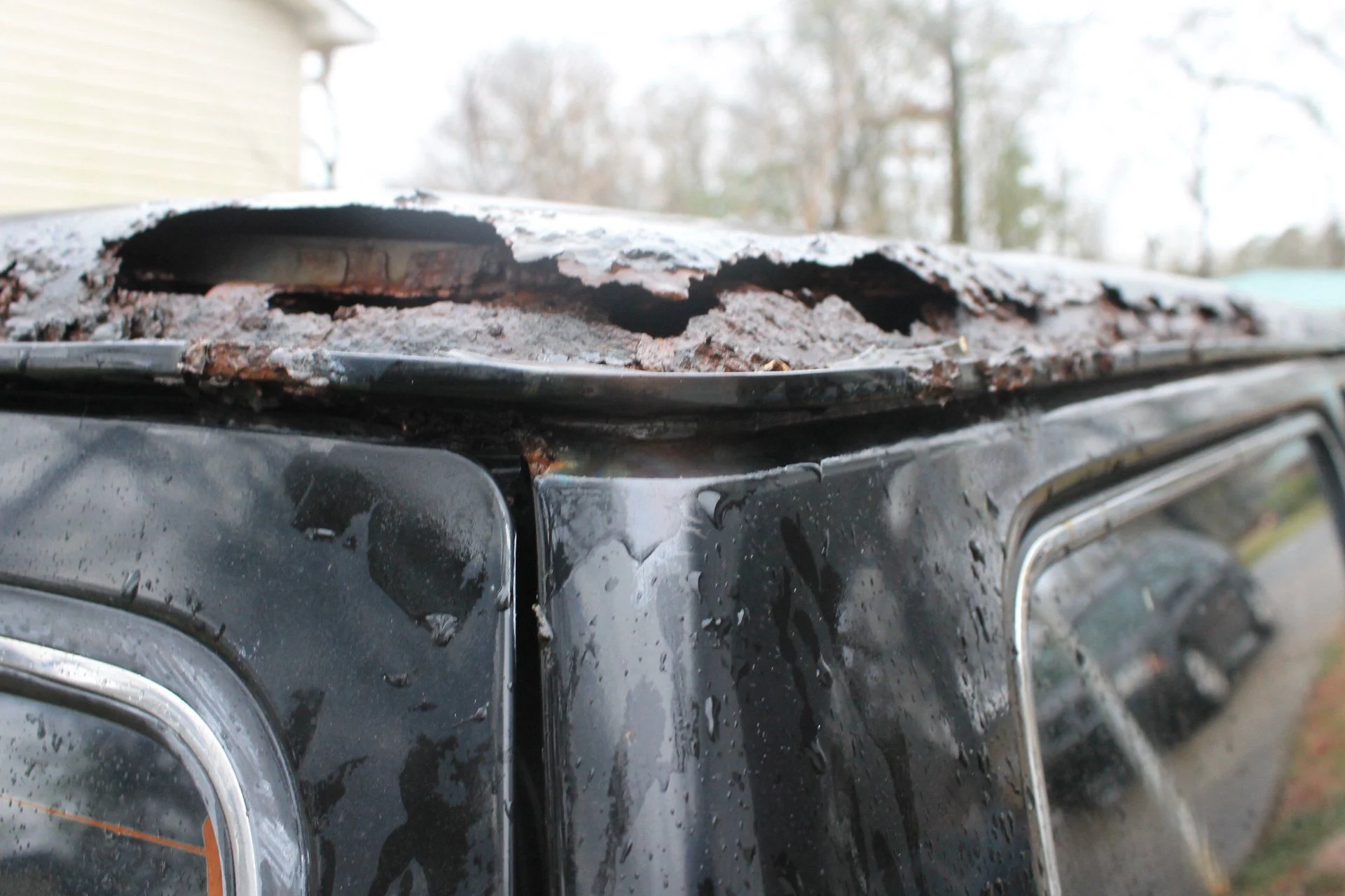

I went down to Florida to purchase it sight unseen after talking with the owner over the phone. The owner had described to me how the rig needed a serious restoration and that it did in fact run and drive with the help of a jump start, starter fluid, and a buddy to hold the choke open until it got warm. The Cruiser had plenty of body rust issues, including a serious hole in the back corner of the roof, but only surface rust on the frame. The glovebox and stereo were missing, tires were old and cracking, the dash splitting, and the driver's side mirror had broken off at the base, among other issues.

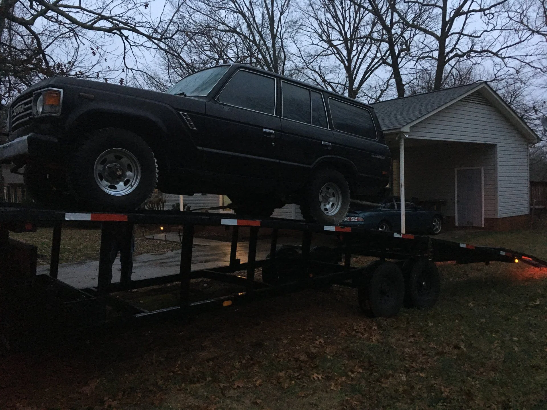

After starting the cruiser to move it to a loadable location, I left town and eagerly awaited for the vehicle transporter to call stating my new Cruiser was on the way home. The next day I arrived back home in South Carolina and waited for my dream vehicle to be delivered. The Cruiser was unloaded safely, but my amigo transporting it got stuck in my yard. Luckily a Good 'ol boy with a 4x4 stopped by to pull him out. I signed my papers, paid the driver, and took a moment to enjoy my new purchase.

Planning to purchase a donor roof and mate it as of now. Open to suggestions.
Probably easier than rolling sheet metal and welding that in.

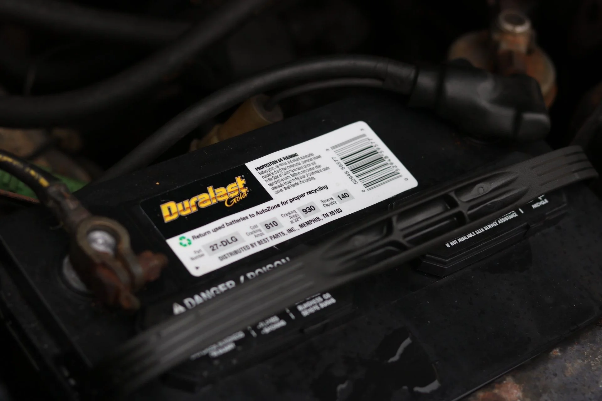

I searched for hours trying to decide on a battery. I read in a couple of forum posts that the Sears Platinums wear unbeatable for the price, but alas, they were discontinued. I played with the idea of an Interstate, but cringed at the $300+ price tag. Eventually, I read one member's comment stating that a couple of rock crawlers had once told him 'not to even bother with finding the "best" battery. Just go with whatever has 800+ CCA and a 3+ year warranty'. So I settled on a Duralast Gold with 810 CCA and 3 year warranty + 2 year prorated replacement.

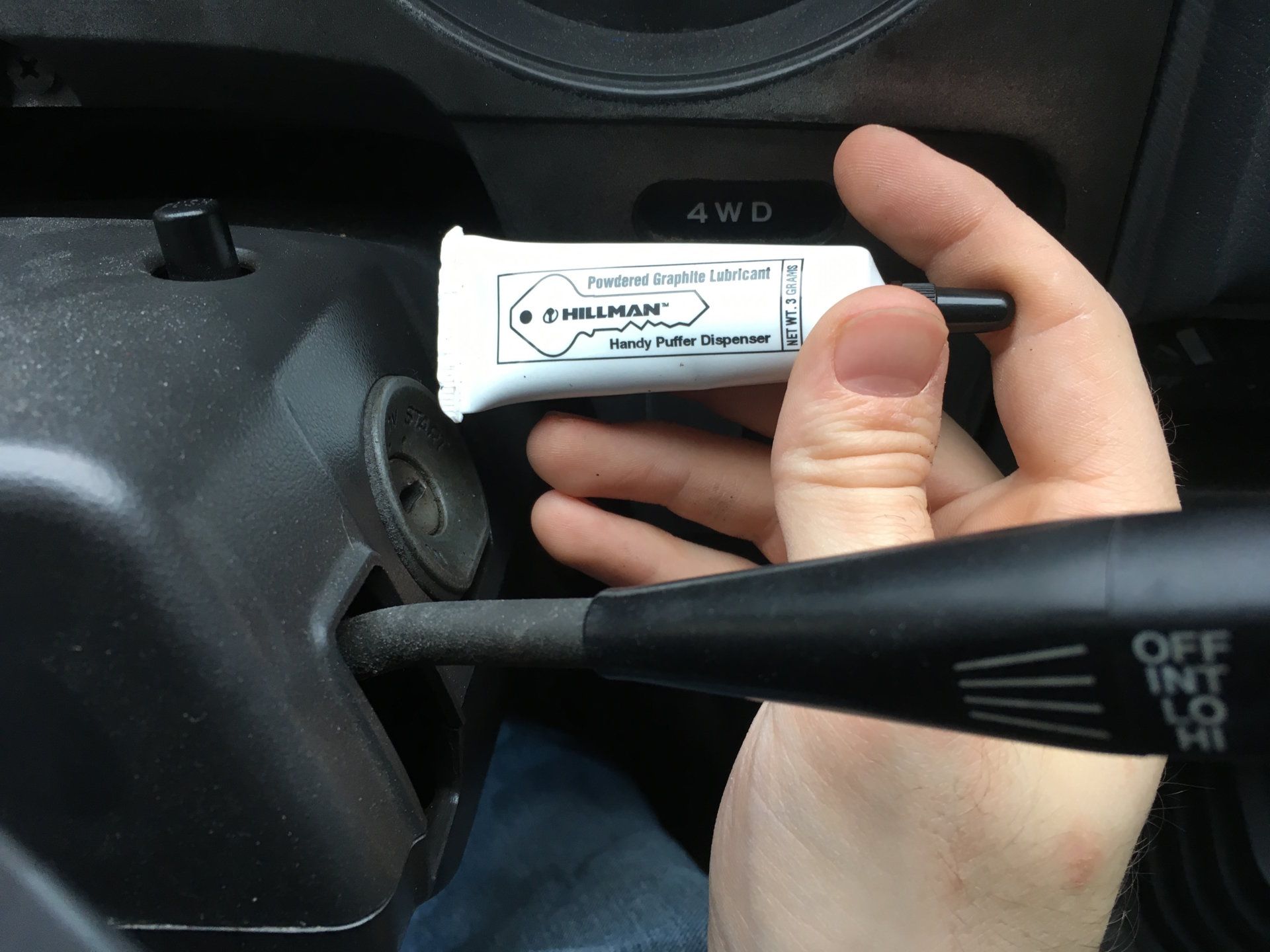

I went to check my lights afterward, but had locked my steering wheel and couldn't turn my key. The key no longer would lock into the tumbler like normal either. It just slid in and out without having to press the key release button. I felt like a total noob. I was worried the tumbler had fully broken.
After looking for a solution, I jiggled the locked steering wheel while turning the key with a bit of force. The key turned and the wheel unlocked. Relief. I tested all the lights and was happy to find they all worked. I don't know if the gauge cluster has any backlighting, but I didn't see anything other than the turn signal indicators and the brights indicator. Neither of the three horn buttons worked. After taking the key out it would only slide in and out again without turning. Back to square one.
1917236
I found some powdered graphite that aided the process and now I have no issues with the key and tumbler.

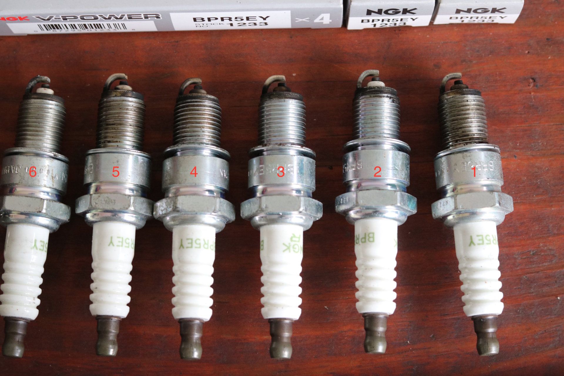

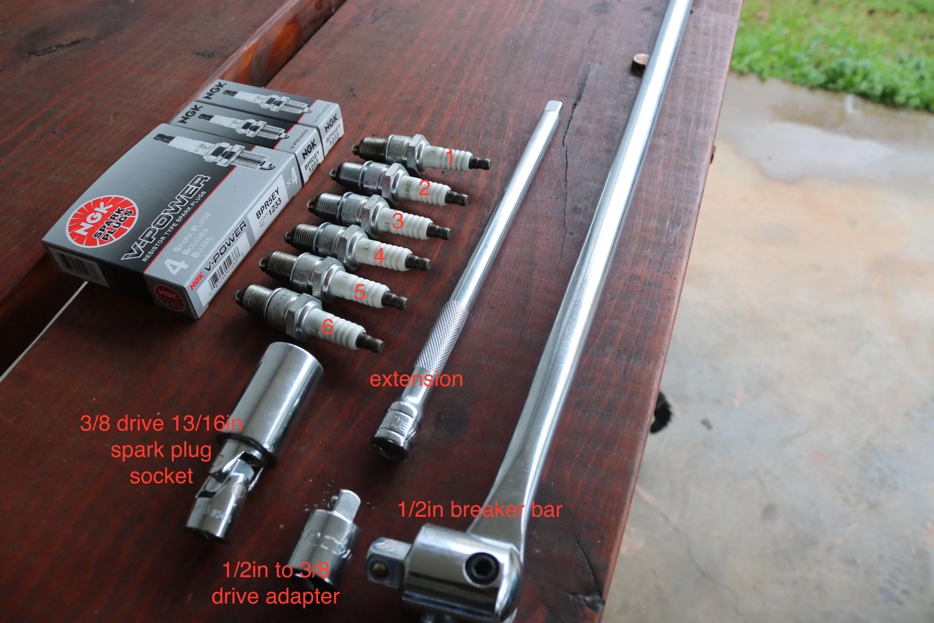

Next, I turned my attention to replacing the spark plugs.
1917146
I used a 13/16in spark plug socket to remove the plugs. I had some trouble so I went to grab my breaker bar, extension pieces, and adapter bits.
1917147
I got plugs 1-5 out with relative ease. I figured cylinder 6 would be tricky due to its location. Apparently, it was for the previous owner or whoever changed the plugs last. Plug 6 I was able to hand turn. It had backed out on its own. Not a good sign, but the plugs all seemed to be in decent shape. Then again, I wouldn't know haha.
1917155
I decided to use my torque wrench to install the new NGK V-power plugs.
I set the torque to 18lb ft. and reattached the plug wires. Done for the day.

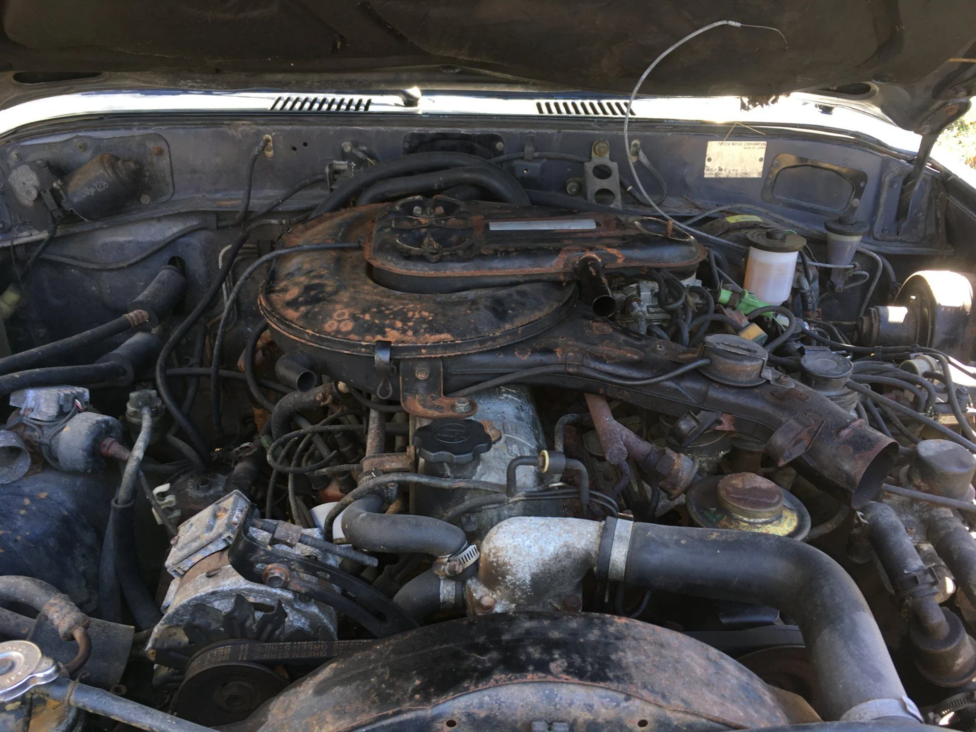

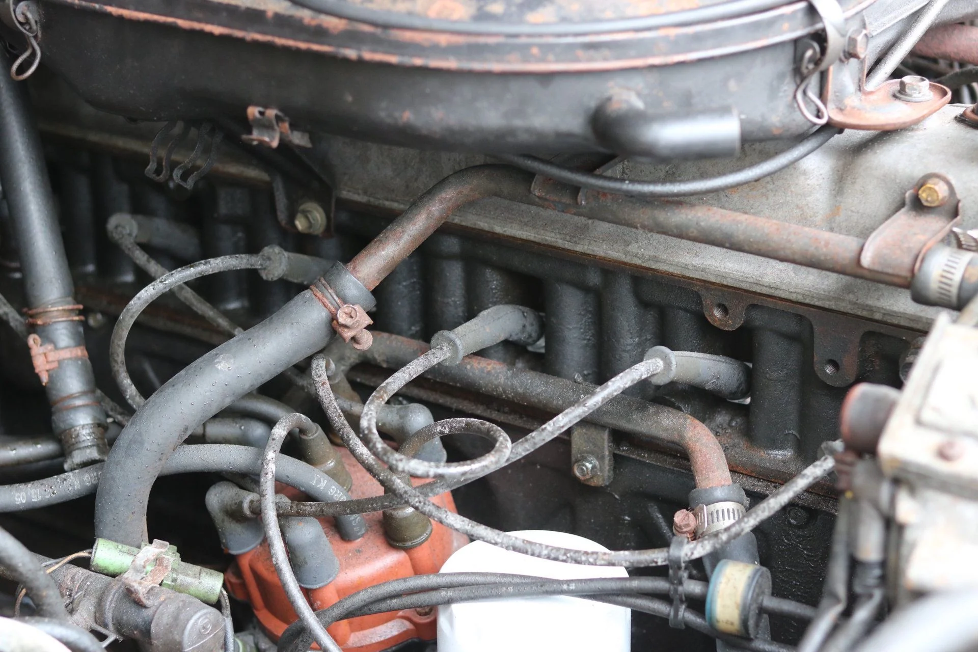

I'm wrestling with how to do that. Many vacuum lines are either not plugged up to anything at all or plugged into the incorrect location. Some even have special objects inserted into them. I'll post pics later... I want to desmog and correct the mistakes at the same time, but I don't know this engine well yet. I did download an emissions control pdf from Trollhole and a desmog pdf as well.
