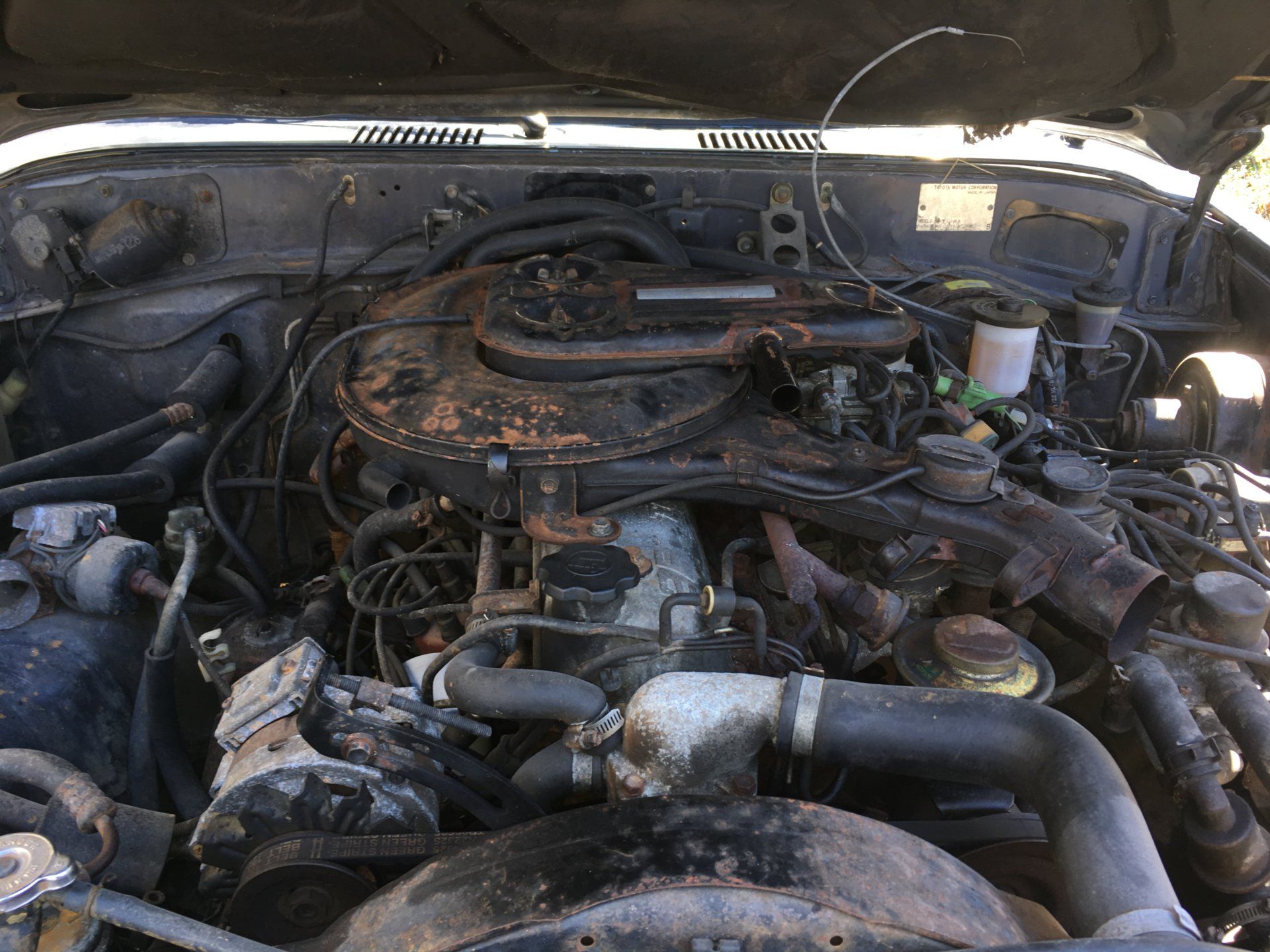

What’s w/ the gaping open air cleaner cover? How long are you leaving the choke on? And is this your first carbureted vehicle?

Just an under the hood pic.

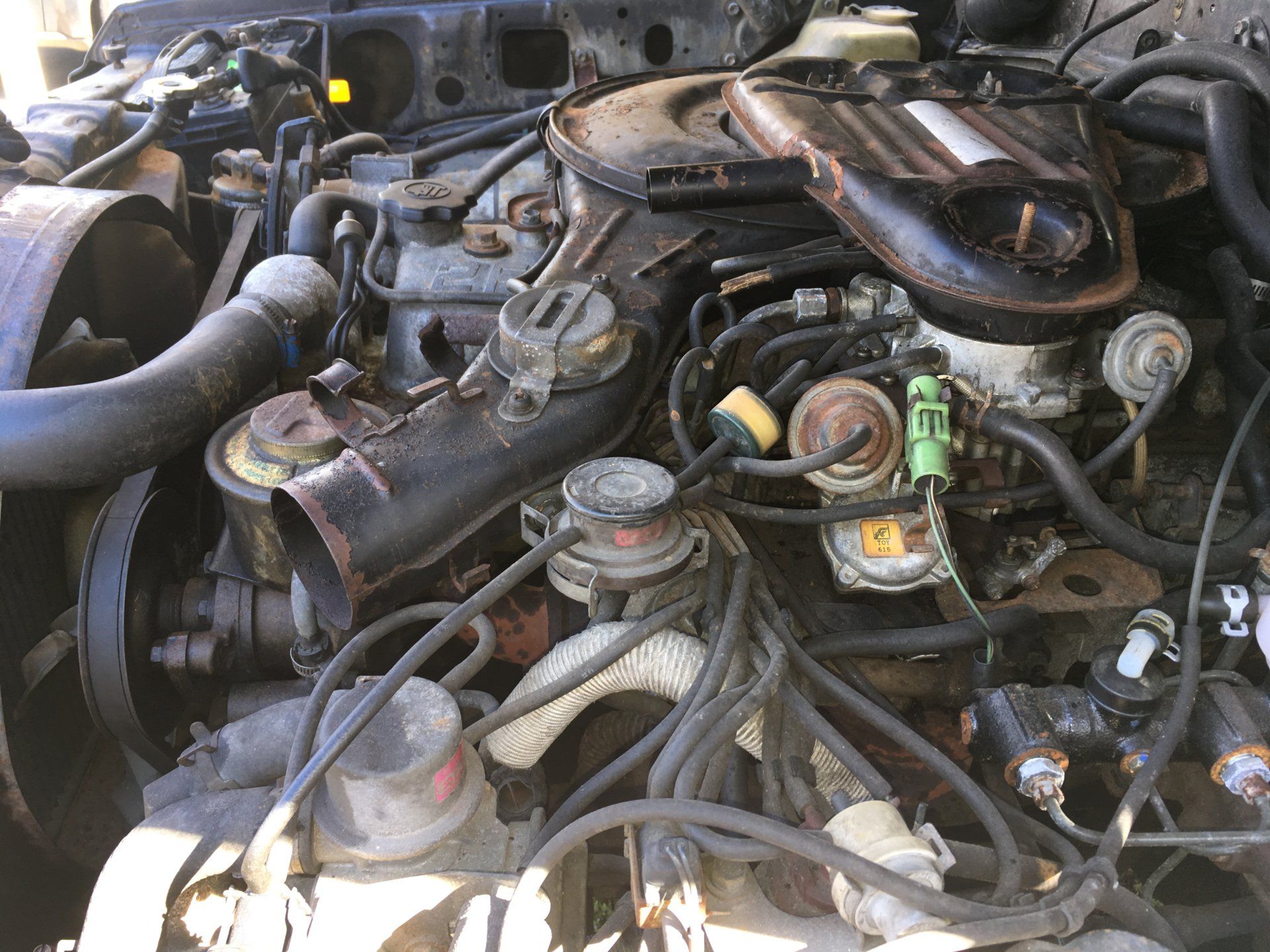

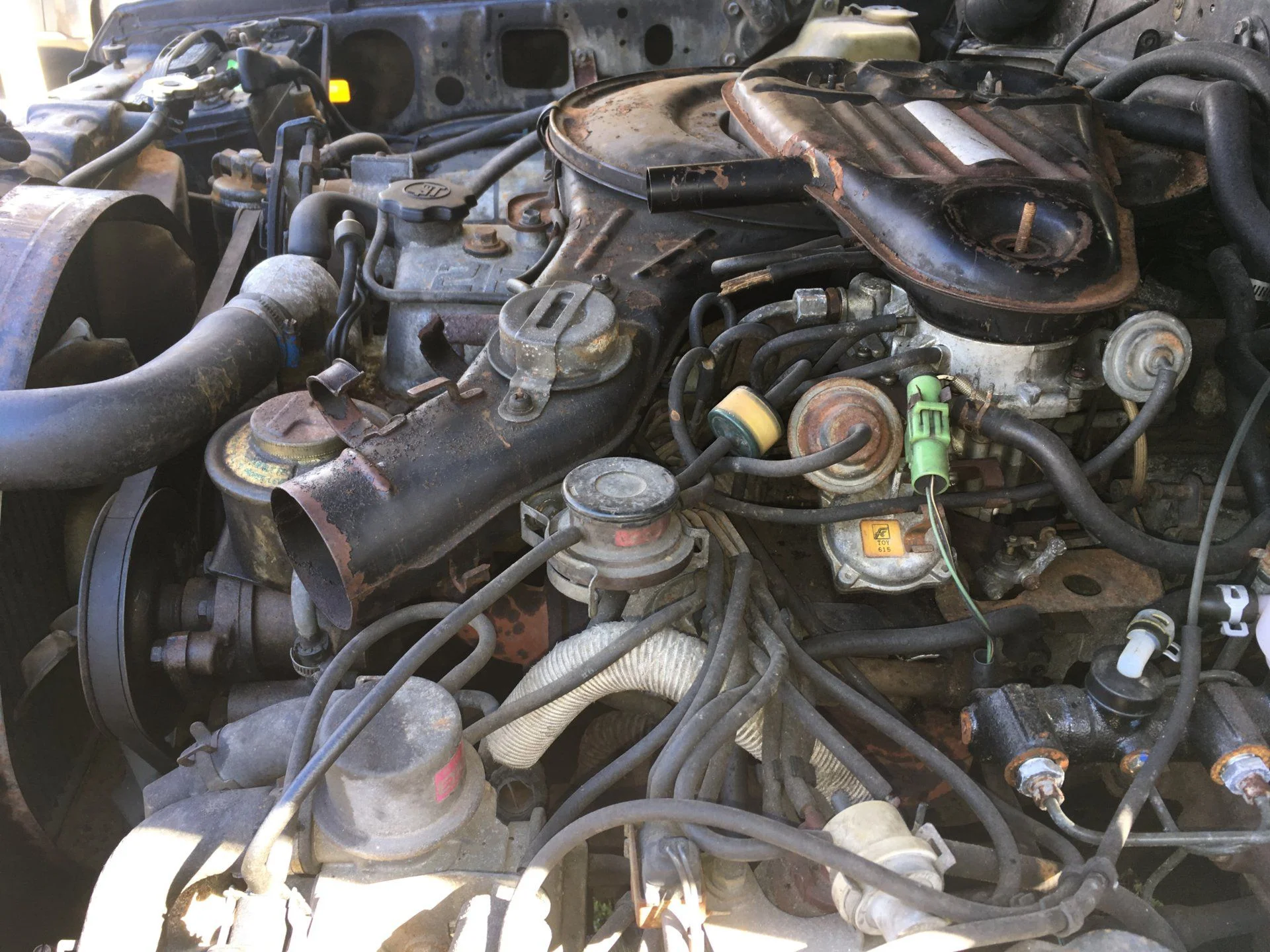

Hmmm... sounds like we will need pics of carb, all vacuum lines, and at least one profile pic( of the car)... could be vac leak, incorrectly routed hoses, incorrect base timing, maladjusted carb, or plugged up ports on carb. If it’s been “desmogged “ then I highly recommend using the approved de smog diagram found in this forum titled “ my de smog thread” et al...and using forum approved hose and wire routing, timing and carb specs, using new vac tubing and a refreshed carb. If it is still stock, verify all the hoses and wiring is correct, base timing set to bb on flywheel, no vacuum leaks exist, then look hard at carb...to check for vacuum leaks, put a welding glove on, some face pro, fire up car without air cleaner on and choke it out by covering the air horn with your gloved hand. It should just die. Anything else means it sucking air from someplace it’s not supposed to be...

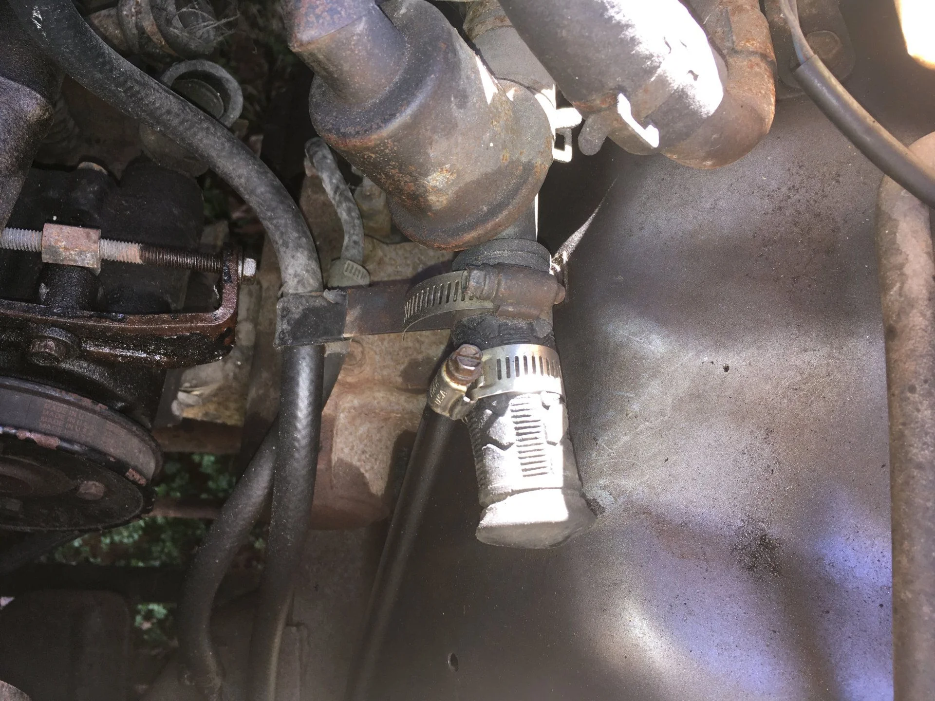

PCV hose in photo one of you holding it... should not be hanging free. That’s a big leak right there. Hose goes to a valve called the positive crankcase valve. It should be seated in the J pipe that juts out of the side cover (passenger side) which is in the block, just a bit behind (toward the firewall) from the distributor.
Pipe that sticks out of the air cleaner cover toward the nose of the truck should be capped or plugged. You can go red neck and stuff a wine cork in it if you any around. Same goes for the other one from the base of the air cleaner too.
Missing the hold down nut for the carb screw that runs through the air cleaner cover too. That’s another leak.
My dear new cruiser owner.... that truck needs some TLC for sure.
Lots of badly routed hoses for the vacuum system and I see some swollen coolant hoses too in dire need.

Chuckling. Check out the pics above. Oof! It really is truly amazing that our trucks WILL run regardless of how sad the vacuum routing is put together.
Charcoal canister hoses are funked up, routed weird.
Distributor vent hose looks like it’s going up to the air cleaner too...
lots of weird stuff here.
