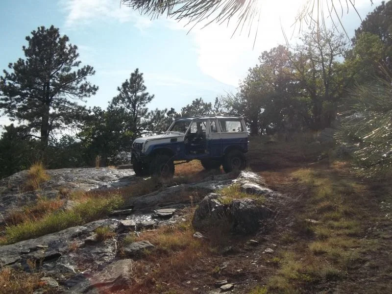

Chicago Toyota Jambo at the Cliffs

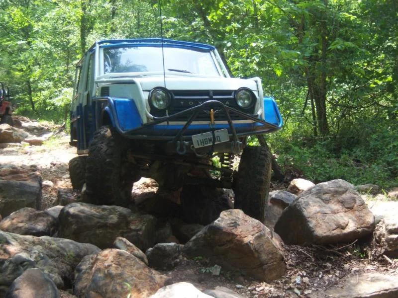

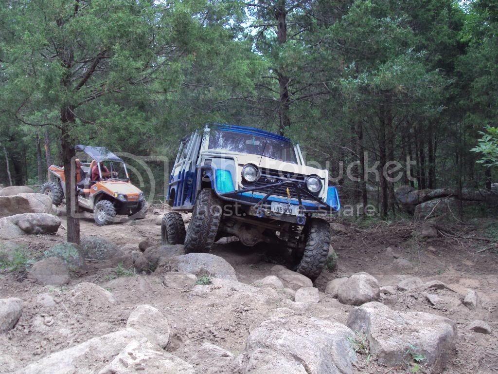

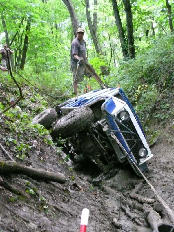

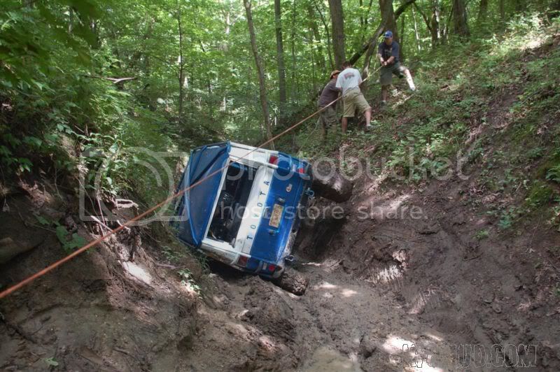

Ran a some pretty hard trails. Only really ran into trouble on the one. Lost the bolt that keeps the steering shaft tight to the box and took a bad line into a deep hole.
I sure hope someone took more pics. I didn't have a camera at all. Woody took a bunch and has some great ones of some shoeless dude standing on the 55.

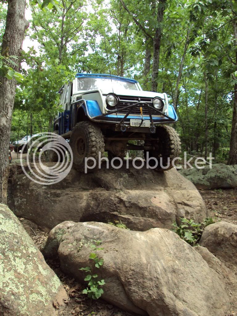

That thing did amazingly well Todd. I am now fully torn about the exo.
Might just stick to beating the 40.

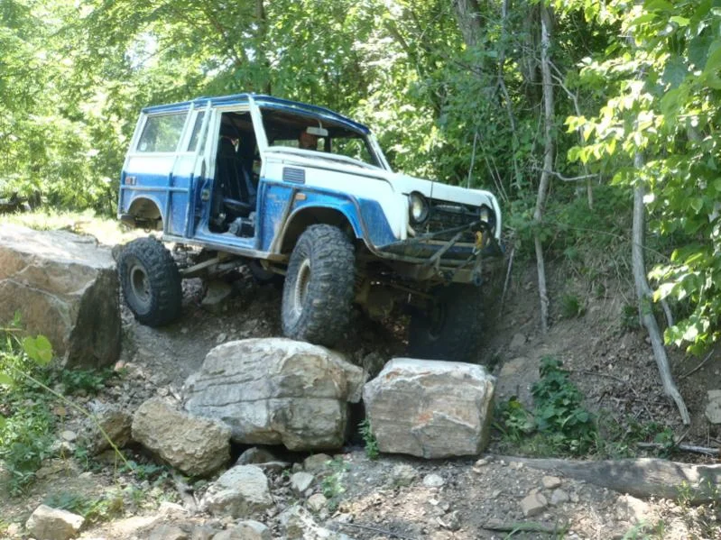

I got just a couple of pictures with the cellphone camera- so I'm hoping Woody's pictures accurately show how messy Saturday was. That was a sloppy good time.
Luke
And that shoeless guy was Al.
We didn't sleep too good in the storm Friday night so me and Cerdito took a little nap on Saturday.
Alstaz taming the wild pig
Cage worked. No body damage

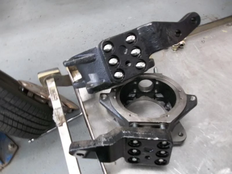

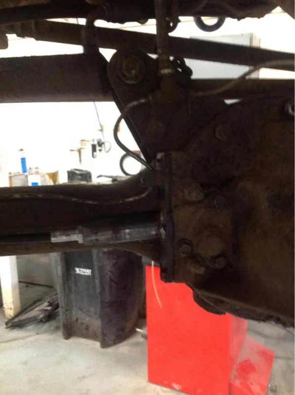

Six shooters are here. Spent much of today fitting an ox locker shifter to the e locker.
It went pretty well. I drilled the end of what is left of my engagement rod to accept the 1/4 -20 thread on the cable. Welded some pipe to the plate I made where the elocker actuator was with a 5/8 nut welded to the end to accept the cable sheath.
Ran the cable and it works.
I need a spring to unlock. Ox uses springs in the locker to disengage. I bought some on the way home that should work.
Got the springs. It works great on the hoist. Well see how well it works on the trail the weekend after next.
Good work, I love the e-locker design. Is there a reason why you wanted to ditch the electronics? It's super easy to wire up.
more on that locker cable mod, please. Where to get the cable and where is the actuator rod cut, and must see how you rigged the unlock springs. I would so rather have cable. and what keeps the thing engaged, does it ever unlock on you pics of dash side of cable if you got em and oh yeah, your truck plain sux:flipoff2:;)
