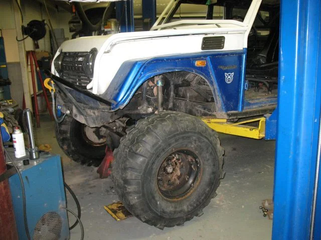

7' even to the top of the exo.
about 21" to the lowest point on the rear transfer which will be the lowest point on the skid. That should go up when I upgrade from the 36s.
Wheelbase is what I get asked about the most. 111" Just a little over stock.
Overall length is 153"ish bumper to bumper not counting the stinger.

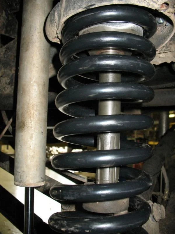

The old bumpstops were mangled. They were nowhere near sturdy enough and didn't guide the spring well enough.
So I needed something with about a 4" wide bell or cone on the end and a long stub coming out of it, preferably with a threaded end so I could bolt a rubber stop on.
Fortunately, I have about a dozen of these around the shop.

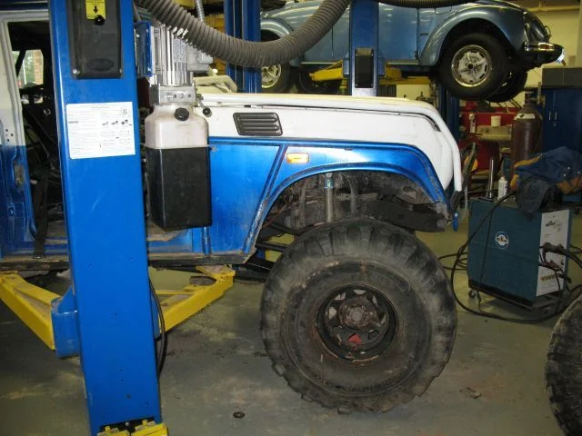

On jackstands about the right height for 39.5s. I wouldn't put these on. They are junk. I got them to check stance and clearance for new tires. The 36s just look too small on this rig.
So, you added 5" from the stock WB, all up front? Mine's right at stock WB 106". Are you running FJ60 axles? Looks like you need some width w/ that ride height. I'd really think about the sway bars seeing the pic of that body roll all unloaded like that. Love that action pics, can't wait to do the same :bounce:
80 axle in the rear. 1.5" spacers on a 55 axle on the front. added a couple of inches on each end as I did the links to give me space to trim fenders. The 111" measurement was by myself. I could be off a couple of inches too.
