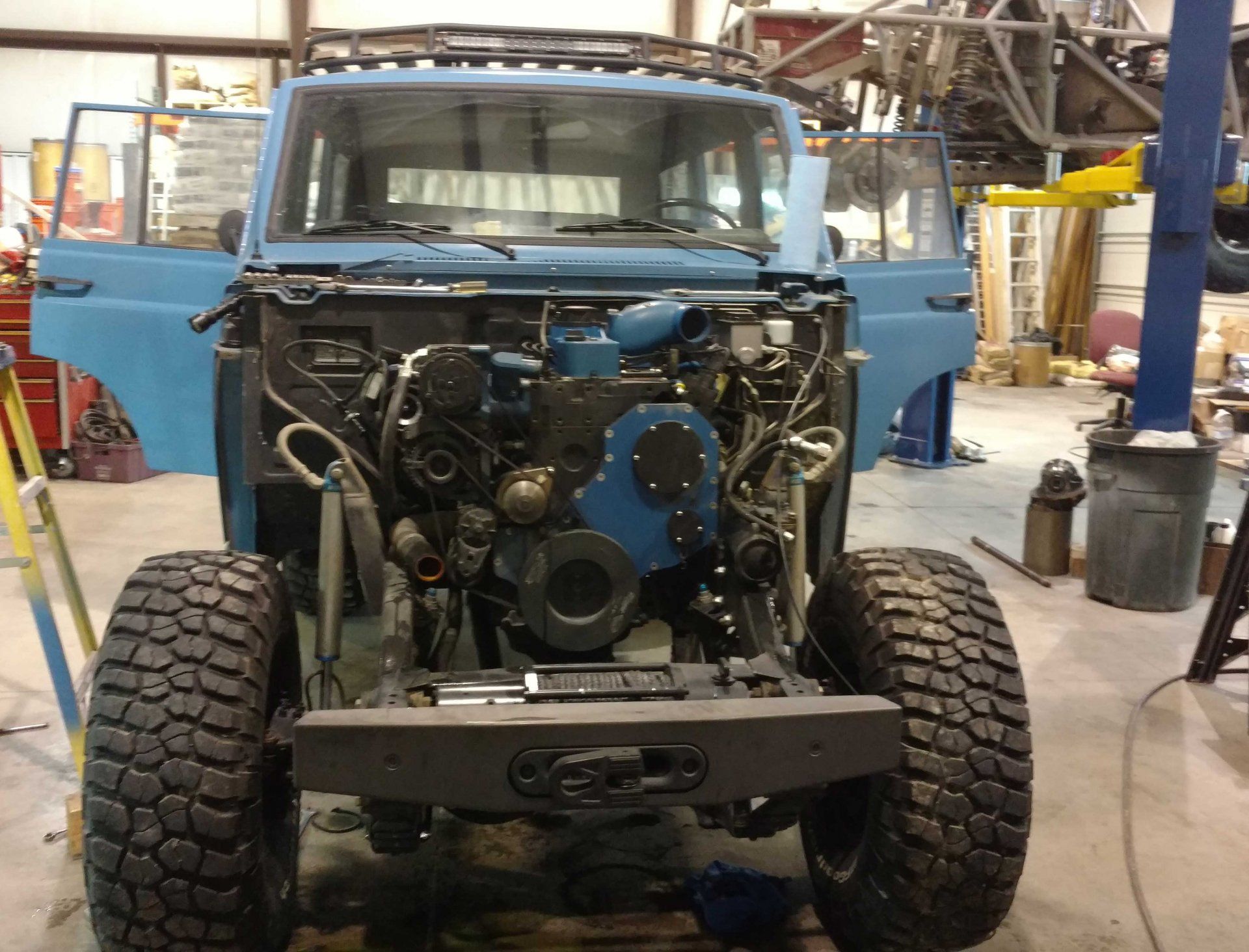

Wow I forgot exactly how many bolts and screws hold the front sheet metal on a pig, two days later I can start unbolting the engine…
Replacing or rebuilding Jim?
The plan as of now is to get it out and see if the block is still standard bore then get it to the machine shop so they can start the required machine work. If this block is at or near max over bore then I need to hunt down another.
Either way I think I’ve settled on building a complete short block with new OEM Cummins parts and not taking any more chances on low mile engines for sale on the interwebs..
Yea and the pity party I’m throwing myself isn’t helping but the thought of getting it back on the road and joining in on some of the events like cruise Moab or the pig party is motivating me to put my big boy pants back on and get to work..
Engine is out and damage assessment has started, looks like valves have made contact with the pistons on every cylinder so assuming new valves will be part of the rebuild.
Engine is going to the machine shop Monday to see exactly what the final damage report and $$$$.$$ is but pistons are standard bore so fingers crossed I can reuse the block..

That was going to be my question, do you have the 60# valve springs?
I had 60# springs and a Colt stage 2 cam, according to Colt that should have worked fine with stock pistons but as you can see from the pictures they were wrong. New pistons are getting fly cut .120” to avoid contact with the new valves. Unfortunately two of the pistons had stuck rings the wore into the cylinders .007” on one side and they are not sure it will clean with the .020” over so I’m stuck with going to the .040” pistons but it looks like they can save the block.
Still making the list of parts I need to order but so far it looks like I could buy two used low mile engines for what it’s going to cost to rebuild one correctly with all new parts :(
